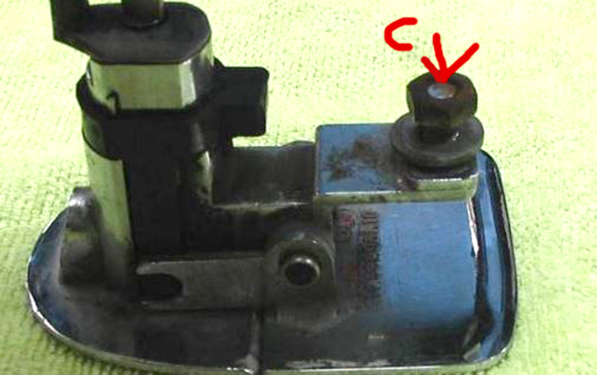

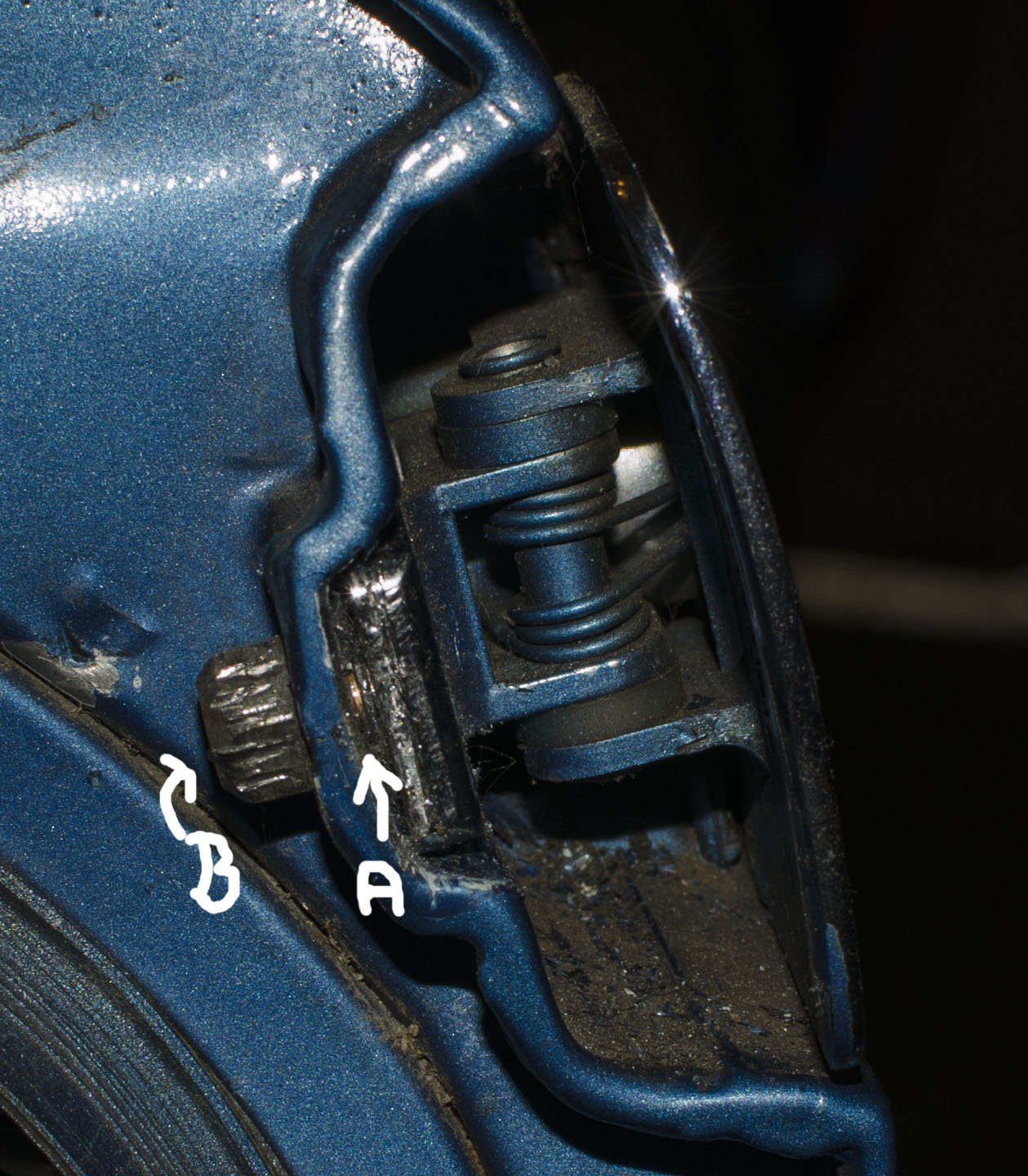

trying to remove the door handles and the nut just spins.. so does the threaded stud.. A is where I scrapped away some of the rubber seal and the threaded stud is visable and it turns when the nut is wrenched. B is the nut that is scarred from the vise grips... wrench would just turn the nut and the threaded stud C is the nut and stud in question.... a snip from an image of some one else's. the car was painted with the handles on by some one previously. I would think that the threaded stud would just come out when wrenching the nut?? any ideas??? please... thanks randal |

Remove the door panel then remove the 5mm Allen screw that holds the front of the handle from the inside, then you can get a pair of vise grips on what is left of the stud.

I had already removed the door panel and the 5mm hex screw. the vise grips and a hammer does not seem to work on the nut. the stud and the nut just spin.... so is this toast.... ????? tks randal |

The stud has broken free in the handle. You nay need to cut off the nut. The stud could be replaced with an oval or flat head screw. Getting off the nut is the biggest problem. I would try a dremel cutoff disk in the nut

Try inserting a pry bar or equiv. in space A, between the handle assy and door panel, then apply prying force while rotating the nut. Hopefully, the stud should back out from the handle assy.
If you're patient and careful, you may be able to save the handle. Inspect to see if there's enough meat to repair with a new thread insert or equiv. Sherwood |

After you get it off, the handle can be restored and reused. One of 3 ways: #1 tap the hole where the stud was and use a short bolt/screw to reattach. #2 tap the hole where the stud was and red locktite a new stud in place. #3 drill the hole out where the stud was and use a small bolt/screw and nut.

I am thinking that I should try to cut off the stud where (A) is pointing. the other door is the same........... fun tks again. randal edit.............. I have tried the prying and wrenching the nut.... |

I know more about outside door handles than anyone here so please believe me.
Only way to get the handle off is to cut the nut off. Drilling out the stud will make cutting the nut off easier. Trying to cut it off at the "A" location will only f-up your door. |

After you get it off, the handle can be restored and reused. One of 3 ways: #1 tap the hole where the stud was and use a short bolt/screw to reattach. #2 tap the hole where the stud was and red locktite a new stud in place. #3 drill the hole out where the stud was and use a small bolt/screw and nut. #1- the handle is cheap pot metal. Tapping it won't work. #2- see above. #3- BINGO! |

Try inserting a pry bar or equiv. in space A, between the handle assy and door panel, then apply prying force while rotating the nut. Hopefully, the stud should back out from the handle assy. If you're patient and careful, you may be able to save the handle. Inspect to see if there's enough meat to repair with a new thread insert or equiv. Sherwood You'll break the mounting tab doing this. But feel free to do it and send it to me to be repaired. I could use some cash. |

The stud has broken free in the handle. You nay need to cut off the nut. The stud could be replaced with an oval or flat head screw. Getting off the nut is the biggest problem. I would try a dremel cutoff disk in the nut Excellent advice! (IMG:style_emoticons/default/first.gif) |

so......... what I did was to cut off the nut and then used the drill press to
drill out the stud... now to take the handle to the flat head store and buy what fits. tks for everyone's help.. randal |
