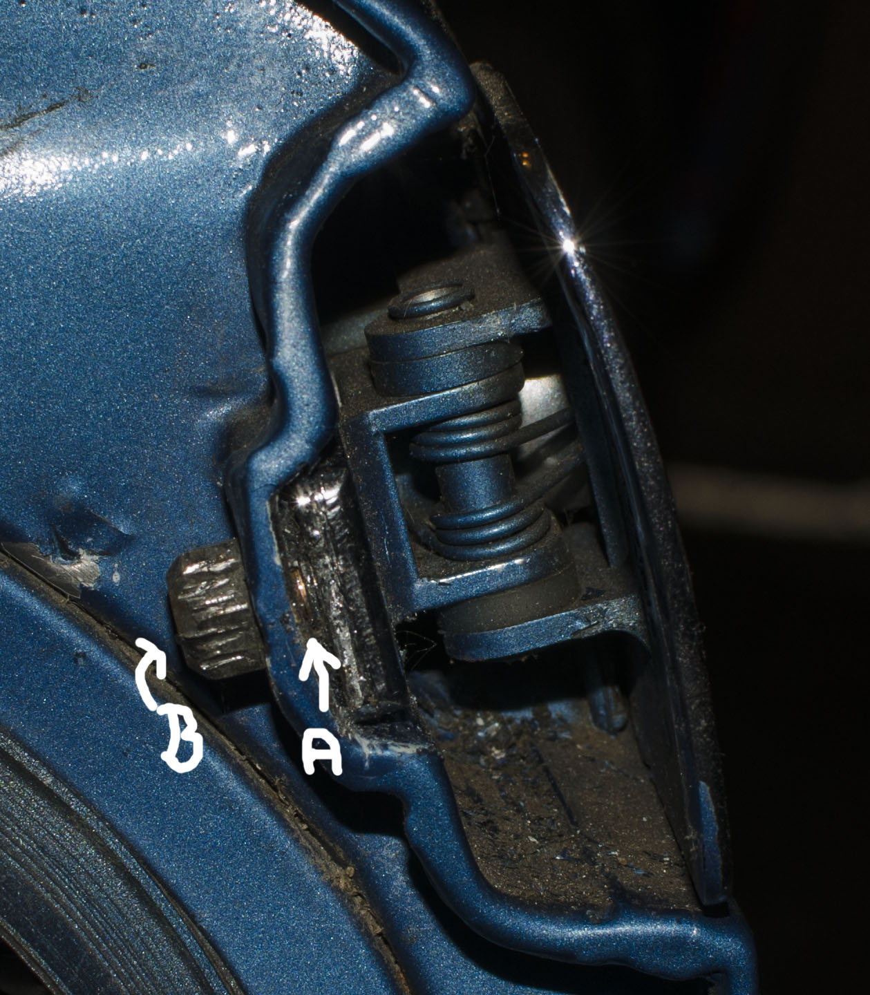

trying to remove the door handles and the nut just spins.. so does the threaded stud..
A is where I scrapped away some of the rubber seal and the threaded stud is visable
and it turns when the nut is wrenched.
B is the nut that is scarred from the vise grips... wrench would just turn the nut and
the threaded stud

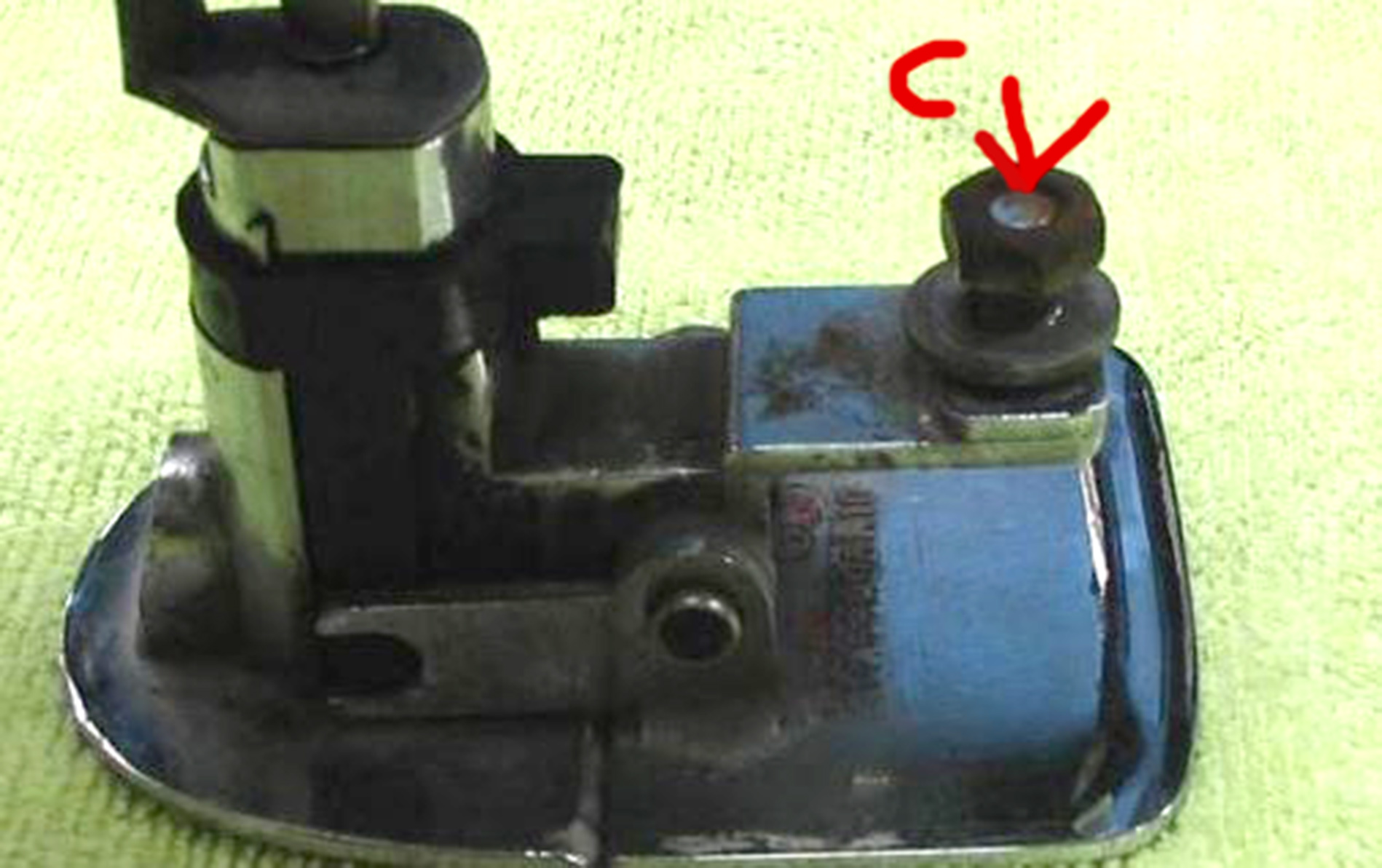

Click to view attachment C is the nut and stud in question.... a snip from an image of some one else's.
Click to view attachment the car was painted with the handles on by some one previously.

The stud has broken free in the handle. You nay need to cut off the nut. The stud could be replaced with an oval or flat head screw. Getting off the nut is the biggest problem. I would try a dremel cutoff disk in the nut

Try inserting a pry bar or equiv. in space A, between the handle assy and door panel, then apply prying force while rotating the nut. Hopefully, the stud should back out from the handle assy.
If you're patient and careful, you may be able to save the handle. Inspect to see if there's enough meat to repair with a new thread insert or equiv.

I am thinking that I should try to cut off the stud where (A) is pointing.

Only way to get the handle off is to cut the nut off. Drilling out the stud will make cutting the nut off easier.
Trying to cut it off at the "A" location will only f-up your door.

so......... what I did was to cut off the nut and then used the drill press to
drill out the stud...
now to take the handle to the flat head store and buy what fits.
