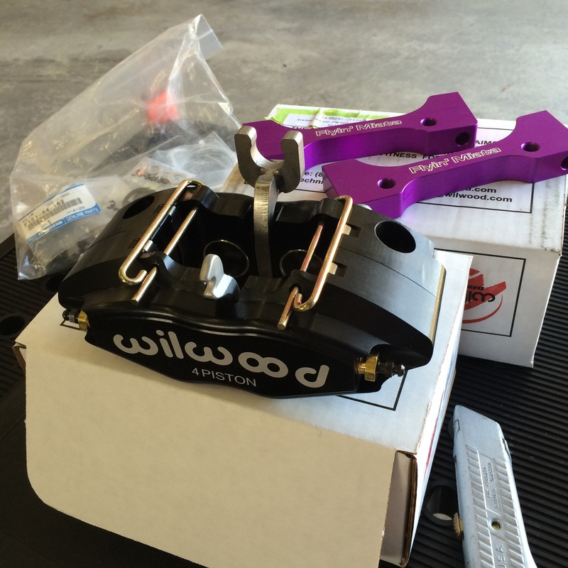

I happened across a photo posted on another forum regarding a rear parking brake solution. It's an interesting idea to an on going dilemma that 914 guys struggle with. I don't know how applicable this might be, or what potential (concept wise) it could have, but thought I'd throw it out there.
The photo is a 4 pot radial mount Wilwood caliper that has been modified to accept cable actuated levers. I can't say if the modification compromises the calipers strength, but it is a cute idea. The modified caliper and hardware is offered by Flyin' Miatas.

I like it...as long as the parts are modified correctly and never swapped over to be used in a front brake application I see nothing wrong with them.

So, this caliper would replace a regular 914 caliper? Would one (without mods) replace the fronts? Are they better? Worse? Cheaper? More expensive?

Without knowing the bore sizes I'd make a semi-educated guess that your would not want to install these on the back of your 914 without upgrading the fronts as well. No idea if a new MC is required as well.
The calipers are about $130 each at Summit racing, figure another $50 to $100 for adapters...however from Flyin' Miatas, the parking brake mods add another $220 per set...a few more hundred and one could buy the slick aluminum calipers Eric has on his site, no adapters if I am correct.
