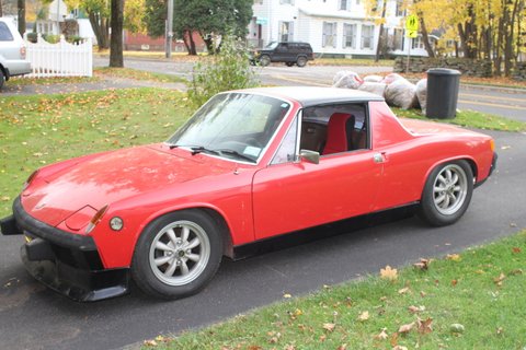

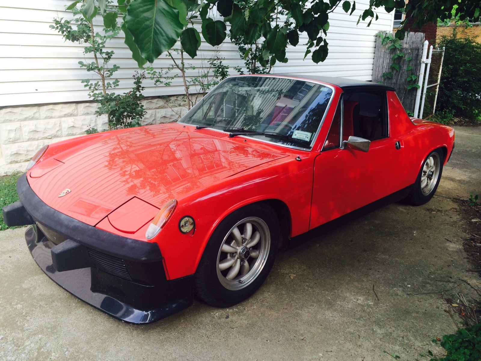

Well, look what the cat dragged in
914Sixer
post Jun 12 2015, 08:33 PM
Posts: 9,472
Joined: 17-January 05
From: San Angelo Texas
Member No.: 3,457
Needs a few things but pretty clean looking. Watch out for dips in the road, spoiler might last too long.

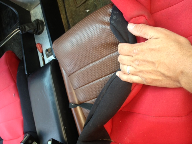

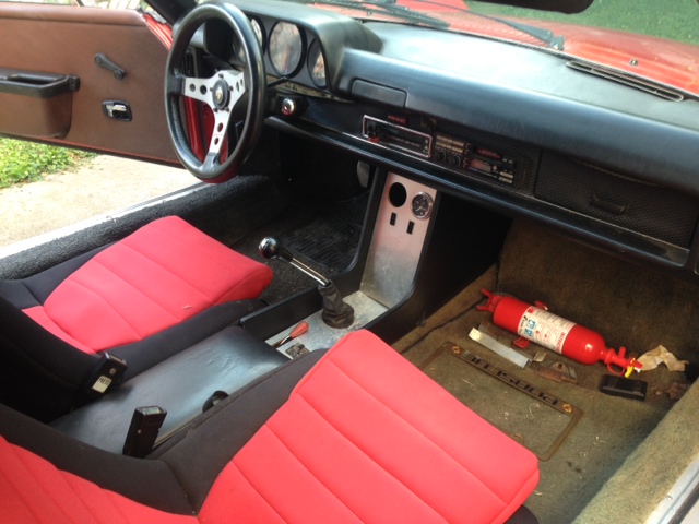

Pretty happy with this car. i only had about 30 minutes to look it over after it was delivered before I had to leave the house, but overall it seems to be a really solid driver. The interior is a little bit rattier than expected. the good part is dash is crack free and the ugly seats turned out to just be seat covers that were hiding really nice stock brown seats. The dash face vinyl is peeling, the carpet needs replacing and the rear window has a less than stellar tint job on it. The one thing that is kind of a bummer is the car was originally Signal Orange. I don't mind the red and it has a good older paint job on it but I am a dead up sucker for an orange car. Knowing that the car I own was originally one of my favorite 914 colors just stings a little bit. I'll investigate a little more this weekend.

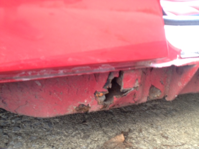

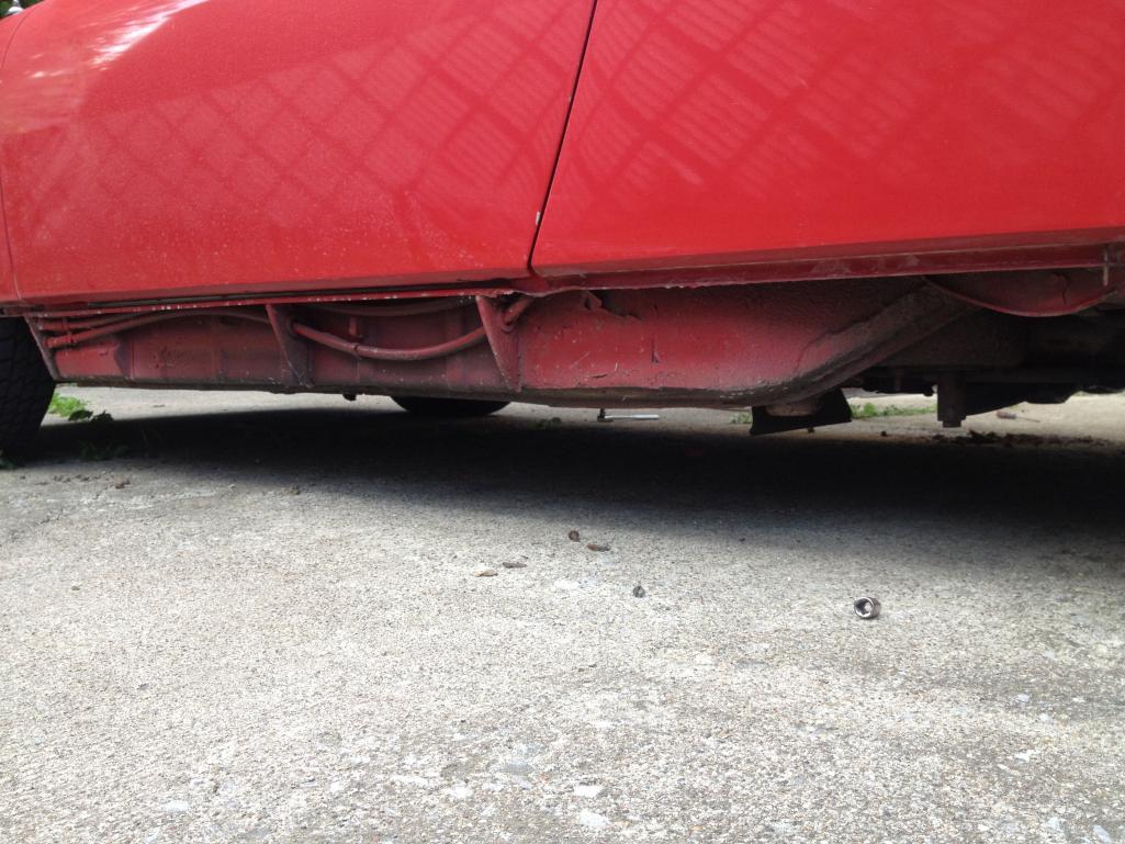

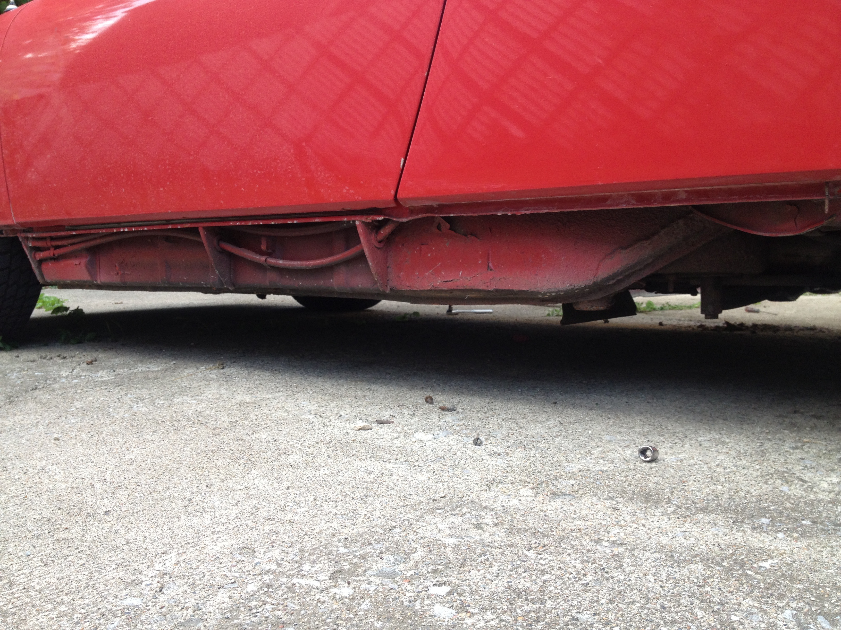

I did a little more digging into the car today. I didn't expect to get a rust free car from the northeast but i'm not sure how bad it is. it seems solid everywhere but under the passenger side rocker. you guys can be the judge of how bad it is. the front floors, and all the jack points seem solid. I haven't pulled the battery but i can't see any real problems in that area. this car has been painted at some point so it probably had some rust issues addressed at that point. I bought the car sight unseen and I didn't know it had a center console. it was just sitting in the passenger footwell and i loosely installed it just for the photos. I realize it's not the same as the factory set up but it was a nice surprise. I also thought the seats had been redone but it turns out they are just covers. The parking brake seems to be stuck on. the lever goes u p and down but i can't push the car when it's not in gear. I did drive it around the block and i'm looking forward to being able to get it out on a longer drive. Any tips to get the parking brake unstuck?
Mike Bellis
post Jun 13 2015, 06:47 PM
Resident Electrician
Posts: 8,348
Joined: 22-June 09
From: Midlothian TX
Member No.: 10,496
Heavy undercoating means you might find more surprises. (IMG:style_emoticons/default/sad.gif)
Dave_Darling
post Jun 13 2015, 08:00 PM
914 Idiot
Posts: 15,338
Joined: 9-January 03
Member No.: 121
Time to start poking around with a screwdriver.
--DD
dabird
post Jun 13 2015, 08:12 PM
Posts: 94
Joined: 17-October 14
From: New Albany, IN
Member No.: 18,025
QUOTE(Dave_Darling @ Jun 13 2015, 10:00 PM) *
--DD
Thats exactly what i did. everything around that area seems solid
Nemisus
post Jun 13 2015, 08:19 PM
Posts: 82
Joined: 1-October 11
From: North Bay CA
Member No.: 13,631
nice looking 914!
Give that screw driver a bit of pressure... I am betting it'll go through in some of the places that "looks" solid
I learned a valuable lesson from the experts here... It might look solid but give it a thorough test.
The fact that you have a hole that size in the left long would suggest that the other side of it is just as bad... that area ties into your suspension console.
I am still debating on which direction to go... attempt a repair or buy a lesser rusted tub.
Your car looks in better shape so hopefully you'll get lucky and it will not be so bad...
dabird
post Jun 13 2015, 08:58 PM
Posts: 94
Member No.: 18,025

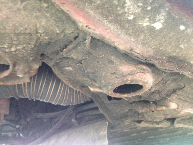

Here is the other side
post Jun 13 2015, 09:06 PM
914-6 GT in waiting
Posts: 20,662
Joined: 19-September 09
Member No.: 10,825
Start digging and figure out what happened to the jack post. Hopefully not just bondo or fiberglass.
Or just drive it and enjoy.
