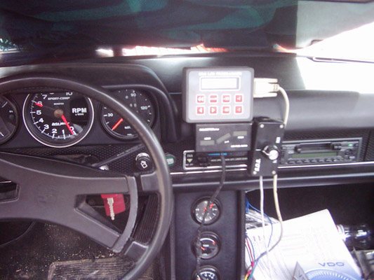

Yep I have the fix...toss it for a autometer monster (IMG:http://www.914world.com/bbs2/html/emoticons/rolleyes.gif)
IMHO you need it for that bad boy your building and it's a 100 times better tach. Fits the stock hole perfect.

will the sportcomp guage work with our stock wiring?

QUOTE (bd1308 @ Feb 23 2005, 04:15 PM)
No problem on the tach, I put connectors on it so I didn't have to cut the stock wiring.
Little bit of black RTV and stick it in.
The issue is you lose the turn and high beam lights. I got a couple of 12v mini lights from radio shack and did a stelthy install in the e-brake light lens. You could just drill a couple of 1/8" holes in the panel.
Thing is as solid as a rock and no more (IMG:http://www.914world.com/bbs2/html/emoticons/boldblue.gif)
