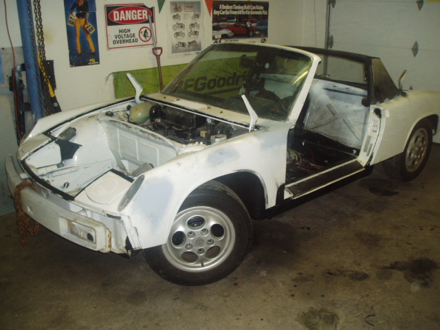

Finally after fitting, buying, fitting, dissassembling, cleaning, painting, fitting, assembly and now i have a car w/ calipers-no lines yet or mc- that has four wheels and steers w/ turbo tie rods, 911 brakes and is fully undercoated and welded up. FInallY!!!!!! (IMG:http://www.914world.com/bbs2/html/emoticons/welder.gif) (IMG:http://www.914world.com/bbs2/html/emoticons/spank.gif) (IMG:http://www.914world.com/bbs2/html/emoticons/givemebeer.gif)

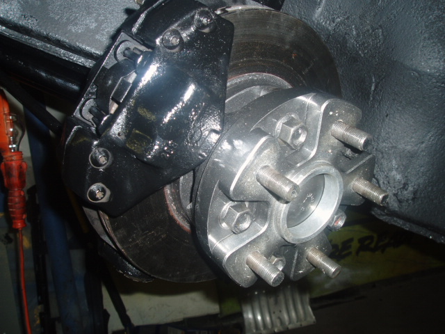

check out how close the caliper is to the spacer!

QUOTE (xsboost90 @ Feb 22 2005, 10:37 PM)
will you be using longer studs in the hub to get full engagement of the spacer's nuts? you look to be 2-3 turns from full engagement and you'll have leverage working against you. that scares me more than a little ...
xsboost90
post Feb 23 2005, 07:14 AM
Posts: 1,393
Joined: 2-August 04
From: cincinnati
Member No.: 2,432
the studs go all the way to the end, but the way they are grinded off at the ends make them look funky in that picture. The nuts also have a beveled edge that sticks out past the endof the threads, making it look like the studs are farther from the end. I assure you they are completely on there. The wheel bolts are the same way. RIght to the end ofthe stud. They are even torqued to 96lbs already.
