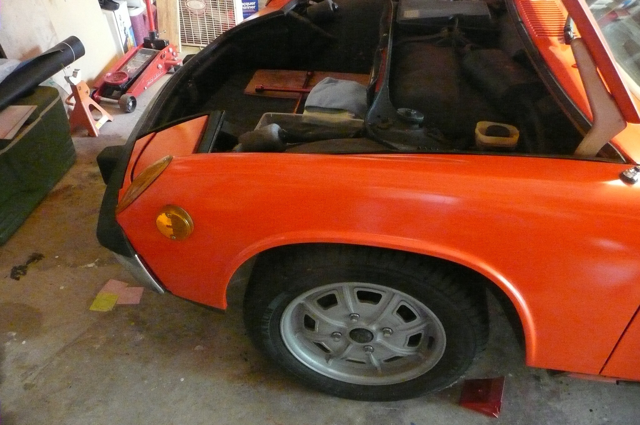

So I just found this nice set of original date stamped 1971/72 Pedrini wheels that I thought would look much better on my '74 2.0 than the Riviera's (stay tuned...will be for sale shortly). I plan on running the stock 165/80 15 tires as well.

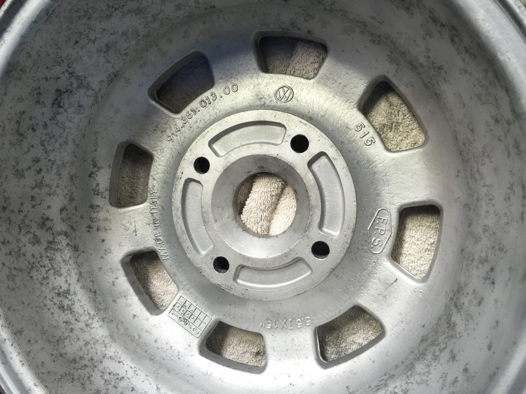

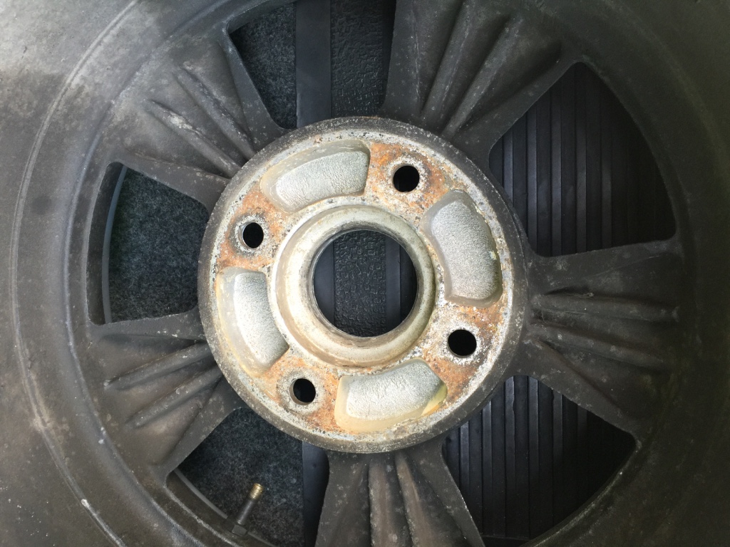

The rears bolted up fine (of course, I had to go out and buy a set of 40mm length thread bolts as the Riviera's only used 25mm length). Then, when we went to mount the fronts, we realized that the front brake disc rotors had a hub centric ring and the back of the Pedrini's had a countersunk shape (see pics below).
Any suggestions how to make these work?
(BTW, the Rears fit just fine)
Thanks
Paul

You can get a machine shop to mill out that inset at the top pic in all 4 or 5 of your Pedrini wheels.
Or else sell them off to a 70-72 914 owner on here ,& look for either the Pedrini or Mahle 4-lug ("Baby Gas-burner") silver painted cast 4-lug alloys, or the Fuchs 2L anodized forged 4-lug alloys - but they should all end with -01 in the part no. for the proper hub centric mill-out from the factory.

I know of three ways to make the .00 part number wheels work on a later car:
- Mill a recess in the back of the wheel for the centering ring on the late hub
- Mill off the centering ring from the late hub
- Change the struts and hubs (rotors) over to the early style with the pinch-bolt rather than the wedge pin ball joint
I'm not a fan of any of those, frankly. I suggest swapping the wheels out for ones that actually fit.

QUOTE(Mueller @ Jun 23 2015, 01:44 AM) *
Paul, meet Eric.
Eric has front rotors that I am pretty sure you can use!
I bought a pair of rotors from Eric and paid him to machine off the hubcentric rings (and press in the wheel bearings). Swapping them over took about an hour per wheel.
