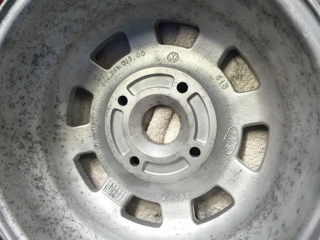

So I just found this nice set of original date stamped 1971/72 Pedrini wheels that I thought would look much better on my '74 2.0 than the Riviera's (stay tuned...will be for sale shortly). I plan on running the stock 165/80 15 tires as well.

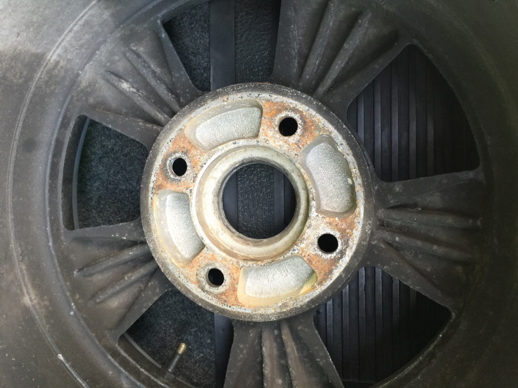

The rears bolted up fine (of course, I had to go out and buy a set of 40mm length thread bolts as the Riviera's only used 25mm length). Then, when we went to mount the fronts, we realized that the front brake disc rotors had a hub centric ring and the back of the Pedrini's had a countersunk shape (see pics below).
Any suggestions how to make these work?
(BTW, the Rears fit just fine)
Thanks
Paul
Click to view attachment Click to view attachment

You can get a machine shop to mill out that inset at the top pic in all 4 or 5 of your Pedrini wheels.
Or else sell them off to a 70-72 914 owner on here ,& look for either the Pedrini or Mahle 4-lug ("Baby Gas-burner") silver painted cast 4-lug alloys, or the Fuchs 2L anodized forged 4-lug alloys - but they should all end with -01 in the part no. for the proper hub centric mill-out from the factory.

Never mind. See one on top is the old wheel.
Dave_Darling
I know of three ways to make the .00 part number wheels work on a later car:
- Mill a recess in the back of the wheel for the centering ring on the late hub
- Mill off the centering ring from the late hub
- Change the struts and hubs (rotors) over to the early style with the pinch-bolt rather than the wedge pin ball joint
I'm not a fan of any of those, frankly. I suggest swapping the wheels out for ones that actually fit.

U can get the lug bolts from sources here and ebay. And. Real machine shop will cut the wheels for a perfect fit. Not a wheel shop from my experience. Cost me about $50 for all 4 wheels.

Eric has front rotors that I am pretty sure you can use!

I bought a pair of rotors from Eric and paid him to machine off the hubcentric rings (and press in the wheel bearings). Swapping them over took about an hour per wheel.
