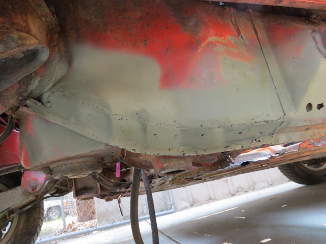

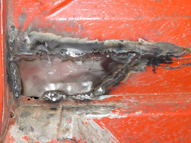

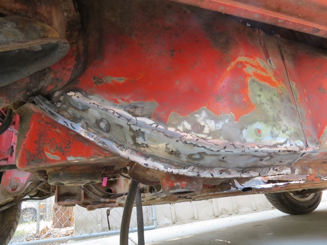

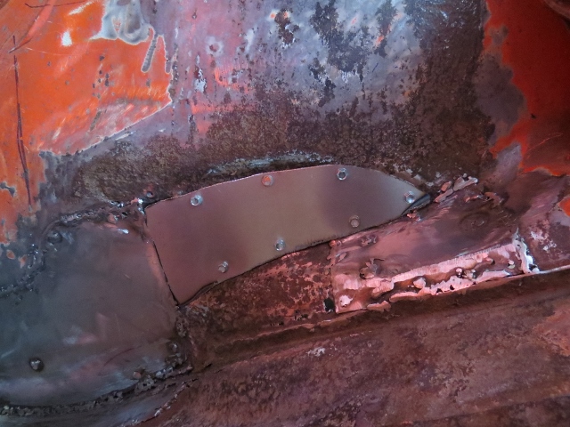

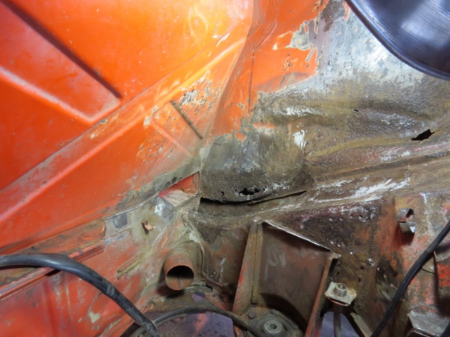

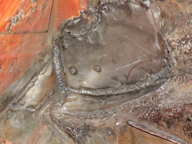

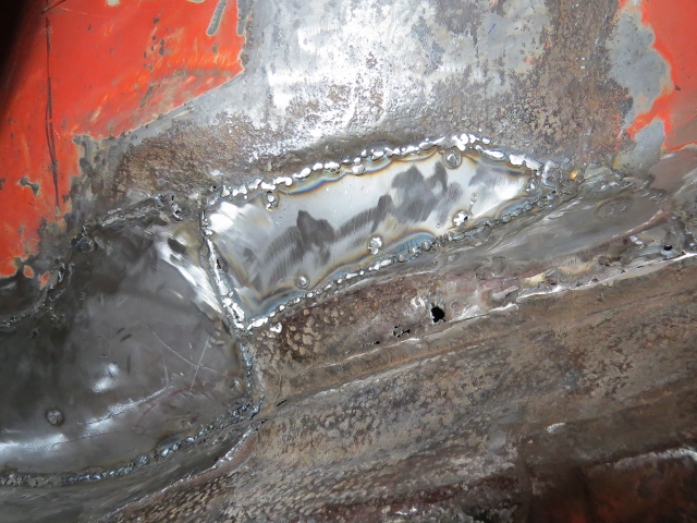

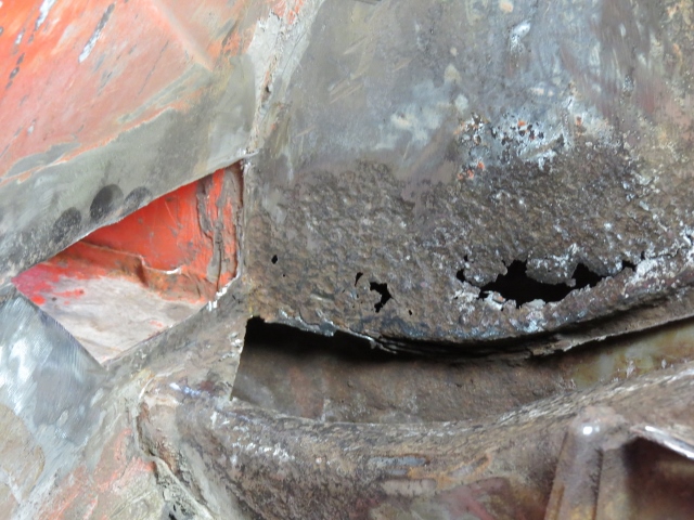

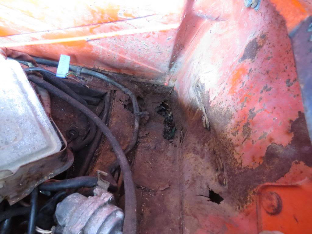

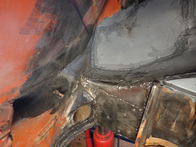

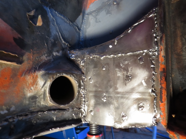

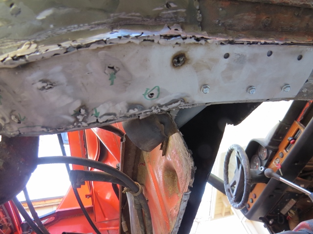

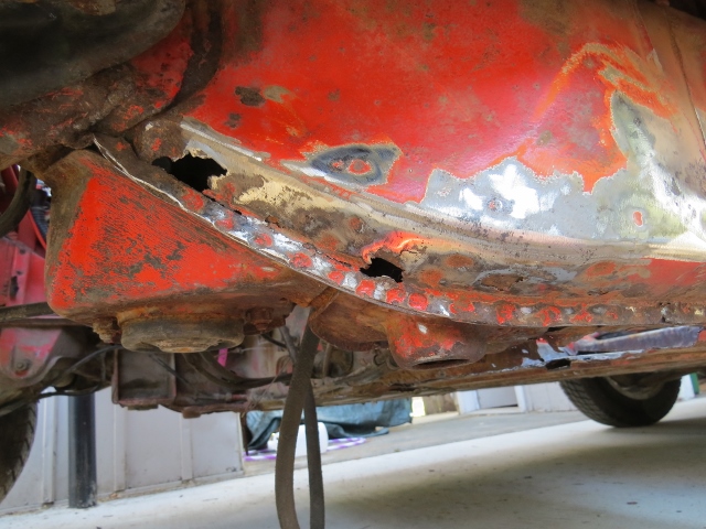

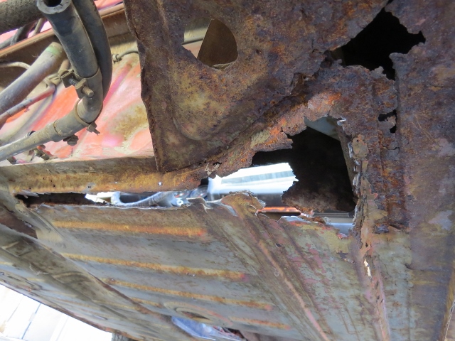

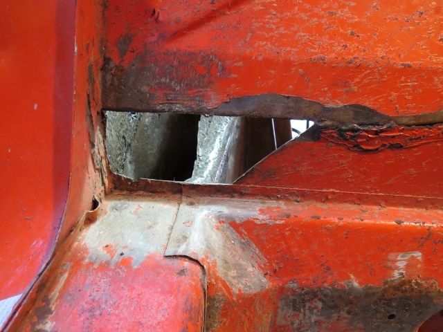

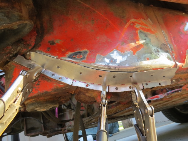

Battery Tray Area Rehab
Most people might consider this a donor car, but I have seen them restored in worse condition. Under the battery tray it had rusted through at the top and the bottom. I cut out the hole in the top and butt welded a piece in and the covered it with a second layer. So, most of it is lap welded. The rust was treated with phosphates, rust converter. I used the Eastwood Rust encapsulator, epoxy primer, and seem sealer. Eastwood makes great products and has very helpful how-to videos. A better method would have been to cut the side panel off and replace the longs.
Rodney Adkins Lyrics: If You're Goin' Through Hell
"If you're goin' through hell keep on going
Don't slow down if you're scared don't show it
You might get out before the devil even knows you're there"
Here's some good examples of repairs:
Strawman post 22
Zaney Post No. 14
Pix of mine:
(IMG:http://www.914world.com/bbs2/uploads_offsite/i1301.photobucket.com-17072-1438411946.1.jpg)
(IMG:http://www.914world.com/bbs2/uploads_offsite/i1301.photobucket.com-17072-1438411946.2.jpg)
(IMG:http://www.914world.com/bbs2/uploads_offsite/i1301.photobucket.com-17072-1438411946.3.jpg)
(IMG:http://www.914world.com/bbs2/uploads_offsite/i1301.photobucket.com-17072-1438411946.4.jpg)
(IMG:http://www.914world.com/bbs2/uploads_offsite/i1301.photobucket.com-17072-1438411946.5.jpg)
(IMG:http://www.914world.com/bbs2/uploads_offsite/i1301.photobucket.com-17072-1438411946.6.jpg)
(IMG:http://www.914world.com/bbs2/uploads_offsite/i1301.photobucket.com-17072-1438411946.7.jpg)
(IMG:http://www.914world.com/bbs2/uploads_offsite/i1301.photobucket.com-17072-1438411946.8.jpg)
(IMG:http://www.914world.com/bbs2/uploads_offsite/i1301.photobucket.com-17072-1438411946.9.jpg)
(IMG:http://www.914world.com/bbs2/uploads_offsite/i1301.photobucket.com-17072-1438411946.10.jpg)
(IMG:http://www.914world.com/bbs2/uploads_offsite/i1301.photobucket.com-17072-1438411946.11.jpg)
(IMG:http://www.914world.com/bbs2/uploads_offsite/i1301.photobucket.com-17072-1438411946.12.jpg)
(IMG:http://www.914world.com/bbs2/uploads_offsite/i1301.photobucket.com-17072-1438411946.13.jpg)
First layer underneath
(IMG:http://www.914world.com/bbs2/uploads_offsite/i1301.photobucket.com-17072-1438411946.14.jpg)
2nd Layer sleeved for added strength. No finesse here.
(IMG:http://www.914world.com/bbs2/uploads_offsite/i1301.photobucket.com-17072-1438411946.15.jpg)
Car was not jacked up during repairs.
(IMG:http://www.914world.com/bbs2/uploads_offsite/i1301.photobucket.com-17072-1438411946.16.jpg)
(IMG:http://www.914world.com/bbs2/uploads_offsite/i1301.photobucket.com-17072-1438411946.17.jpg)
(IMG:http://www.914world.com/bbs2/uploads_offsite/i1301.photobucket.com-17072-1438411947.18.jpg)
Well I hope it holds together. Another reason for 2.5 NA power rather than a big six.
