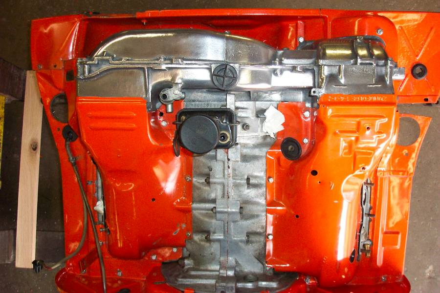

Speaking of cleaning engine tin, hers's a pic of our spare motor ready to go in my car will I do a 2056 build. I did a little clean up. (IMG:http://www.914world.com/bbs2/html/emoticons/biggrin.gif)

Where is your rod for the cooling flaps?

Cooling flaps were long gone from this motor, along with thermostat, wire, and pully. It's a spare. I don't worry about it much.
