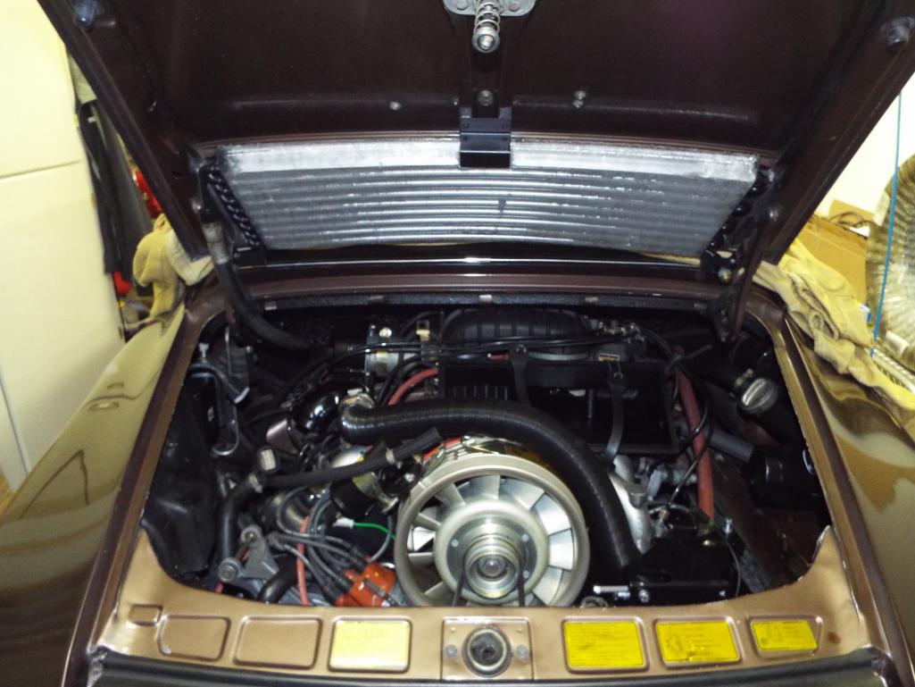

QUOTE(forrestkhaag @ Dec 4 2016, 10:07 AM) *
At your convenience, can you post a picture of the access port open to see the engine front / and loosely describe your cover's dimensions? I have built a cover from doner firewall but want to confirm that I will be able to get at everything necessary in the engine bay with my dimensions. Thanks and nice work.
Forestkhaag,
I was recently in touch with the previous owner (Moparrob)and let him know about the thread and progress on World. If you look closely you will see my last post was actually a year ago almost to the day. By responding, Moparrob resurrected the thread with his kind words on the work I have completed. Unfortunately life got in the way a year ago and I had to sideline the project and put it in my trailer. In the trailer I cannot actually get to anything so I am sorry I cannot furnish picture or dimensions at this time. When I get it back out, and I am thinking in just a couple of months, I will provide the picture and info you have requested. Hopefully that will still suit your time frame needs. All the best on you project!

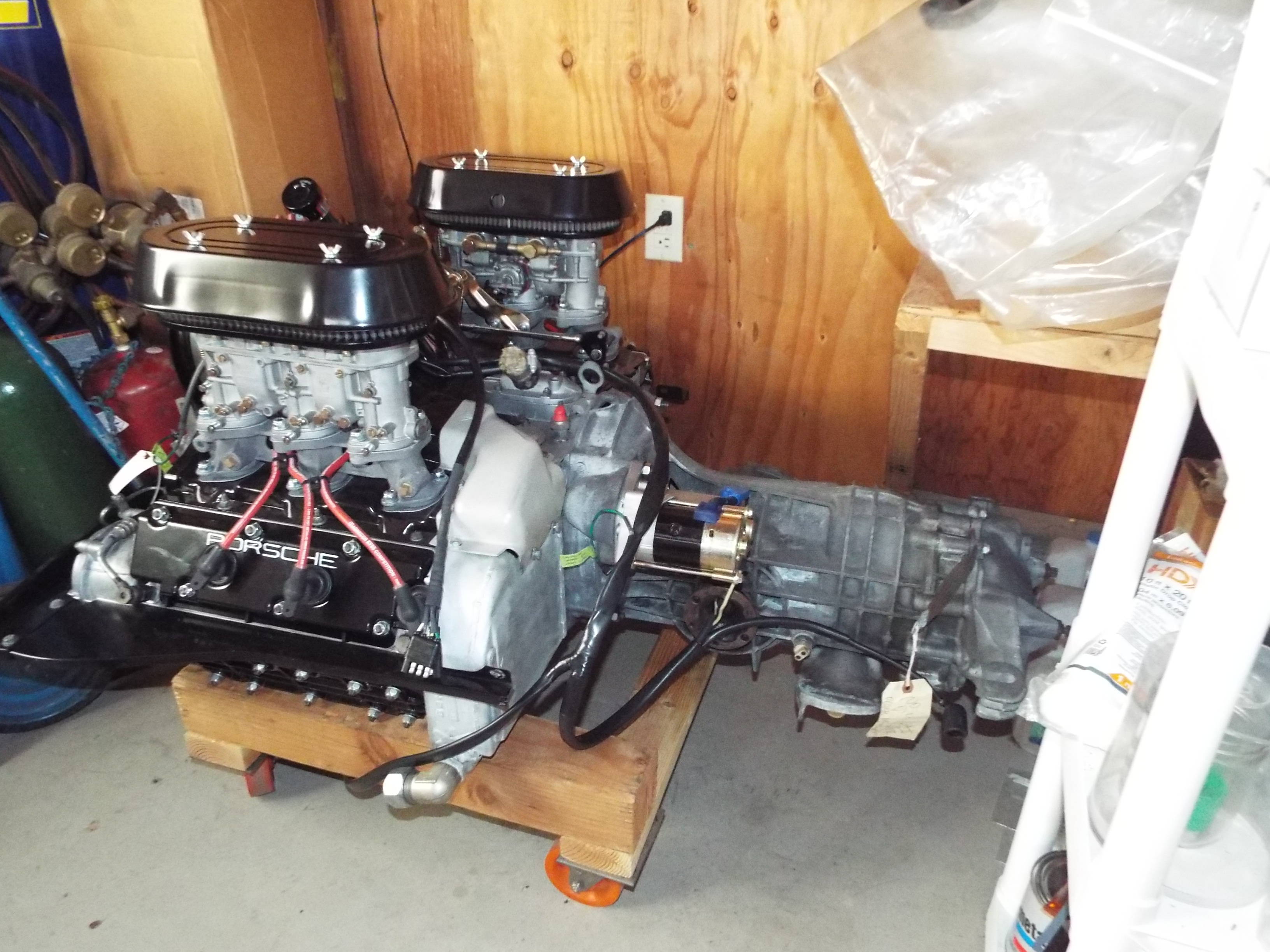

Recap, I bought this “work in progress project” with some good stuff already completed and a lot of brand new parts to work with. To top that off this 1974 is an amazingly solid GT conversion with genuine Porsche PN metal flares on a car that did NOT need paint when I got it!! Yes that is correct and this paint job is over 20 years old! It also came with a ’79 3.0 big port six, that to my understanding, “was ready to go”. Hence my handle Lucky9146 for this amazing find after a very long search. This is how it looks today but still not complete.
I had mated the trans to the engine a while back and really had planned to install it as basically the next major phase. However I had a chance to chat with the PO moparrob earlier this year about the car, and although he had dressed the engine with a pair of Weber 40’s, 914-6 powder coated sheet metal, turbo valve covers etc. to where it looked fantastic, he expressed some reservations about the engine itself. Dang. Turns out we really did not know the history.
And…. In addition I also learned that CIS pistons and CIS cams were NOT that great of a setup with Webers. Soooo….. what next took me quite a bit of time was contemplating and researching what to do.
All this all led to my decision to tear down the engine and go through it. My second 3.0 build, so at least I had done one.. It sure looked ready to go!

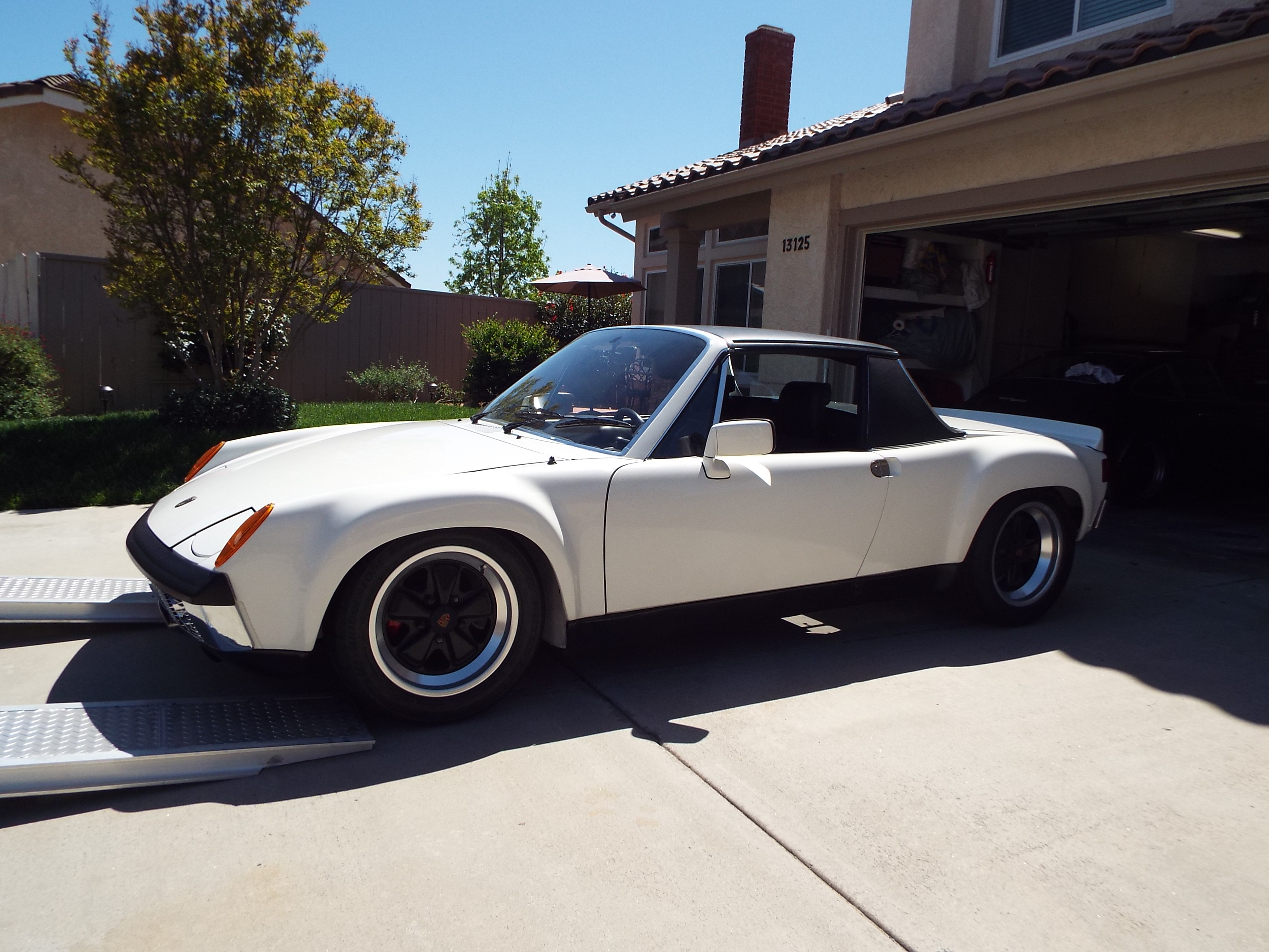

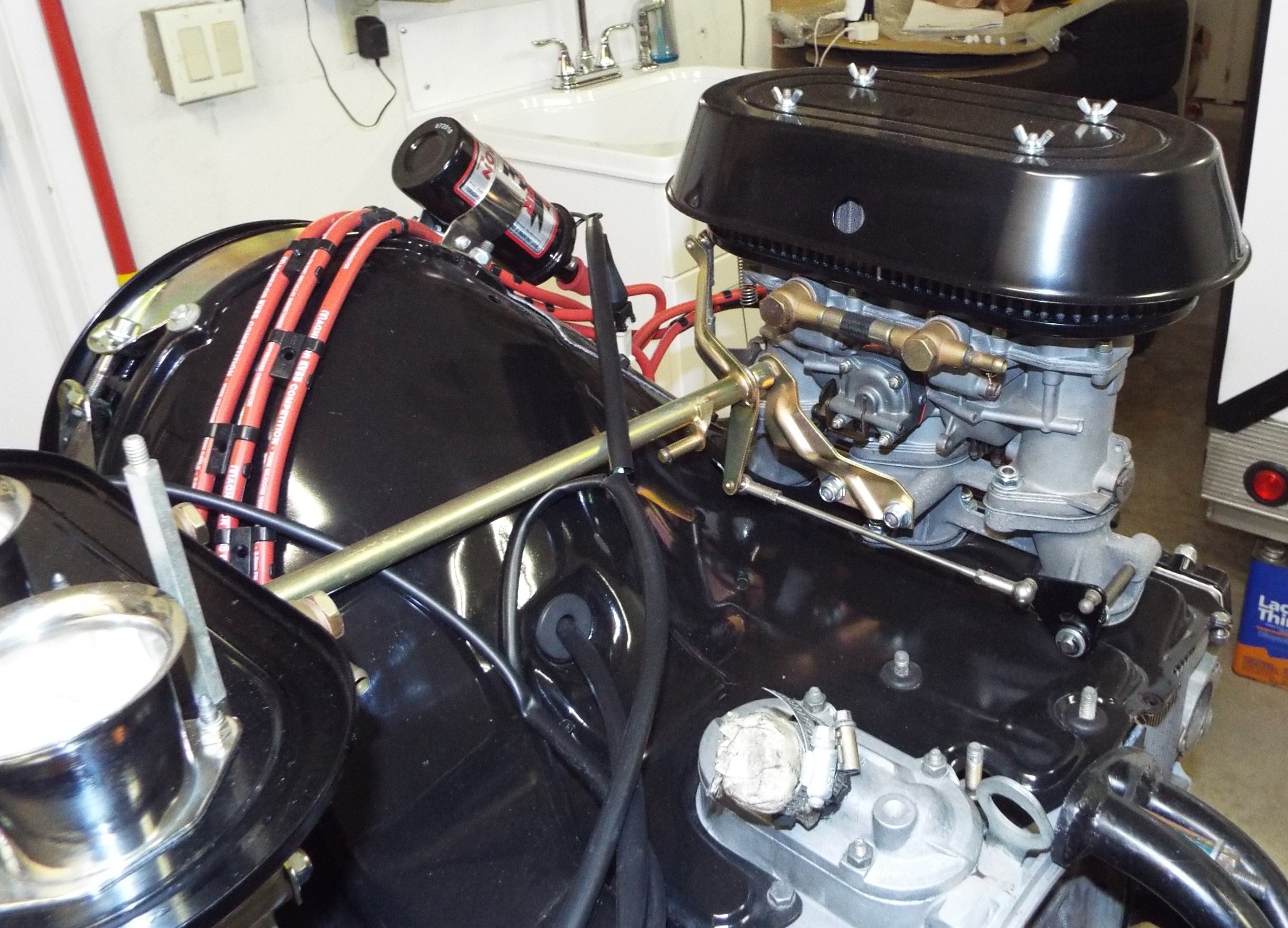

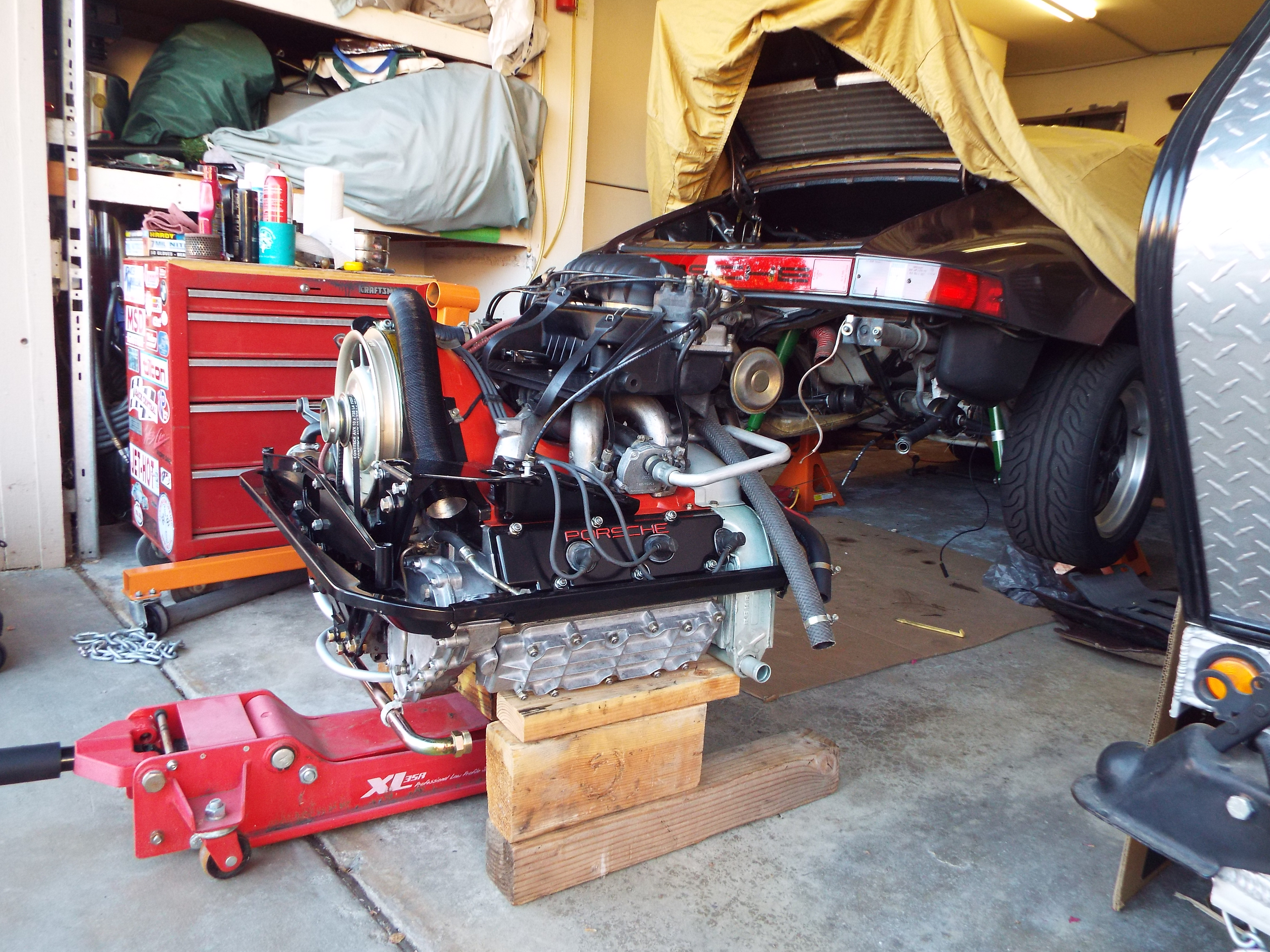

I had recently (like May – Aug 2016) rebuilt the 3.0 CIS for my then newly acquired ‘78 SC and that really is a good part of the reason my 914 project got “back burnered”.
Save all the tail dragger comments it is a blast to drive! And I got a smoking deal.

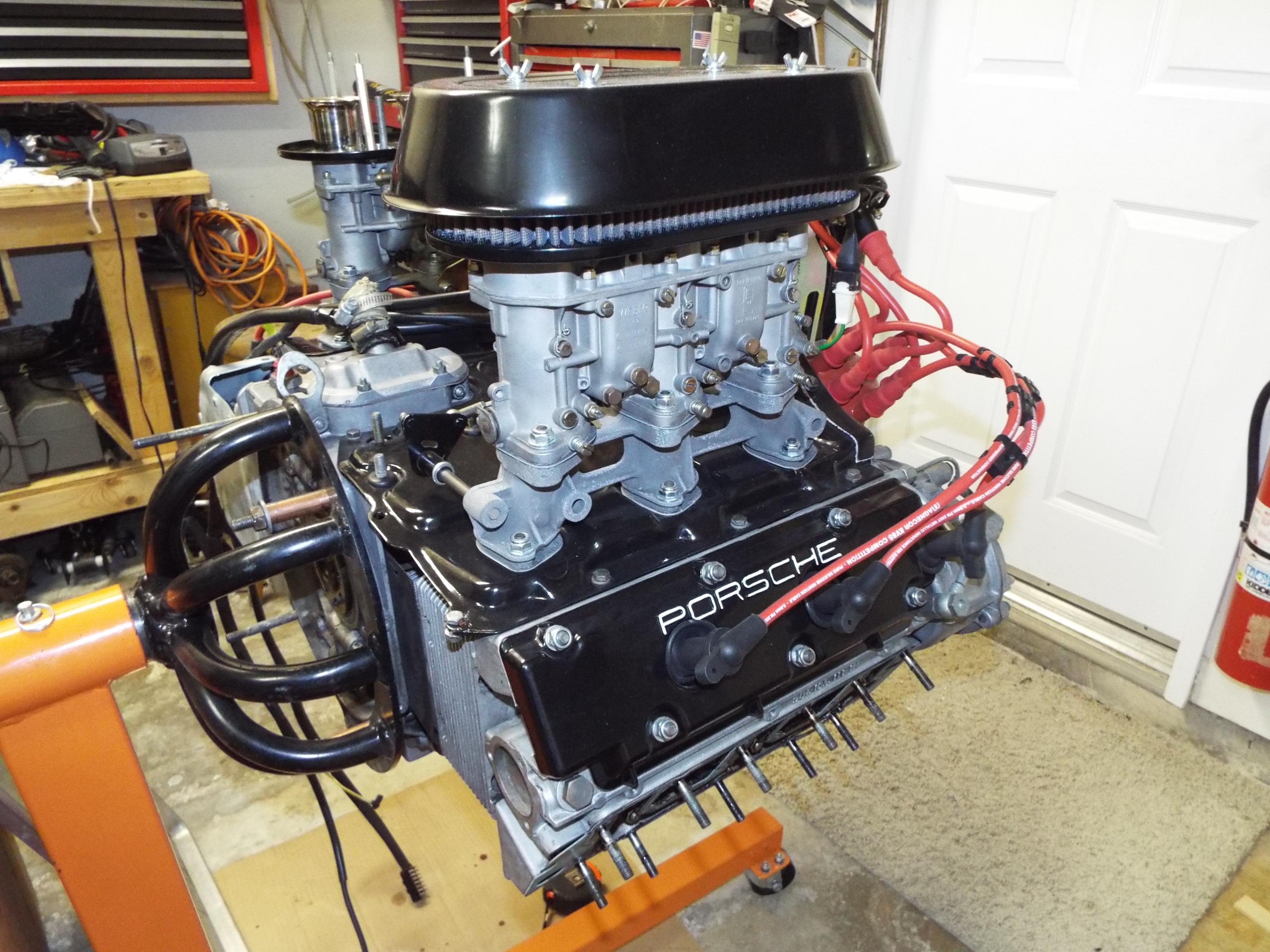

This is the 3.0 CIS going in.
Lucky9146
post Aug 15 2017, 07:19 PM
Post #110
Posts: 1,711
Joined: 22-September 14
From: Poway California
Member No.: 17,942
And Installed. Such a sweet running motor!
Lucky9146

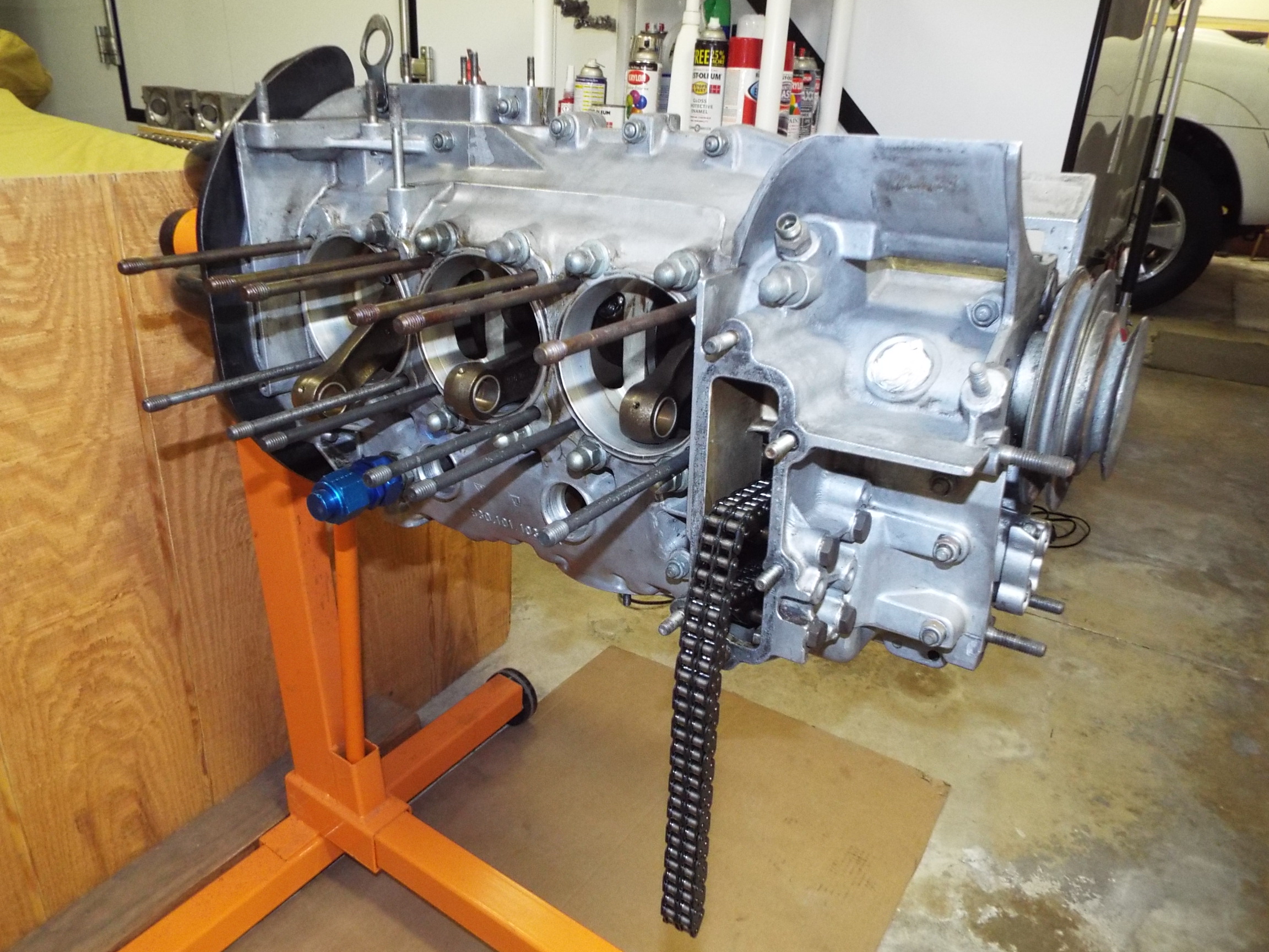

So up on the engine stand the tear down begins and the discovery process.
Lucky9146
post Aug 15 2017, 07:42 PM
Post #112
Posts: 1,711
Member No.: 17,942

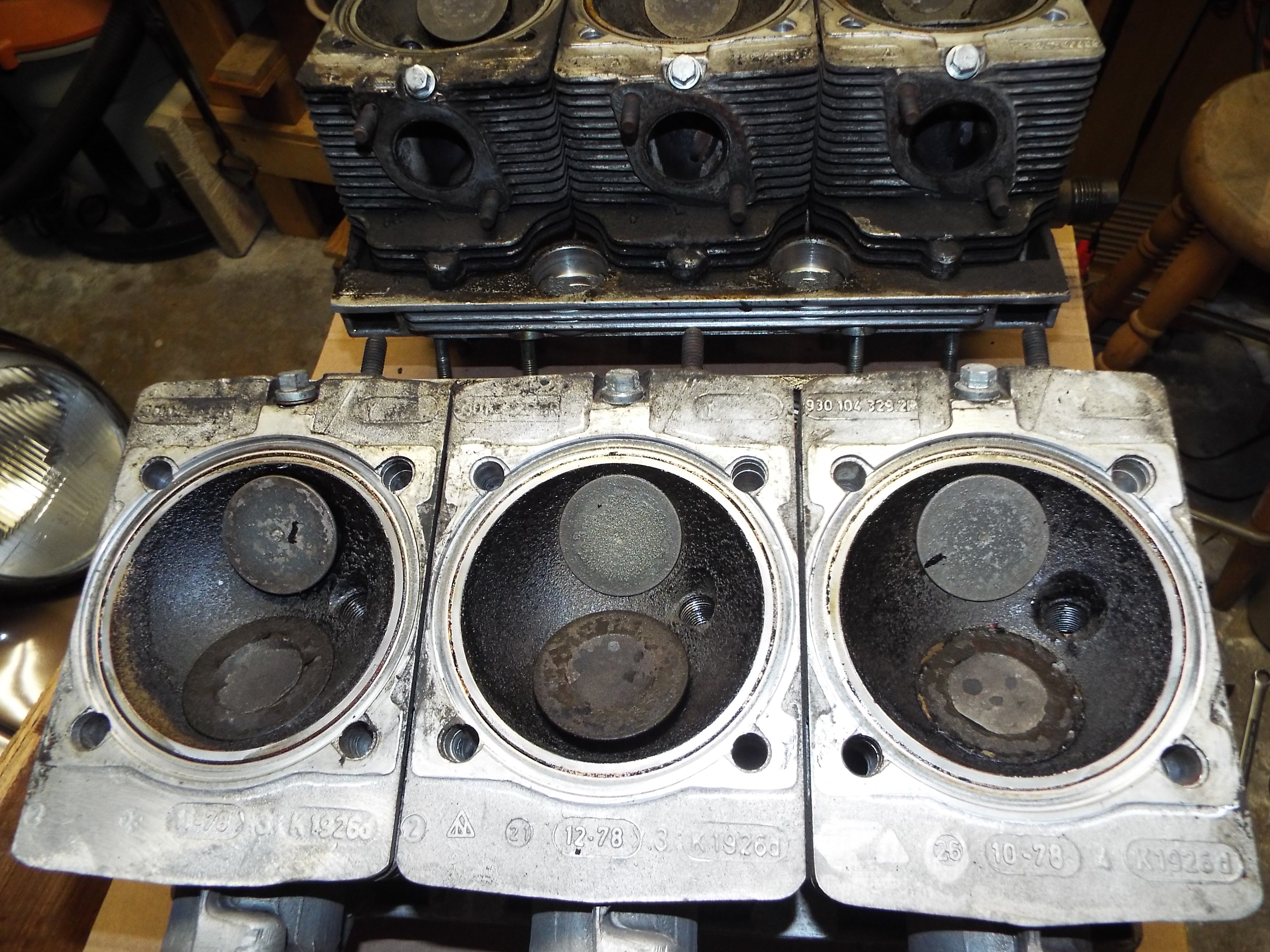

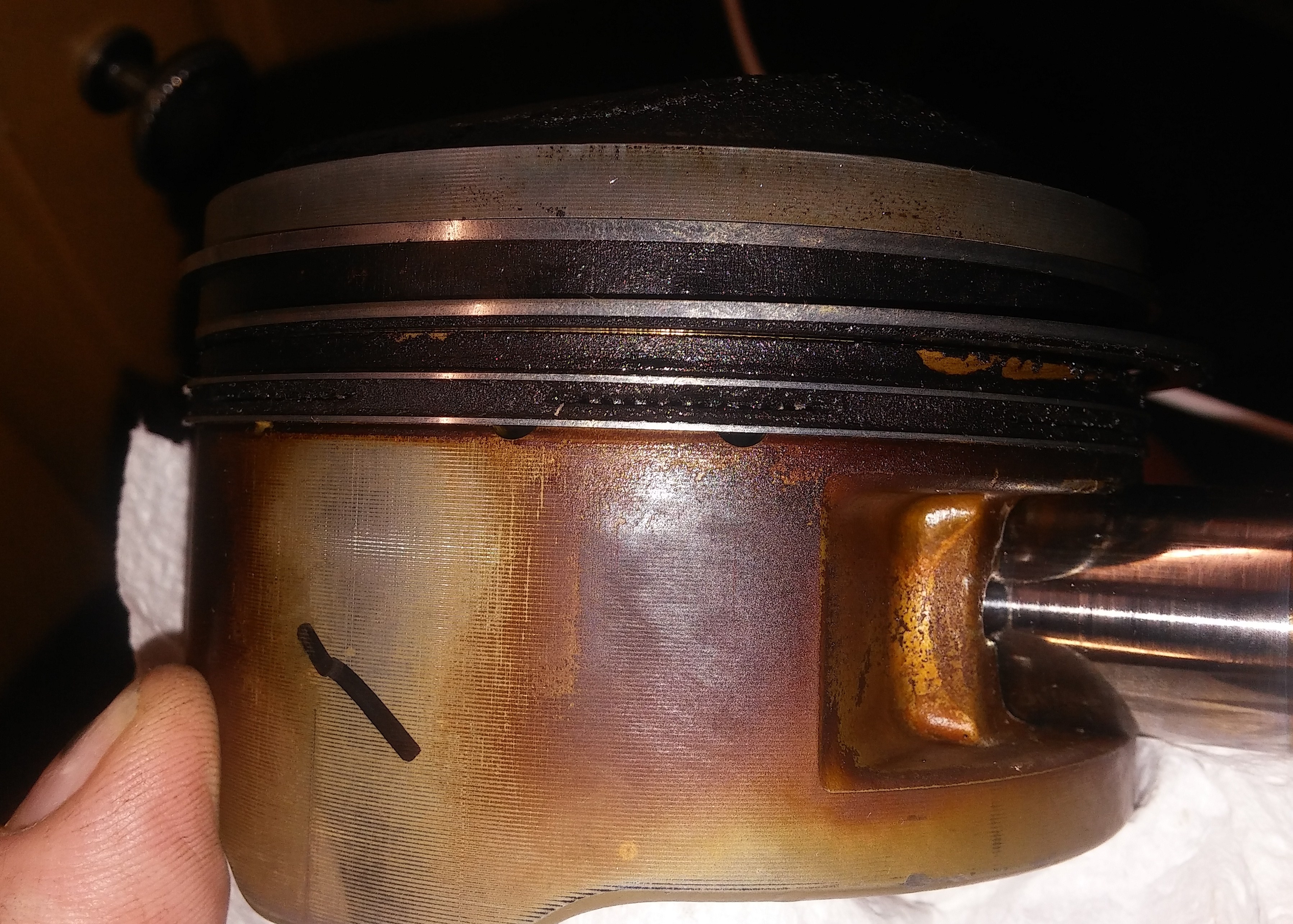

Turns out it was a good decision to get into this engine because there was major carbon that went down the piston skirts and clogging the rings. The Cylinders and heads were not the greatest looking either. Appears not to have been all that well maintained and it apparently had sat for several years and at least the 6 years I know of causing other problems.
Inside seemed to be a caramel color, like the pistons shown, from maybe burnt oil?
Can’t blame the PO too much he got it from a guy who bought it from a reputable source but ya how that goes………….

More of the caramel color inside like the pistons...

Good move,oil burning indicated on the pistons and lack of oil changes has caused the caramel colour in the chain cases .
Great to see you back on the job (IMG:style_emoticons/default/beer.gif) .

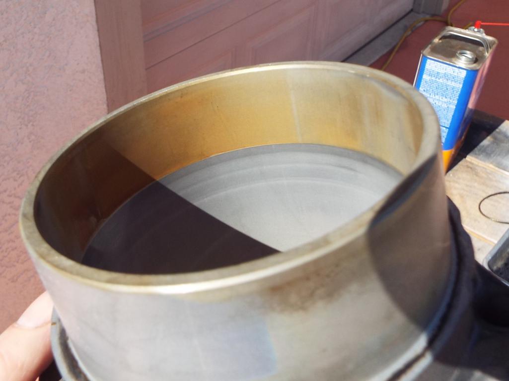

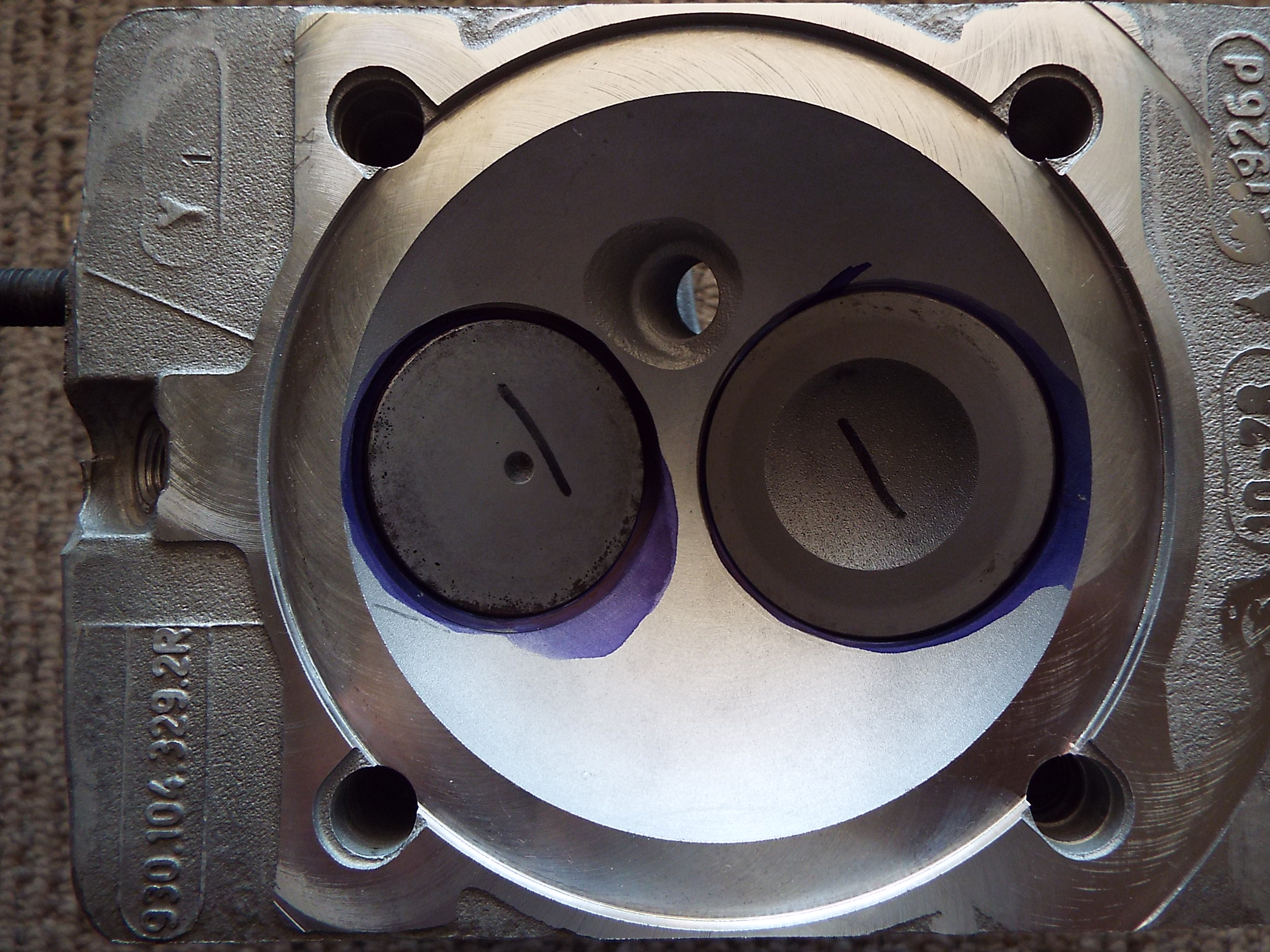

Continuing with the tear down process here is a cylinder....
Comparing these cylnders with the SC (mentioned earlier) that I rebuilt, this cylinder looked much worse. On my SC I could still see the hone marks and it had 100k miles on it! Not so here.
These did not look like good candidates for a hone job as I was considering new pistons to get away from SC pistons.

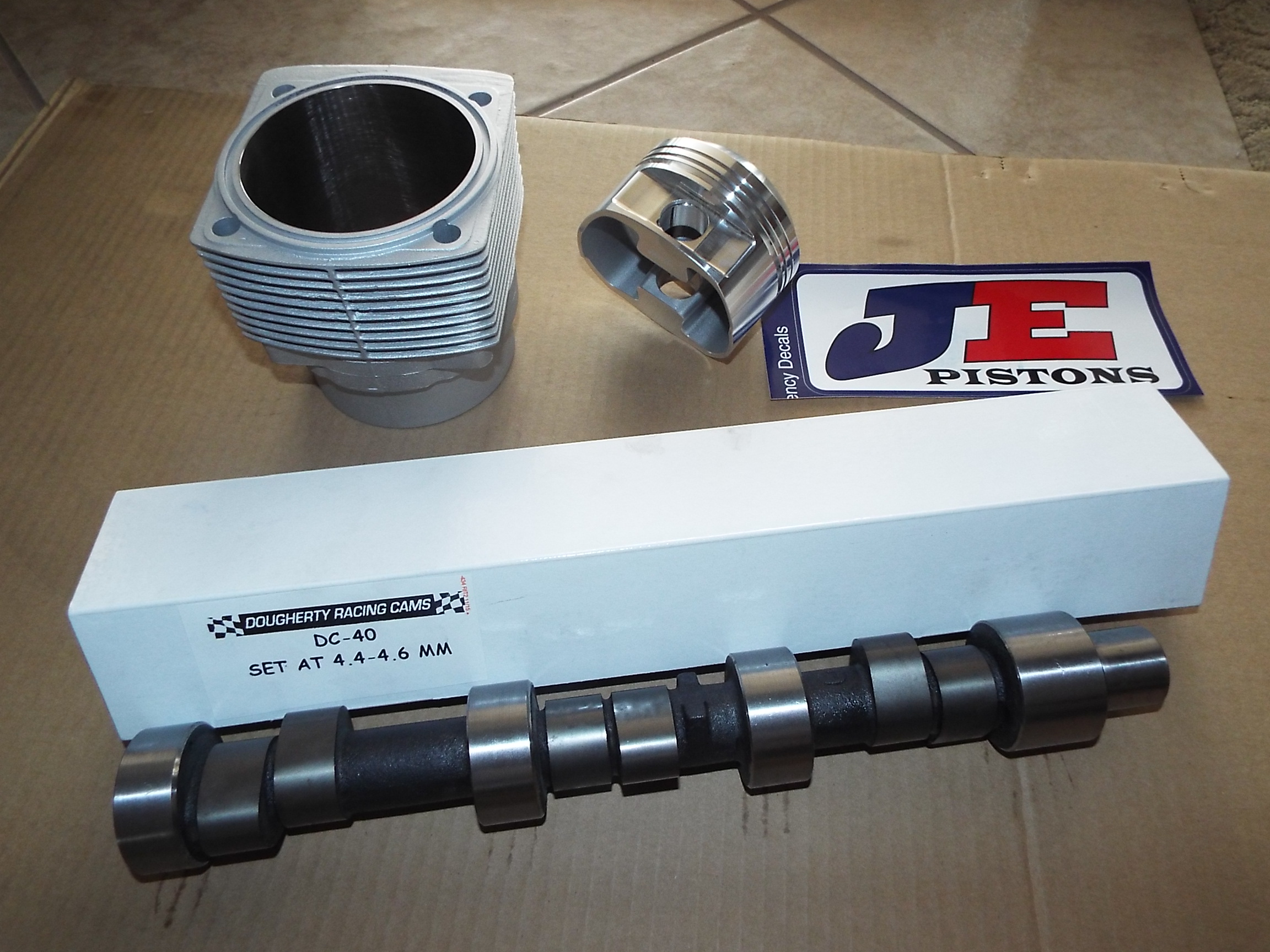

So all my research led to the following decisions. Cams and pistons is what really took me the time figure out. then of course lead times for valve job and cylinder work.
Dougherty DE40 Cams
Re-Nikosil the cylinders
JE 9.5-1 Pistons almost too nice to hide in an engine!
Top notch valve job from one of the best in San Diego

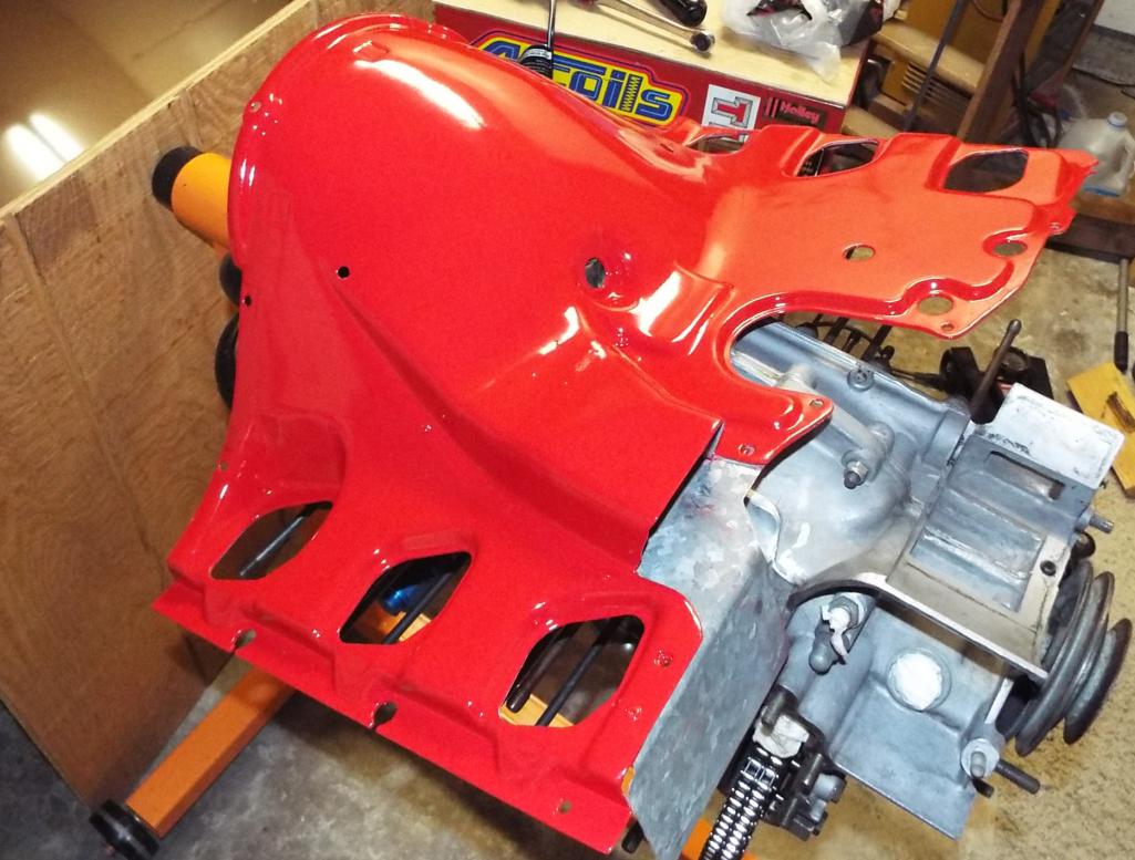

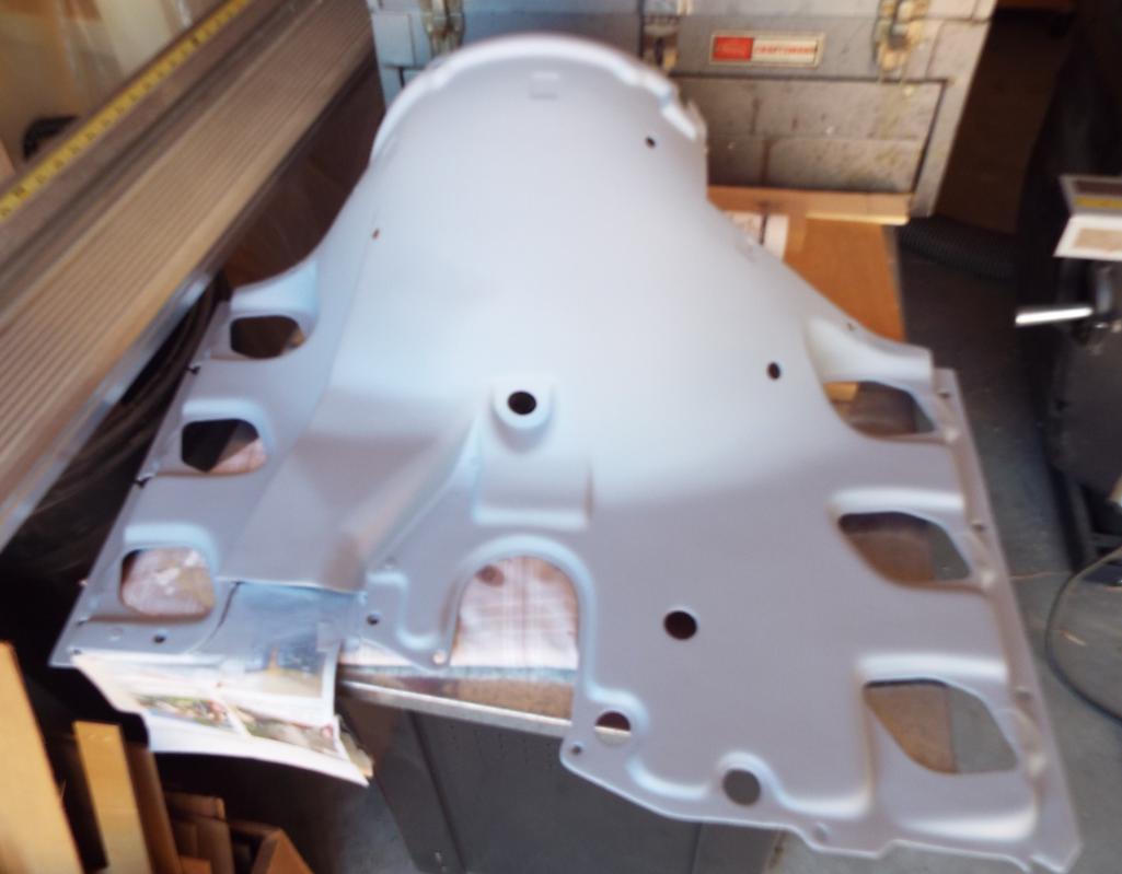

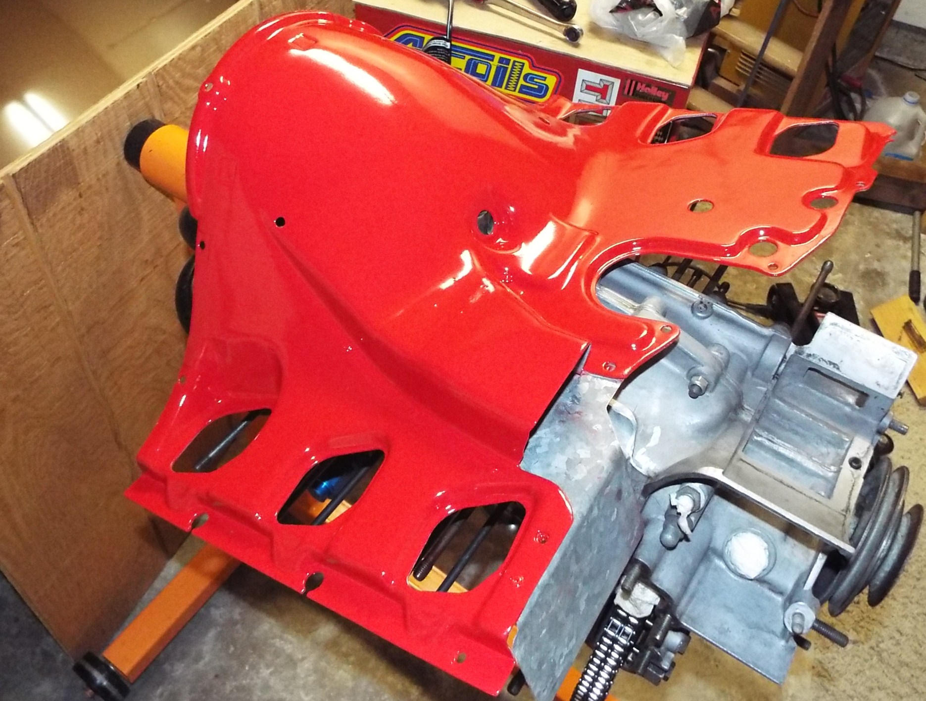

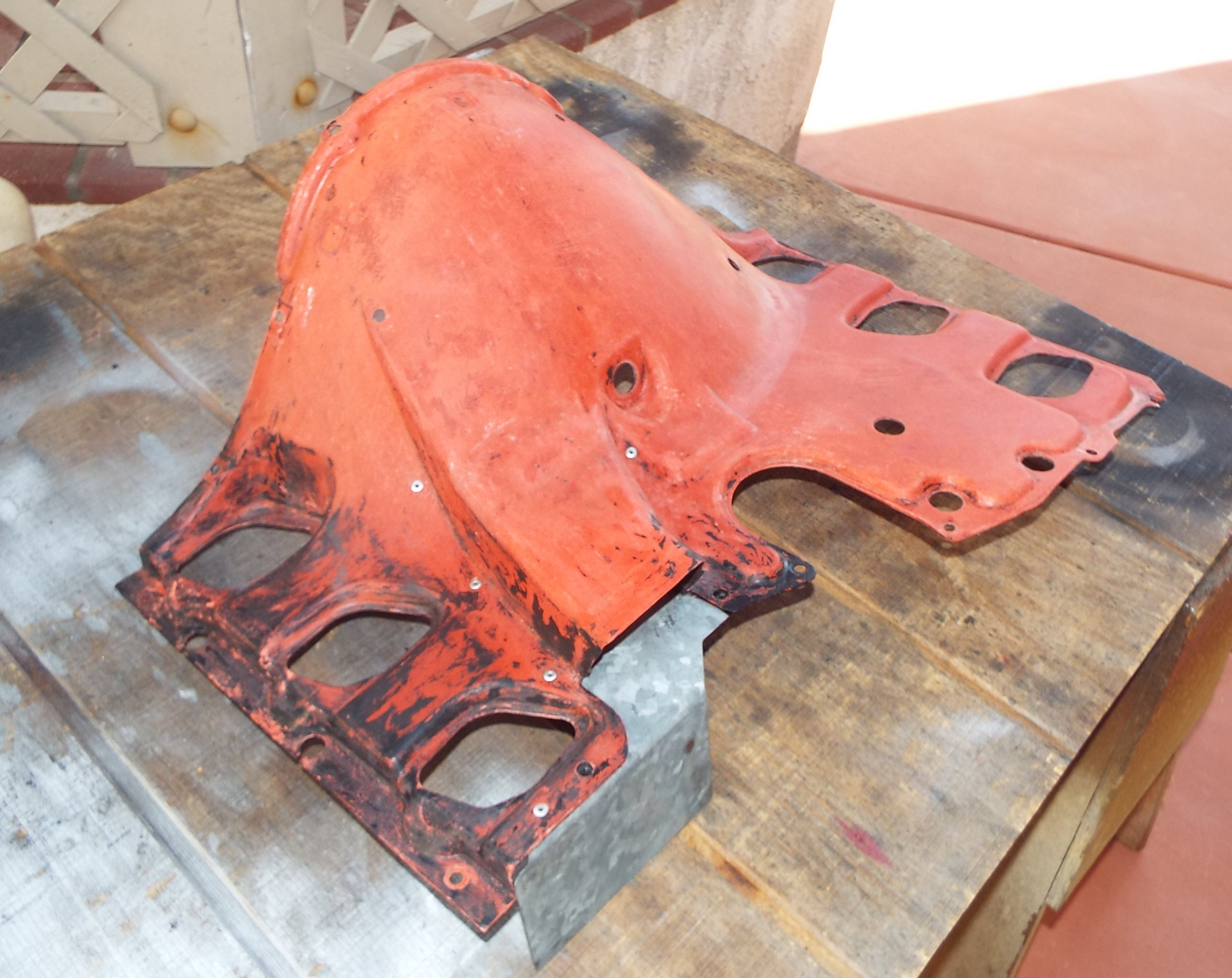

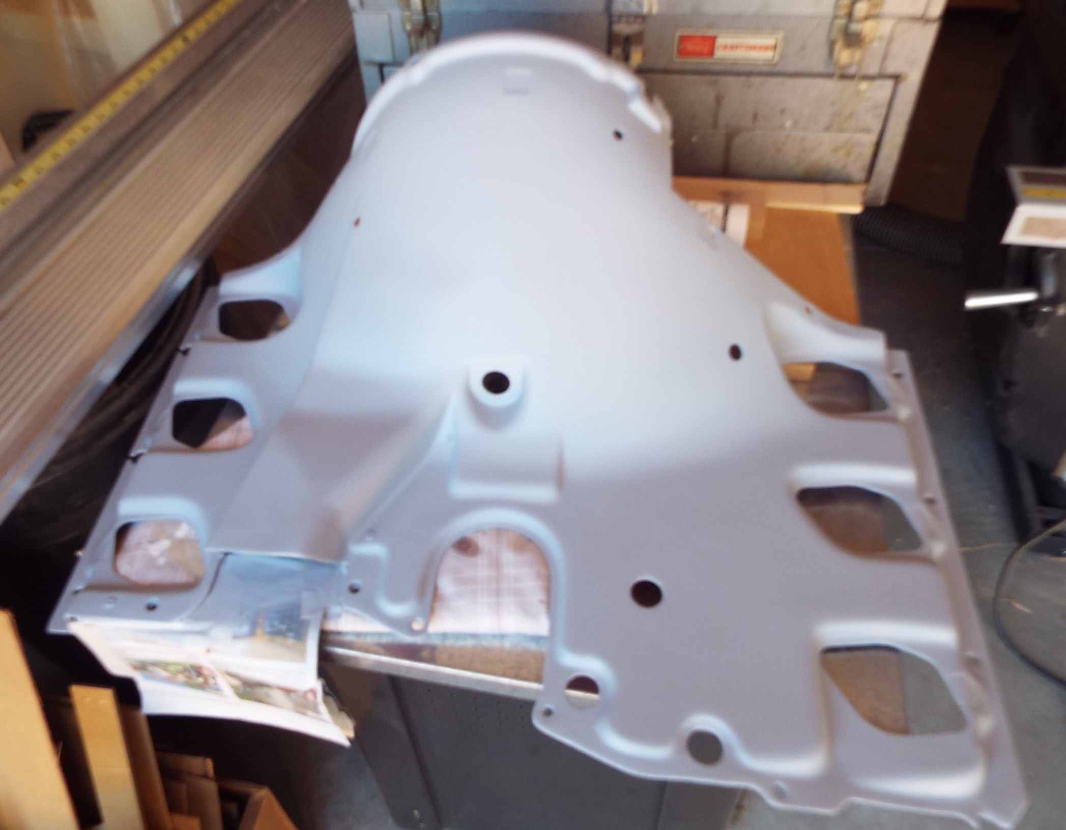

One fun project that I thought I could knock out of the way fairly quickly was the engine cooling shroud. PO had painted the original red one black and it was a nice shiny paint job and all but I just thought the engine being all black with black rain hats, black valve covers, and black shroud would be lost in the hell hole and I wanted it red.
I first wrongly thought that I could just strip the shroud down to the fiberglass original red and that would be good. Big! Big! mistake because not thinking, I used paint stripper, and it got into the fibers and I just couldn't get all the black off! What a mess!
Now I HAVE to paint it again and so I contacted moparrob to find out what he painted it with because the black was pretty nice and amazingly he he still had the can of black Rustoleum For Plastic that he used and shot me a pic. Try to find red Rustoleum For Plastic locally in CA. Nope! Ended up buying from Summit Racing. I must have sprayed and sanded and then primed and sprayed and wet sanded #600 at least 8 times because the paint just kept krinkling up.
So after I had tried several things with no luck I finally ended up calling Rustoleum and amazingly enough they are actually quite helpful. Suggested Rustoleum Professional Primer which can be found locally but the Rustoleum Automotive Line Acrylic Enamel Gloss red #248642 they recommended as their top of the line was another tough one and had to order. I highly recommend this paint. A couple of good coats of this and you're good.
At one point I almost started to look for another shroud but ended up saving this one and it came out great just took a lot of extra work. And sanding.......
