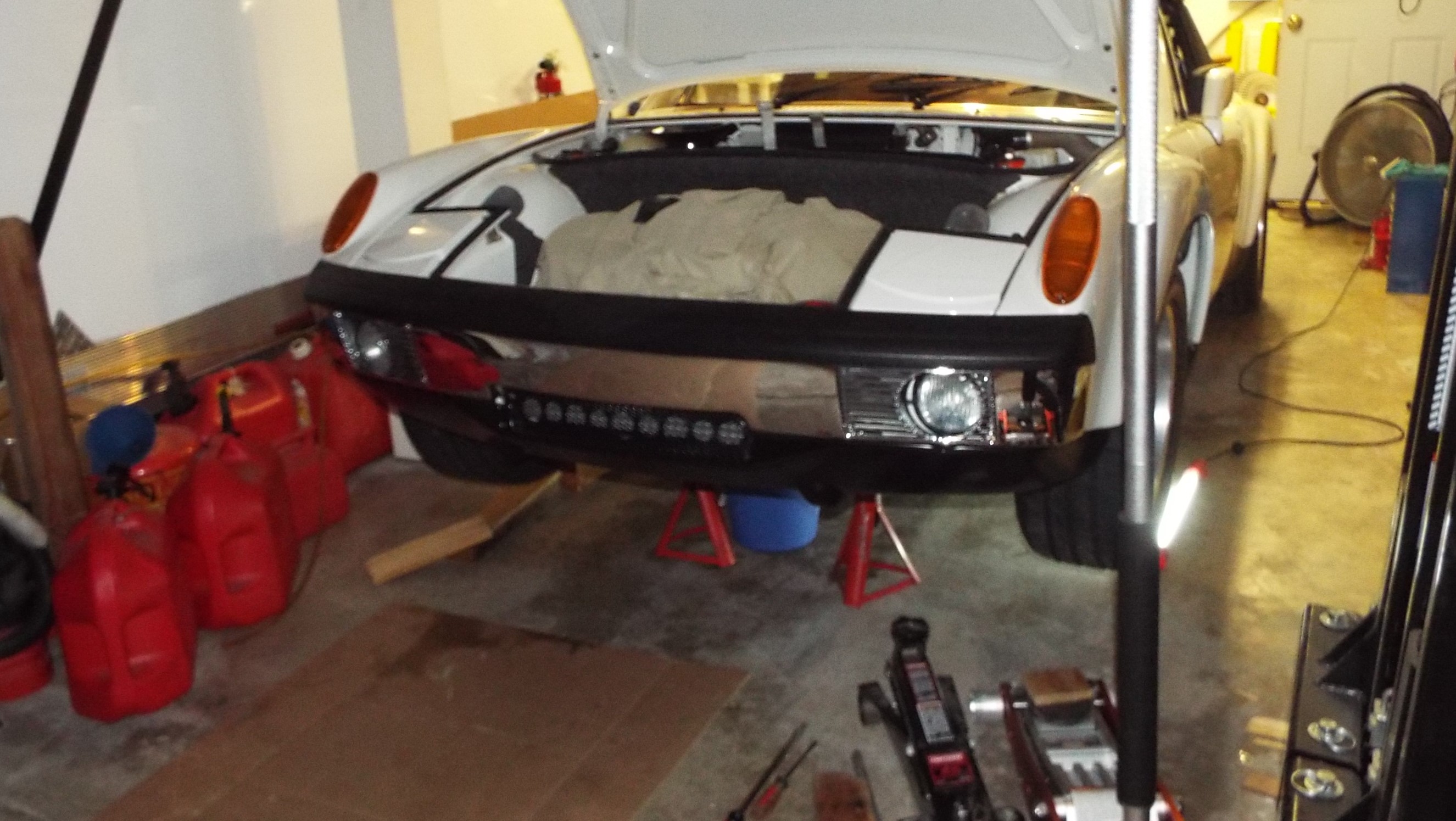

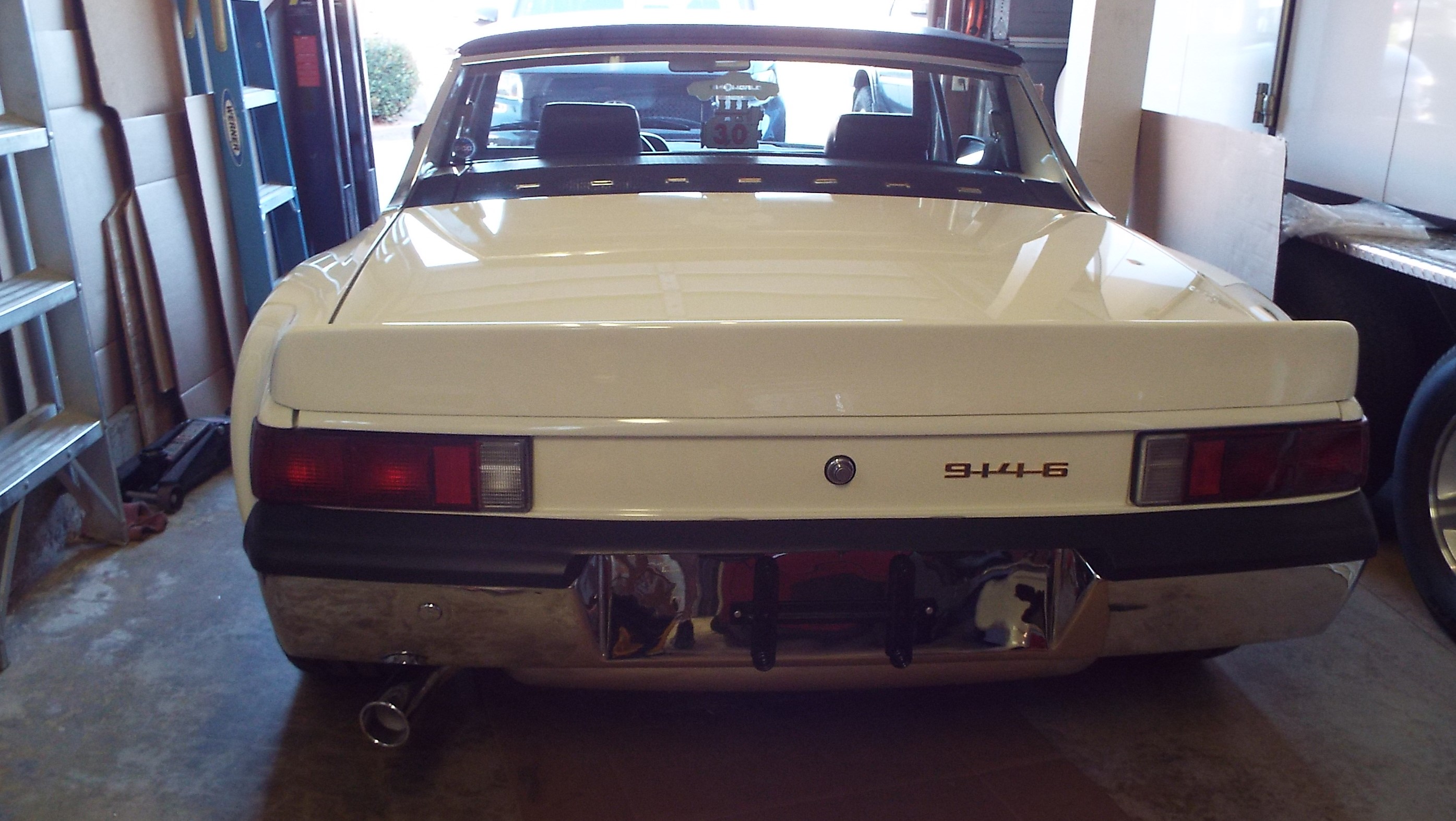

Bought This car in Nov 2013 and unfortunately it had to sit in my trailer until May of this year to get started on it. The picture is how the car looked the way I got it and how it came out of the trailer. Factory P/N steel flares, nice paint job, a not installed 3.0 close to ready to install, Oh, and an in process conversion. Just some cleaning and put it together and yes a lot of learning/ research. Because (a) I have never owned a 914. (b) never done an engine conversion (built a few). © never picked up where someone left off (you know how its easier to put something back together when you take it apart).
I got the "bug" from a friend who took me up the Ortega Hwy in his 6 conversion and I was hooked.
I decided to share my experiences with the "world" and hopefully along the way gain some insight. I have met some great 914 folks so far at swap meets and parts houses and everyone has been quite helpful. I will tell more of the story of what came with the car and what I have done so far as the days go by. Check in once in a while.

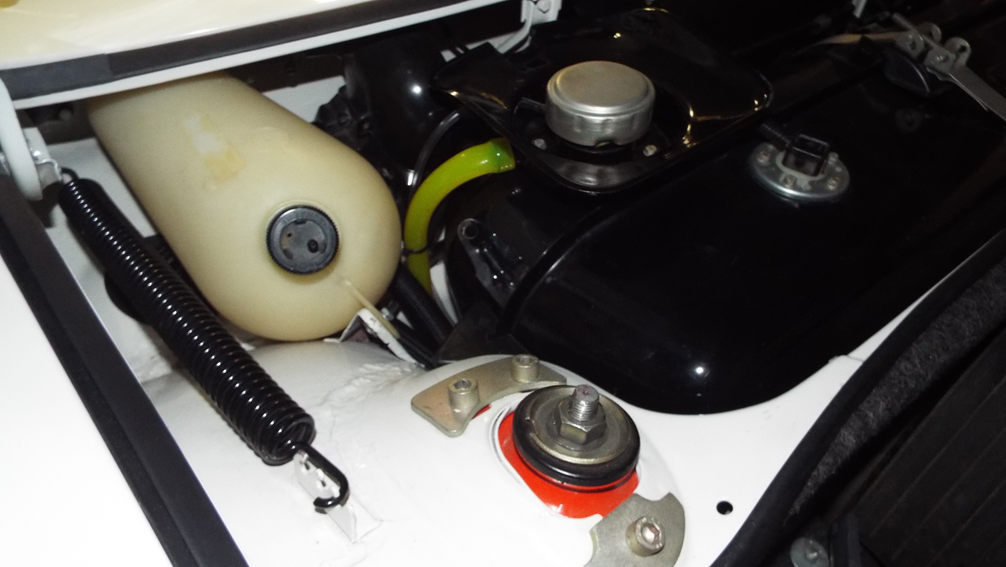

Lucky9146   This car came with some really nice parts! So...   Aug 4 2015, 04:52 PM

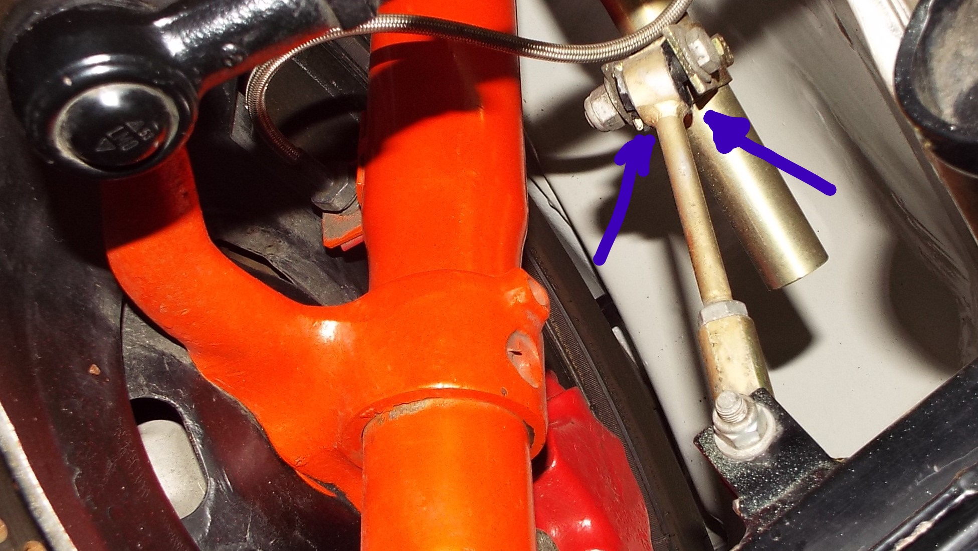

rhodyguy   the shift rod bushing looks a little spent.   Aug 5 2015, 07:25 AM
Lucky9146   the shift rod bushing looks a little spent. Lik...   Aug 5 2015, 09:51 AM

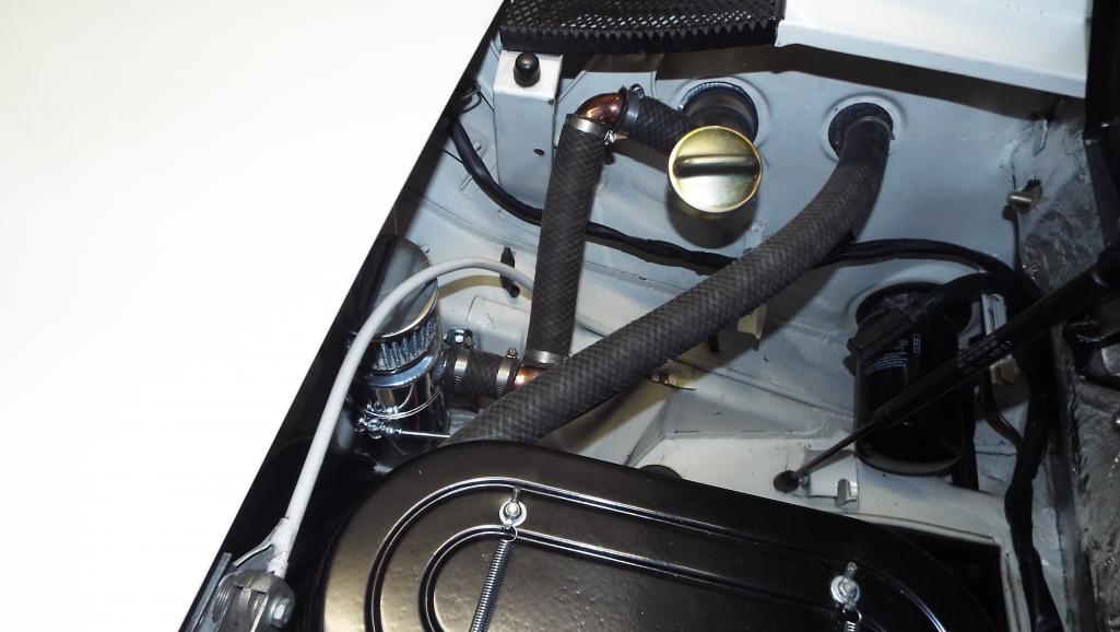

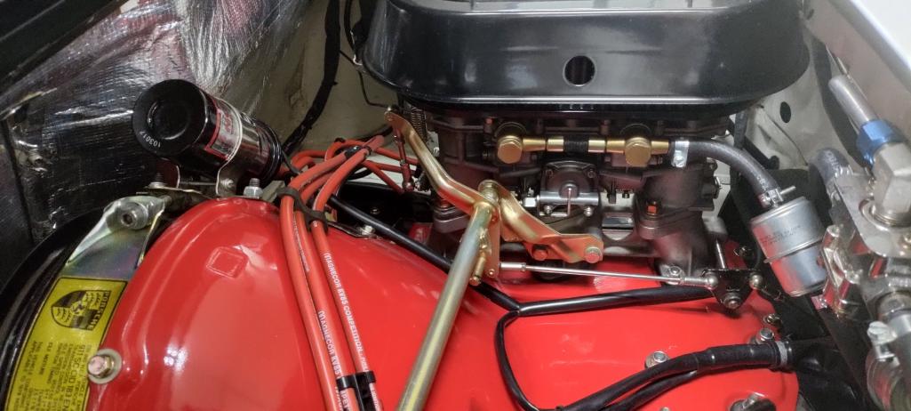

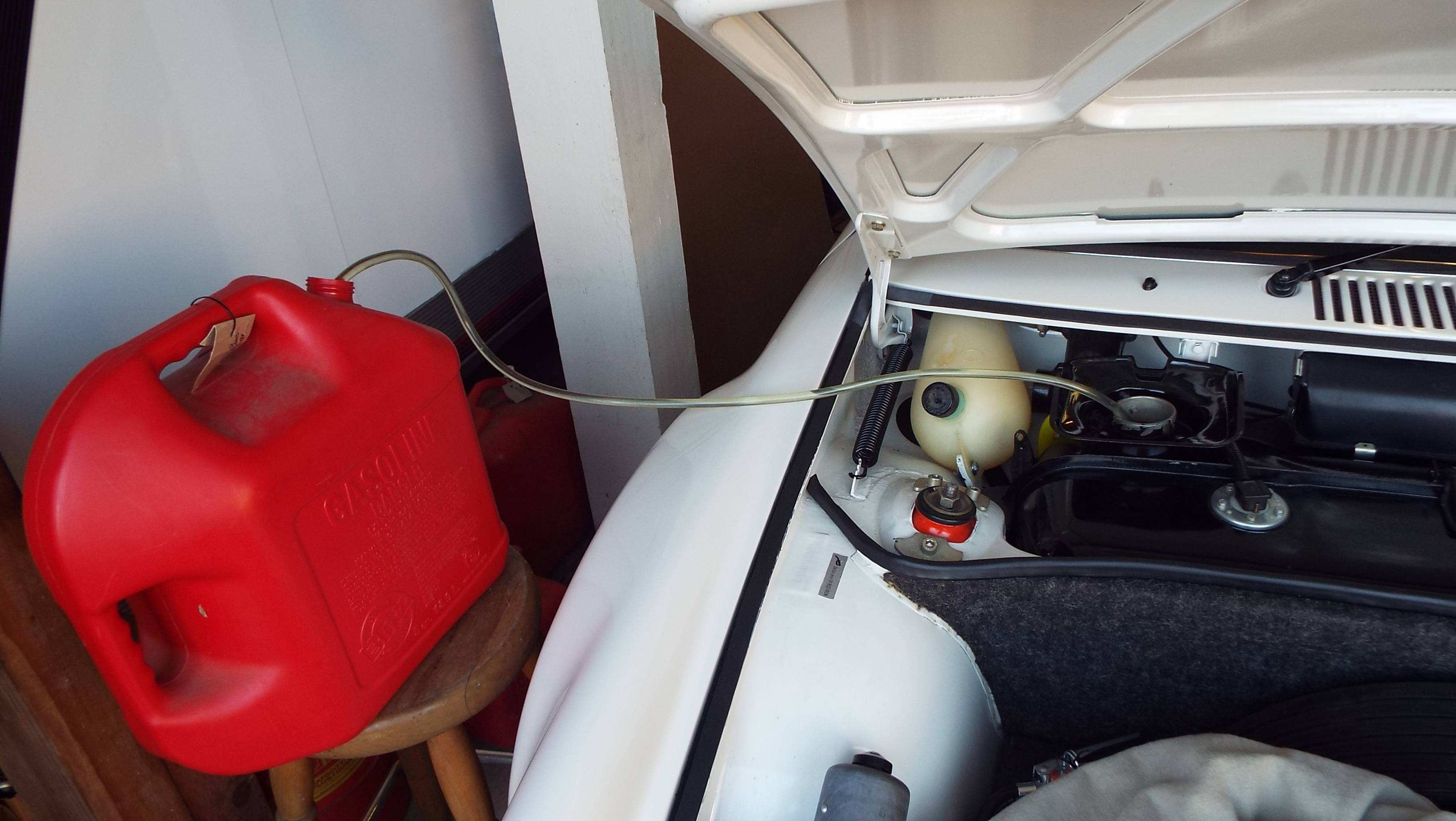

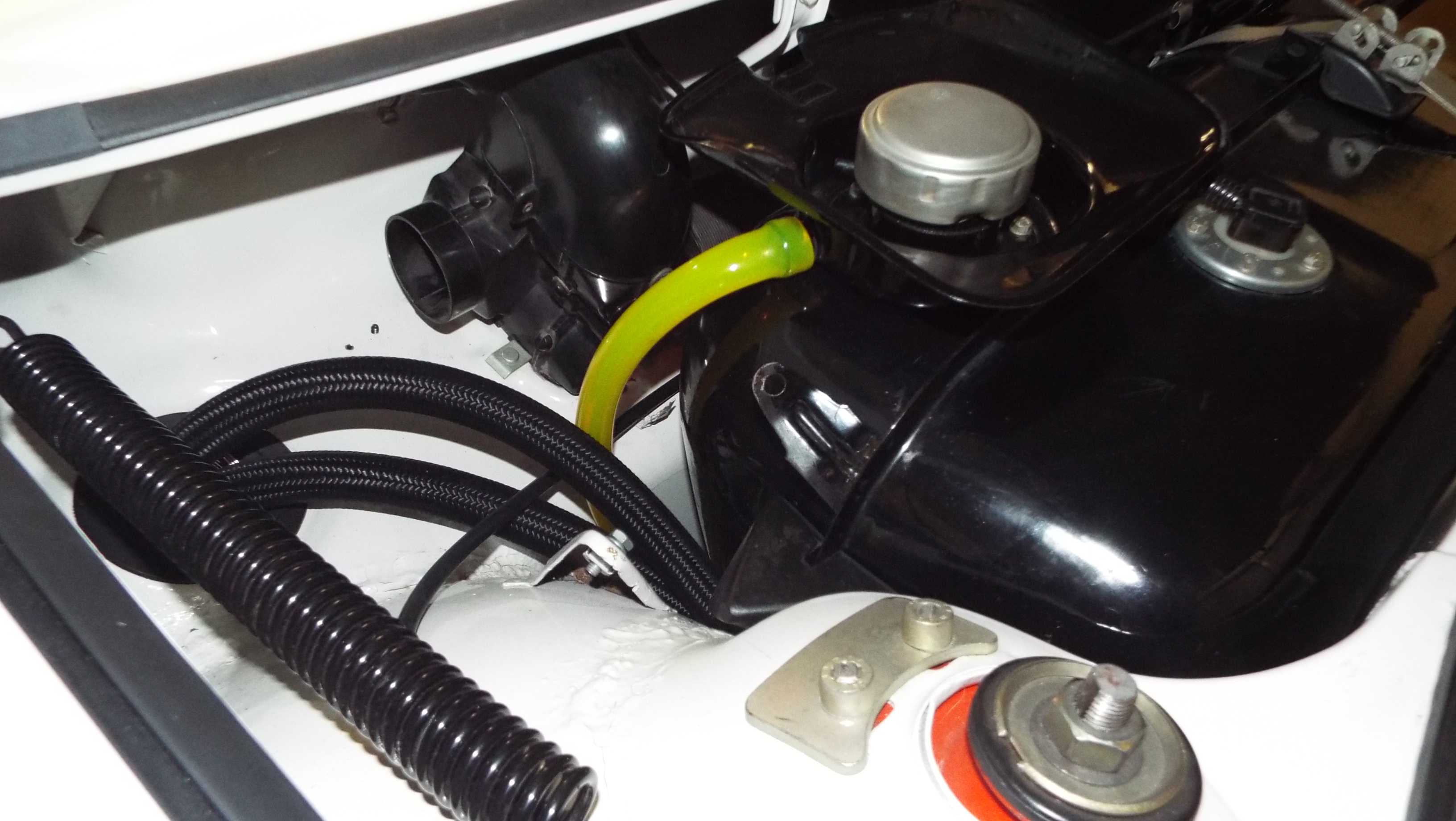

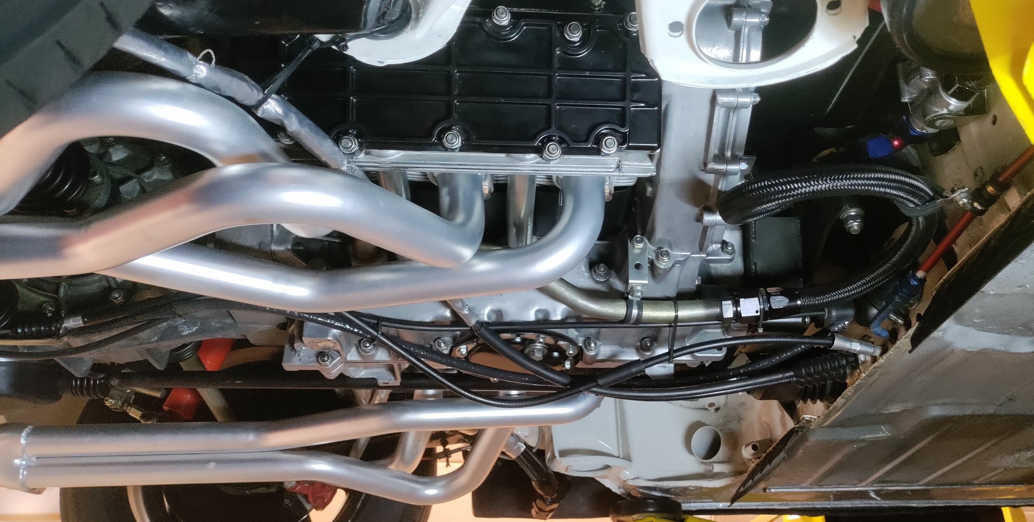

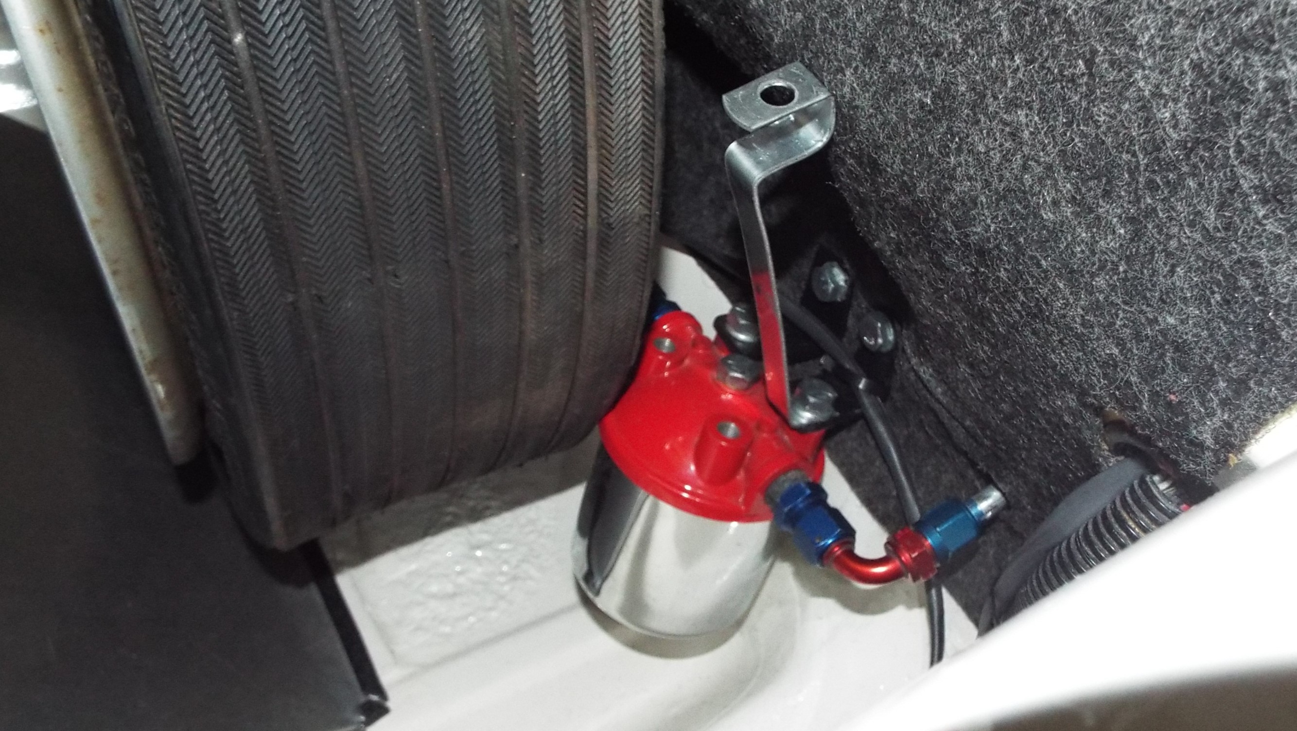

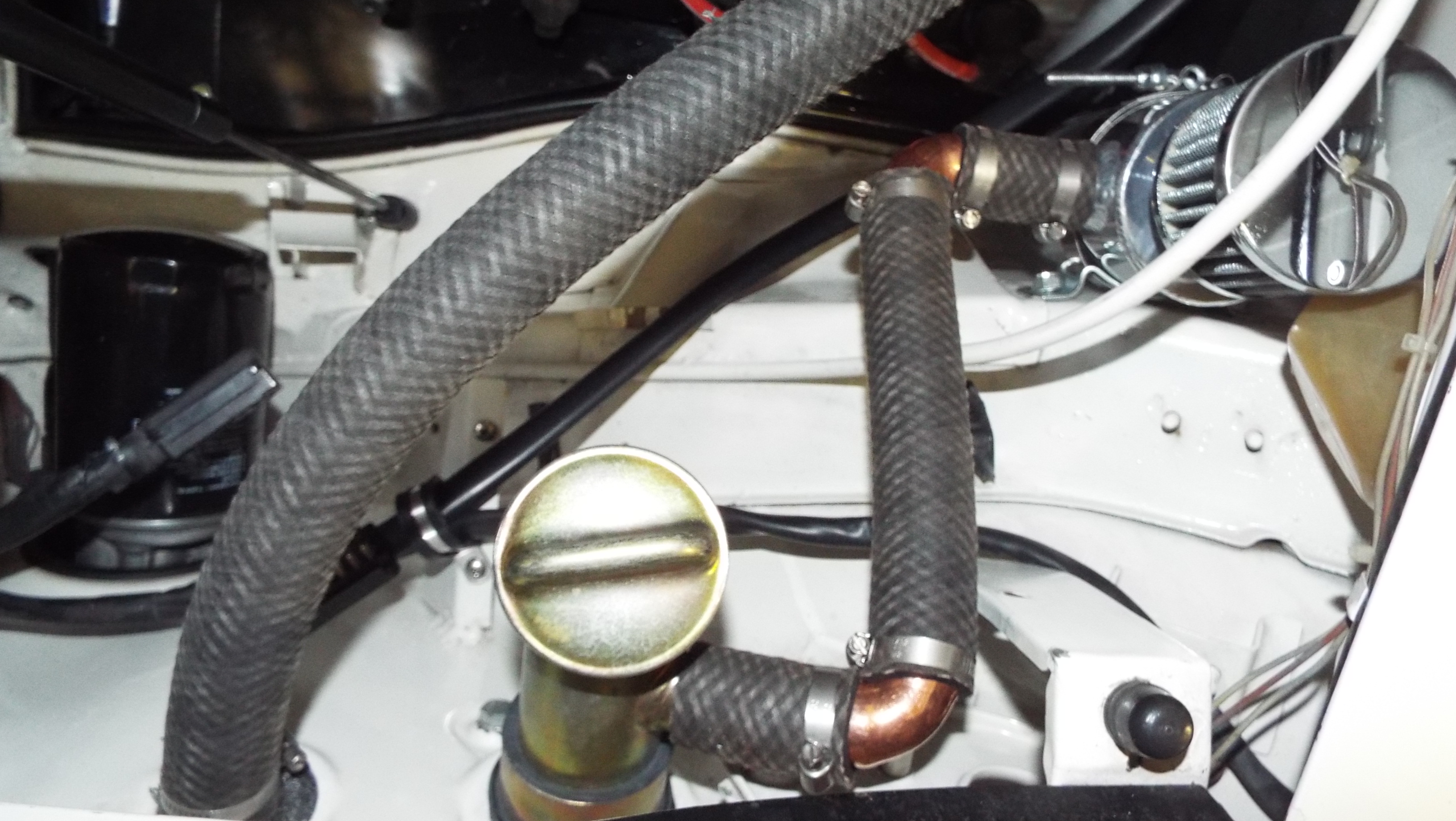

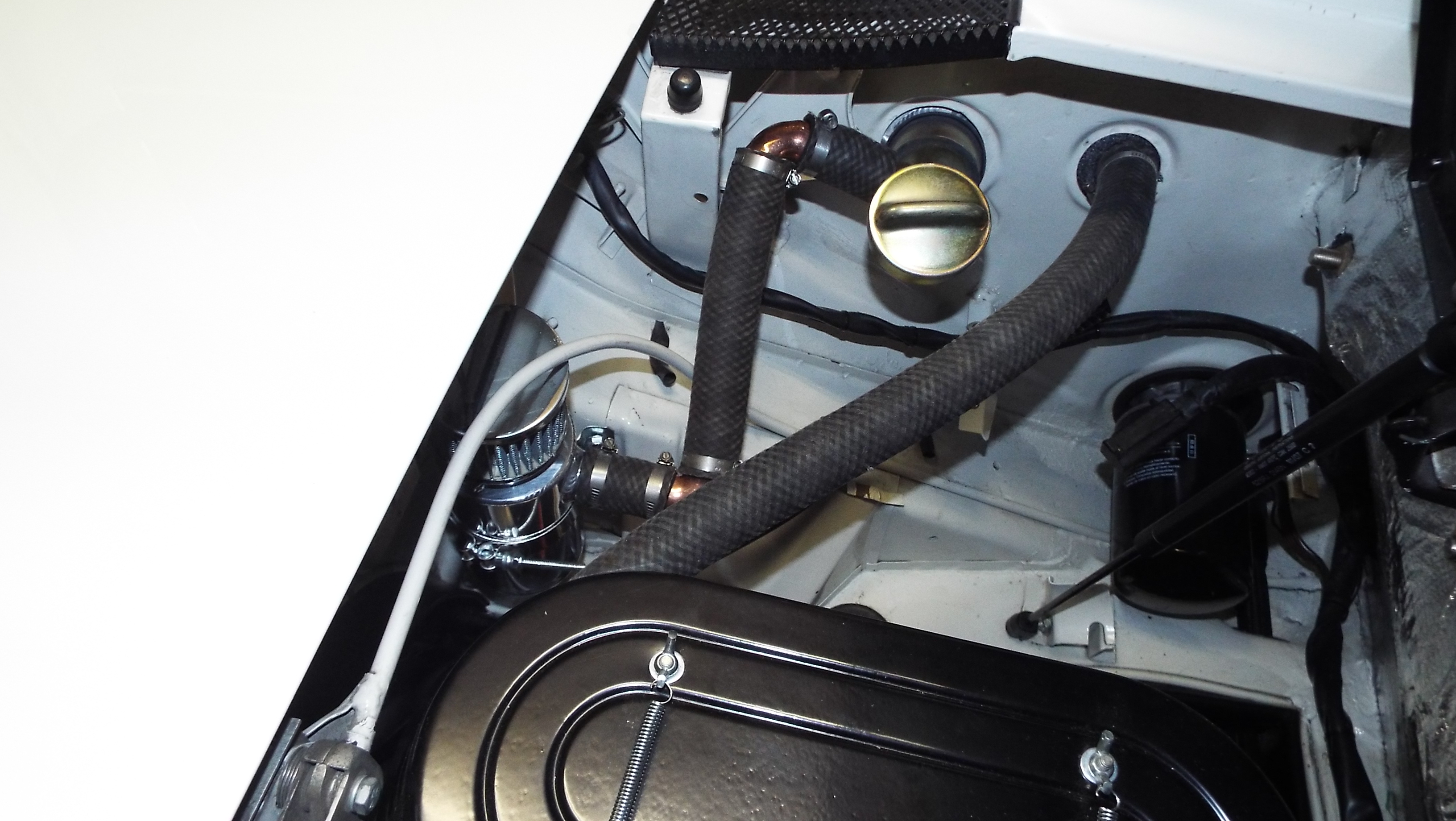

Lucky9146   So I decided to run the oil hoses from the front t...   Aug 5 2015, 09:12 AM
rhodyguy   do em all. the complete 'kit' from pelican...   Aug 5 2015, 10:00 AM
rhodyguy   in this picture the top is the throttle cable. the...   Aug 5 2015, 10:41 AM
Lucky9146   in this picture the top is the throttle cable. th...   Aug 5 2015, 11:09 AM
rhodyguy   73'   Aug 5 2015, 11:41 AM

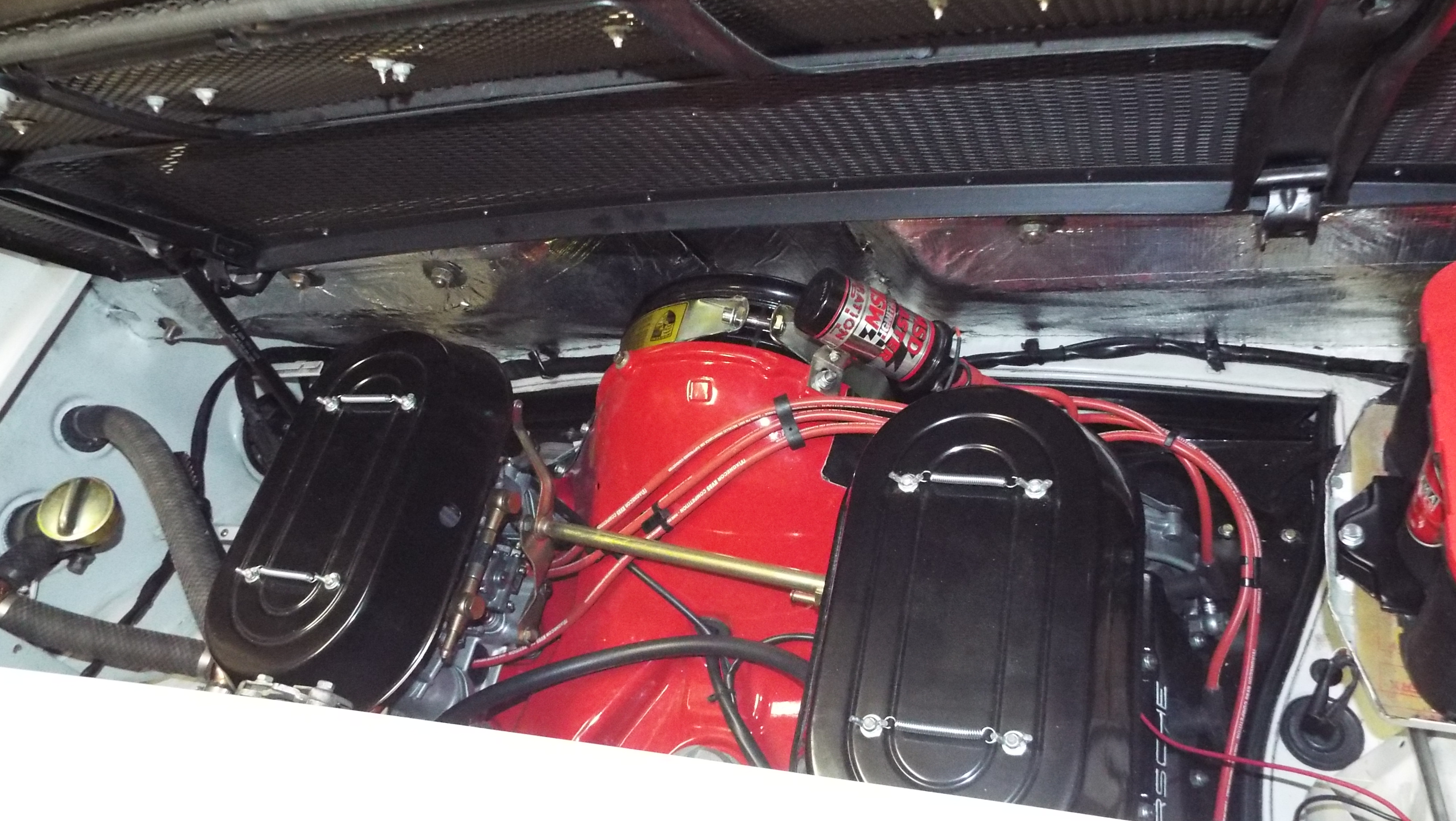

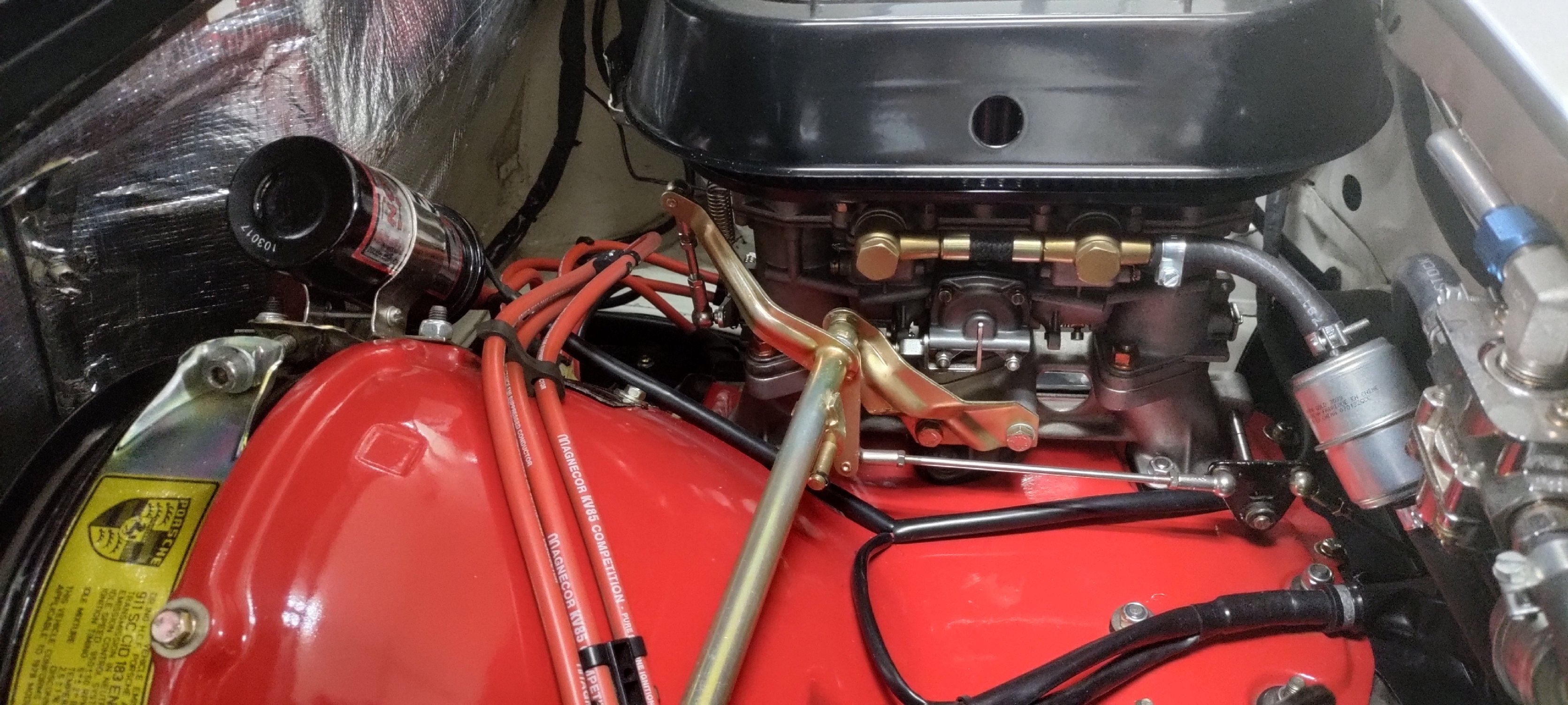

Larmo63   Great looking engine!!! :worship: I...   Aug 5 2015, 12:19 PM

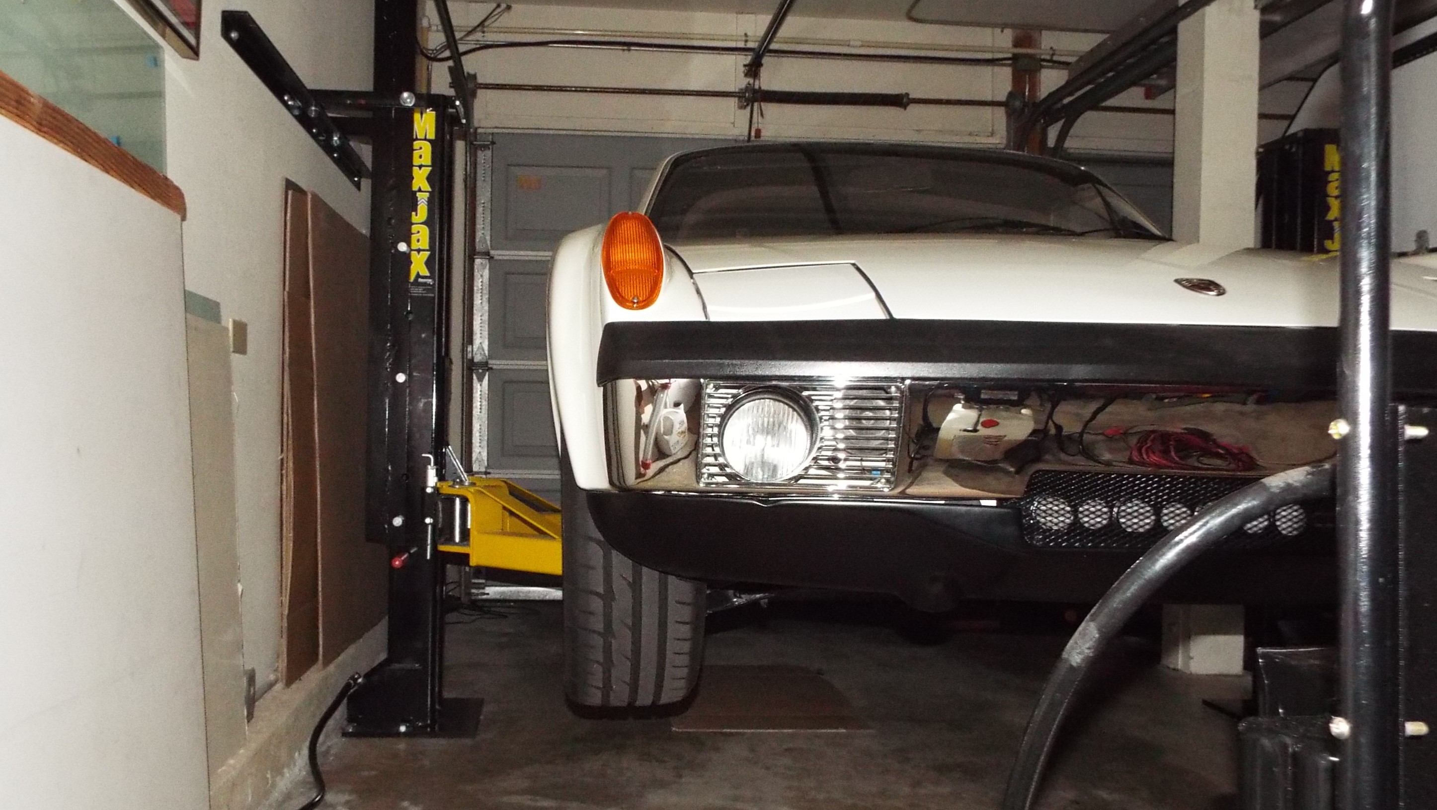

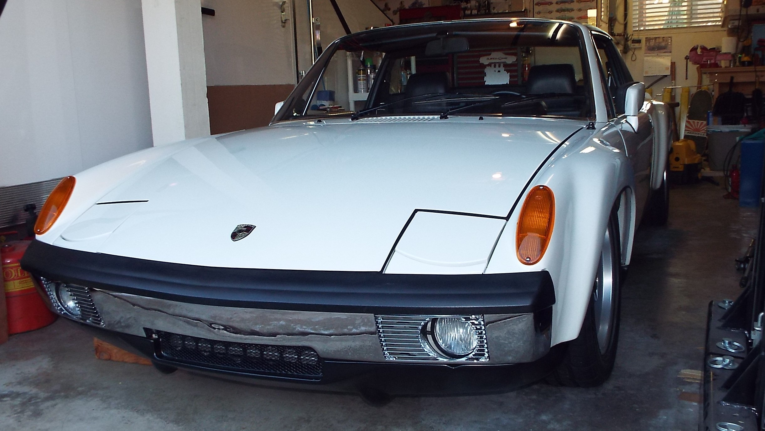

Lucky9146   One of the things I have completed is the rear bum...   Aug 6 2015, 12:22 AM
lonewolfe   One of the things I have completed is the rear bu...   Aug 6 2015, 12:50 AM
Lucky9146   One of the things I have completed is the rear b...   Aug 6 2015, 09:10 AM
earossi   [quote name='lonewolfe' post='2219478' date='Aug ...   Aug 8 2015, 08:26 AM
rhodyguy   in your favor it's not an LE. then you would h...   Aug 6 2015, 09:47 AM

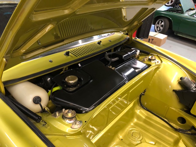

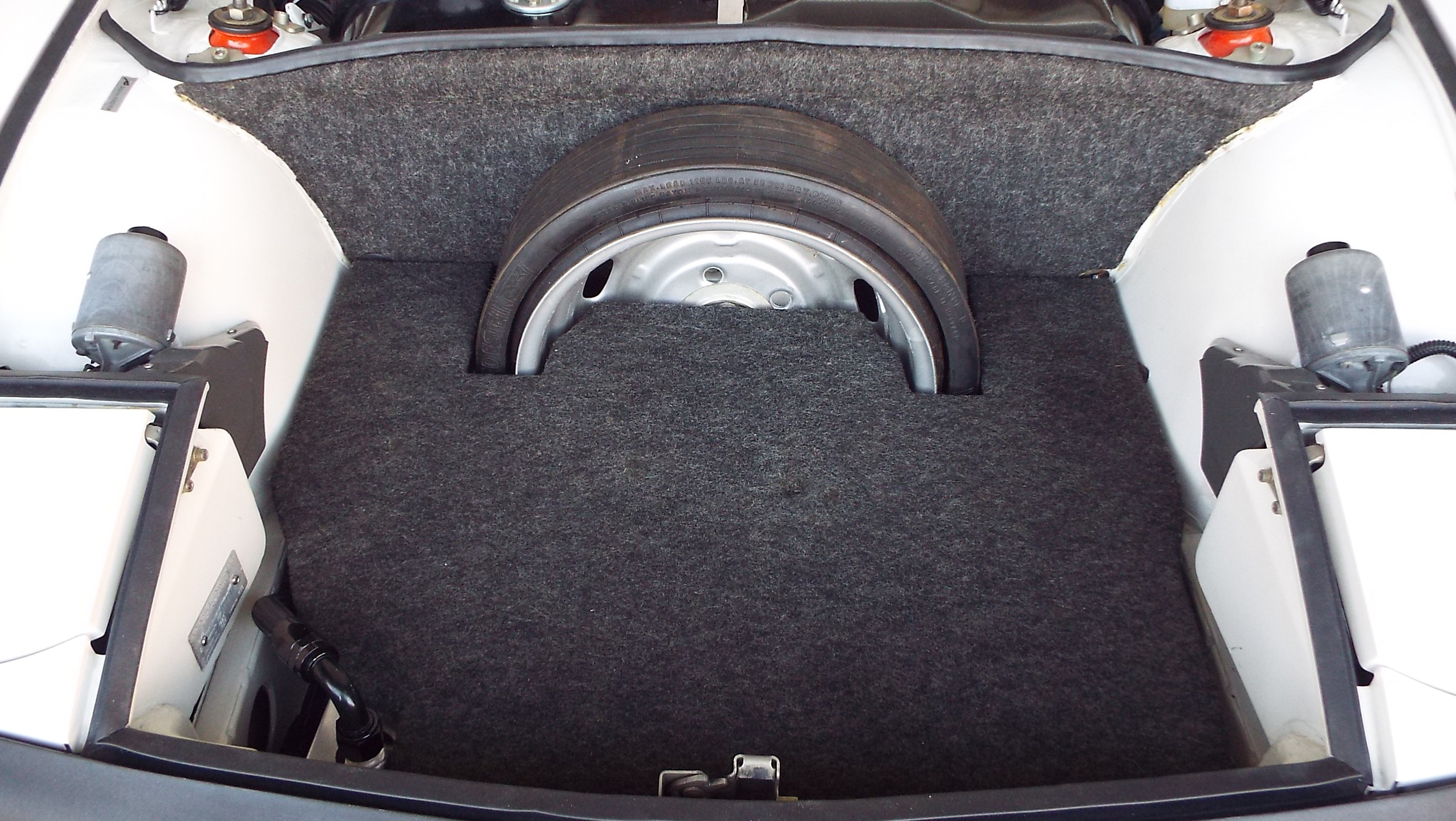

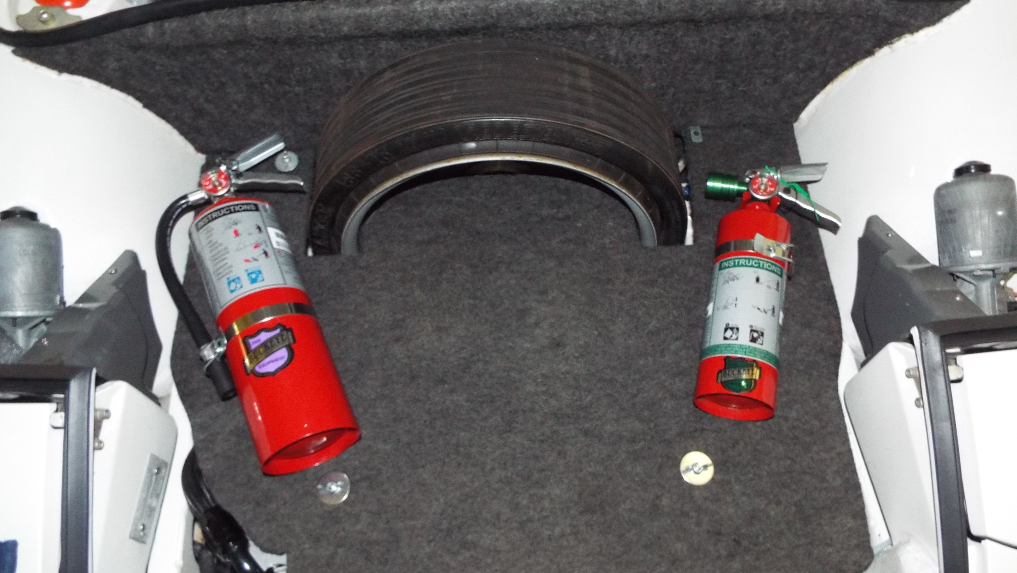

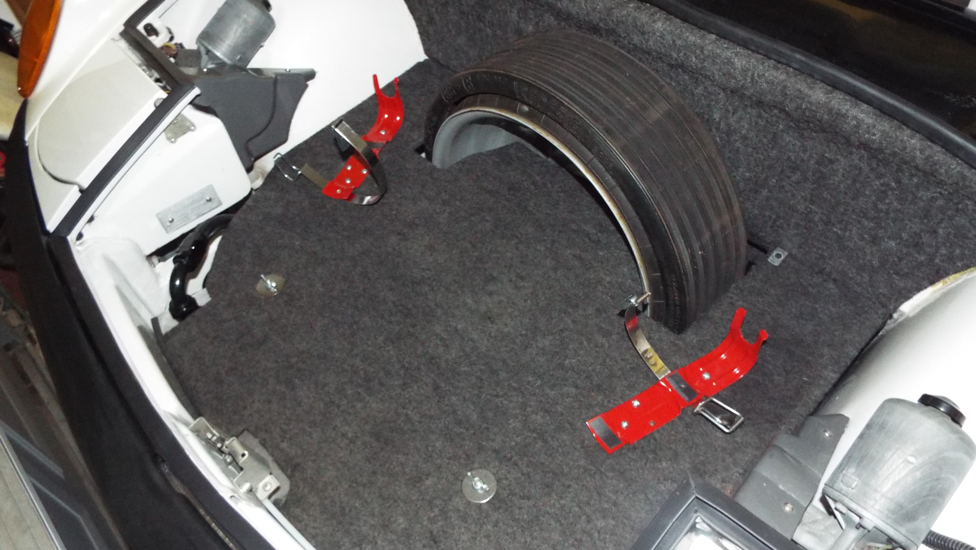

Lucky9146   Pictures of front trunk as received. Louver was i...   Aug 6 2015, 05:13 PM
Lucky9146   Minimal rust was treated with Pour 15, louver was ...   Aug 6 2015, 05:19 PM
lonewolfe   I like how the spare tire mount was added for a sp...   Aug 6 2015, 05:22 PM
Lucky9146   I like how the spare tire mount was added for a s...   Aug 6 2015, 05:53 PM
SLITS   unfortunately I have no info on the fuel filter o...   Aug 8 2015, 07:31 AM
Lucky9146   Front carpet reinstalled. Under front louver seale...   Aug 6 2015, 05:32 PM

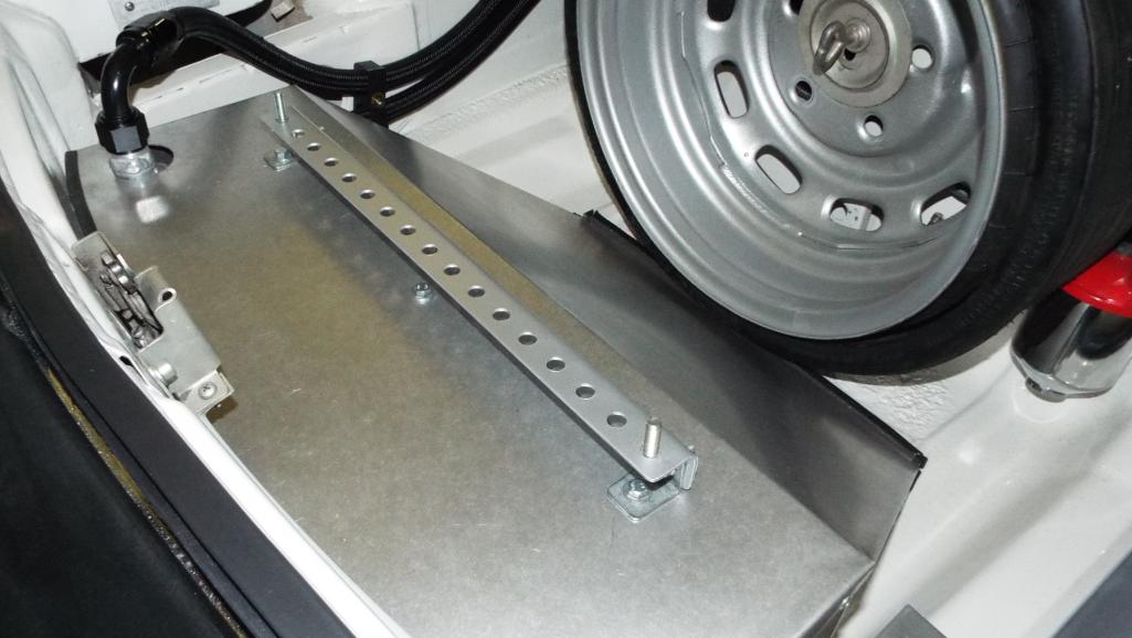

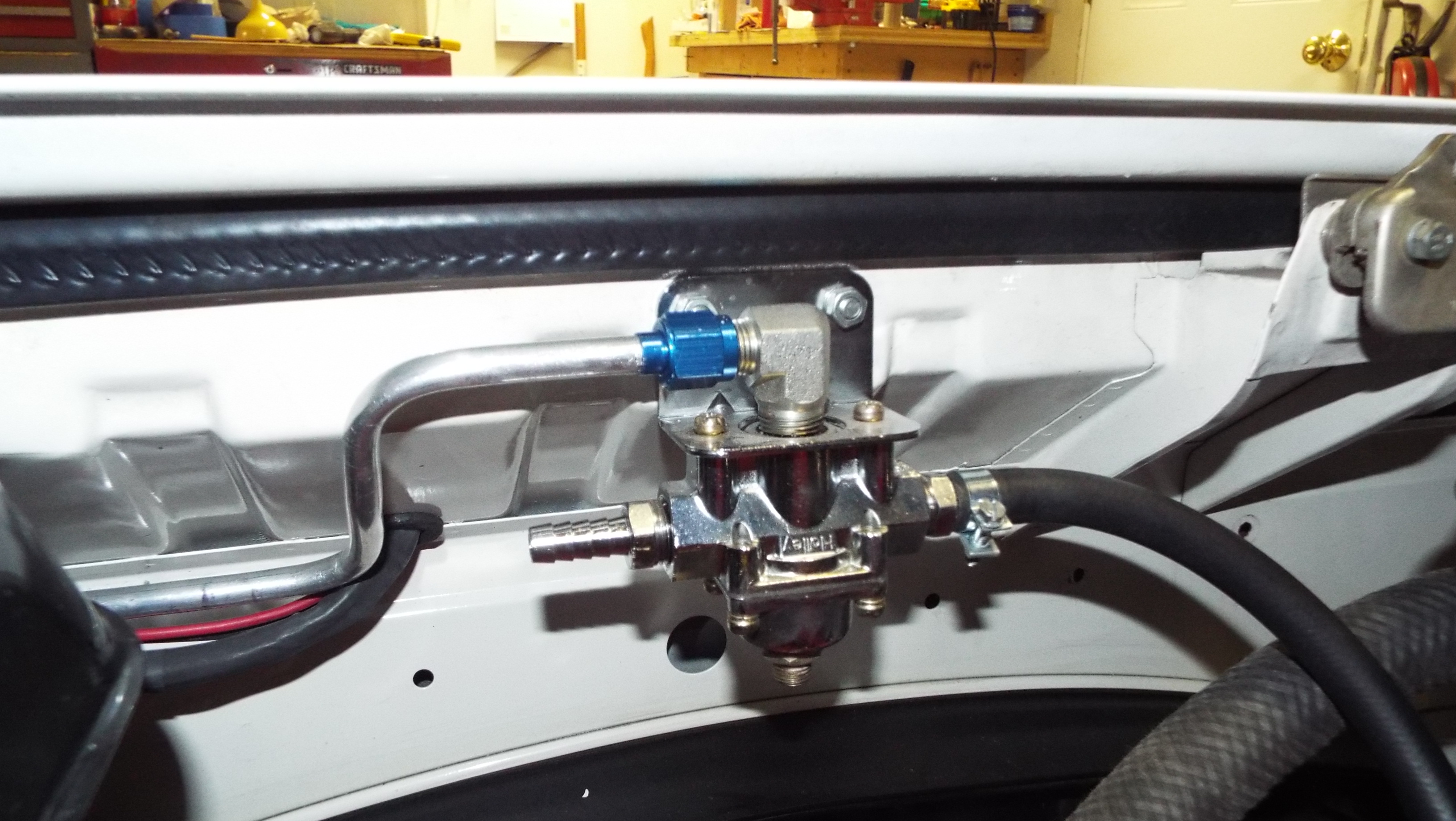

Lucky9146   To continue on with the front trunk, oil cooler, a...   Aug 8 2015, 12:29 AM
Lucky9146   The PO installed oil cooler and card board mock up...   Aug 8 2015, 12:41 AM
Lucky9146   So I started with the mock up and some spare galva...   Aug 8 2015, 01:09 AM
mepstein   Very nicely done!   Aug 8 2015, 06:57 AM
RobW   Very nicely done! :agree: :agree: Very ni...   Aug 8 2015, 07:08 AM

Lucky9146   So learn as you go. Seems the lower bracket for m...   Aug 24 2015, 02:10 PM
OllieG   I wasn't sure what that bracket on mine was fo...   Aug 28 2015, 03:10 AM
