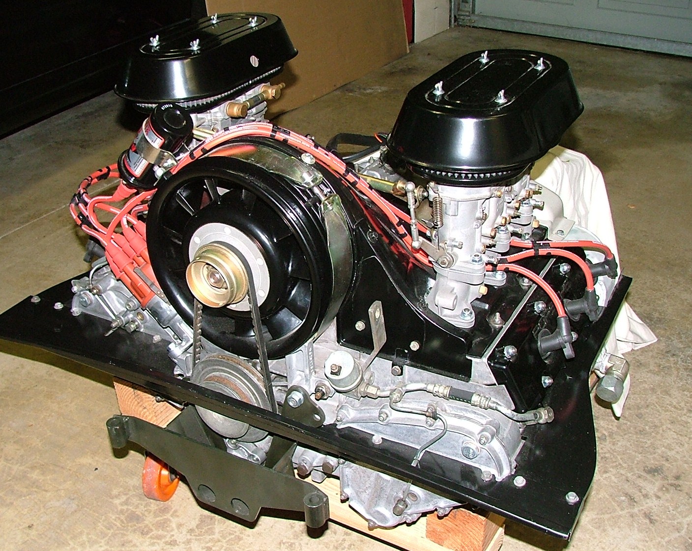

This car came with some really nice parts! Some it already had. Some purchased by the PO for the conversion. The PO did his homeowrk and it is going to take some time but I will show you a lot of what came with the car.
First pictured is the engine which is a 1979 3.0 with 39mm port heads, chain tensioners, turbo valve covers with fins trimmed to clear trailing arms then powder coated. A Jerry Woods complete distributor rebuild/ re-curve, MSD Blaster high vibration coil, Magnecor Spark Plug wires, new plugs. Valve clearances set. Dual Weber 40 IDA 3C carbs/manifolds/linkage, completely rebuilt and bench tested by Paul at Performance Oriented. Intake manifolds are glass beaded, port matched to the heads, new gaskets and phenolic spacers. New K&N Filters and powder coated rain hats. Note the cad plating and front mount installed. Yes this is how I got the engine!!!!!
Next is the PO installed Rich Johnson engine conversion mount pictured and it is both bolted and welded.

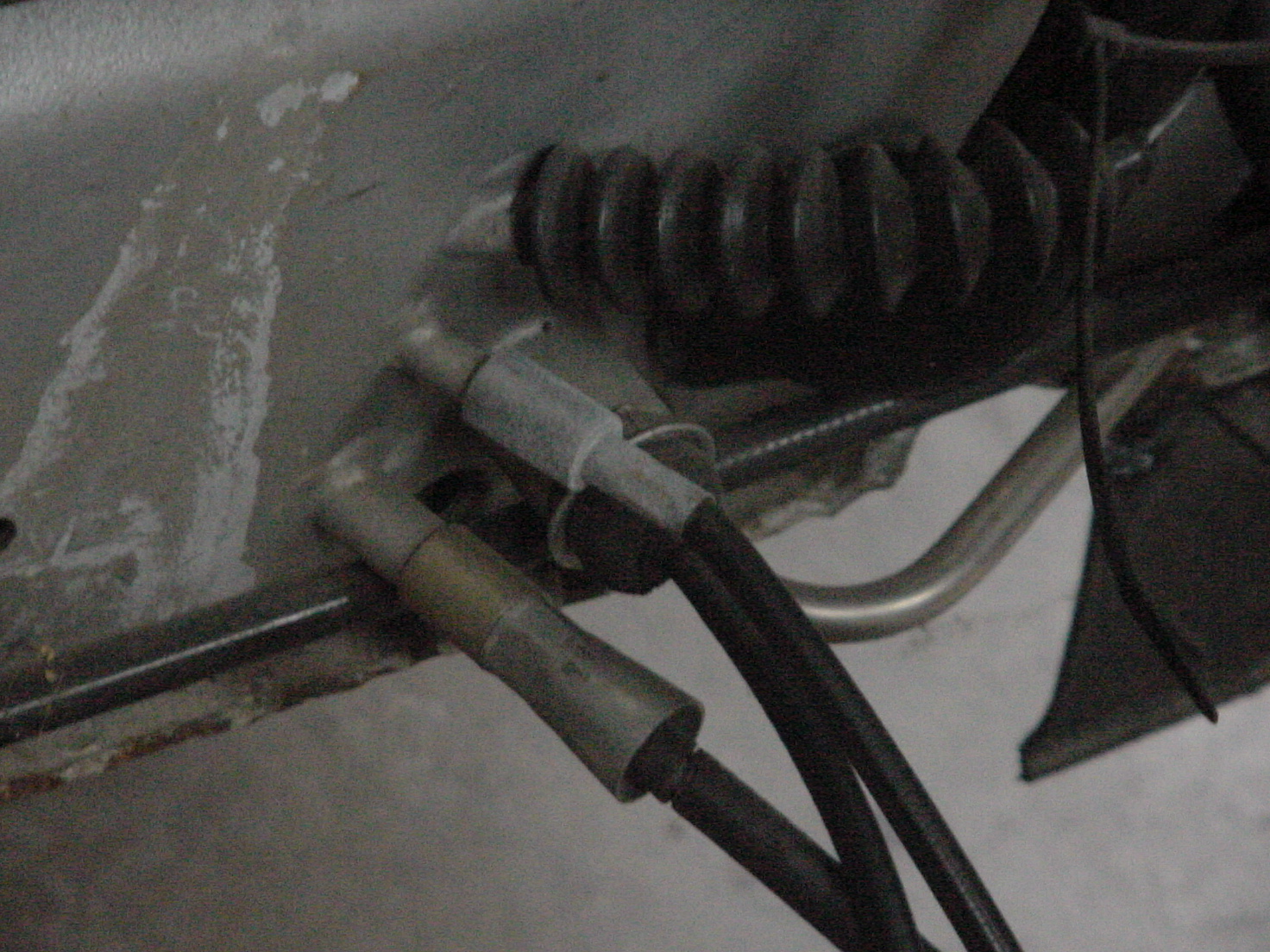

in this picture the top is the throttle cable. the bottom is the clutch. the large one to the right of them is the speedo. you seem to be missing something.
Lucky9146
post Aug 5 2015, 11:09 AM
Post #37
Posts: 1,712
Joined: 22-September 14
From: Poway California
Member No.: 17,942
QUOTE(rhodyguy @ Aug 5 2015, 09:41 AM) *
Thanks rhodyguy for responding to my PM with the picture of your cables. I was trying to figure out which tube the accelerator cable went through since the car came with out the cable. In my picture the PO welded flat washers as back stops for the center e-brake just left of the cables, and I like the idea. So on mine the clutch is on the left, the speedo goes through the larger opening up to the right and the speedo tube must be where I have the safety wire hanging out of. Note PO ran fuel line next to Clutch hole. Mine is a 74 what year is yours? Thanks again
