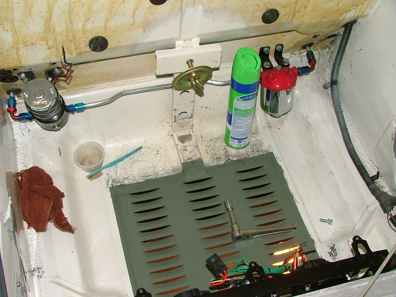

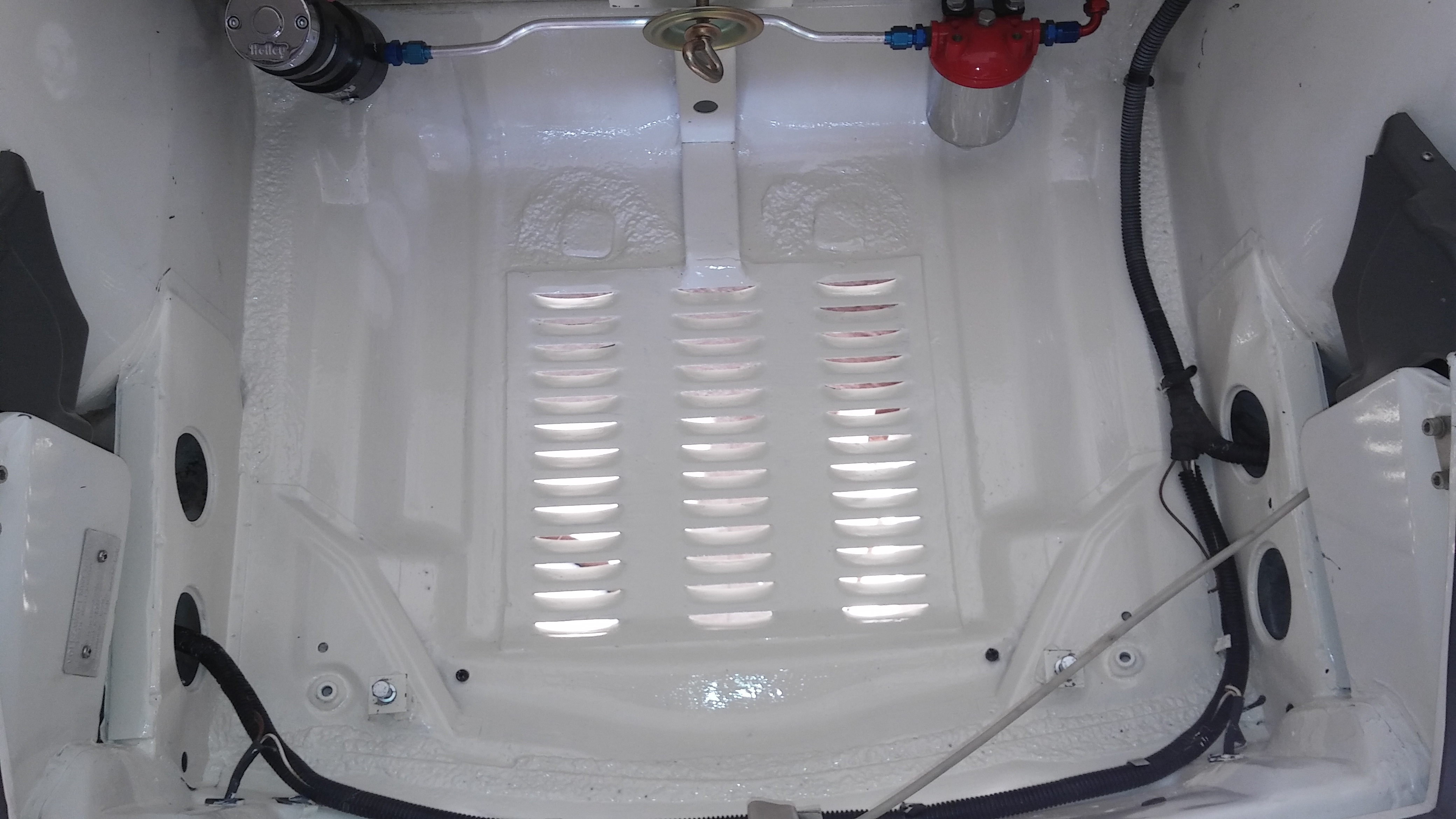

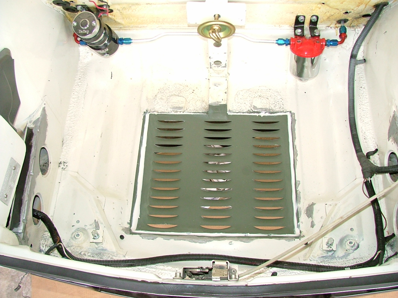

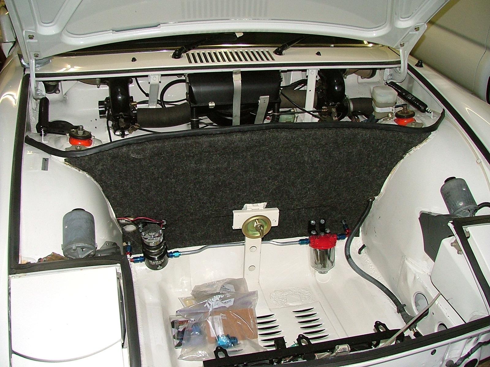

Pictures of front trunk as received. Louver was installed. Bracket had been added for compact spare tire mount. The oil cooler was mounted and I will cover that and the oil cooler shroud in more detail shortly. Note the PO added same size holes matching and between the original holes on the front for the oil cooler intake.

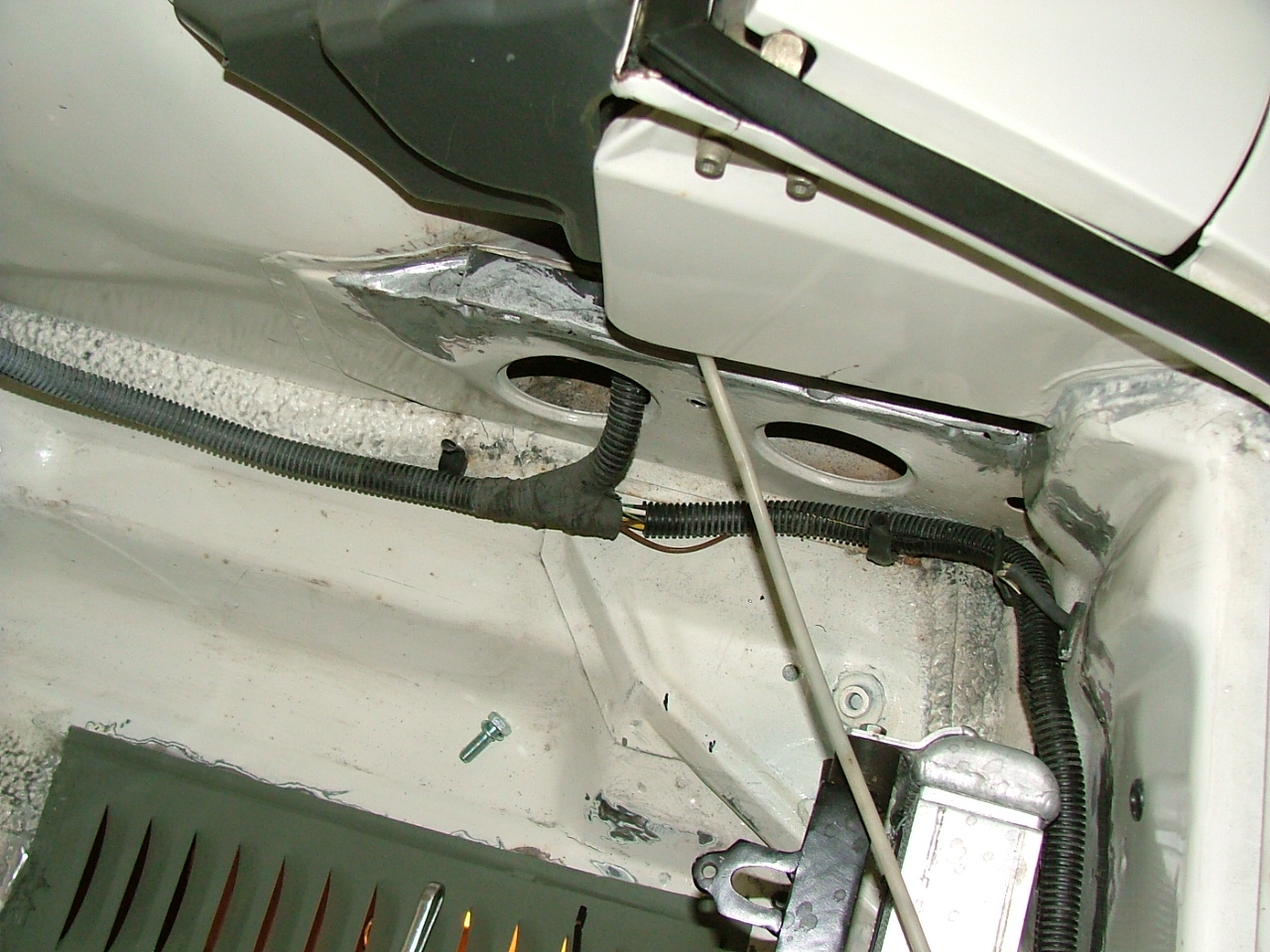

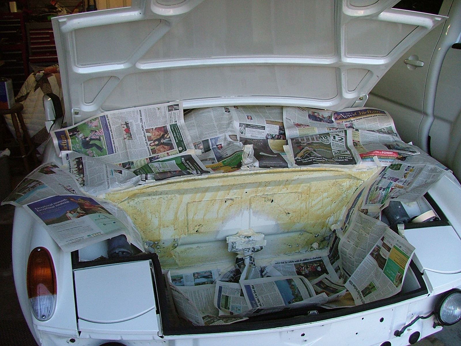

Minimal rust was treated with Pour 15, louver was sealed from top and bottom, and trunk painted.

I like how the spare tire mount was added for a space saver spare. Is that the fuel pump mounted on that same firewall? I'm pretty sure it is but what is the other device? Is that a giant fuel filter? I've not seen one like that before if that's what that is. Did you weld in that louvered panel?

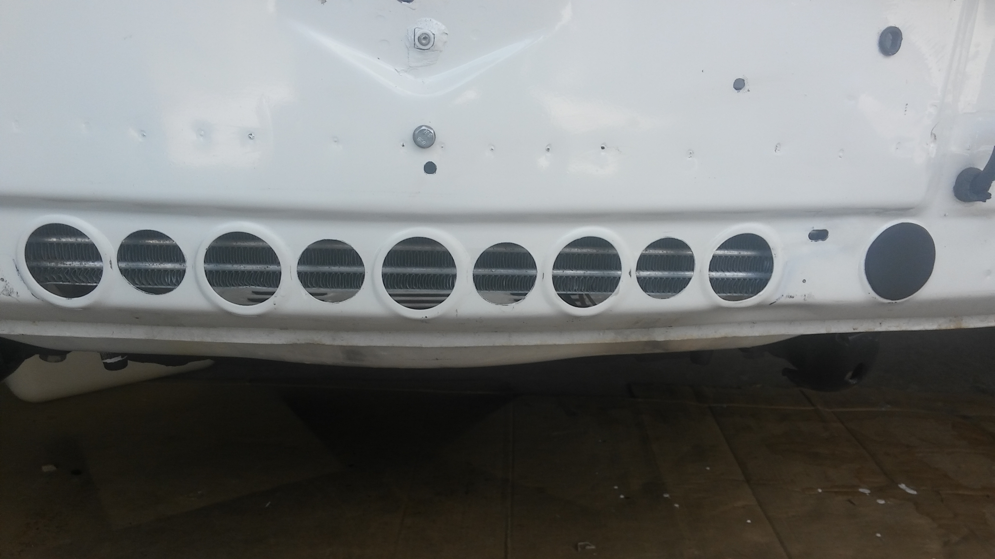

Front carpet reinstalled. Under front louver sealed and undercoated.

QUOTE(lonewolfe @ Aug 6 2015, 04:22 PM) *
PO gets credit for the compact spare tire mount and it is nicely done. Yes that is a Holly 120 fuel pump on left and unfortunately I have no info on the fuel filter on the right but I believe it is a Holly as well, both done with AN 6 tube and fittings to engine compartment by PO. Yes the louver panel was spot welded in hence the sealing by me. I tried to find the filter on line but could not find it, there are no markings on it.

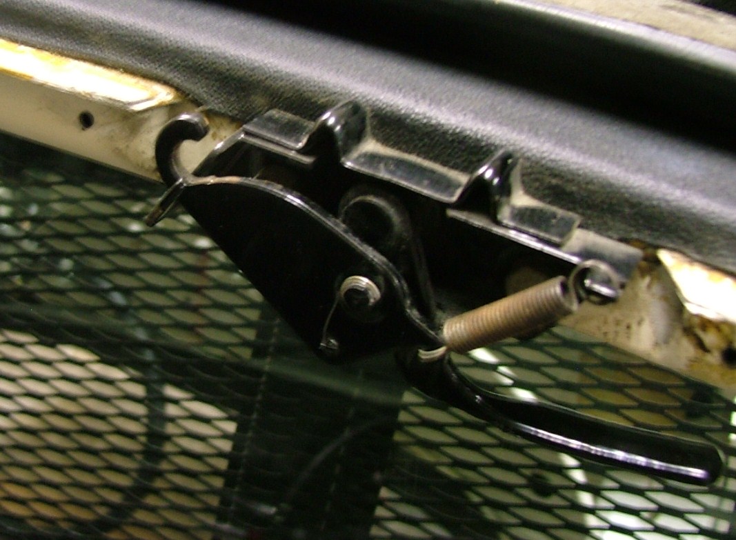

Have been looking for months for the cir-clip that hold the rear roof latch on the shaft that it rides on. Found it at Marshalls Hardware, huge selection of parts. San Diego Off Miramar Rd. Like I always say the devil is in the details.

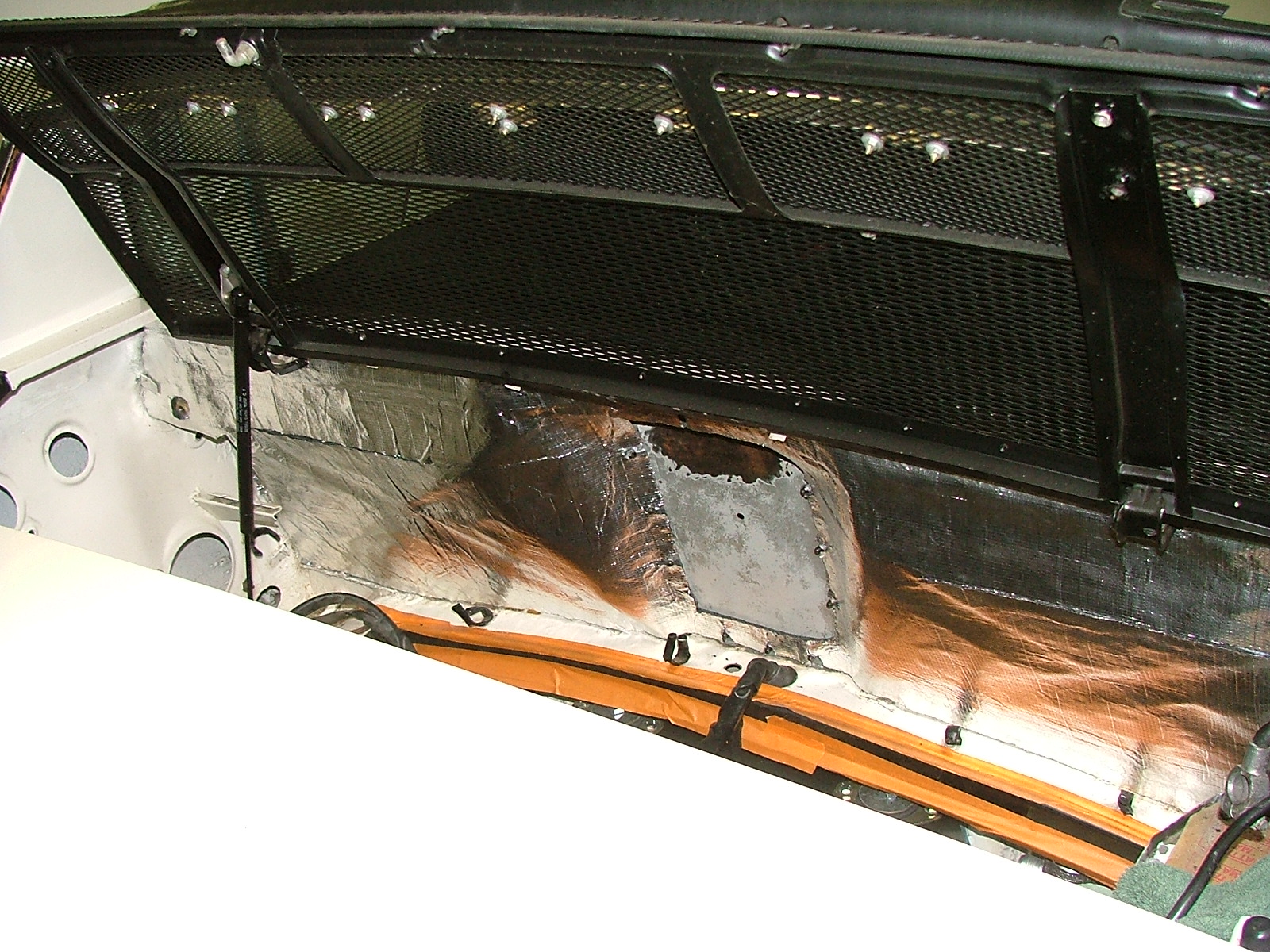

Engine compartment insulation was not installed when I got the car but the original insulation did come loose with the car but it was very tired. Also, it had a lot of extraneous holes in it so I used it for a template. Found some foil backed heat shield at ORW = Off Road Warehouse made by Competition Specialities (about $50). It worked well fitting it and glueing it in, mostly scissor work. Still need to do the back side of the access panel from the passenger compartment.

Insulation Installed

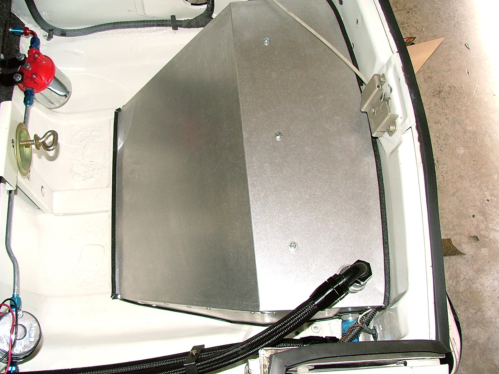

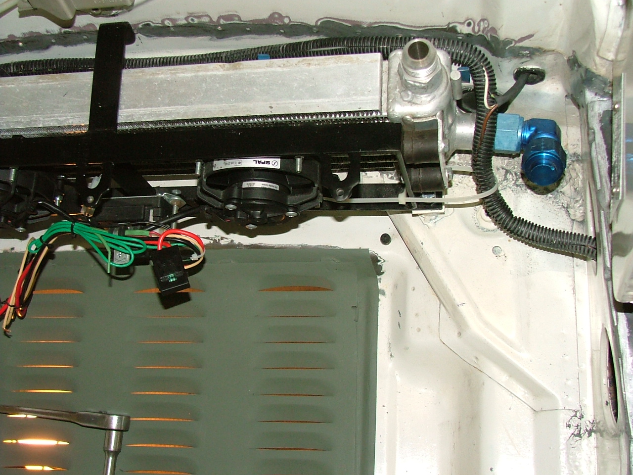

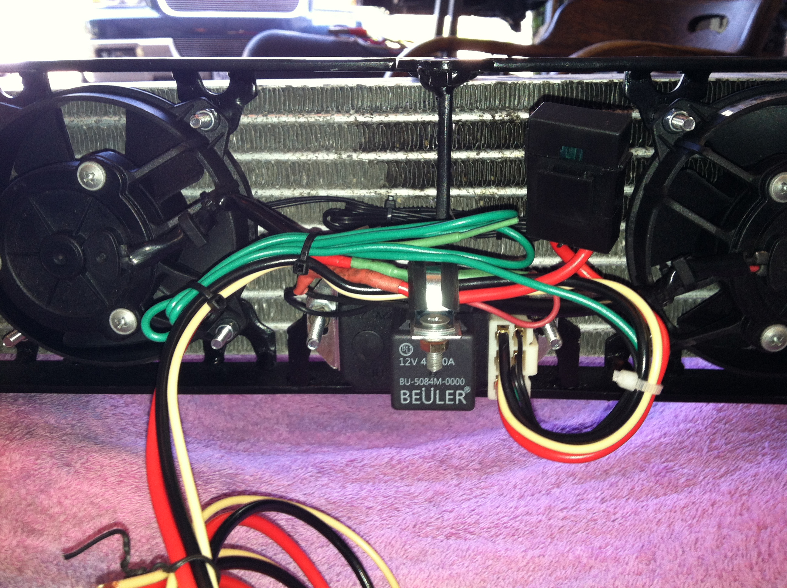

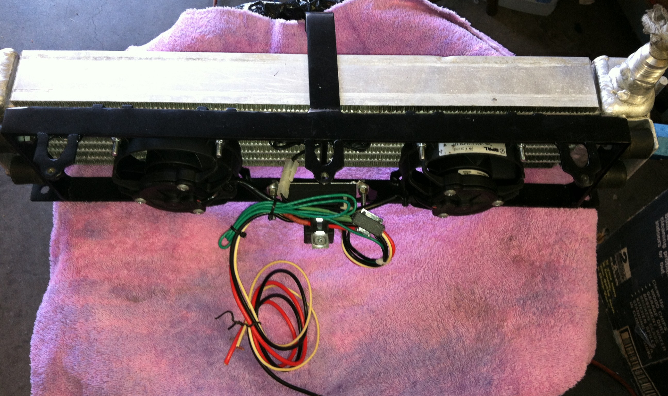

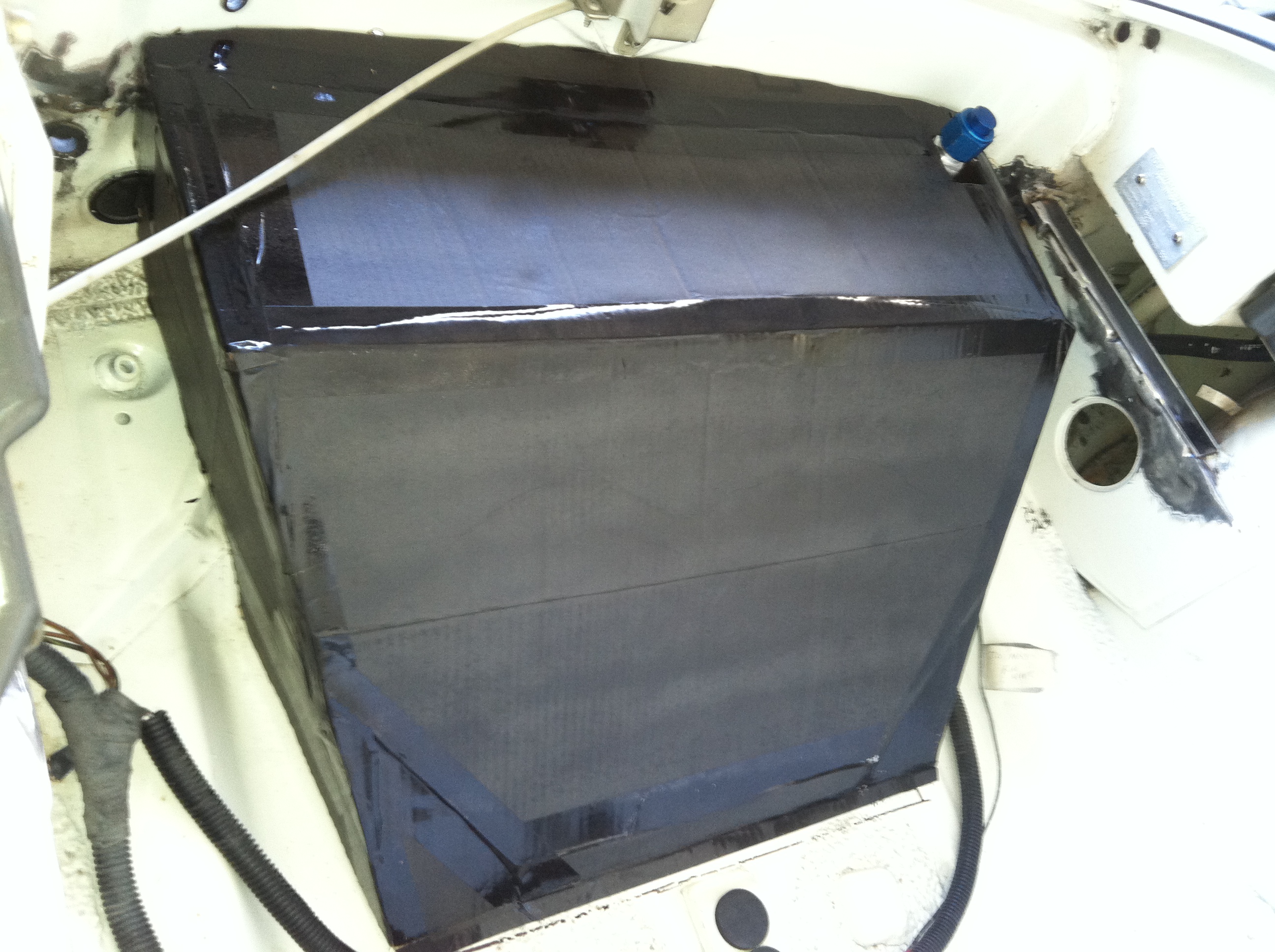

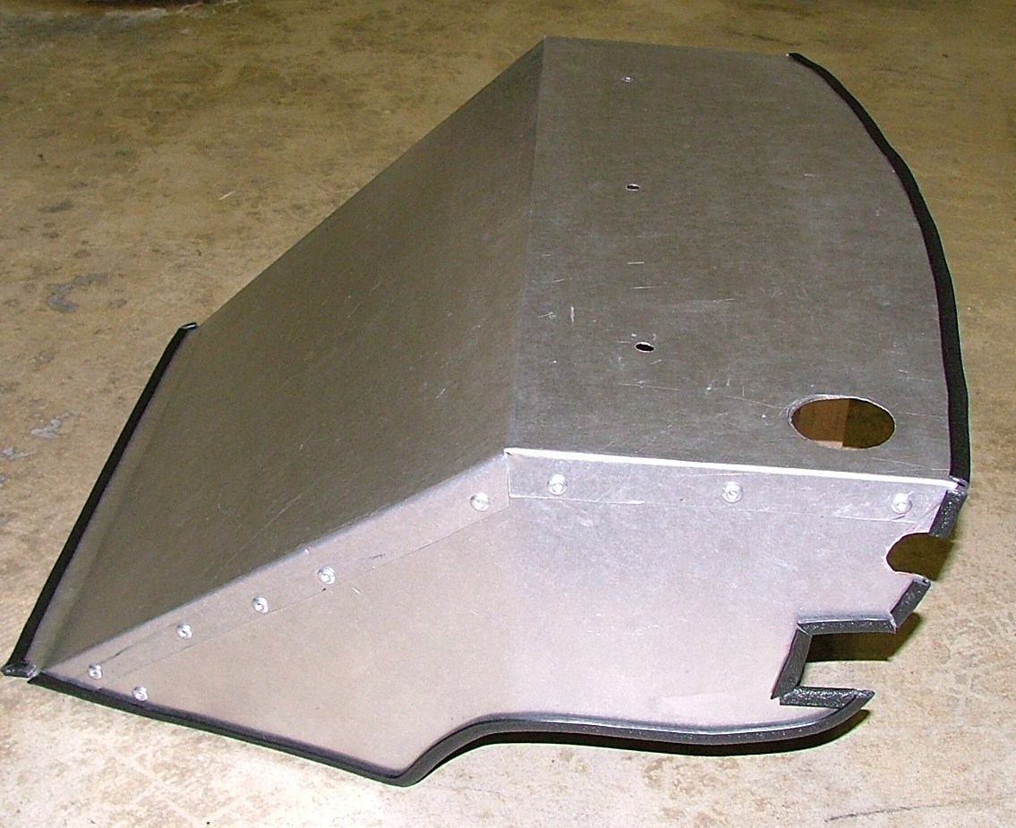

To continue on with the front trunk, oil cooler, and shroud. It should be noted that I started a thread "Mazda RX7 Oil Cooler Flow" to try to figure out in fact which way the oil should flow or if it really mattered. That thread has taken on a life of is own and I will try not to duplicate here. In fact that post preceded this thread because through that thread I decided I would share my experience of taking over a project started by someone else to complete it. The PO fabricated a bracket for the oil cooler and fans and it is the support for the shroud. Pictured
Lucky9146
post Aug 8 2015, 12:41 AM
Post #56
Posts: 1,712
Joined: 22-September 14
From: Poway California
Member No.: 17,942

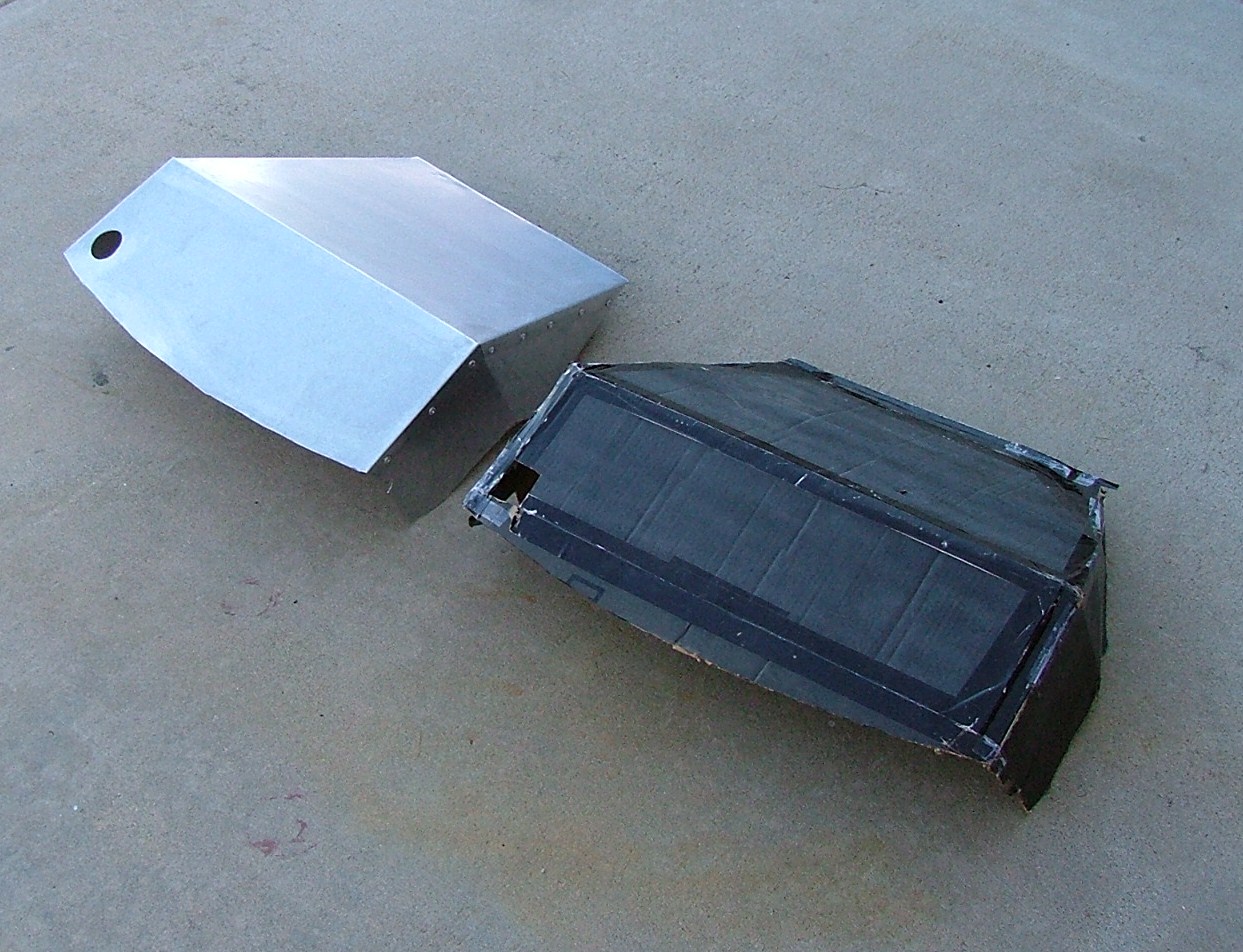

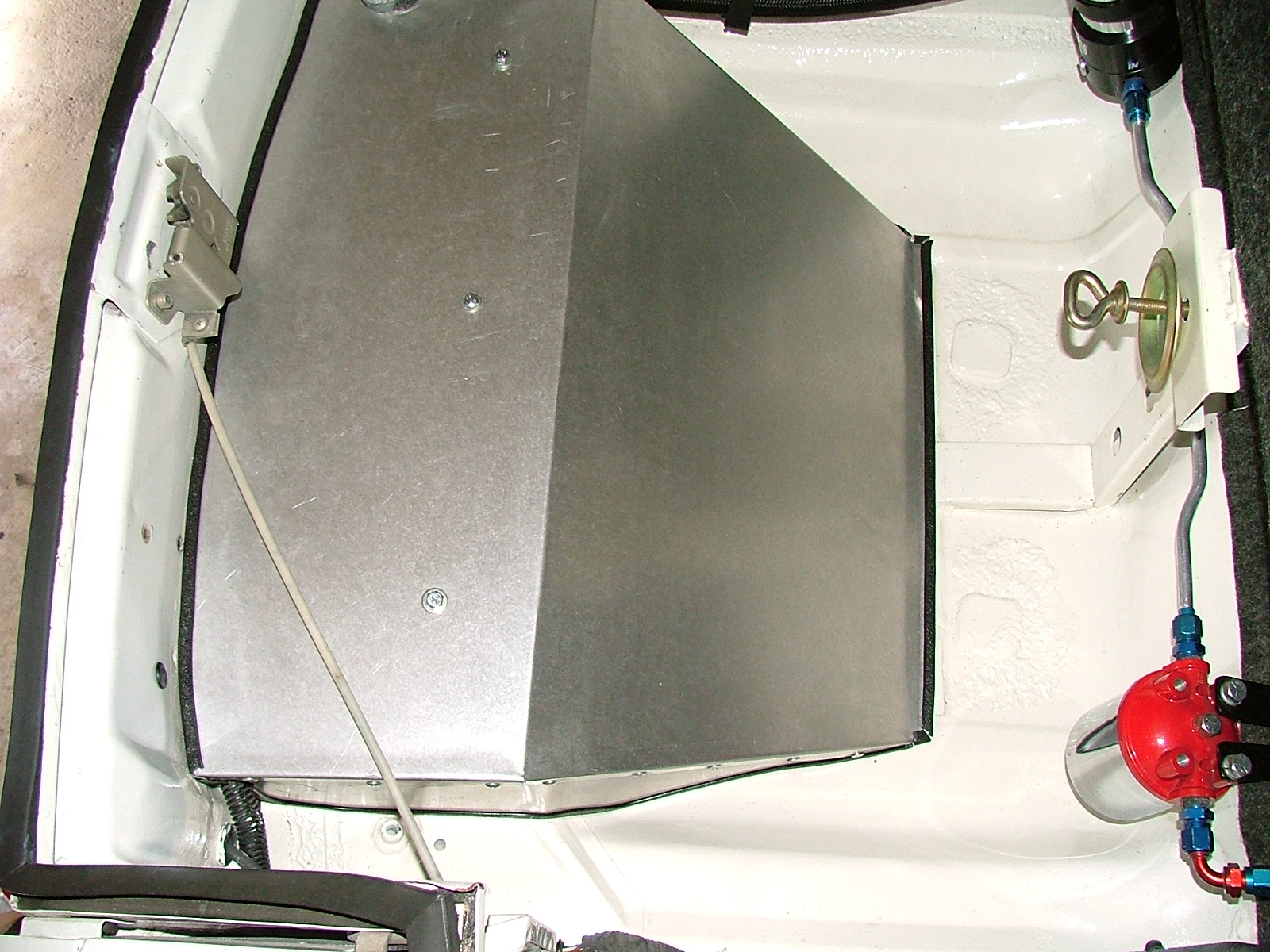

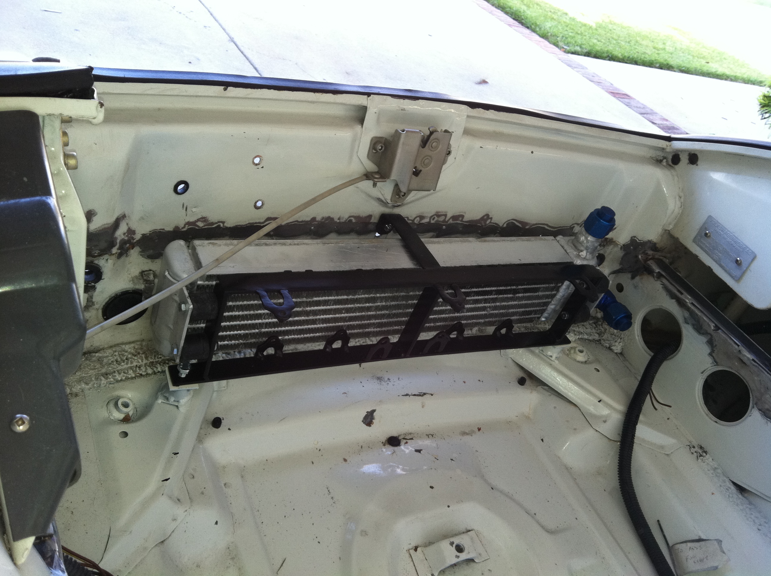

The PO installed oil cooler and card board mock up shroud. It is my understanding the Mazda cooler is wider making it harder to just buy a shroud.

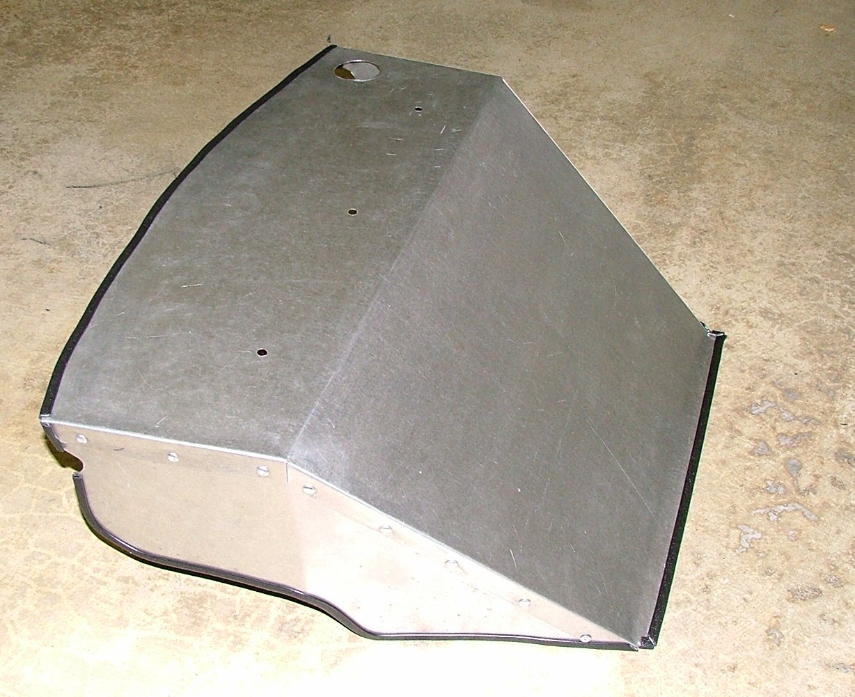

So I started with the mock up and some spare galvanized sheet metal. It would take a total 5 brake bends to shape the top piece and then cut to fit the two sides. Note it is much more difficult to cut the metal to contour the trunk than cardboard but with careful trial fits it works. I located a local metal fabricator for the first 5 bends which are the one main bend across the top and then the 4 flaps which would attach to the sides. Fabricator charged $20.00 which seemed fair as a walk in customer. Rivits $6.50 Depot. Finally, 9 feet of Trim Lok edge protector $11.50 which also serves as additonal contour to the floor. Total cost $38.00 One last bend was done at the back to allow a clamping flange. Three bolts through the top to the cooler bracket bold it firmly in place and camps have yet to be completed.

Very nicely done!

QUOTE(mepstein @ Aug 8 2015, 05:57 AM) *
Very nicely done!
(IMG:style_emoticons/default/agree.gif) (IMG:style_emoticons/default/agree.gif)
Very nice!

QUOTE(Lucky9146 @ Aug 6 2015, 04:53 PM) *
The fuel filter is a Fram HPG1. We used their remote filter bases for both oil and fuel on the race cars. You can find them at JEGS and Amazon.
