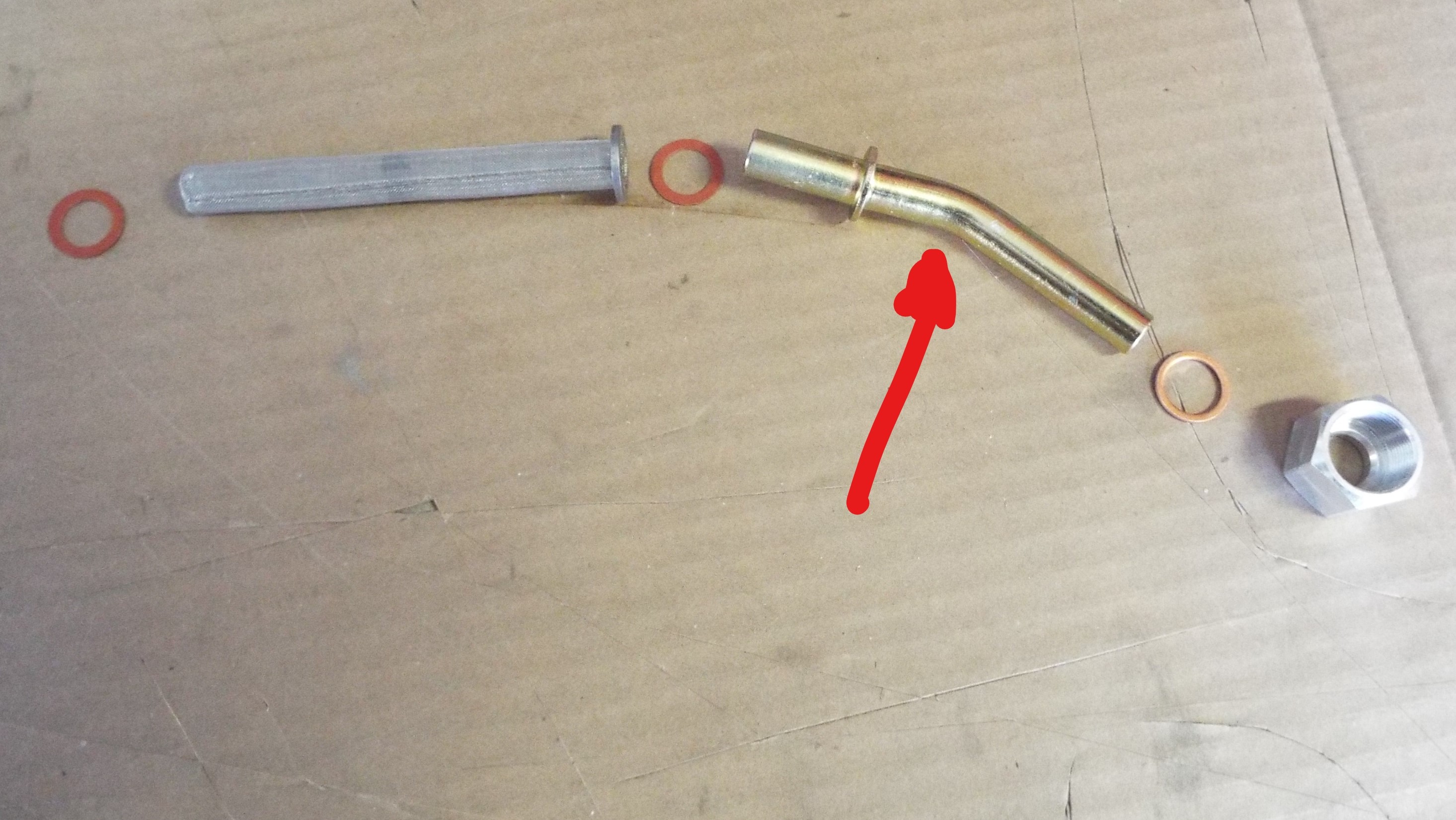

You can still buy this fuel tank nipple kits new for less than
Playing the old one. CB performance sells the whole kit for 8.95 and it comes with the nipple, securing nut and gasket. I’d install a brand new one. They are the same as what was in aircooled VW’s.
Thanks for the tip that is amazing and possibly better suited to my situation. (IMG:style_emoticons/default/beerchug.gif)
If that nut is the same, and it looks like it is, Bruce Stone will be thrilled.
Will have to contact CB Perf on Monday to find out tube diameter.
Below is what is on their website.
(IMG:style_emoticons/default/white914.jpg)
3189 Fuel Tank Outlet Kit
Your Price: $8.95

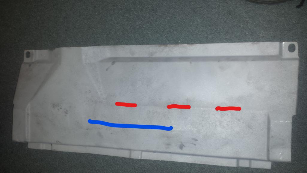

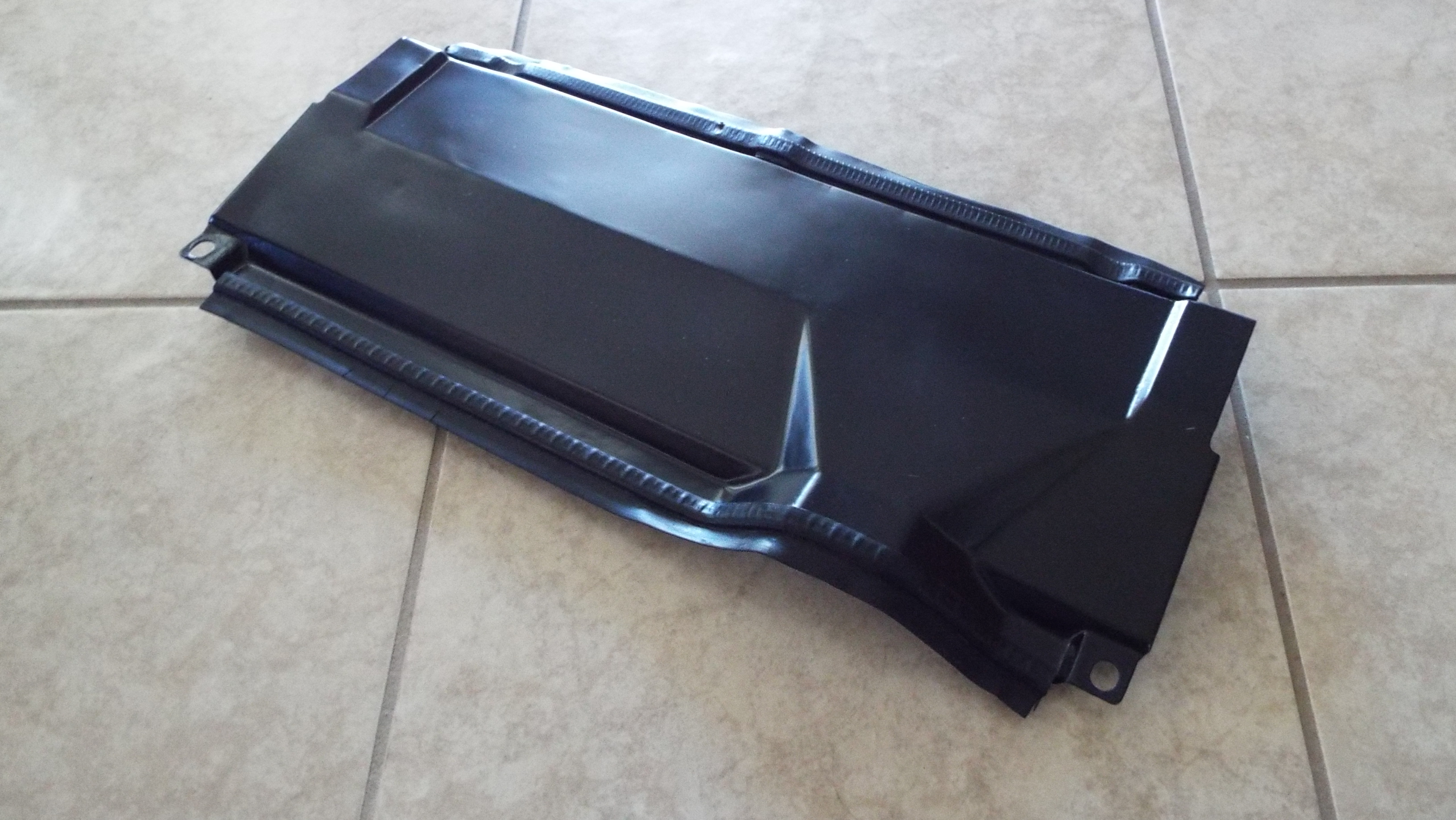

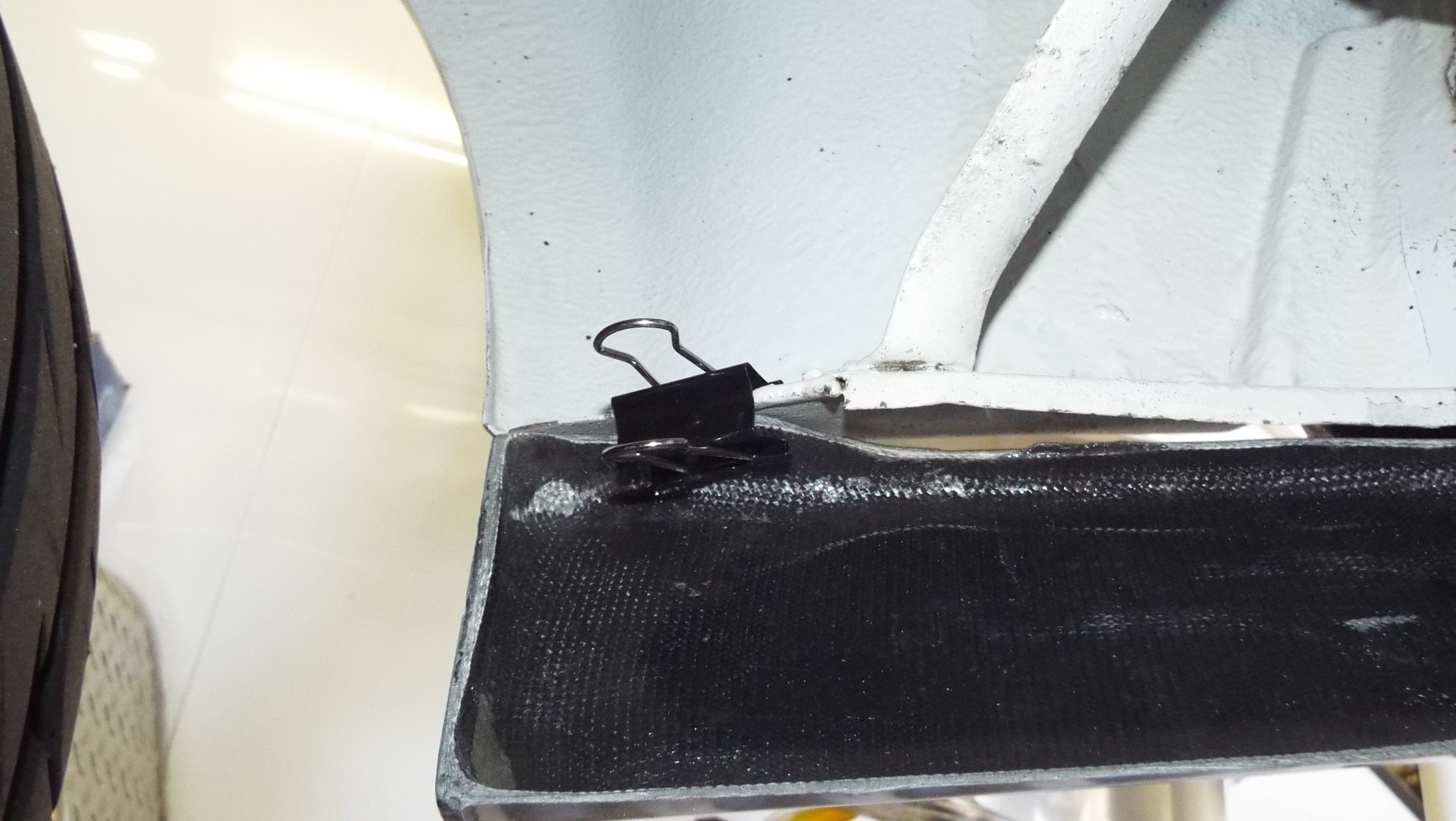

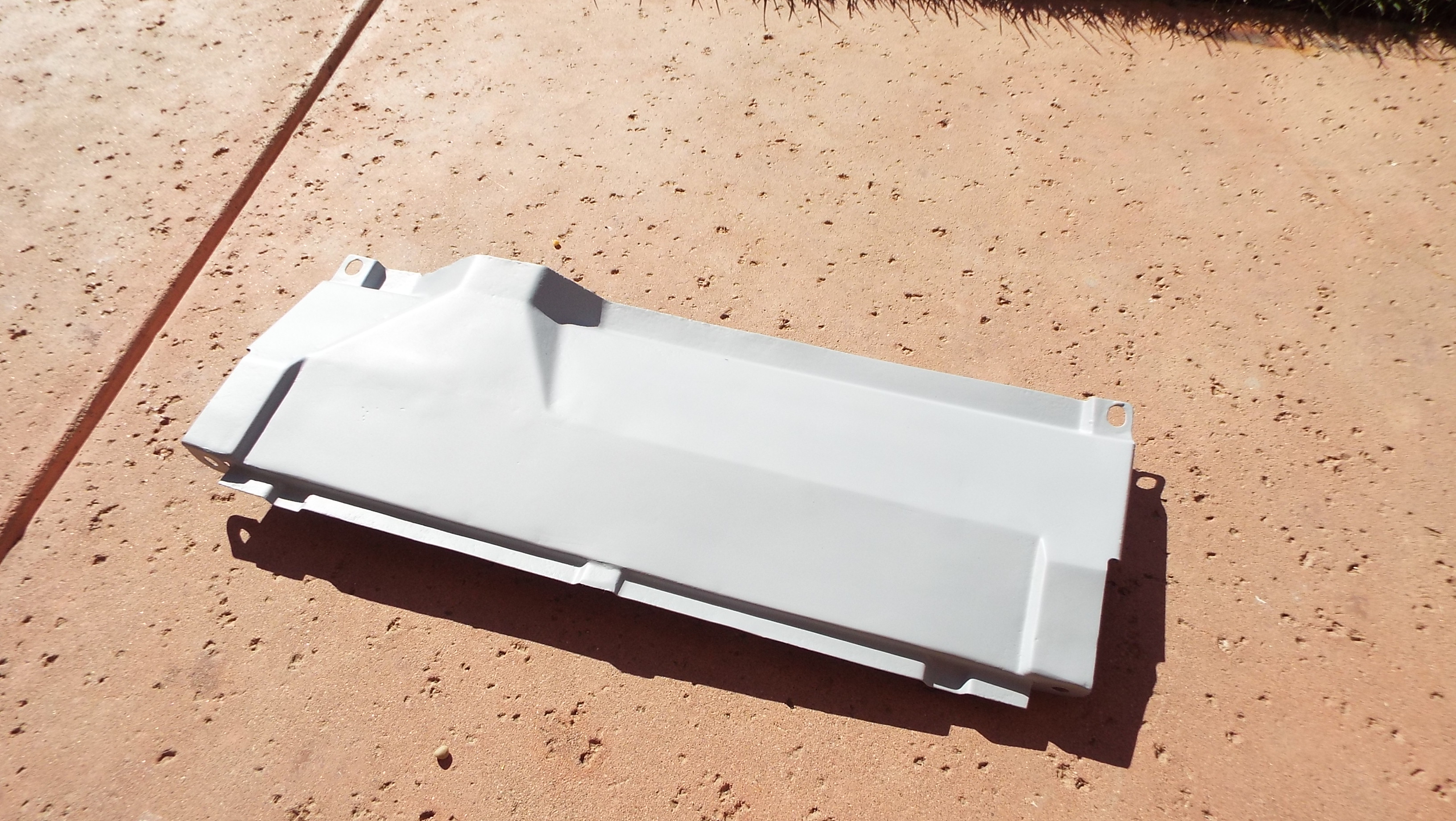

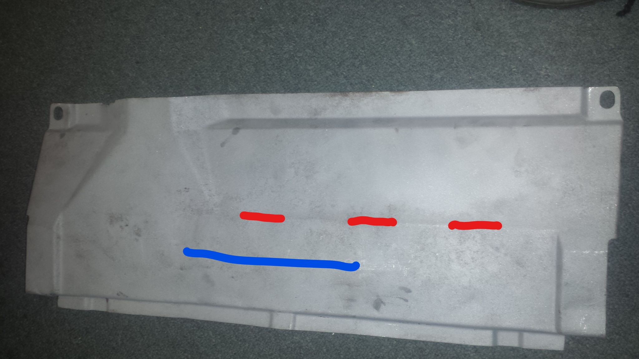

While I’m waiting for gas tank parts I got into a couple of small projects, one of which was the steering rack cover.
It needed a bit of straightening with hammer (IMG:style_emoticons/default/smash.gif) and dolly, then Por15 on the up side with prime / paint the bottom side that will be visible.
These cars are so low and I know you can't really see this part when installed but I was on a mission to see what I could do with it. (IMG:style_emoticons/default/biggrin.gif)
Before Pic - Unfortunately what you really can't see is the crease marked in red running the length of it was wavy and bowed.
The flat area marked in blue was actually curved in the center but not the ends.

Wow, nice improvement!

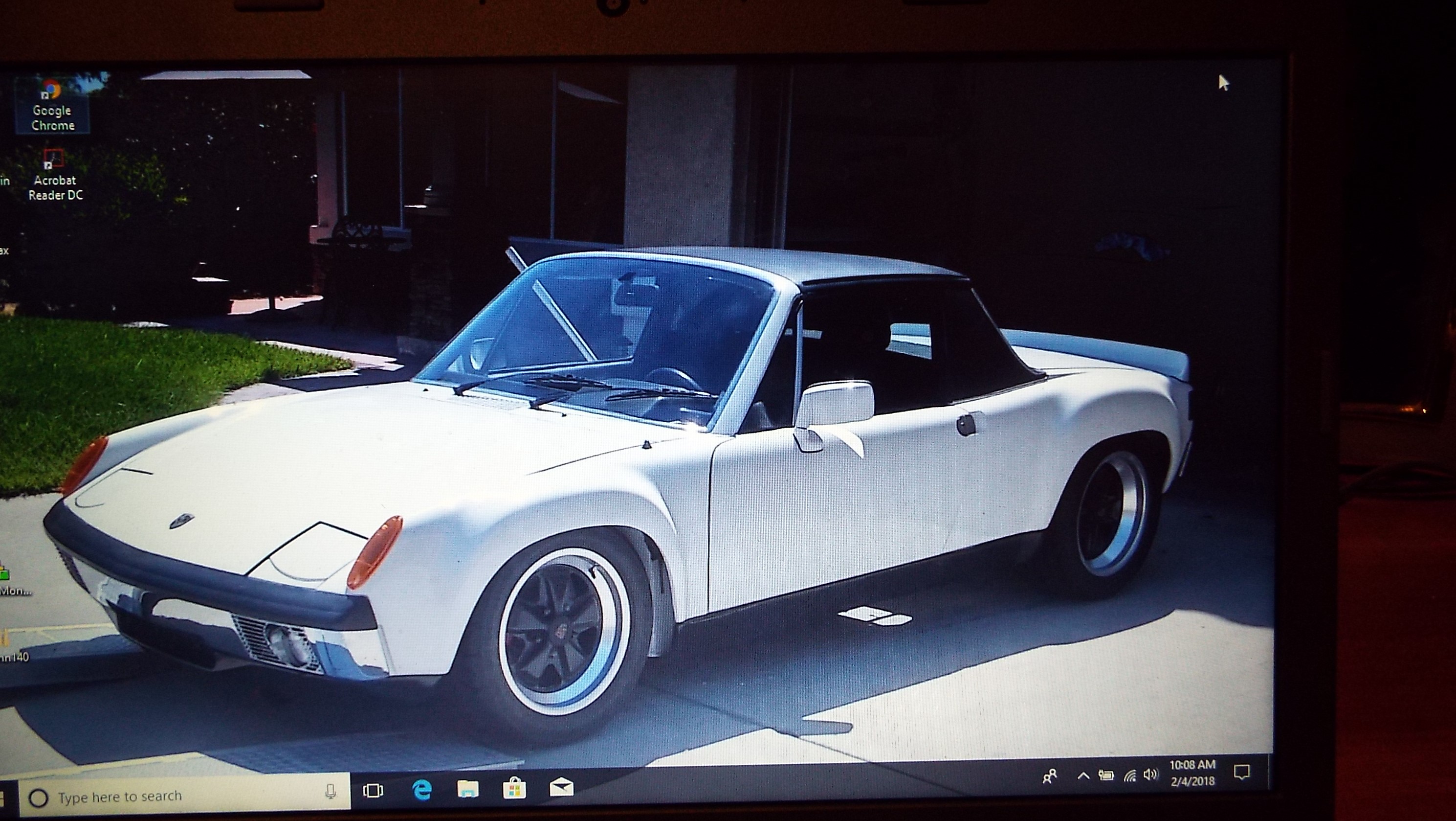

Thanks, I do what I can, but it sure doesn't hold a candle to the work being performed on Cairo94507's car! That's a double Wow! (IMG:style_emoticons/default/first.gif) Or Defianty's car also a double Wow! (IMG:style_emoticons/default/smilie_pokal.gif)
I have some added inspiration now (disclaimer I am by no means a computer guy) (IMG:style_emoticons/default/biggrin.gif)
I just figured out how to change my screen background in Windows 10 and I get to see this all the time on my computer now! (IMG:style_emoticons/default/type.gif)
Unfortunately it is currently on jack stands (IMG:style_emoticons/default/sad.gif)

Called CB Performance this morning and was told the tube is very small for VW. I do not know if they measured or not but said it was 4mm ID and 6mm OD. This could possibly work for 4 cylinder 914 but doubt it would be good on 6 cyl with Webers being fed with AN 6 fuel line.
Thought I would provide the follow up. Thanks again lonewolfe for suggestion. (IMG:style_emoticons/default/beerchug.gif)
Forgot to ask about the nut, might be a good deal (IMG:style_emoticons/default/confused24.gif)

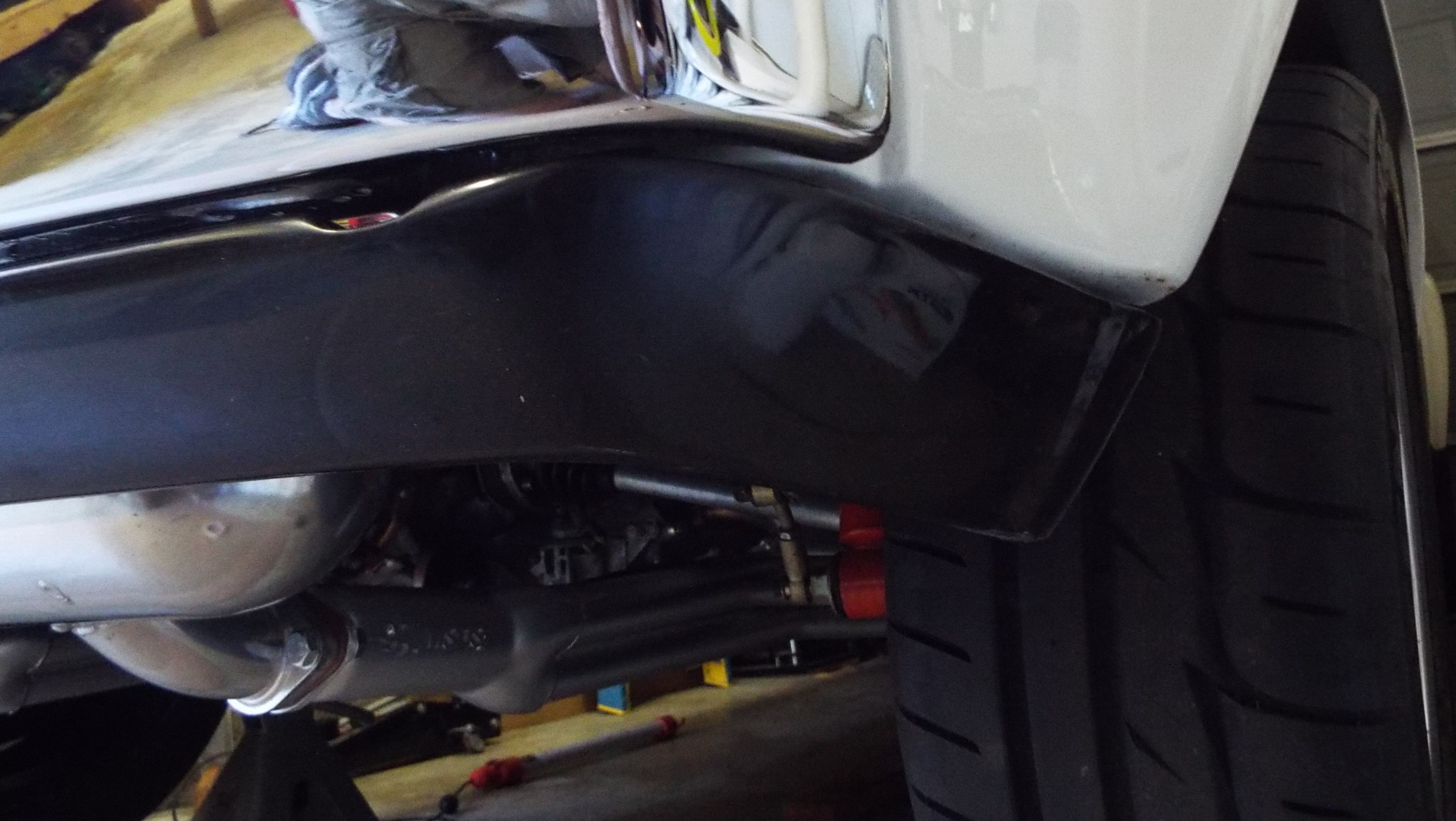

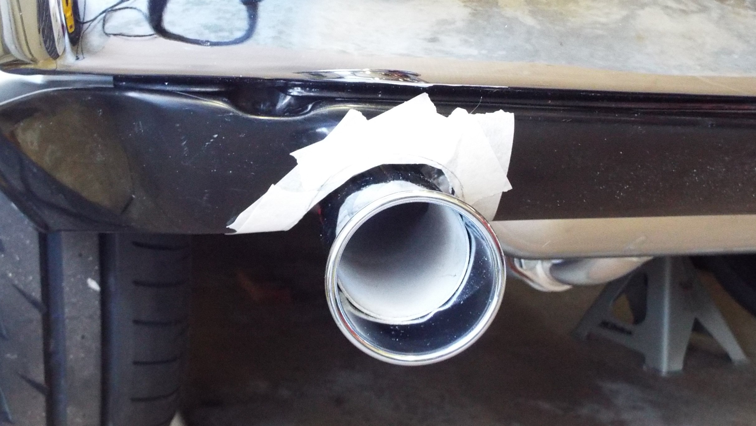

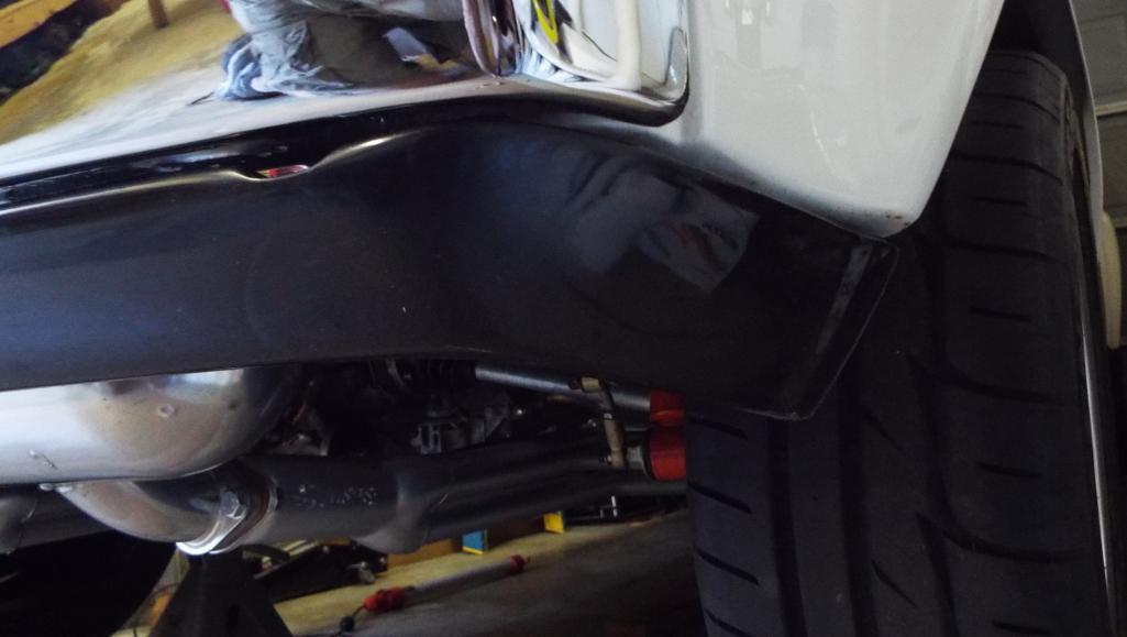

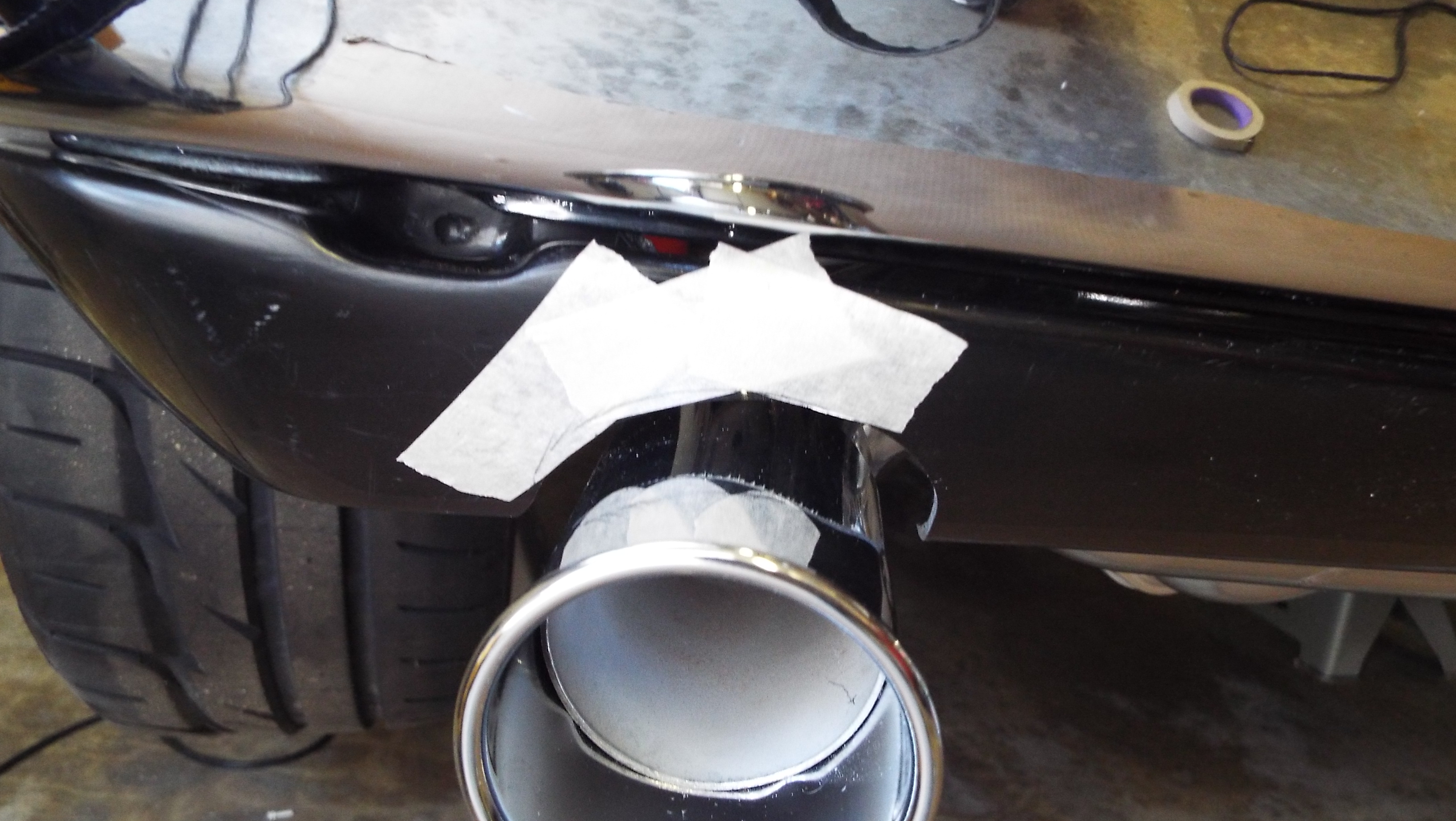

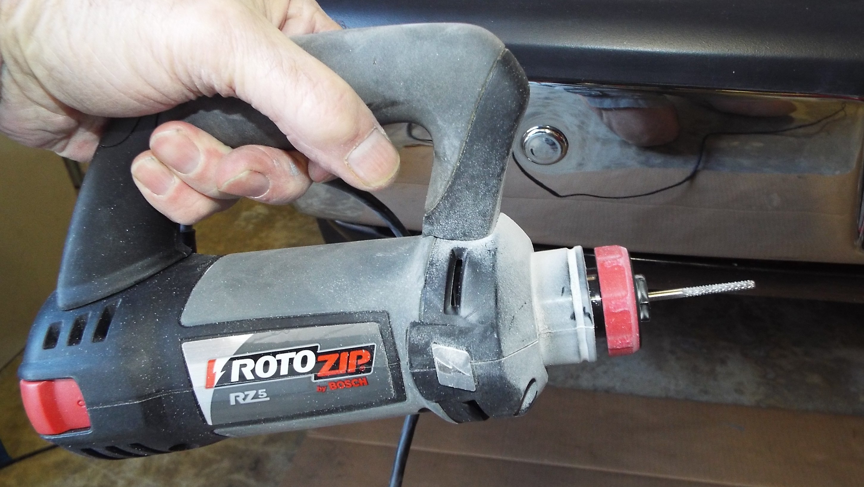

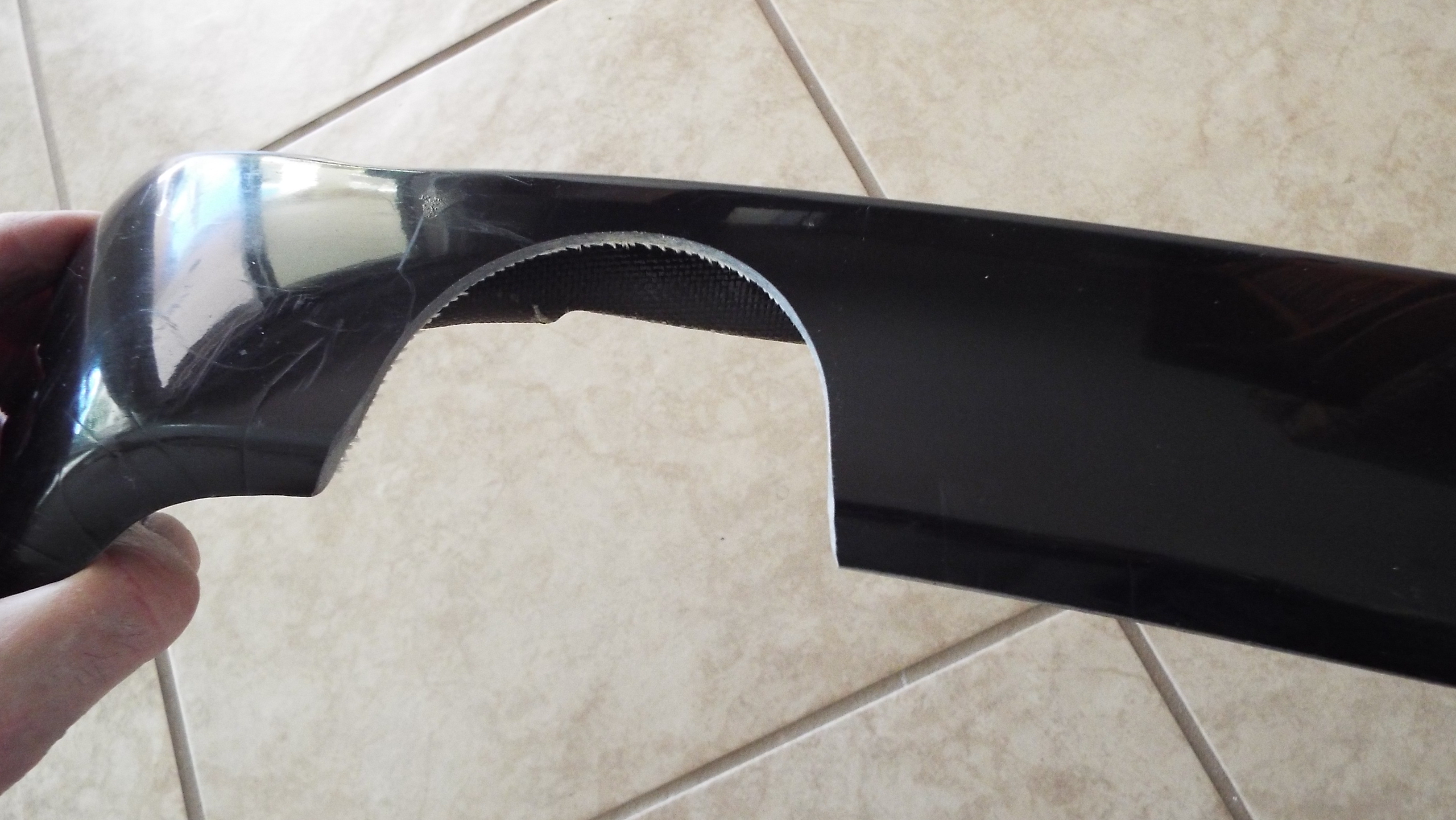

The other project I’ve been working on while waiting parts is fitting Marty Schneider’s cool fiberglass GT rear valance. Nice little piece I was going to do later but getting past the gas tank fuel line issues has provided an opportunity. Figured a roto Zip might work and it does a nice job. (IMG:style_emoticons/default/sawzall-smiley.gif)
Thought of trying to make a template but it just seemed to be such a pain. Took my time and by eye nibbled at it and did several trial fits that got it on close enough to then determine a proper clearance to the tail pipe.
Pencil line generated by tracing a spacer to the exhaust.
Rough cutting got it close enough!
Great fit!
Lucky9146

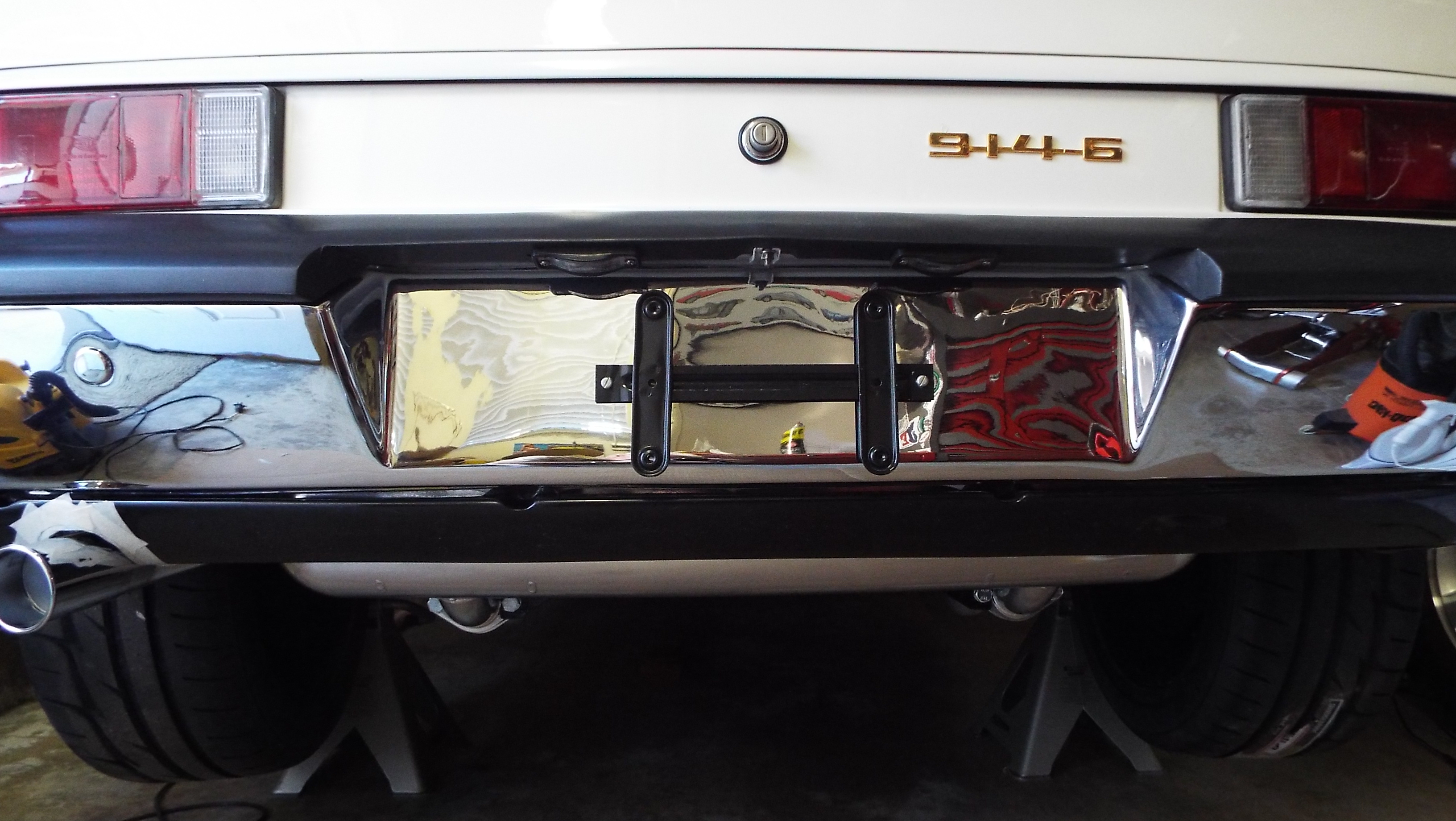

Fitting and clamping and final sanding the opening went great!

All done. Next is prime and paint!

Nicely done Jim and the belt sander (looks like 6" x 48" belt) shapes a perfect mouse house . Looks like you will be having sound as soon as that fuel fitting is sourced !
Marty
Exactly what that sander is and I have done some pretty crazy things with it over the years. I contacted you a while back, and when asked, you advised what you used to cut the valance and of course I had none of that! The sander did a couple of things like allowing me to sneak up on my line and also provided a really nice finished edge. Hoping to get fuel part today.
Love that valance installed pics soon (IMG:style_emoticons/default/beerchug.gif)

Very creative technique for cut out Jim... (IMG:style_emoticons/default/piratenanner.gif)

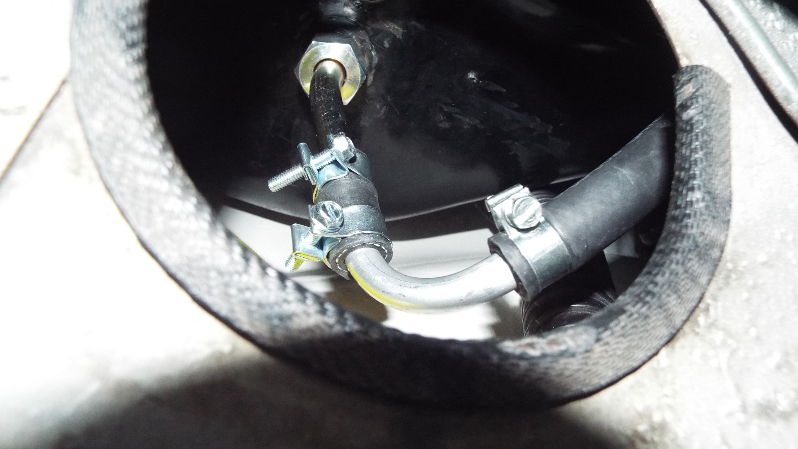

The fuel line nipple arrived today from Bruce Stone and it looks great!
Now to install it is another story. I did not have a stock fuel line set up coming out of the tank. There was no screen and I wanted one. There was just been an AN adapter and an AN elbow going to a hose but now the stock nipple tube coming out of the tank is more angled down making my hose too short. Either remove the gas tank again to add longer hose or get creative. I chose the latter which involved making and adding a different elbow on the end of the stock nipple from Bruce. Lots of fun up in that hole. But thinking now, it turned out better than removing the tank anyway, and the clamps are very accessible. Finally fuel line done back to the engine.

See, I knew you could do it without removing the tank! I'm sure you have some skinned knuckles but still better than tank removal.
I like the elbow idea since it is very easy to kink the hose without an elbow.
