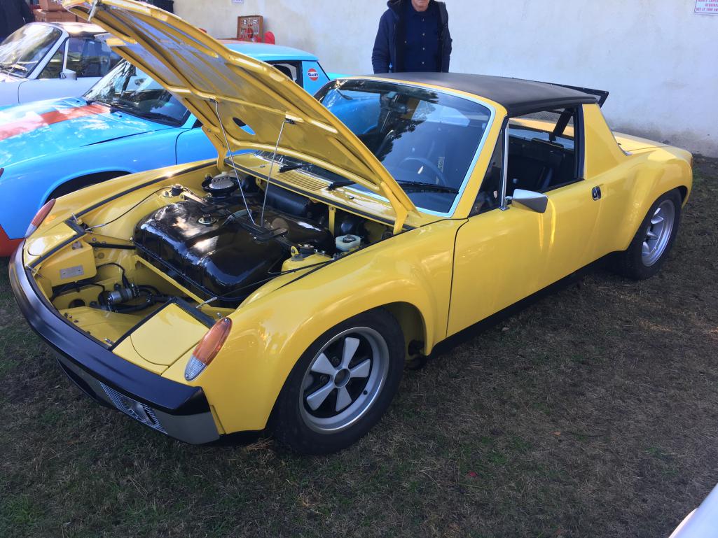

I forgot to take any pictures at the Phoenix Club this weekend so I was really glad to see someone got a picture of me! (IMG:style_emoticons/default/biggrin.gif) (IMG:style_emoticons/default/av-943.gif)
Yup that is me behind that cool 6
Photo credit to 914-300Hemi. He was probably saying to himself get out of my picture! Sorry about that.

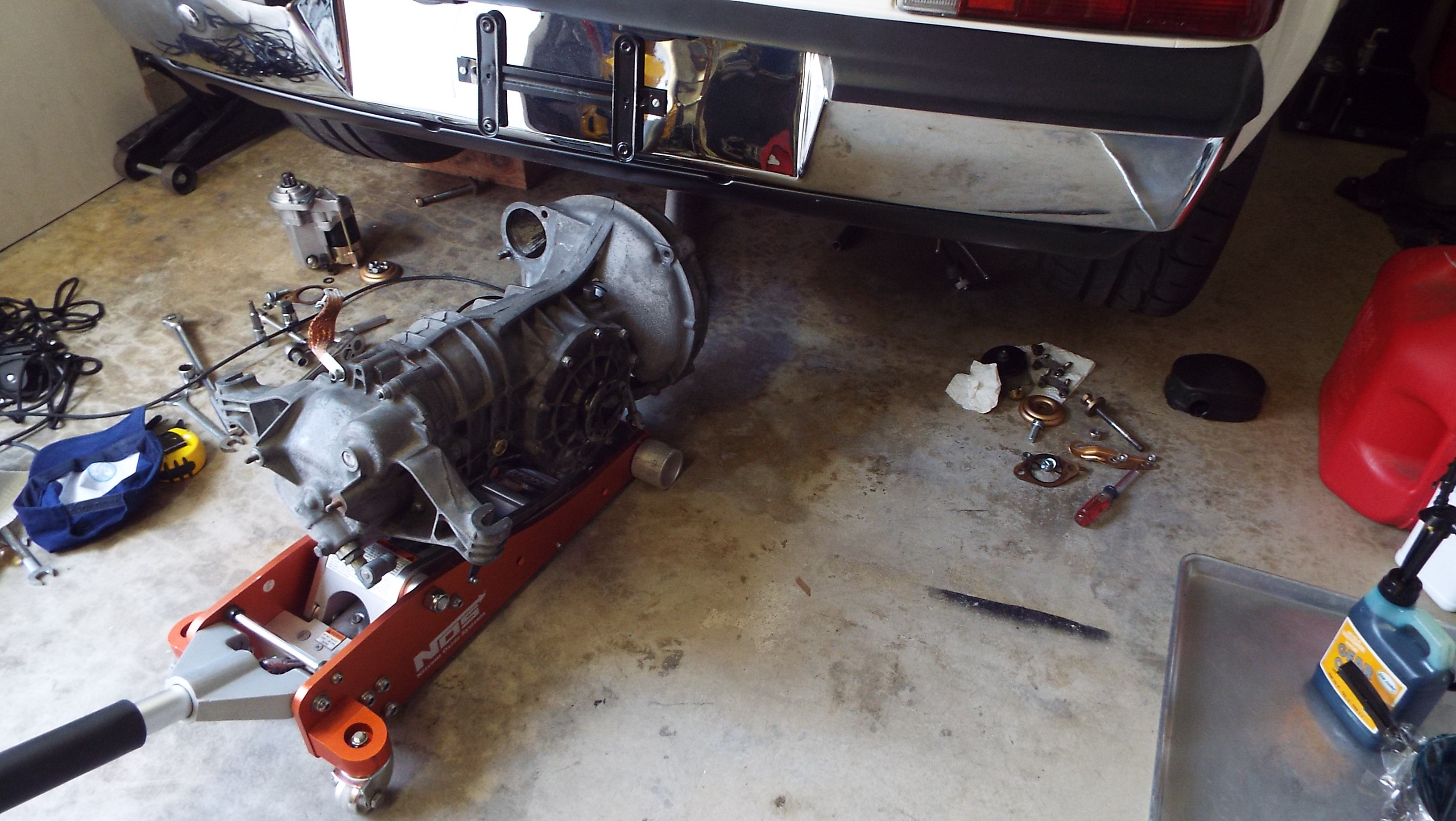

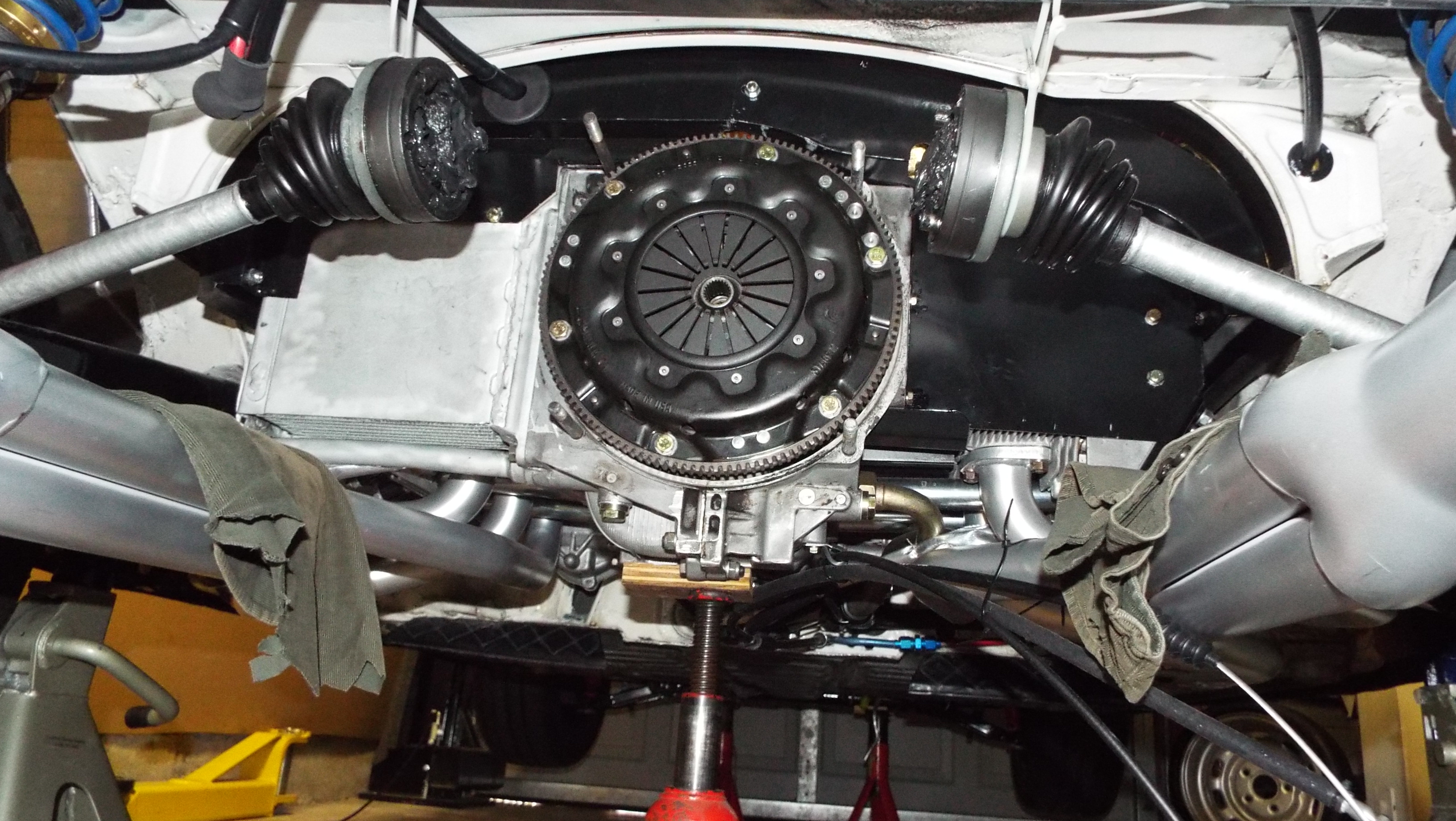

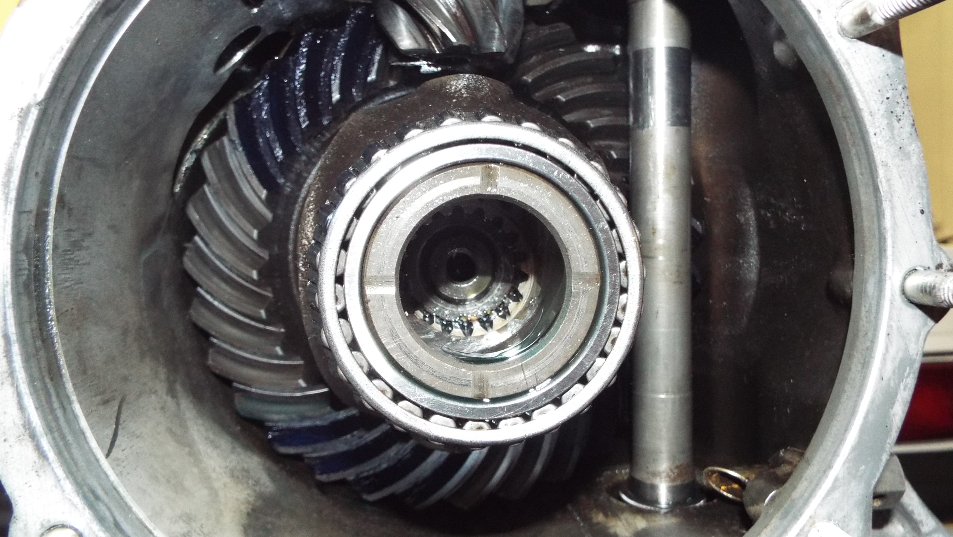

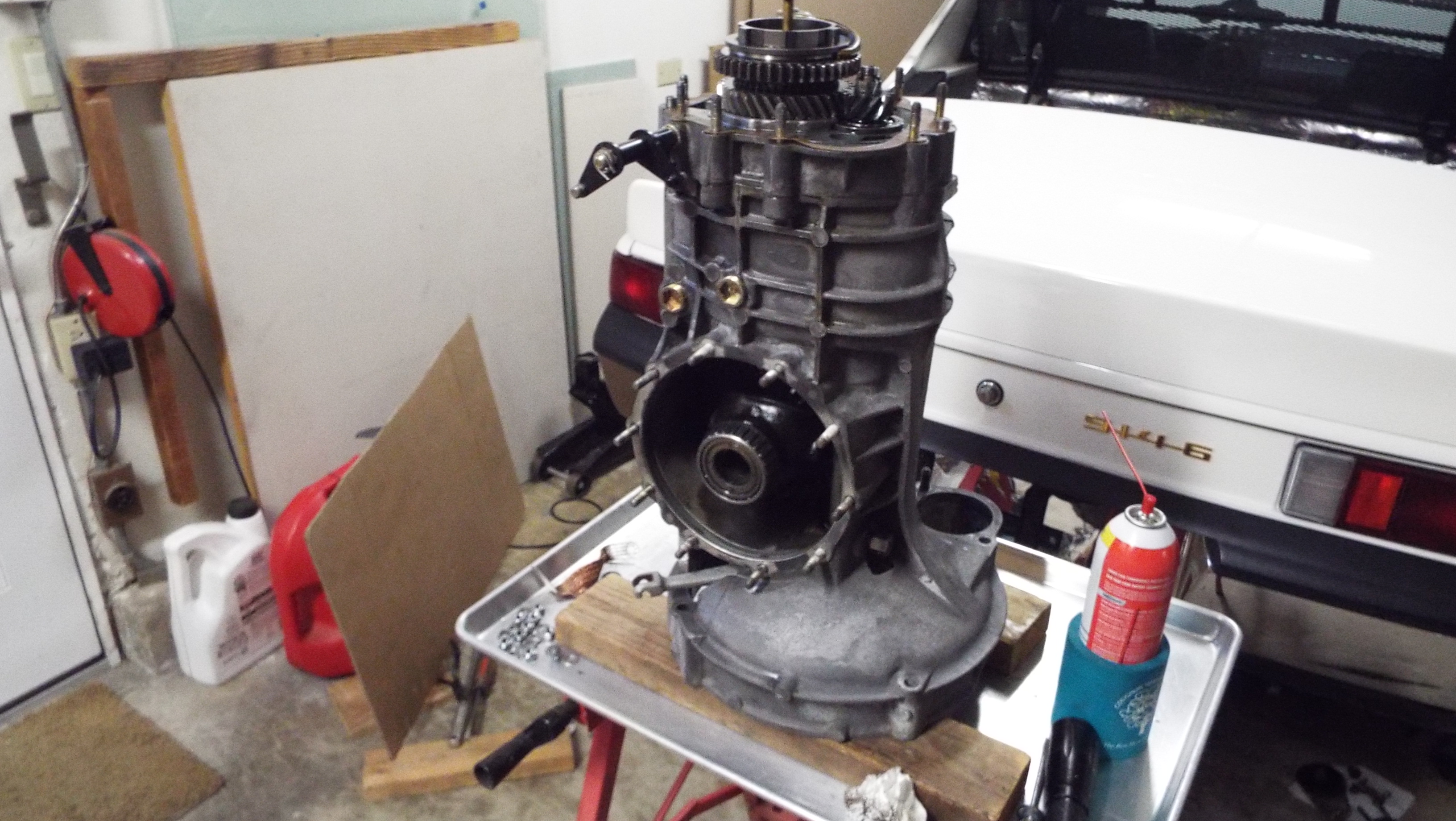

Transmission hiccup now behind me. Well, it's back in the car at least.
Had a few other priorities and just took my time to feel my way through the trans “issue” with the extremely patient helpful Dr Evil. He walked me through many questions and details. Suffice it to say there was a bit more to it than “just pull the stack back and flip the ring gear” as it started out. He has done so many that it is all second nature to him I am sure. Many thanks Dr Evil much appreciated. (IMG:style_emoticons/default/beerchug.gif)
Crud, back out the trans came leaving the engine in place. (IMG:style_emoticons/default/sad.gif) (IMG:style_emoticons/default/smile.gif)
Some how I managed not to get a picture of the backwards ring gear but here is the differential correctly now!
(IMG:style_emoticons/default/white914.jpg)

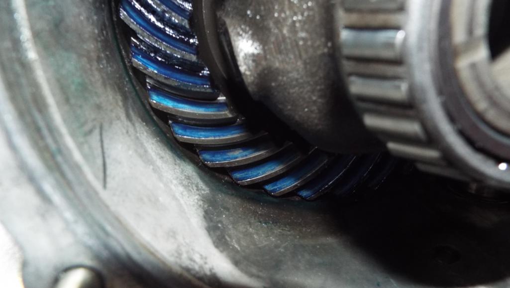

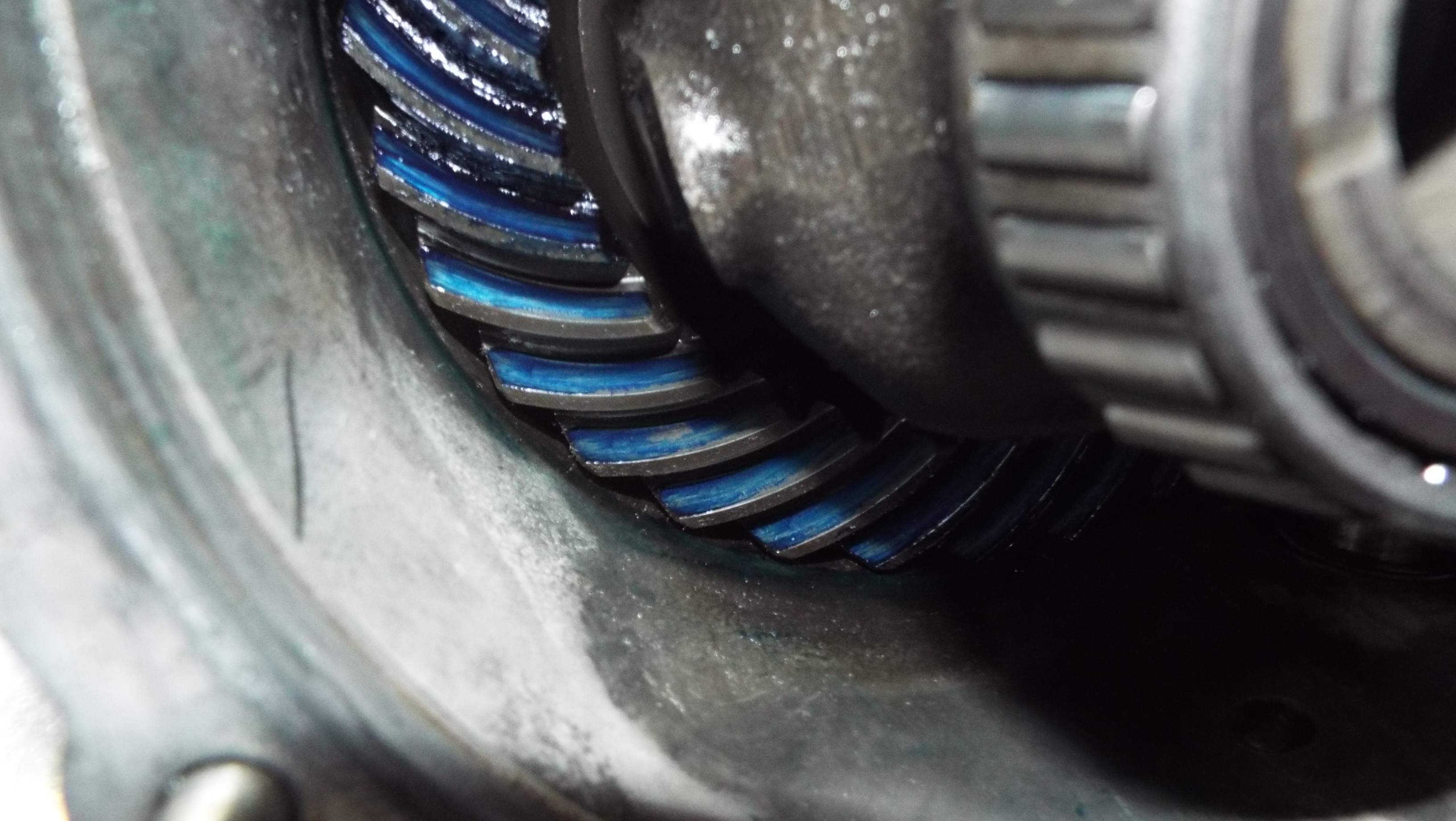

The process
I applied Prussian Blue to 3 areas of the ring gear in 4 tooth sections
Difficult to get a good picture of the resultant pattern but contact appeared to be correct and consistent. The hardest part was cleaning off the blue when done.

The process allowed me to make a few more improvements along the way. Namely better fit of headers, muffler, and muffler bracket, half a day there.
And the home to which it returned. All in all, these are pretty good cars to work on because at first I thought I would have to drop the engine AND trans.
Not too bad really, I was just not in the mood to do it. Schnoor washers and repacking the CV joints and all.

Did not check bearing pre-load and here is why.
I knew the disassembly was done to replace the mid plate with 914-6 mid plate, and a first gear and bearing. So it was more than likely that the ring gear was accidentally flipped. Doesn't say much for the shop I know but there was a tag on the trans stating what had been done. I figure if he was used to 901 trans for a 911, it was an honest mistake. I had a lot of helpful guidance and assurance from Dr Evil on the trans. (IMG:style_emoticons/default/beerchug.gif)
Now should it not pan out over time, maybe I see a 915 trans in my future. (IMG:style_emoticons/default/idea.gif)
