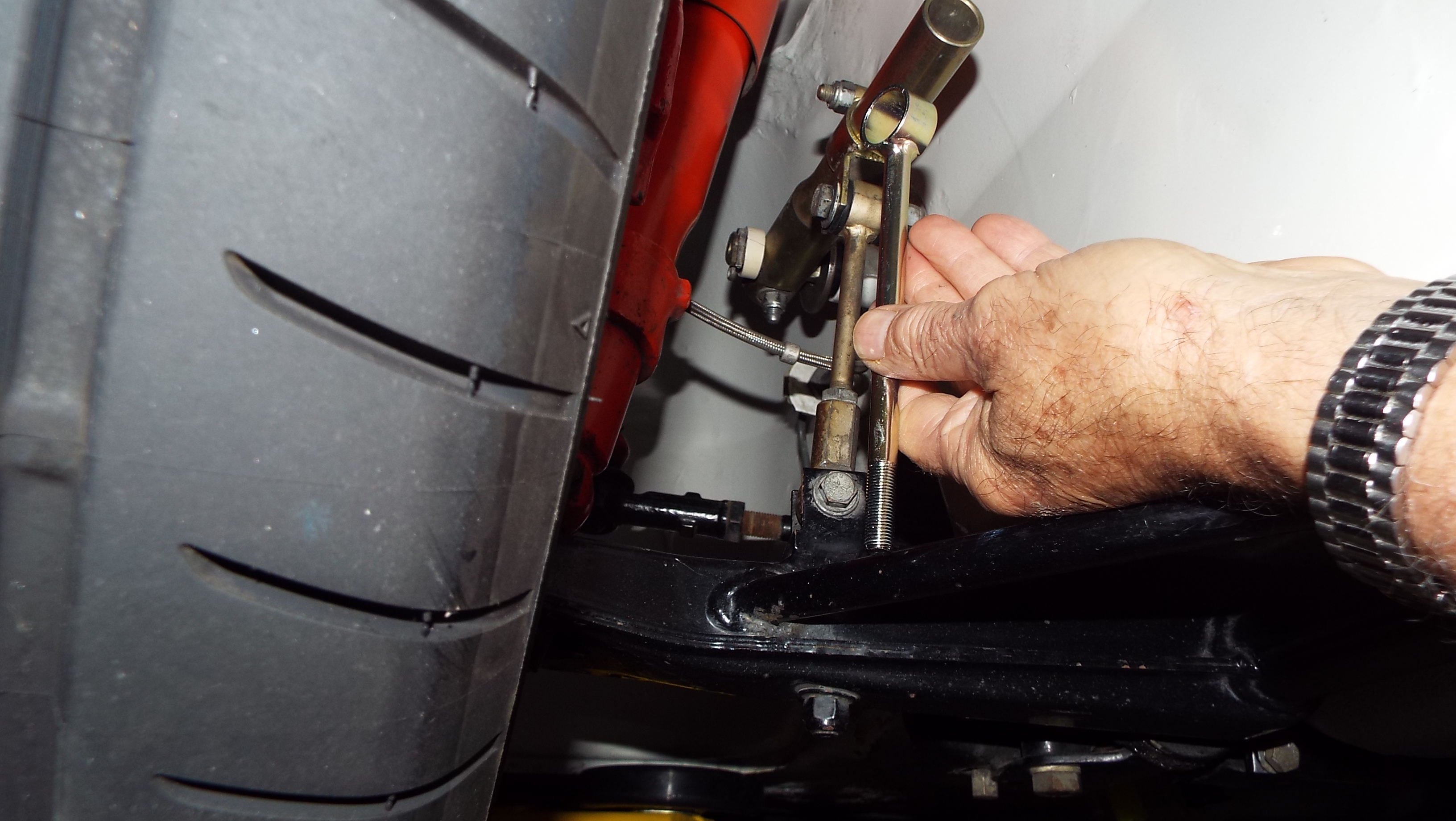

So to finish off on all the drop link discussion last week I received the "correct" Weltmeister 6 7/8", which a few guys here verified the length on theirs, is what the standard Weltmeister drop link measures.
It is plain to see they will on work on this car, which apparently was lowered way back in the day by about 2 inches. As I said it drives just fine as set up. Case closed. (IMG:style_emoticons/default/smile.gif)

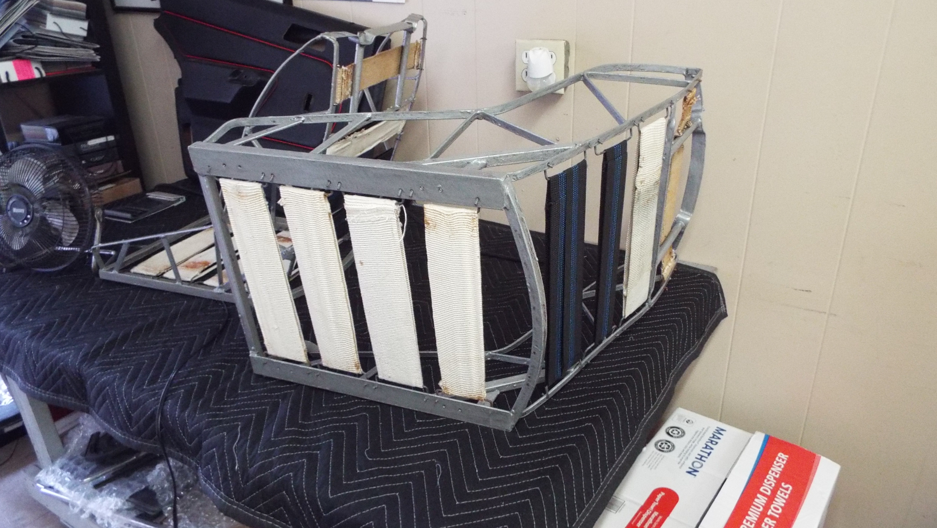

Seat Update

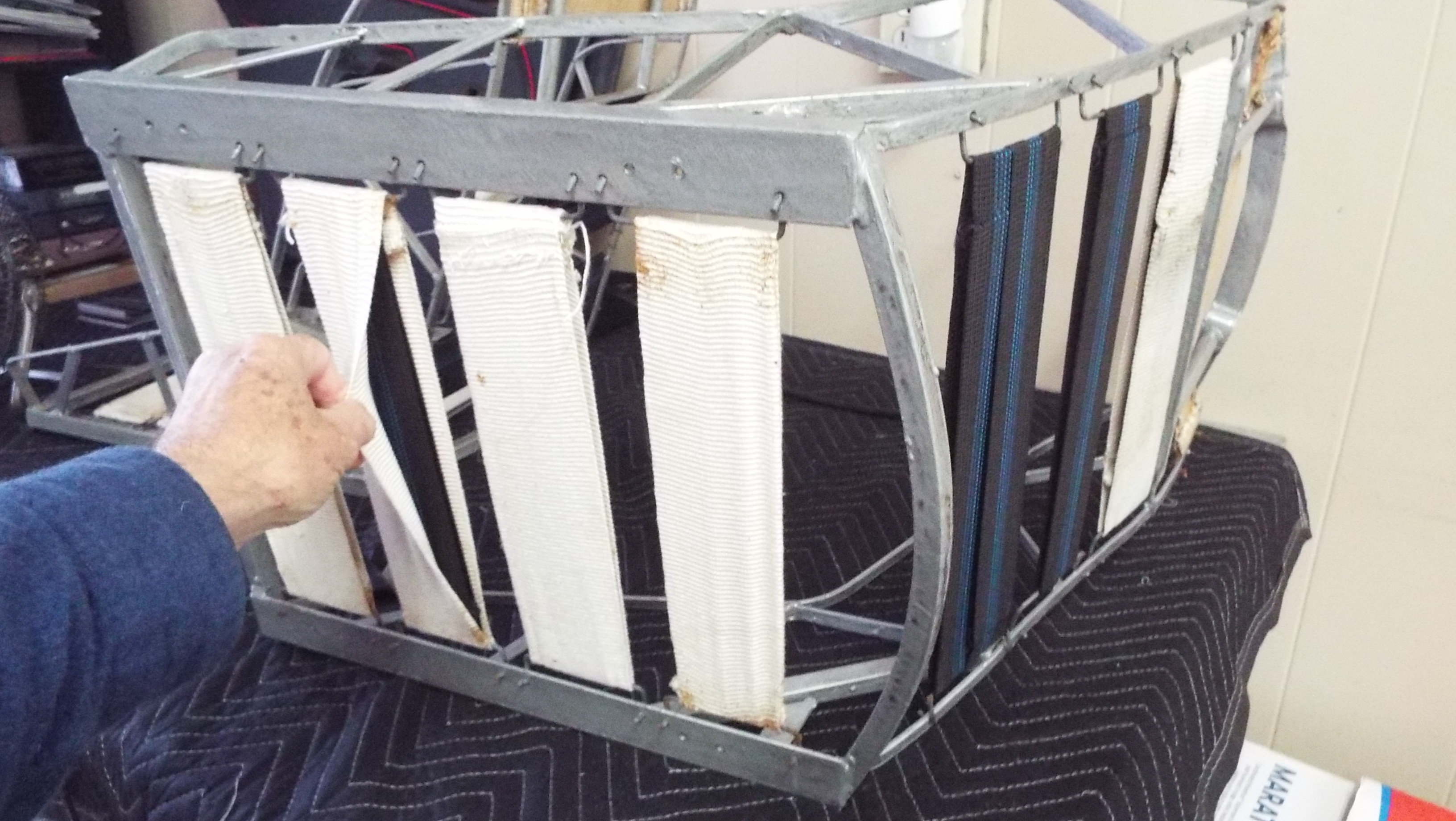

My upholsterer is pretty resourceful. Original webbing in NLA. He took the "best" of the old webbing (elasticity is pretty much gone) and reused it to make it look like the original webbing was still there on the bottoms.
There was just enough of the better looking stuff left to do it on both seats! Inside the old webbing he put new. Very creative! (IMG:style_emoticons/default/pray.gif)

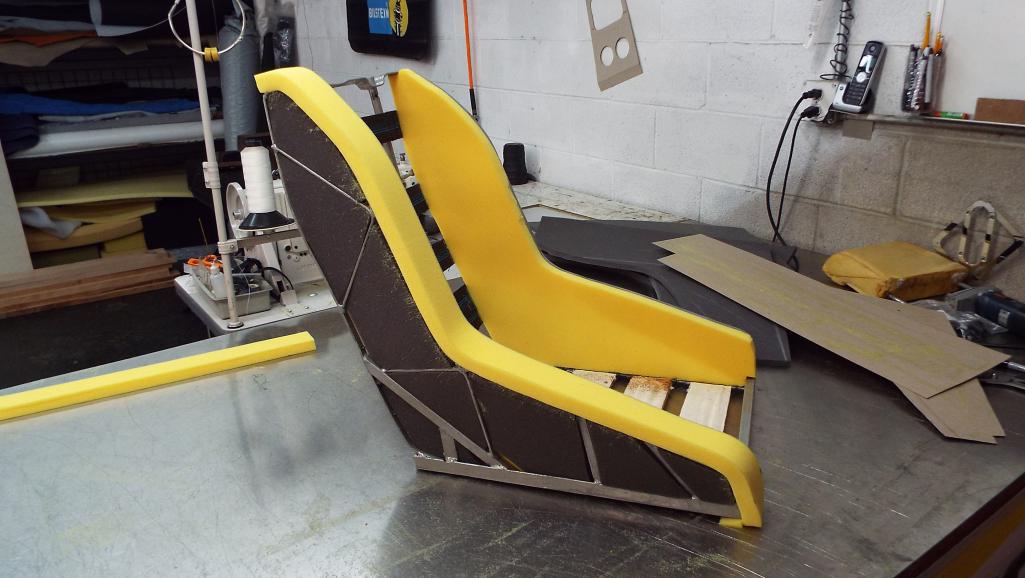

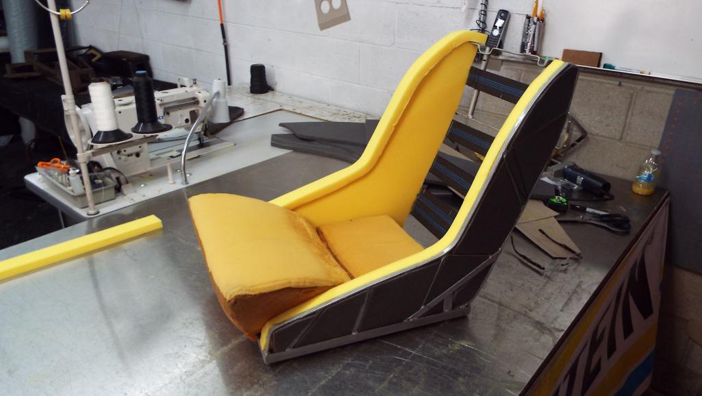

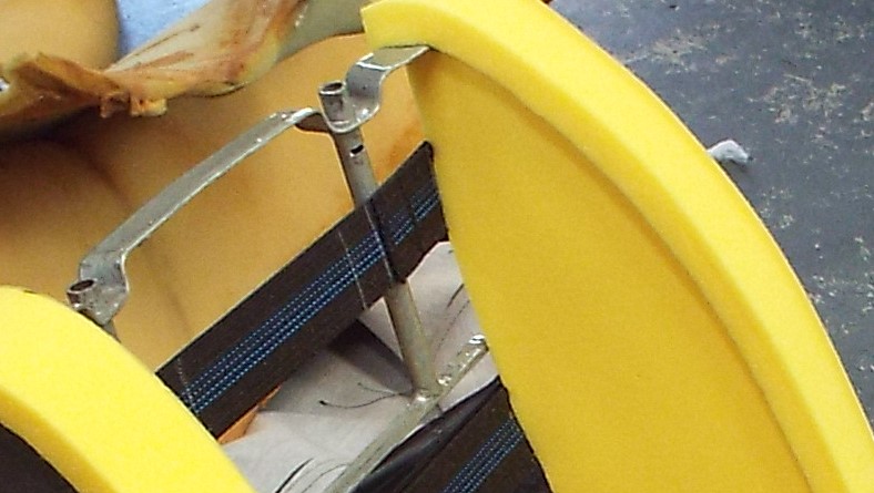

Next Update on the seats

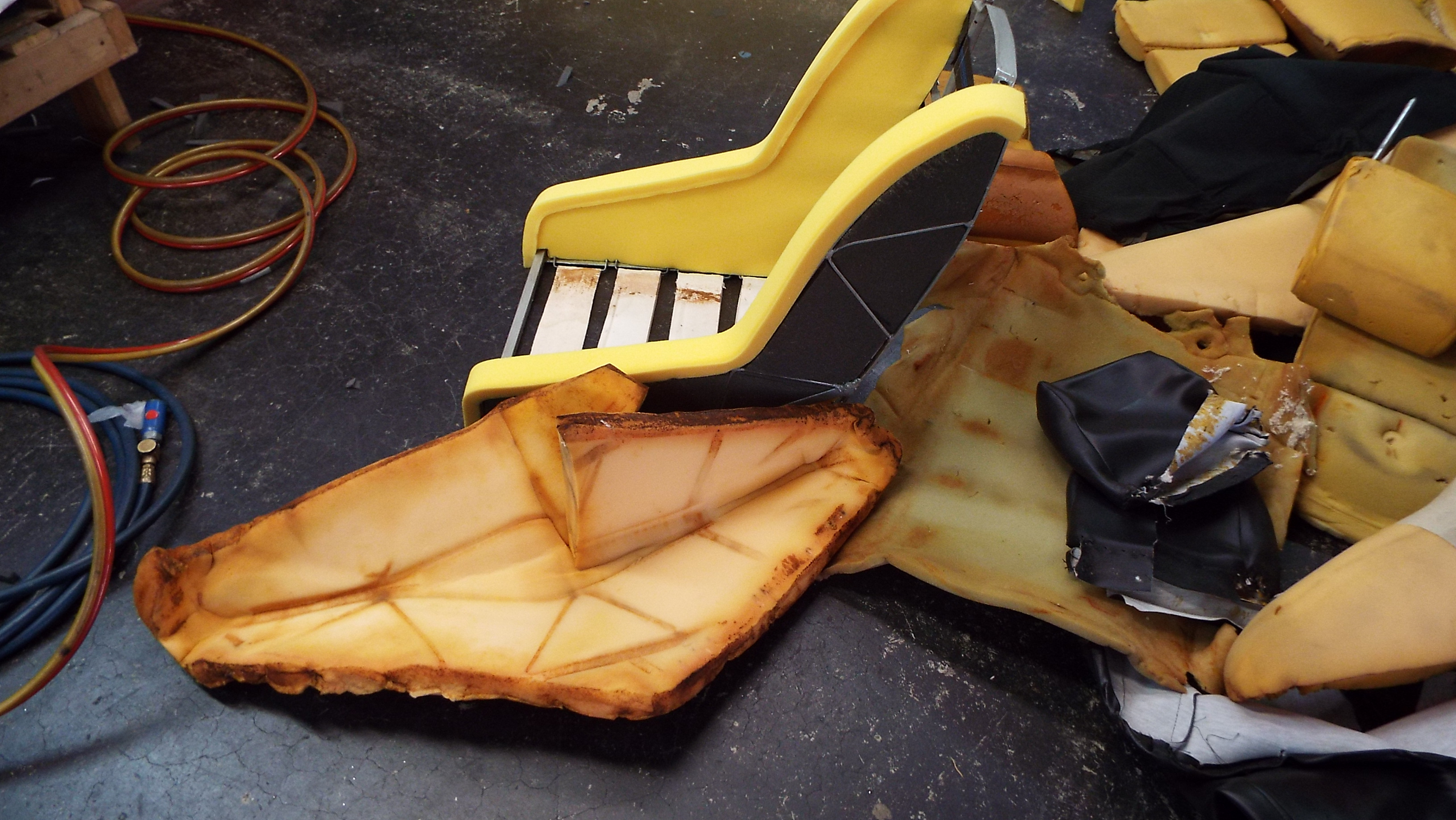

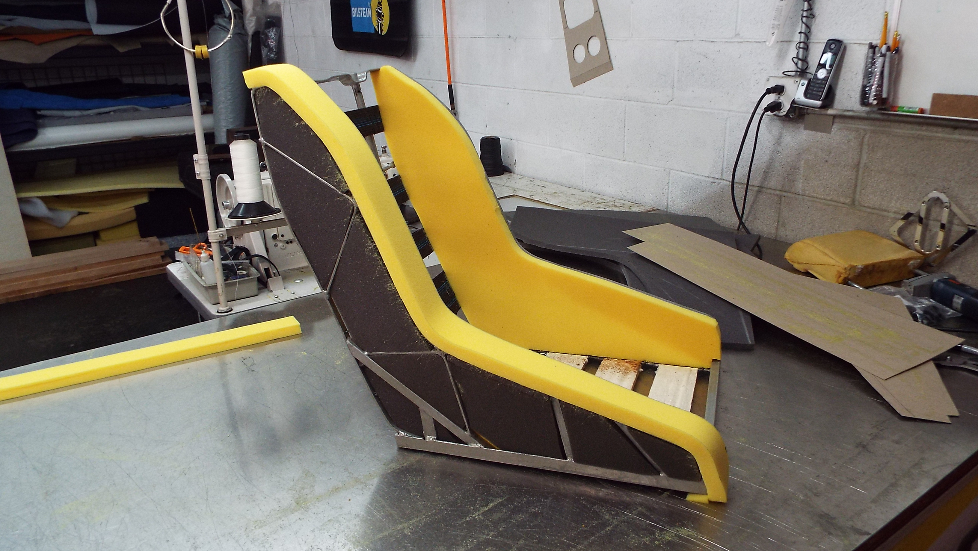

He starts with the inner wall foam (yellow) and then fills all the frame cavities with foam (gray). This method provides strength to the inner walls and prevents them from sinking into the frame. Then he adds foam to the top rail.
Here is a picture of the old foam used where it was just one piece wrapped around inside and out, which makes for a bulkier look because the foam is always pushing outwards against the vinyl.
He told me to bring the head rest grommets next time up as he needed them.
Hmmmm interesting.

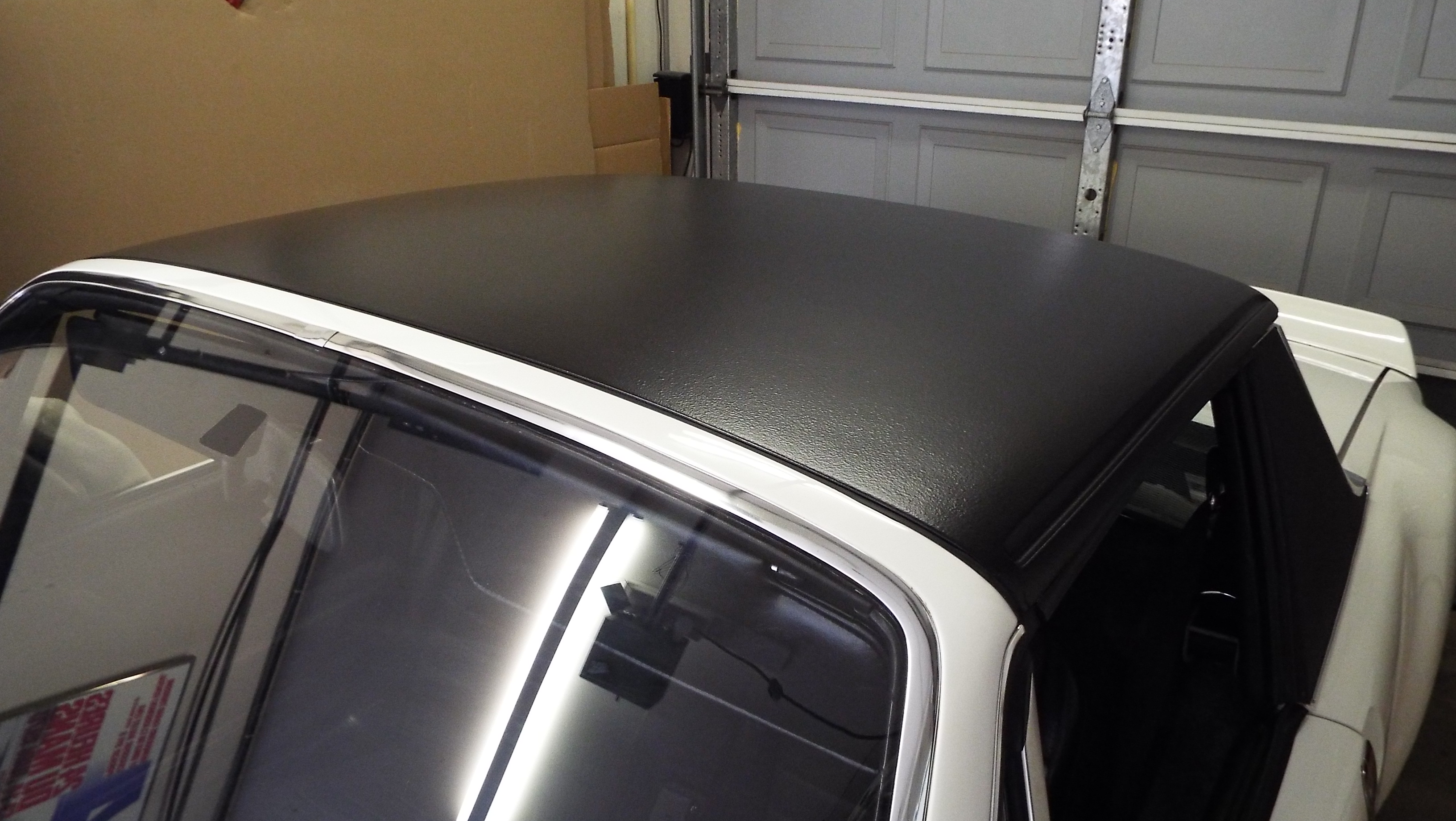

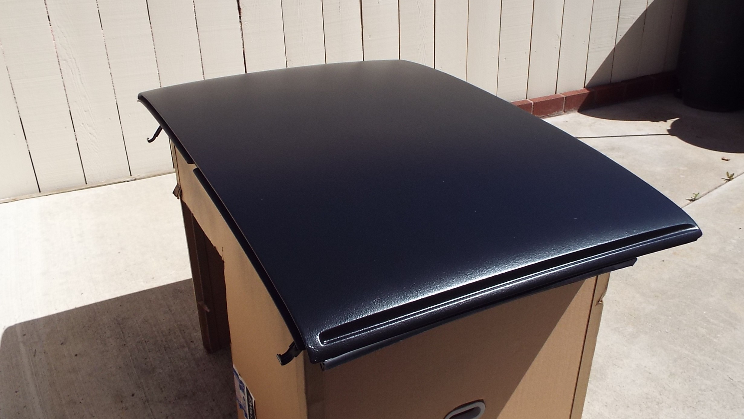

Last weeks trip to local Cars & Coffee brought to my attention the targa top. I had long thought it was “ok” but now outside it clearly wasn’t and I could clearly see it needed a paint job. I have seen many threads about painting the targa top and decided to paint it with SEM Trim Black as a recommendation from a friend. Spray can on a large surface is not the greatest because the fan is so small.
After 3 attempts I still was not satisfied. It was a combination of things the gave the poor results. Number one with that small fan you really have to keep the “wet line” going or you end up with zebra stripes and I have been painting for years. Maybe shoot a little slower and heavier coat helps. Number two there must be no wind and that is maybe the most critical with the small fan too. Number three the SEM product is good mind you, but I don’t think it really likes spraying that big of a flat surface all at once (with the can horizontal for a prolonged period of time) because early coats sometimes the nozzle skipped or sometimes spattered and it usually happened 5 inches before you could get to the other edge. (IMG:style_emoticons/default/barf.gif)
Today was a total success, no wind, good coverage, cooperative can. Nice sheen, not shiny, and a good finish. (IMG:style_emoticons/default/smile.gif)
