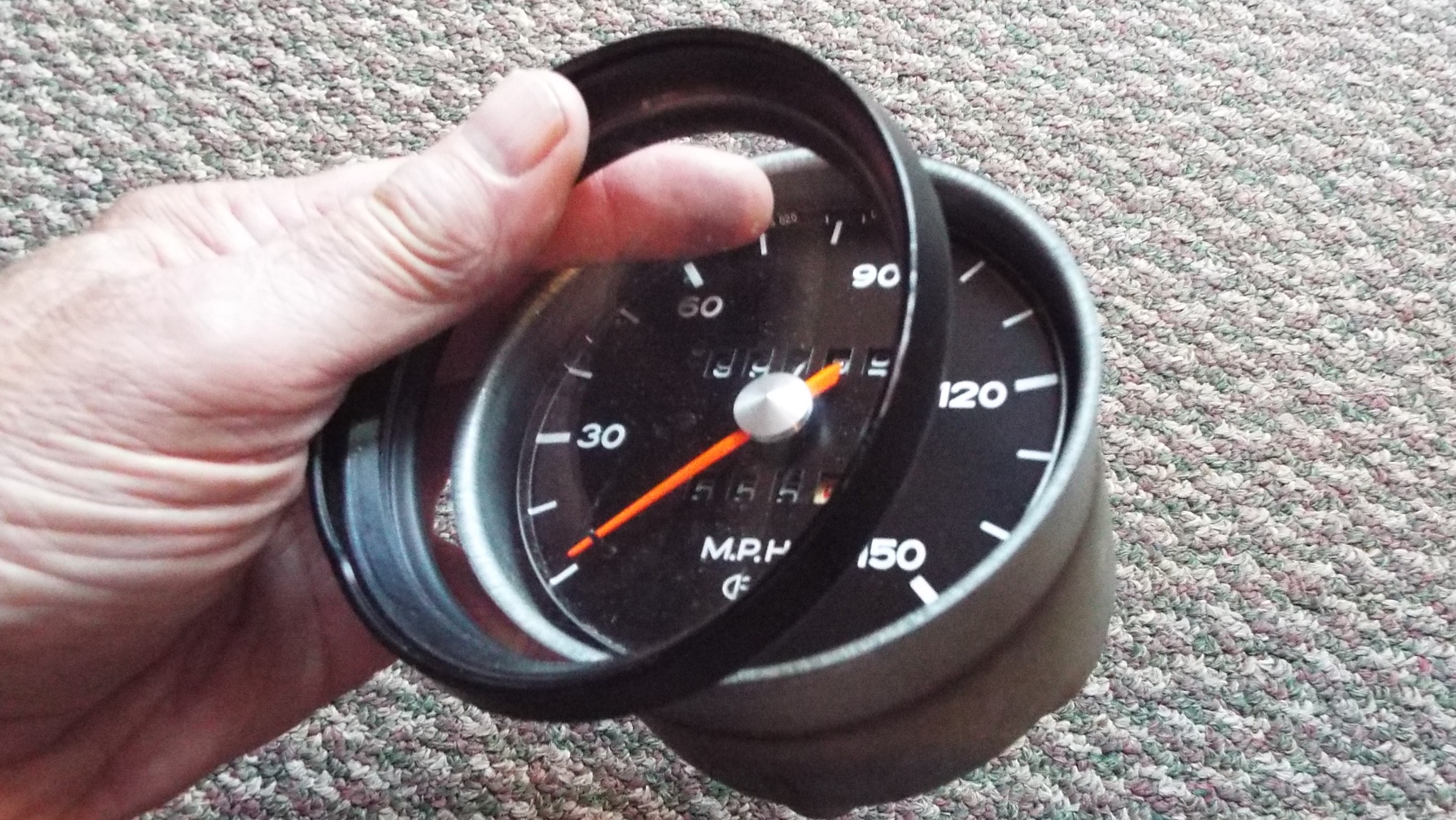

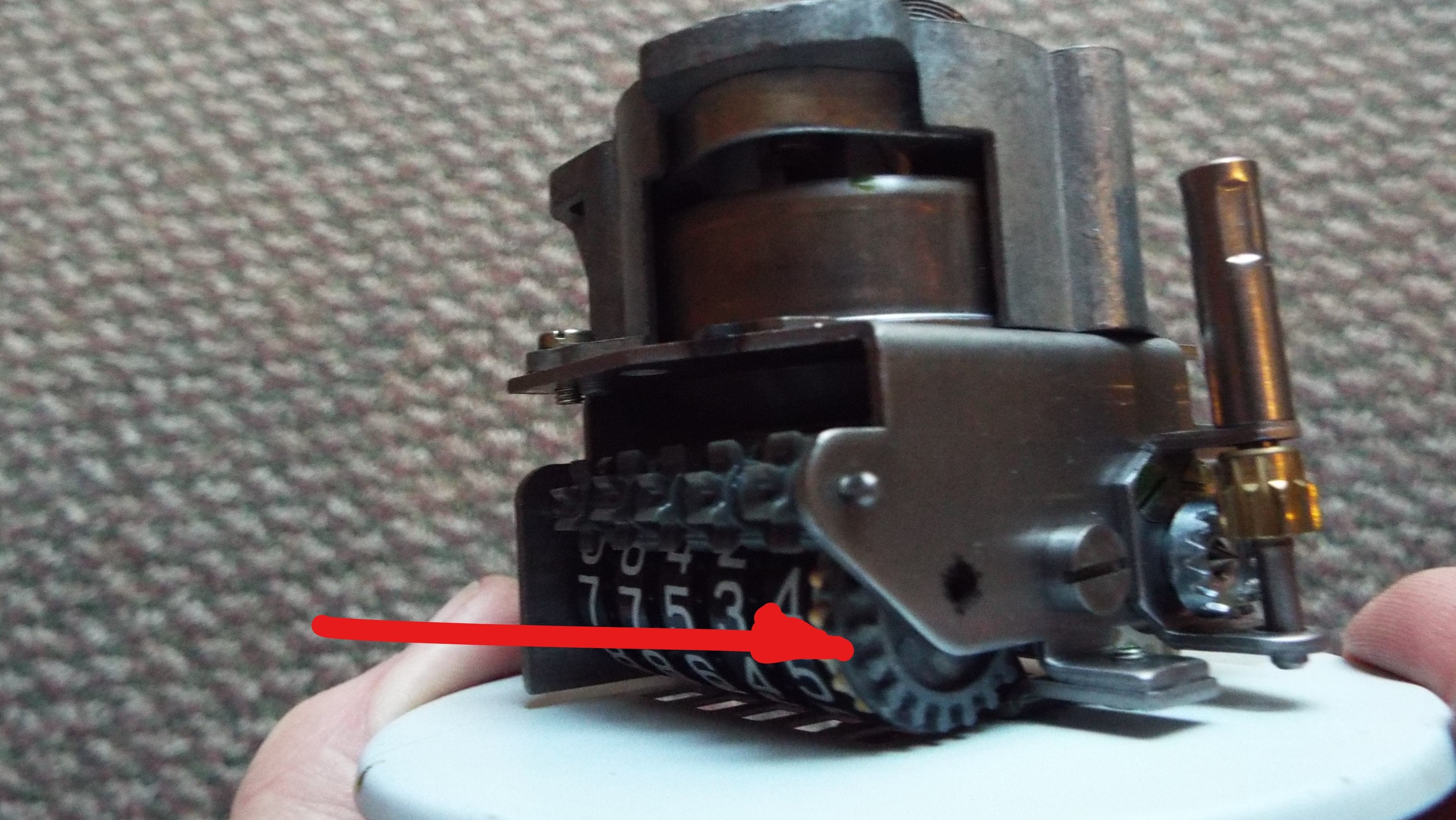

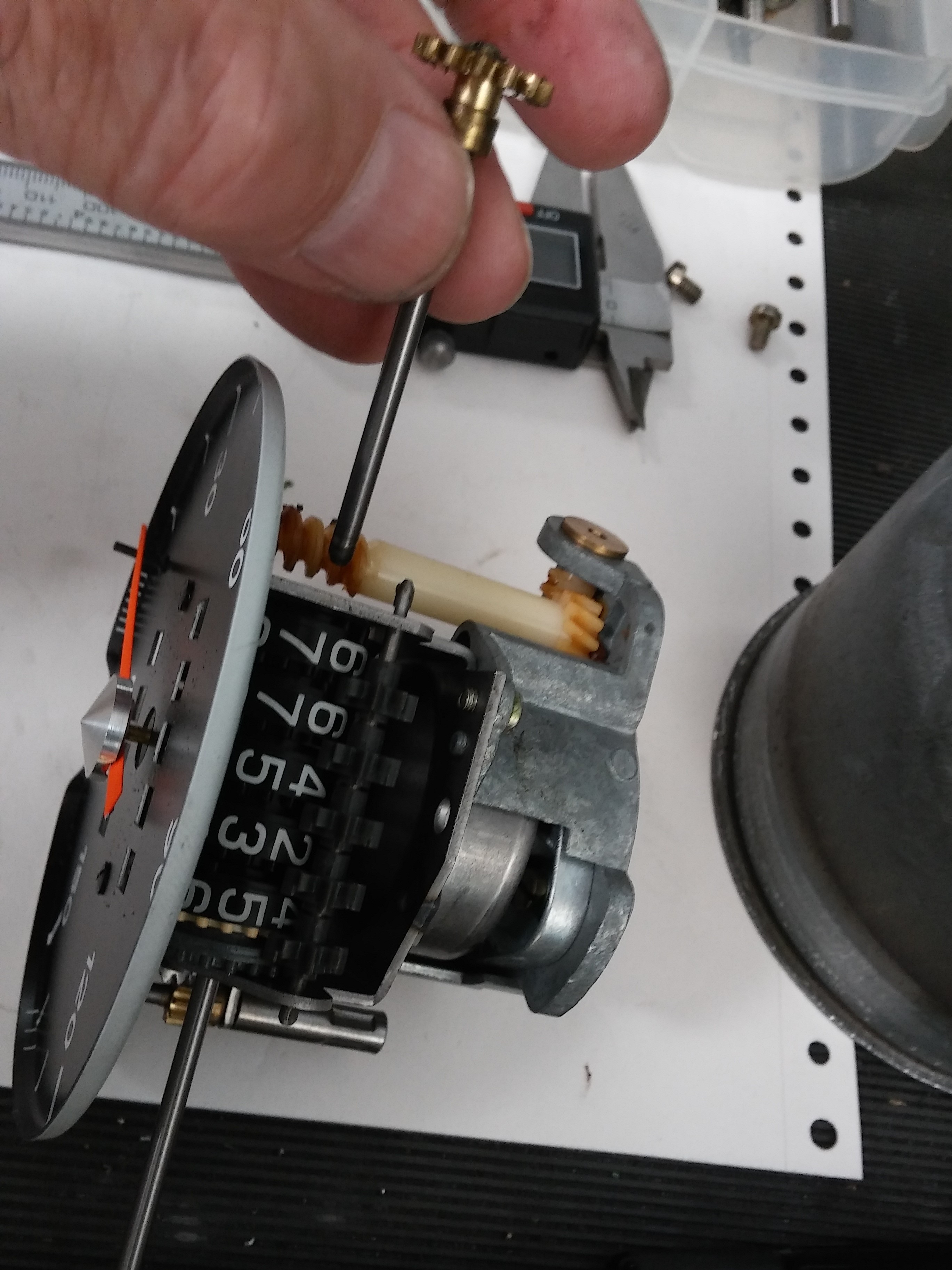

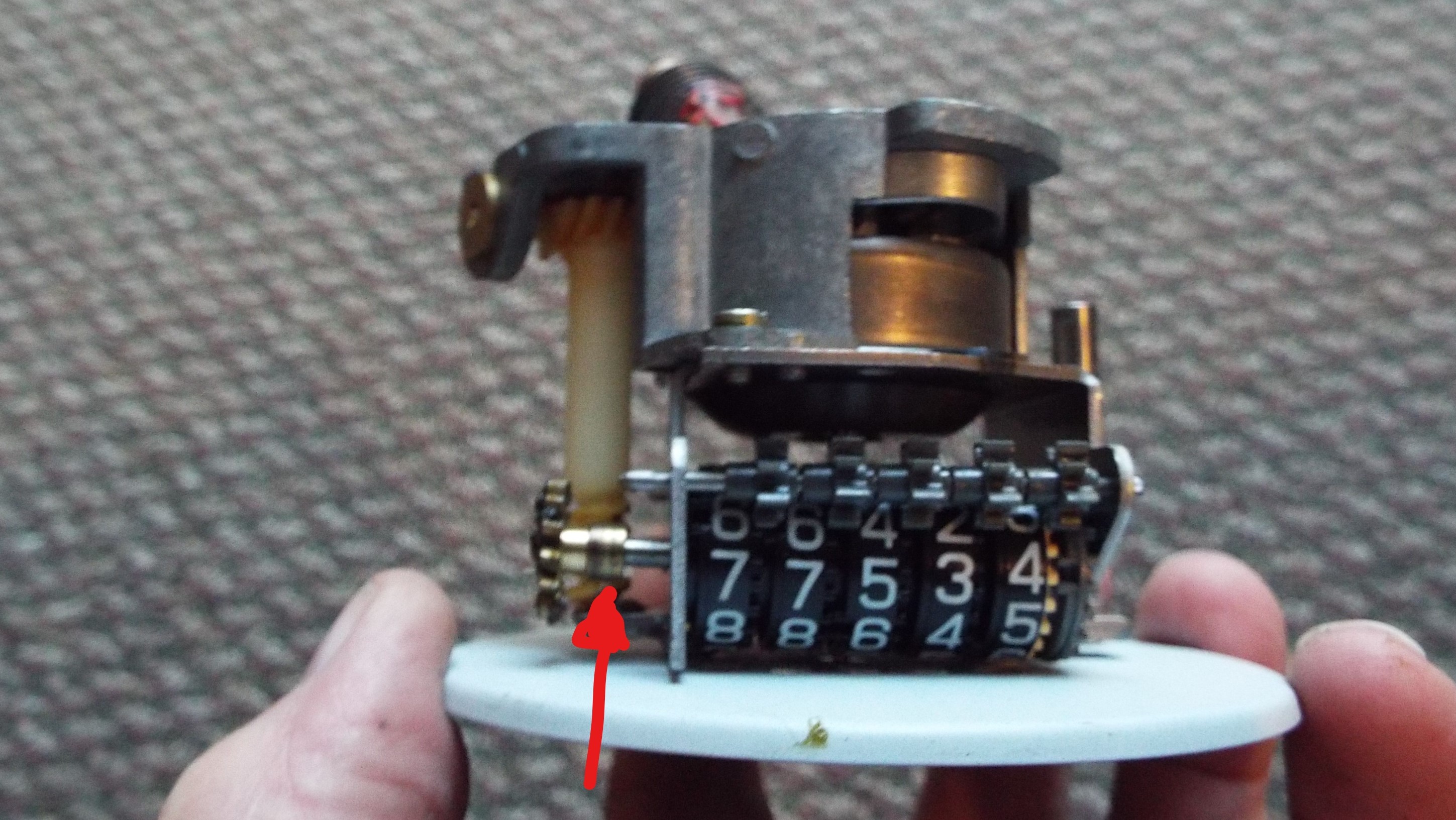

Finally addressing the Odometer!
The odometer has not worked since I got the car running in late March. Speedometer works just fine.
Usually an odometer that has stopped working is a broken plastic gear. I have never attempted to repair an odometer, but how bad can it be? (IMG:style_emoticons/default/confused24.gif)
So here goes....................
Once open, I found the main shaft that all the numbers ride on had come partially out of the housing and was no longer in contact with the worm gear at this end.
Cool, no broken gear but now what?
You can see the entire number cylinder has fallen away from the drive cogs at the other end because it was out of the housing.
I realized this metal gear would normally be pressed on the shaft was no longer being driven by the shaft. Also, this gear pressed on feature holds the shaft in place.
Since I was headed to Toolguy's house to pick up the metal wheel nuts, Might as well see what he thought about getting the shaft to drive this gear again.
(IMG:style_emoticons/default/driving.gif) (IMG:style_emoticons/default/white914.jpg)

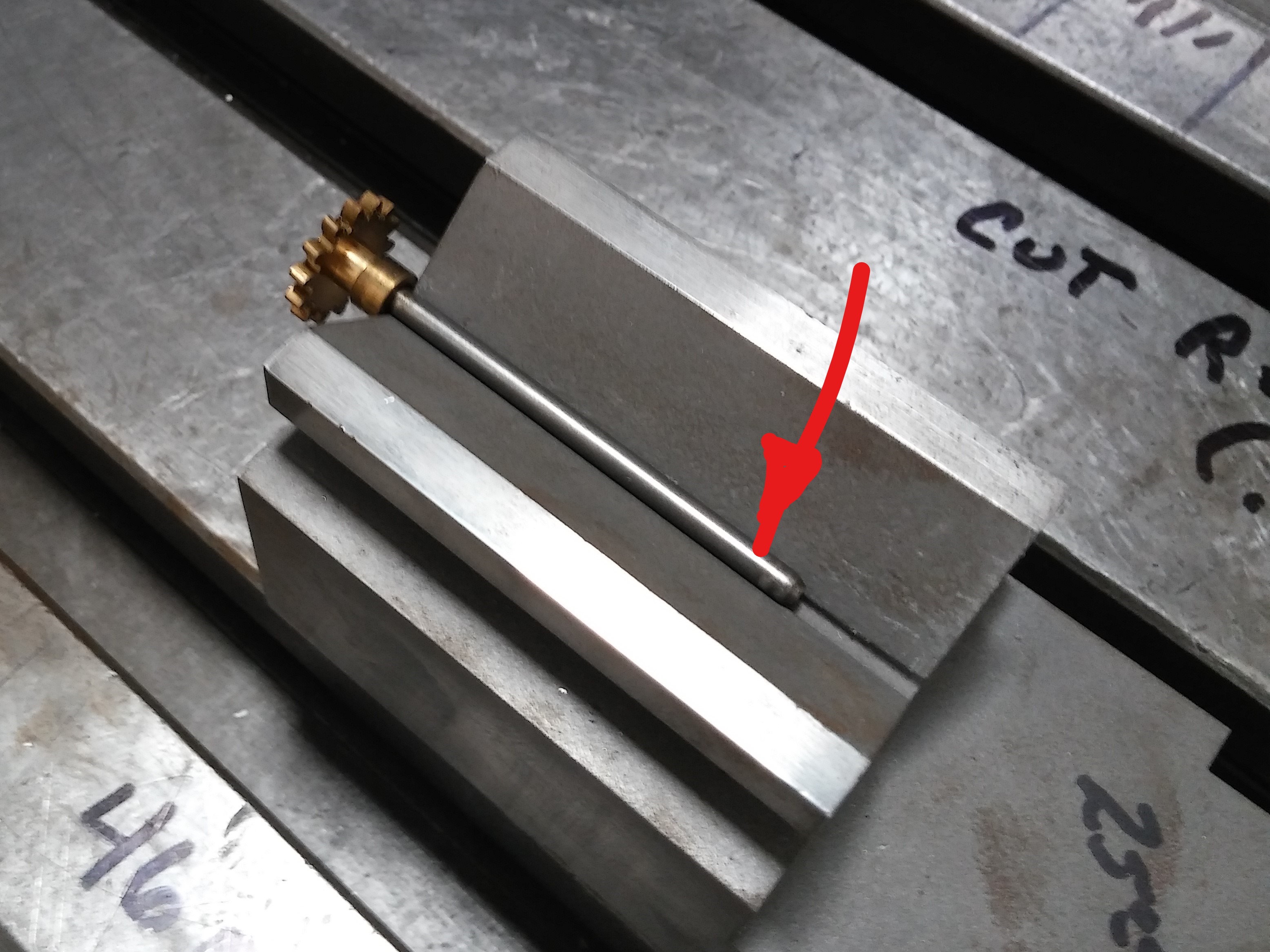

Lucky9146
post Jul 14 2018, 09:13 PM
Post #787
Posts: 1,711
Joined: 22-September 14
From: Poway California
Member No.: 17,942

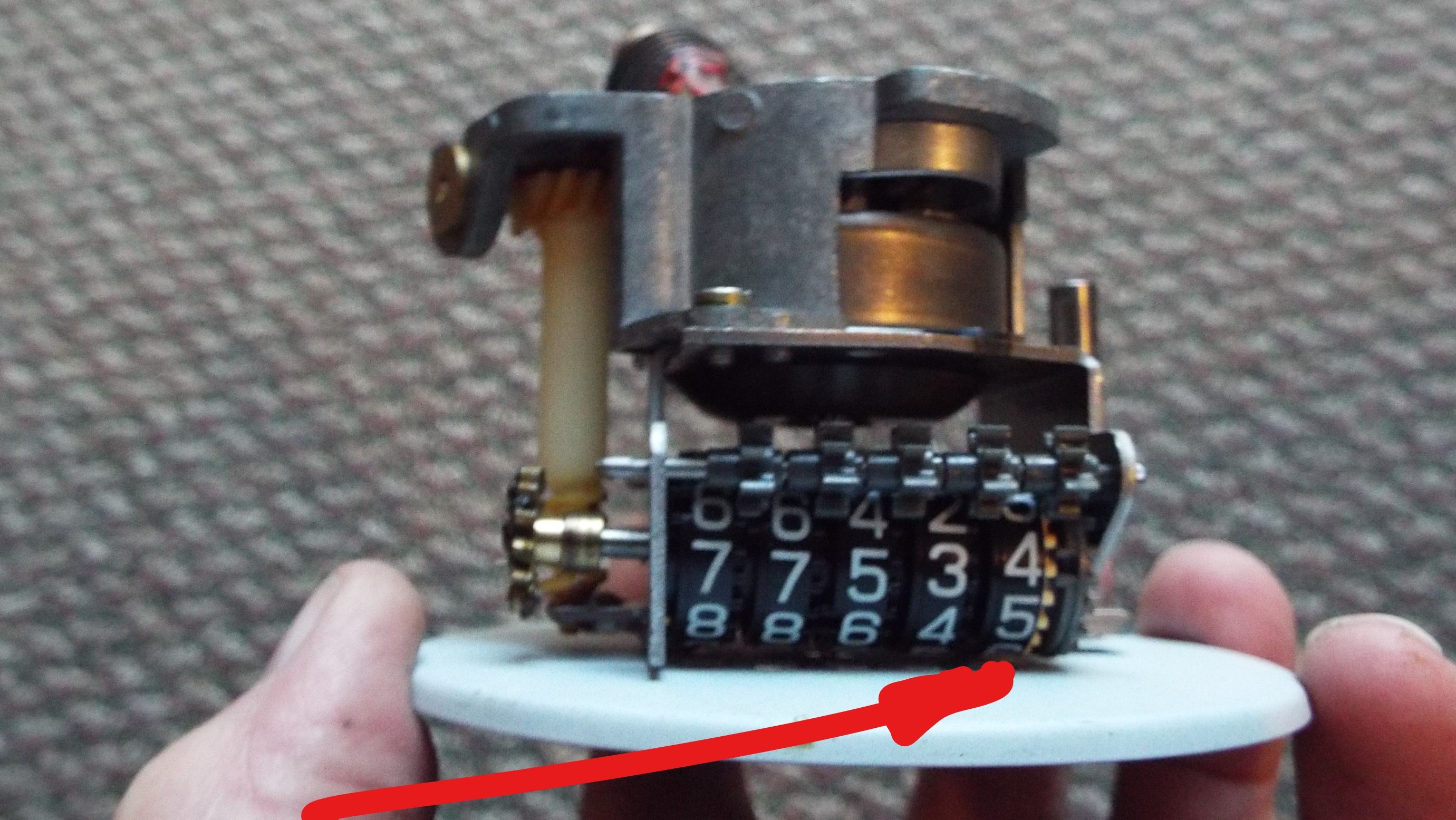

Toolguy suggested inserting a rod of the exact diameter of the shaft to push out the drive shaft and keep the spindle all in tact.
We then placed it in a V block and made small punch marks around the shaft where the gear rides.
Then we drove the shaft back through the housing where it grabbed the gear very well and after a couple tests with a drill driving to turn the speedometer about 60 mph it is good to go!
For some reason i thought the gage face was glass, but it is plastic, so I got that all spiffed up and all the scratches out too. I was able to reinstall the bezel as well!
Many thanks to my buddy Toolguy for your help! (IMG:style_emoticons/default/beerchug.gif)
Drove it today to C&C and it works great.

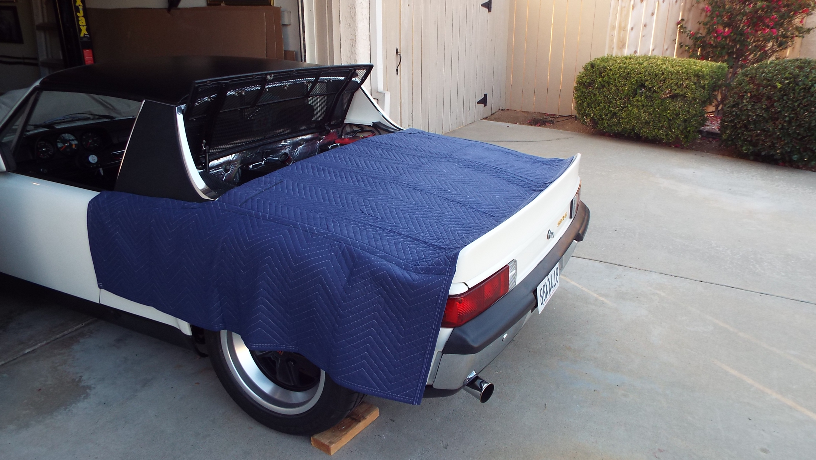

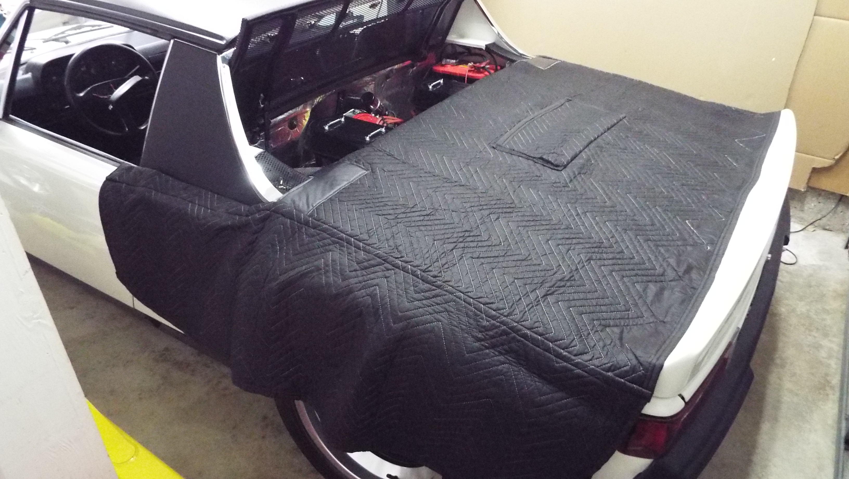

Also, she made me a copy of Eric9144's rear trunk cover that was made by Garold's mother, and pictured here in black.
Cheers to Garold and his mother (IMG:style_emoticons/default/beerchug.gif)
Eric9144/ Garold's mother's
My wife's prototype here made in blue.
Many, many thanks to Eric9144 for lending us his cover. We will arrange that ride in the 6 hopefully sooner than later. Great seeing you! (IMG:style_emoticons/default/beerchug.gif)

QUOTE(Lucky9146 @ Jul 14 2018, 11:13 PM) *
The gears are reproduced by Odo Gears, and pining the shaft helps to give them a bit of bite. It was designed that way though as a fail safe to protect all the mechanism. Re-lube all your gears also the grease in there gets a bit hard after 50 years.
BTW if your looking for it, it is officially called a lead gear.
Good work (IMG:style_emoticons/default/beer.gif)
