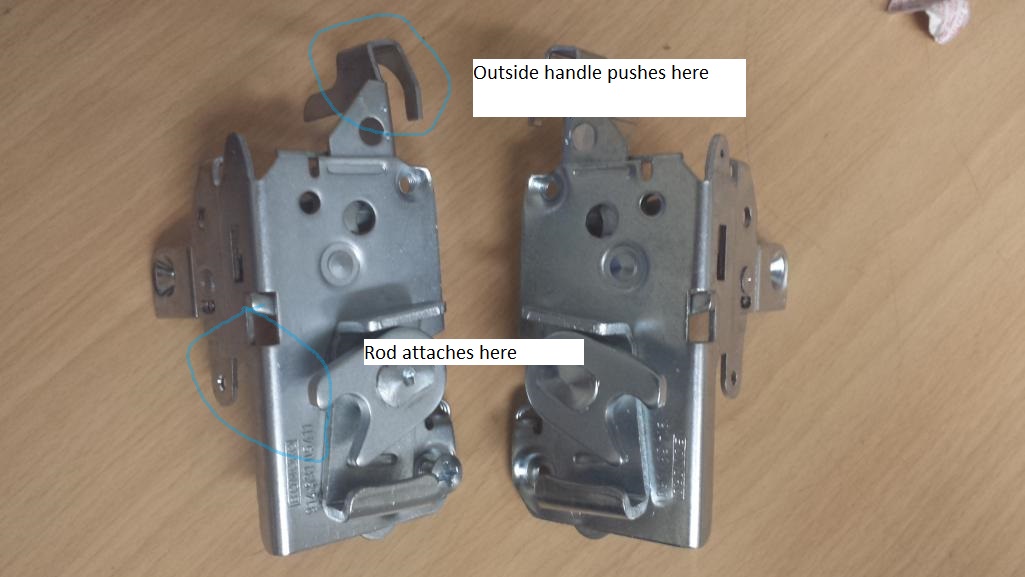

Everything happens at the latch.
Outside handle pushes from the top.
Inside handle pushes and pulls from the bottom.
