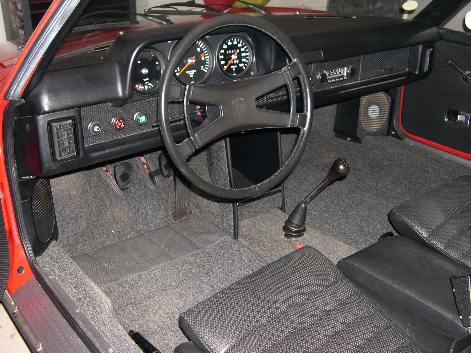

Pat Garvey
post Sep 10 2015, 05:44 PM
Do I or don't I...........?
Posts: 5,900
Joined: 24-March 06
From: SE PA, near Philly
Member No.: 5,765
QUOTE(porschetub @ Aug 15 2015, 05:26 PM) *
I have info and measurements from Jeffs website for the centre console,I would prefer to have the so called "deposit box''.
Anyone have a similar measurement plan or do I just build the main section off Jeffs plan and go from there?.
I want it to look/fit as close to original as possible,thanks.
Are you referring to this.....

QUOTE(Pat Garvey @ Sep 10 2015, 04:44 PM) *
There you go...that is exactly what mine looks like but Pat's is WAY cleaner than my car right now.

QUOTE(914_teener @ Sep 11 2015, 11:36 AM) *
...Or were you talking about the plastic center section underneath the center cushion.
The "deposit box", as Porsche marketing called it, was/is a compartment from the lower center of the dashboard on early 914's to the floor. It was affixed top and bottom with stainless hardware, carpeted on the sides, a vinyl floor and that was it. Was meant to hold the deitris of your commute.
Some places who should know better (Auto Atlanta) will attempt to make you believe that it was the center console on later year 914s. They are (typically) incorrect. There's a huge difference between a "deposit box" and a "console". Don't be fooled by the fools!
Pat

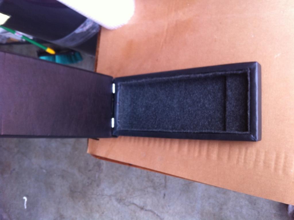

23e Heure
post Jan 21 2017, 11:53 AM
Busy overtaking 911s
Posts: 323
Joined: 13-August 15
From: London
Member No.: 19,057
Region Association: England
I believe the box between the seats is referred to as the "Centre Console Box".
Does anyone know the dimensions of this box including pad dimensions?
My car is off having works done, so I can't go measure up... My box has the 2 'compartment' solid plastic tray insde the box.
Thanks!

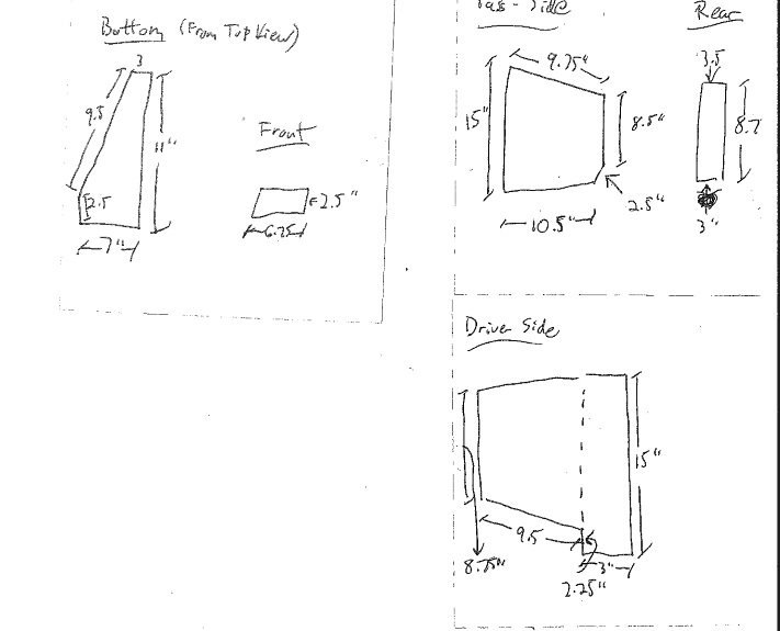

Biggles
post Feb 10 2017, 04:13 PM
Posts: 205
Joined: 5-September 13
From: UK
Member No.: 16,353
I asked the same question about the Deposit Box last year, and one of the guys on here got me the measurements, hopefully you can read them:
malcolm2
post Feb 10 2017, 04:27 PM
Posts: 2,749
Joined: 31-May 11
From: Nashville
Member No.: 13,139
I love using mine. I bought a tan one that was in pretty bad shape.... kinda like the rest of my car, looks-wise. Looks decent in my black interior. But it is perfect. The gauge one is a total waste of space. I mounted 4 gauges across the dash, right above it.
Throw anything in there. Not a bad cup holder either. I clip my garage door opener to it. Keep a screwdriver and a couple can koozies, phone charger in there.
The greatest!
