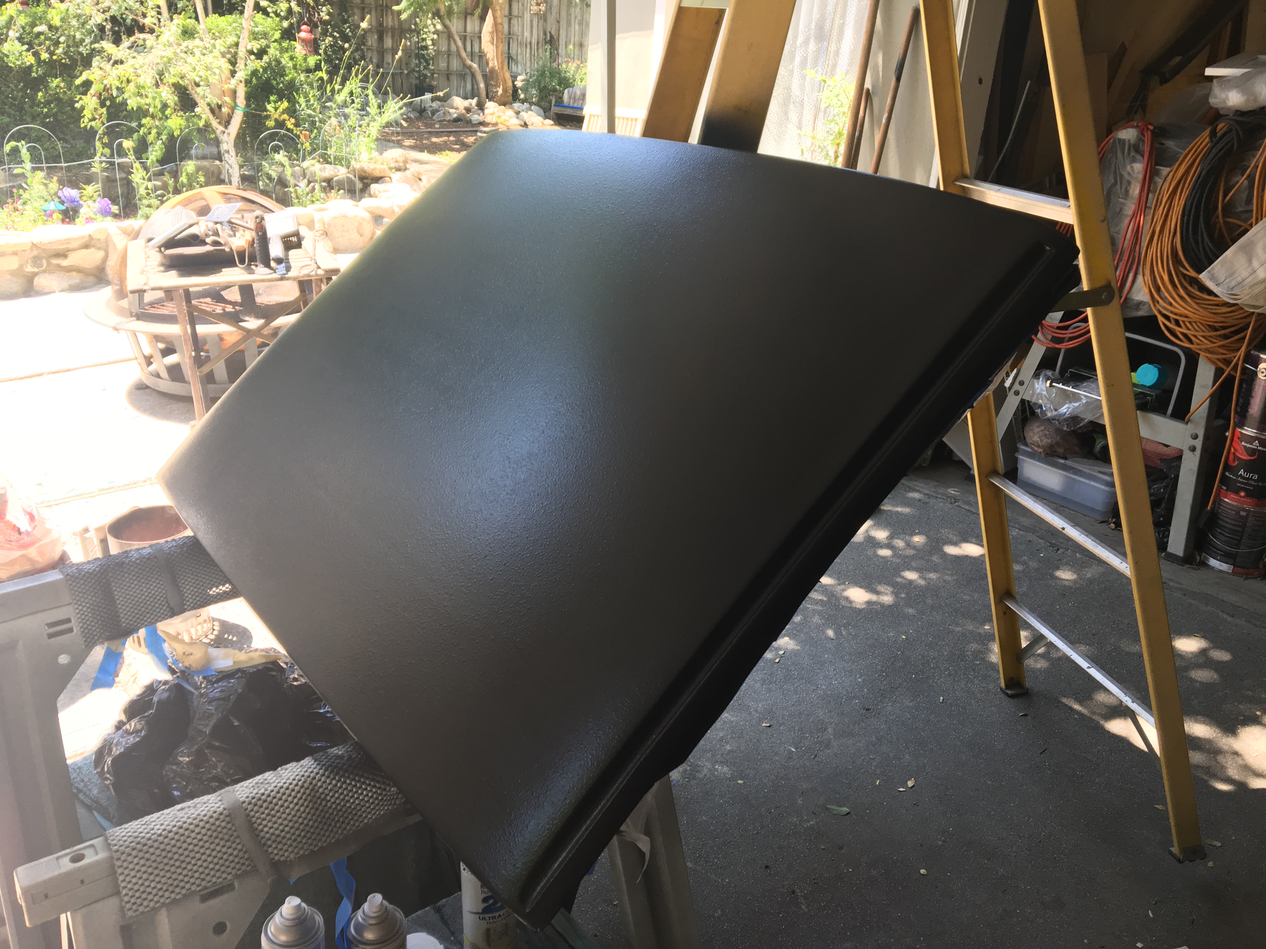

Mikey914
post Aug 20 2019, 09:42 AM
The rubber man
Posts: 12,782
Joined: 27-December 04
From: Hillsboro, OR
Member No.: 3,348
On my decklid
