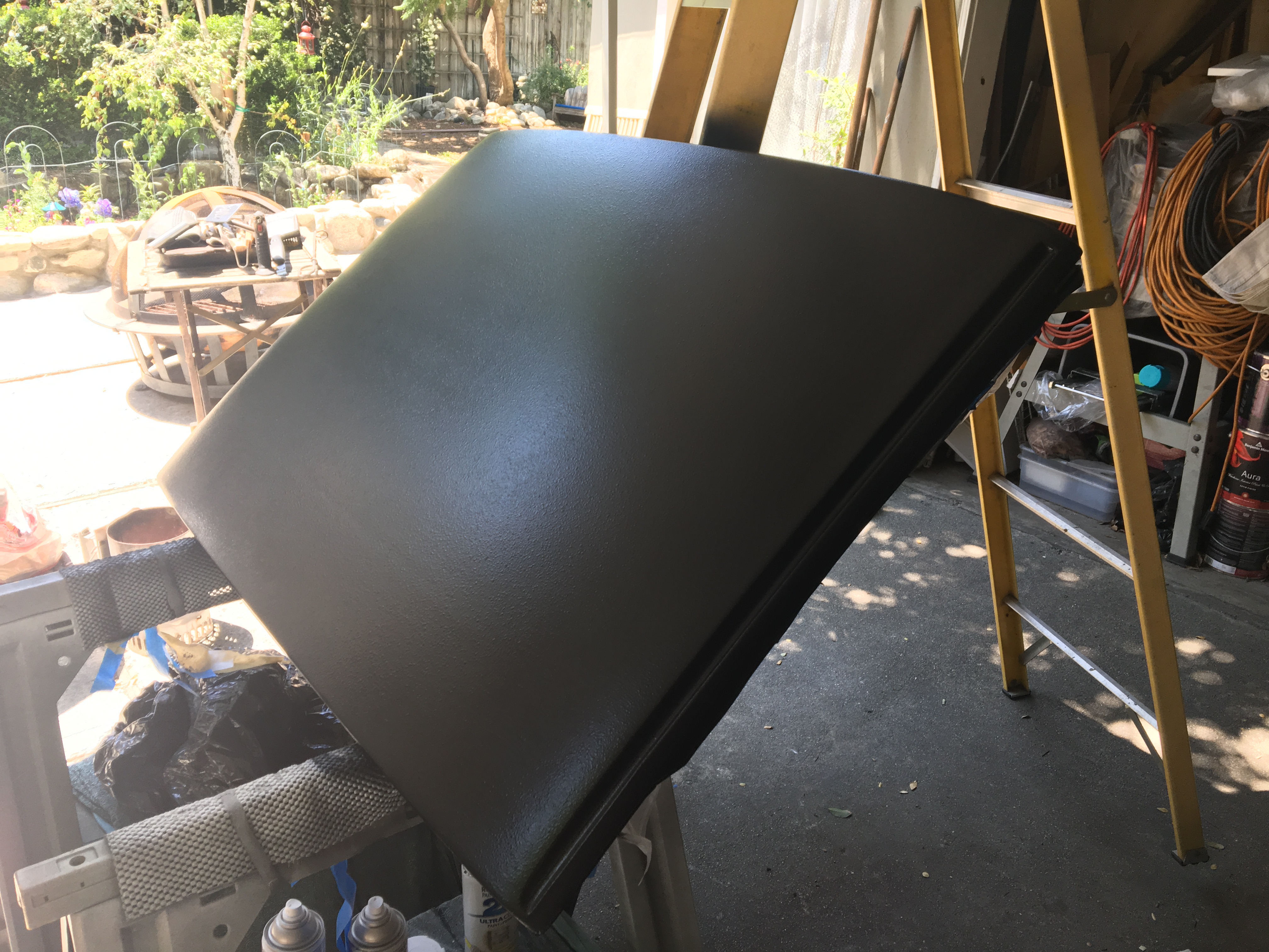

Mikey914
On my decklid

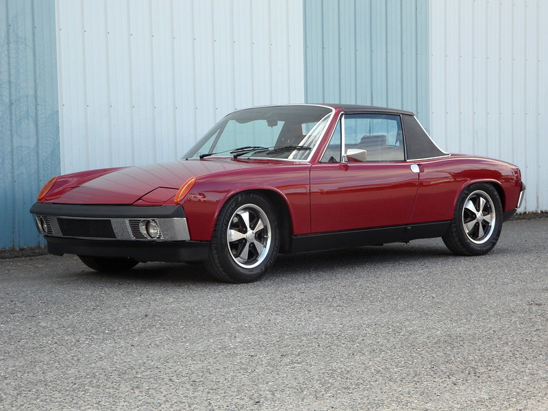

Another vote for the SEM trim black , But I used the EURO Trim black... Cause ya know we're Euro an all that...

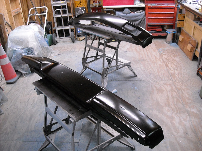

Would this not be an appropriate choice for the A-arms, trailing arms, Fuel tank, etc too - as an alternative to powder coating ? I'm not CW, but would like to use something pretty close to original.
No 2K for SEM Trim Black...
It's mixed 1/1 with a good urethane reducer only.
I used it on my rocker covers, valences, engine lid mesh, targa top. It goes on quite nice with an HVLP gun. Durable (so far).
I used their Color Coat (also available in aerosol cans) to freshen up the sail panels and some interior parts (including the dash).
Both blacks match.
IPB Image
IPB Image
If you are looking for bone stock original, this may or may not be it. I don't know (and don't care too much smile.gif ). My guess is that if you talk to 10 914 experts, you'll get 11 answers on what shade of black and what sheen was stock.

Hey Olympic, that's honestly the best looking painted bumpers I've seen, the sheen looks perfect to my eye. Any idea where to get the Euro Jet Black in quarts?

Olympic 914

Unfortunately it looks like SEM discontinued the Euro trim black in 2018. I still have a little left for touch-ups.
SPI has a single stage black satin that might work for you, I think you can adjust the mix to get whatever amount of satin / matte you want. I considered this when I painted mine. But went for the SEM because it was easier.
