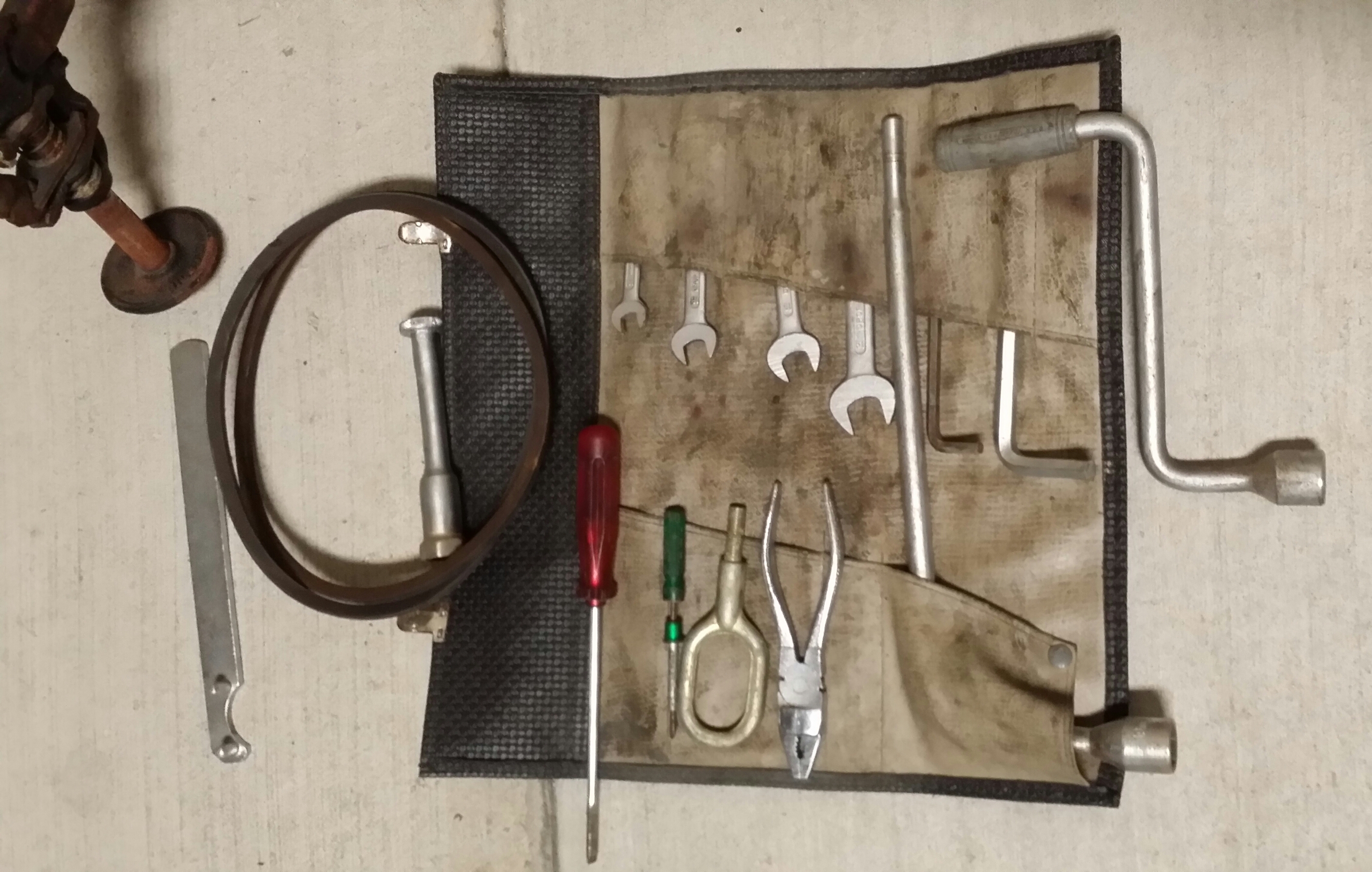

I just purchased a 914-6 all numbers matching nice drivers 1970 914-6 (not for sale)
Please tell me if this is a complete tool kit, if not what is missing?
Thanks,
Dennis
Attached ImageAttached Image

Tom_T   Hopefully toolguy (Dave W.) or SoCalAndy (Andy T.)...   Aug 28 2015, 06:44 PM
TJB/914   Skydance I am not an expert, but here is a quick ...   Aug 28 2015, 07:19 PM
Cairo94507   Adriatic Blue with gas burners! It just does ...   Aug 28 2015, 07:33 PM
TJB/914   Sundance I just found these up close photo's...   Aug 28 2015, 07:38 PM
Johny Blackstain   Not sure but it looks like the green holding screw...   Aug 28 2015, 07:43 PM
rgalla9146   Nice tool kit, very few issues compared to most. ...   Aug 28 2015, 07:59 PM
Skydance   You guys are priceless, within a couple hours ever...   Aug 28 2015, 08:09 PM
Hawk   I believe the pliers are no different than the ear...   Aug 29 2015, 05:03 AM
TJB/914   I believe the pliers are no different than the ea...   Aug 29 2015, 05:53 AM
bdstone914   I believe the pliers are no different than the e...   Aug 29 2015, 01:46 PM
Hawk   [quote name='TJB/914' post='2229994' date='Aug 29...   Aug 29 2015, 03:23 PM
RobW   I just purchased a 914-6 all numbers matching nic...   Aug 29 2015, 05:06 AM
rick 918-S   Are you guys sure about that double box end wrench...   Aug 29 2015, 06:02 AM
TJB/914   Are you guys sure about that double box end wrenc...   Aug 29 2015, 06:31 AM
rgalla9146   Are you guys sure about that double box end wrenc...   Aug 29 2015, 06:35 AM
rick 918-S   Are you guys sure about that double box end wren...   Aug 29 2015, 06:44 AM
TJB/914   Are you guys sure about that double box end wren...   Aug 29 2015, 06:46 AM
fixer34   Never really paid much attention to the set I got ...   Aug 29 2015, 09:08 AM
rgalla9146   Never really paid much attention to the set I got...   Aug 29 2015, 01:06 PM
bdstone914   Aside from the tool roll there are 4 original 6 t...   Aug 29 2015, 01:34 PM
bdstone914   Never really paid much attention to the set I got...   Aug 29 2015, 01:32 PM
rgalla9146   Never really paid much attention to the set I go...   Aug 29 2015, 04:33 PM
fixer34   Never really paid much attention to the set I go...   Aug 29 2015, 08:03 PM
rgalla9146   [quote name='bdstone914' post='2230143' date='Aug...   Aug 29 2015, 08:28 PM
stugray   I know there is an optional sparkplug wrench that ...   Aug 29 2015, 11:22 AM
TJB/914   Help. I still have this one 6" long Heyco W.G...   Aug 29 2015, 12:26 PM
rgalla9146   Help. I still have this one 6" long Heyco W....   Aug 29 2015, 01:01 PM
TJB/914   Help. I still have this one 6" long Heyco W...   Aug 29 2015, 01:26 PM
bandjoey   heyco started in the 30's according to Google....   Aug 29 2015, 03:15 PM
bdstone914   heyco started in the 30's according to Google...   Aug 29 2015, 07:49 PM
Hawk   Back to the correct pliers. According to 914club w...   Aug 29 2015, 08:28 PM
Hawk   See this website for photo documentation of the co...   Aug 29 2015, 08:32 PM
Mike Fitton   Here is my 914-6 tool kit original to my 7/70 late...   Aug 29 2015, 08:39 PM
DennisV   Here is my 914-6 tool kit original to my 7/70 lat...   Feb 19 2023, 09:41 PM
gereed75   The p914 website has been the definitive asset for...   Feb 20 2023, 08:21 AM
DennisV   The p914 website has been the definitive asset fo...   Feb 24 2023, 06:24 AM
rhodyguy   What purpose does P208 serve?   Feb 24 2023, 08:31 AM
rgalla9146   What purpose does P208 serve? P208 holds the ...   Feb 24 2023, 08:39 AM
DennisV   Is there consensus on which version of the spark p...   Feb 24 2023, 06:21 PM
rudedude   My 10/69 has the plug wrench with the Allen wrench   Feb 24 2023, 07:02 PM
DennisV   My 10/69 has the plug wrench with the Allen wrenc...   Feb 26 2023, 09:12 AM
rgalla9146   Better illustration of the different Drop Forged S...   Feb 26 2023, 11:39 AM
