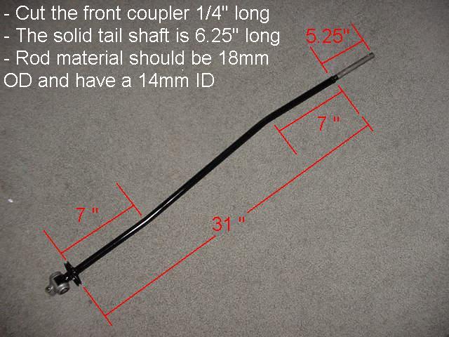

I am hoping to install a Rennshifter into my 6 conversion car in the next few days...anyone have installation tips on how to set it up so the linkage adjustment is close and then can be fined tuned quickly? My tranny is a sideshifter and the long linkage rod has been slightly modified by Rich Johnson so it clears my 6 headers that looks like this.
