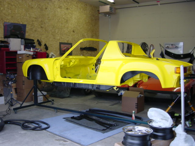

I noticed that Gint undercoated his 914-6 car and then painted it body color.
http://www.914world.com/members/ginter/DSCN0257.jpg

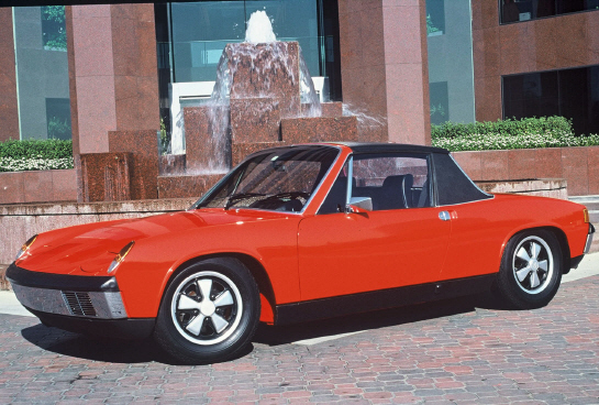

This is car similar to mine that someone from either Minnesota or North Dakota e-mailed me a few years back.
I don't remember who it was...

(IMG:http://www.britainsmith.com/Porsche/912Project/Paint/images/150_0052_jpg.jpg)
-Britain
