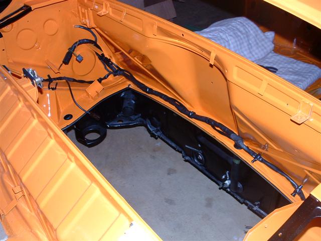

Doug Leggins
Mar 4 2005, 06:25 PM
Qarl - Glad to hear that you are getting moving on the project again! I hope that in a couple of months you are smiling from ear to ear while looking at your new paint job!
Some reasons why I went black on the underside.
-I always thought that the color coded underside looked kind of odd. Nearly all cars that I am familiar with have a black underside. My opinion on this is changing however, after seeing more 914s. The color coded bottom looks really good on some 914s. And after all, that is the way they came from the facory.
- My car is intended to be a frequent driver. My thoughts are that the black will not show dirt as much as bright orange would. And after some suface scars appear and need to be touched up I should be able to blend a satin black into the wheelwell easier than i could blend in the orange.
-My thoughts were that a black underside would help to show off the black chrome powder coated parts.
- My painter was familiar with the black industrial enamel that we used. There's a local hot rod builder that has been using it for a few years and recommended the material. The material is an industrial equipment enamel made by Western Automotive Finishes which is a division of Sherwin Williams.
- The painter recommended spraying the tops of the wheel wells with a stone guard/chip resistant 3M material. With the car going to be a driver- this made sense to me. I am fairly certain that the stone guard is sprayed on top of the paint. Since both are black, this worked on my car.
Pics...
Doug Leggins
Mar 4 2005, 06:34 PM
After the wheels and tires are installed and the car is on the ground, there is really not much of the wheel wells that is visible. The black underside does not draw attention to inside the wheel wells. The car body is where most peoples view will stop. With a color coded wheel well it seems, to me, to take my viewing of the car on into the wheel wells. I did not want this for a driver. For a show car I sure would.

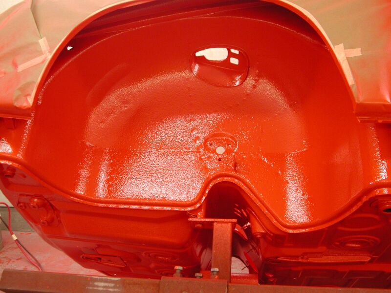

Tom Perso
Mar 7 2005, 12:26 PM
A friend of mine does this process:
1) Bare metal prepped for POR-15
2) POR-15 applied and dried
3) Shoot 3M Body Shutz
4) Paint to match.
Looks like this:
Doesn't that look sweet, AND deaden the stone/rock noise, and look durable?
