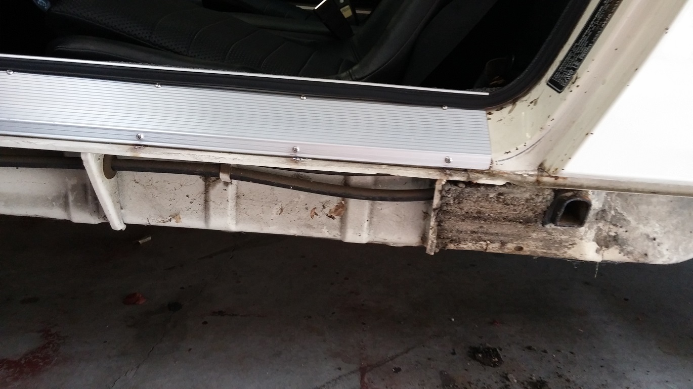

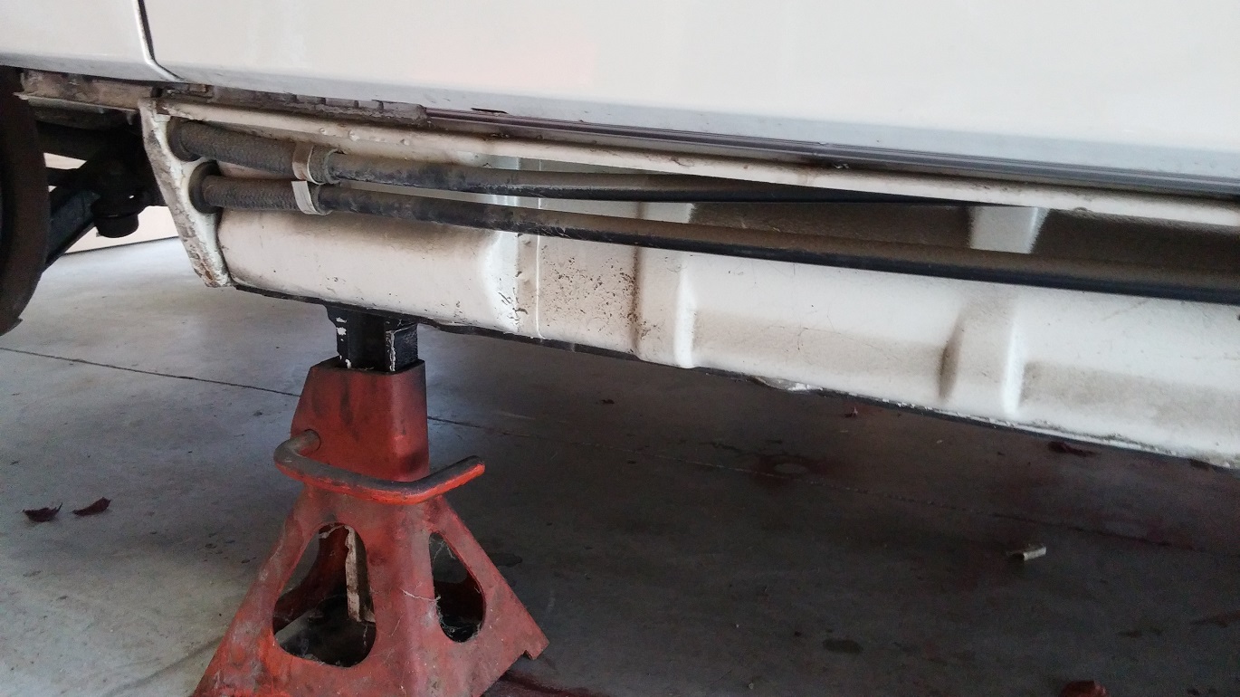

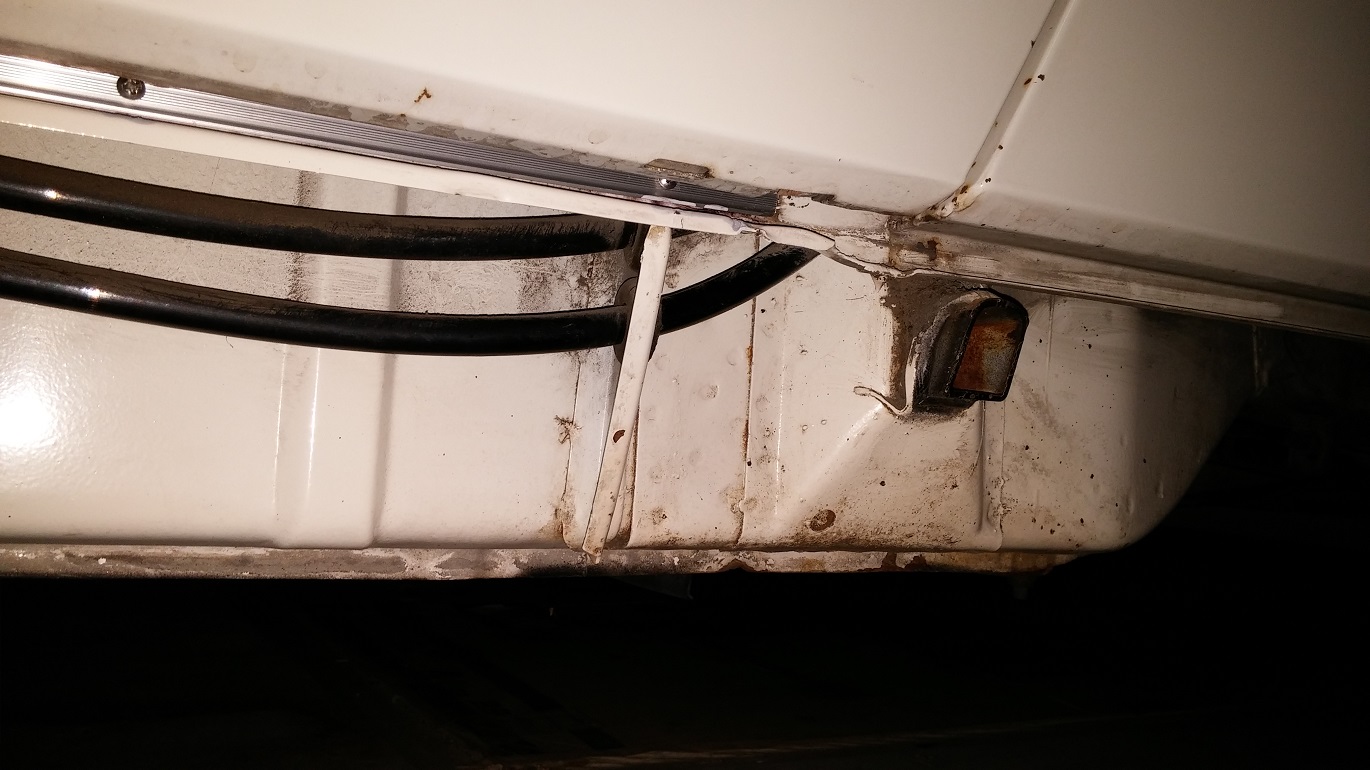

this is what I found:

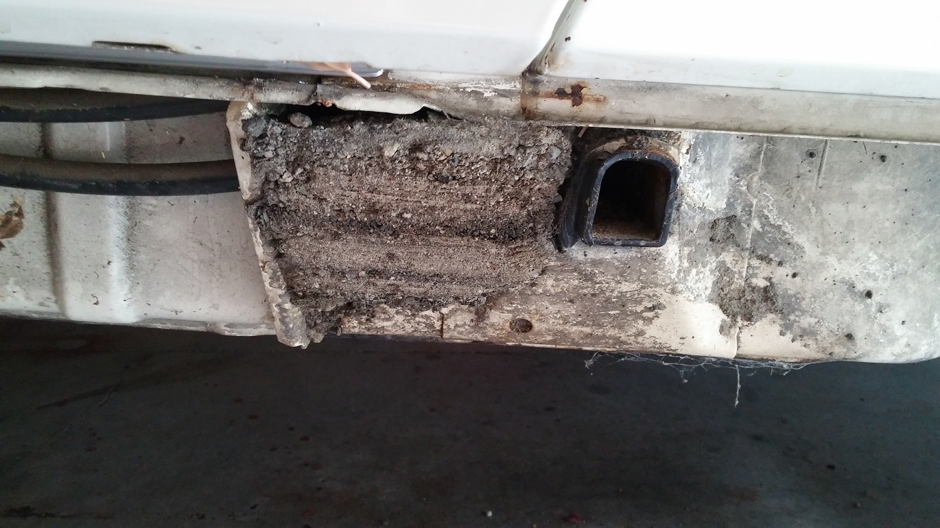

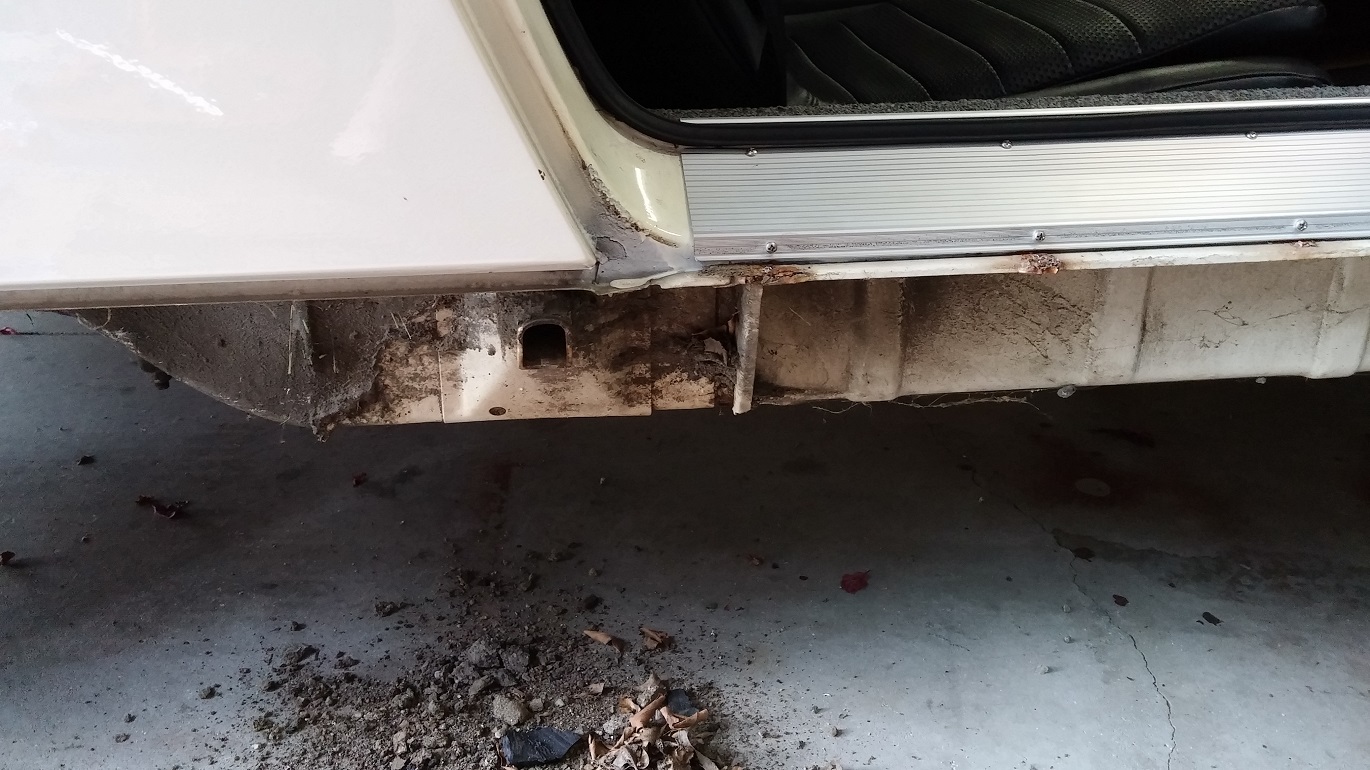

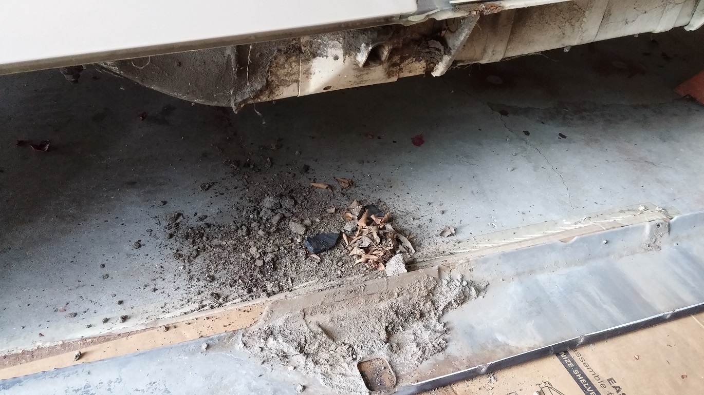

Drivers Side:
This is the road tar and sand and whatever was caked in there! (IMG:style_emoticons/default/WTF.gif)

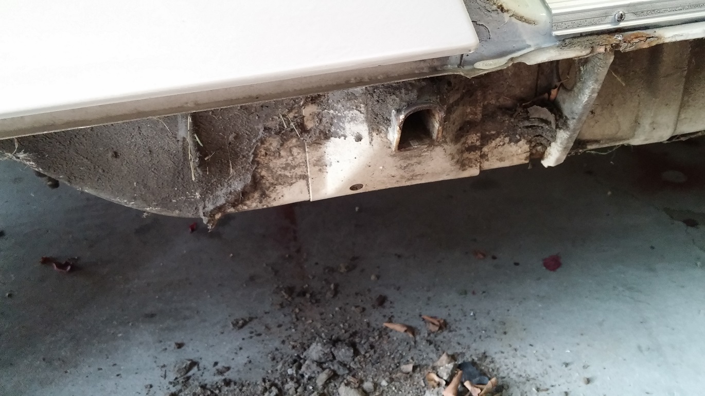

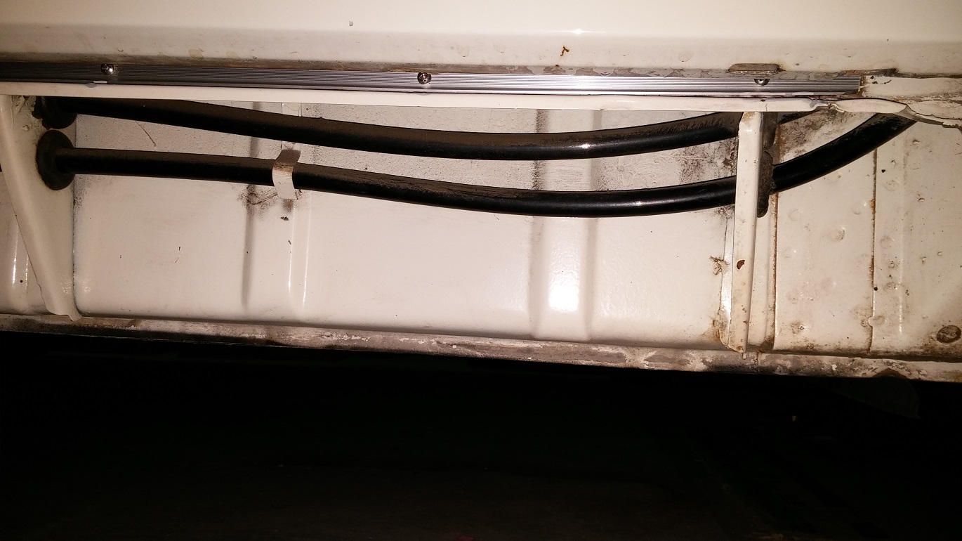

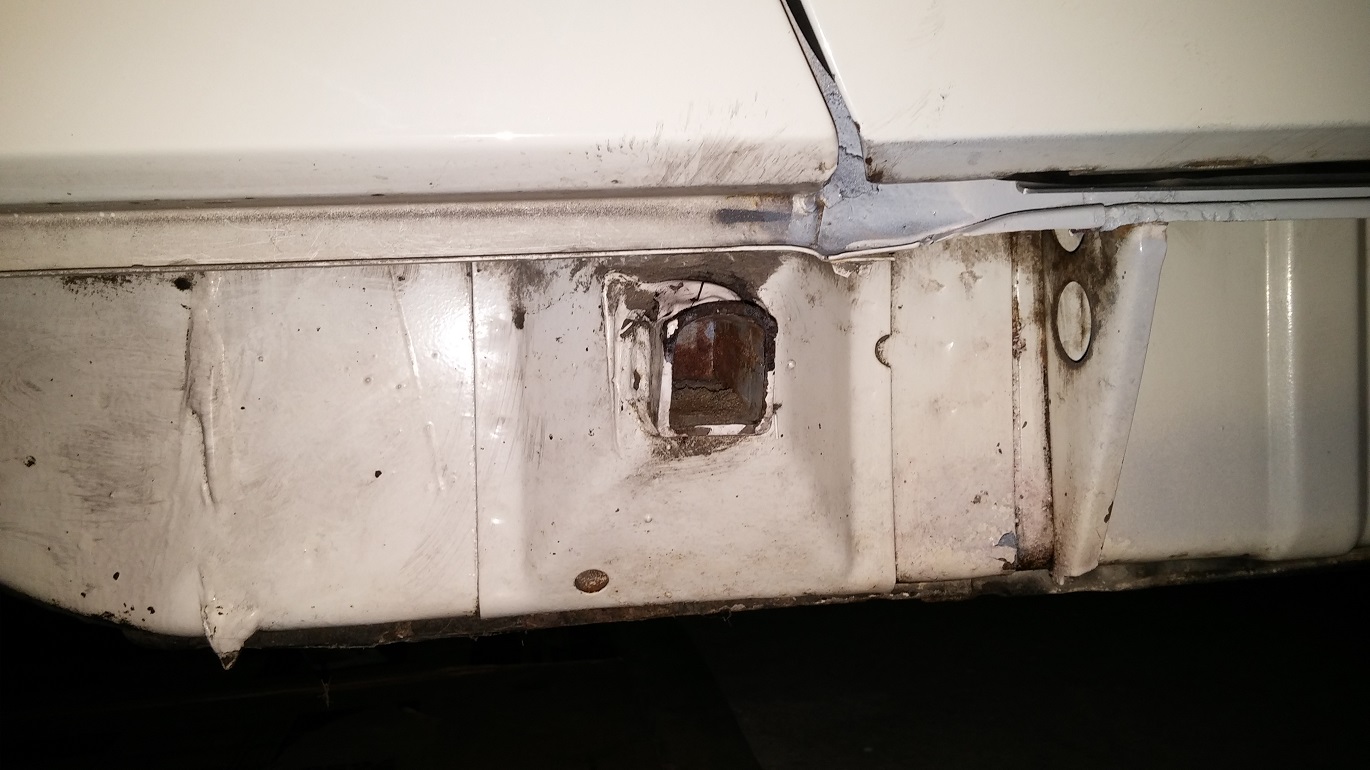

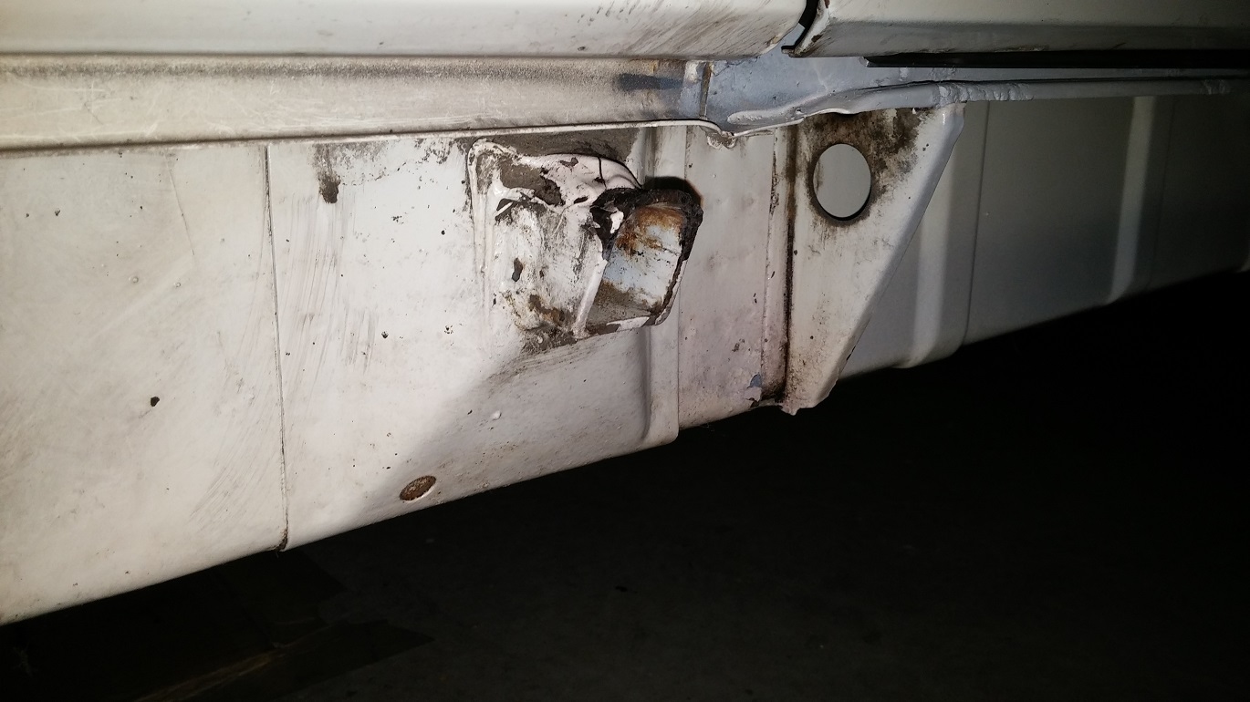

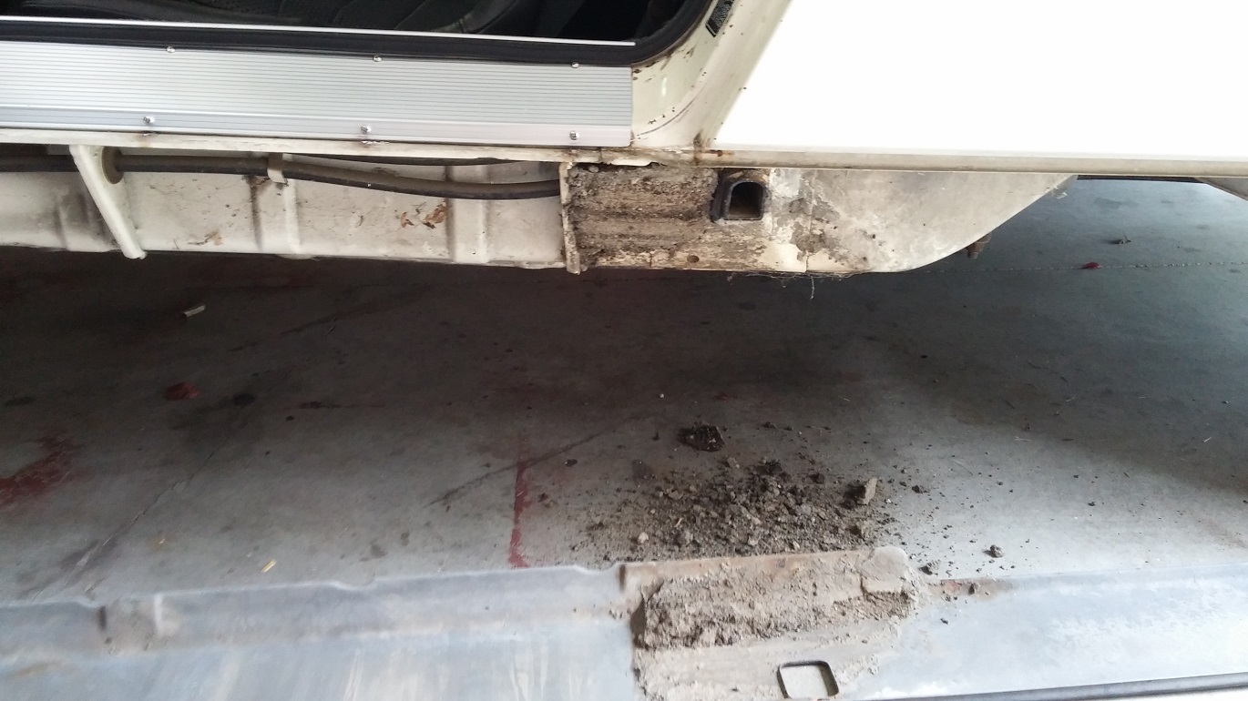

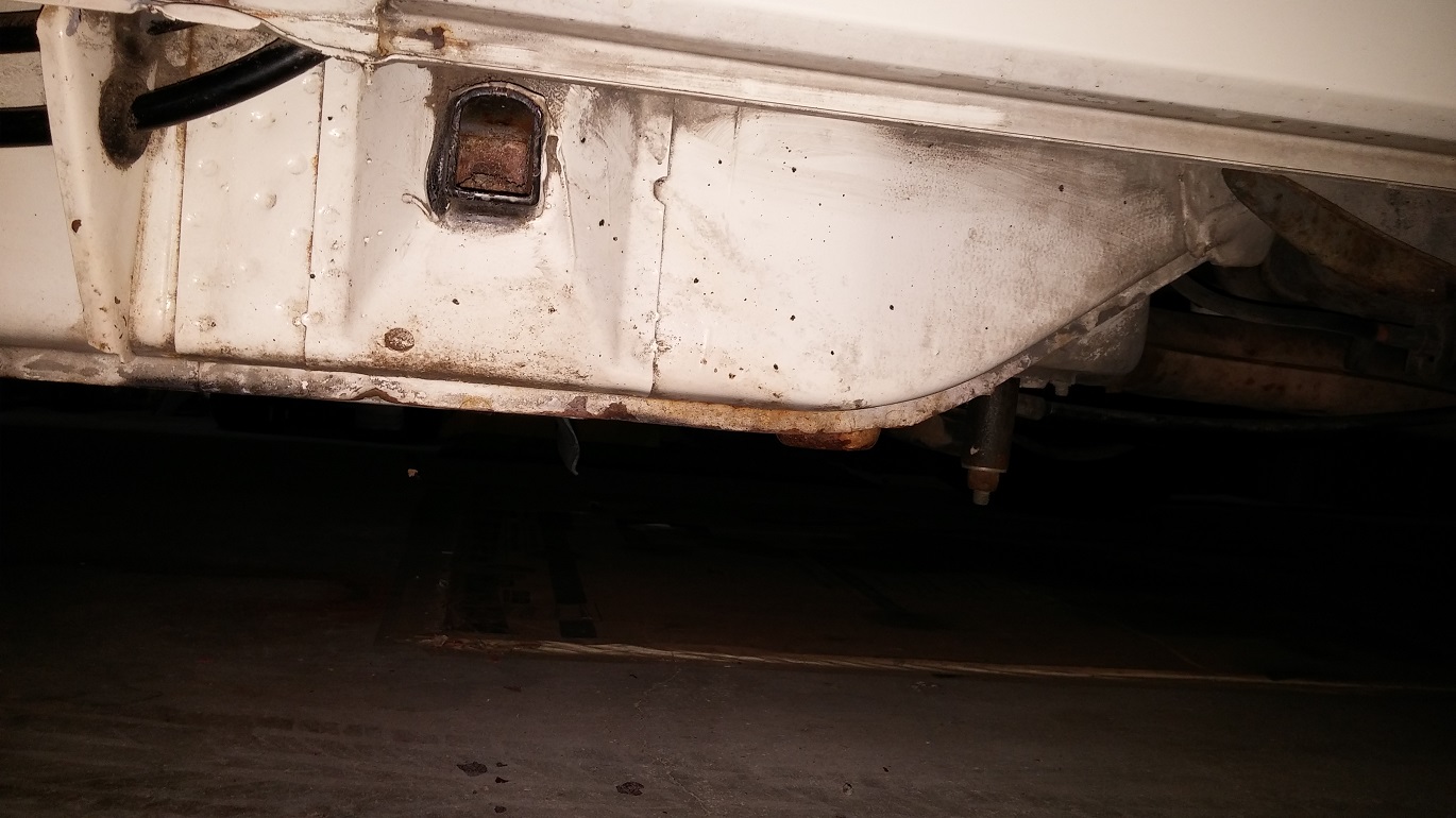

Passenger Side:
So the rivet holes on the passenger side sill are rusty, and I'll clean those up and primer/paint.
Overall the longs look great, and I'm happy to see them so clean and rust free. (IMG:style_emoticons/default/piratenanner.gif)

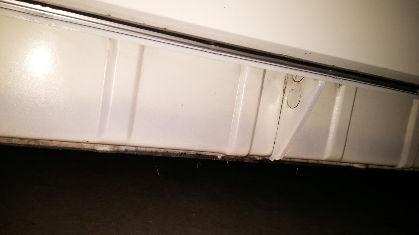

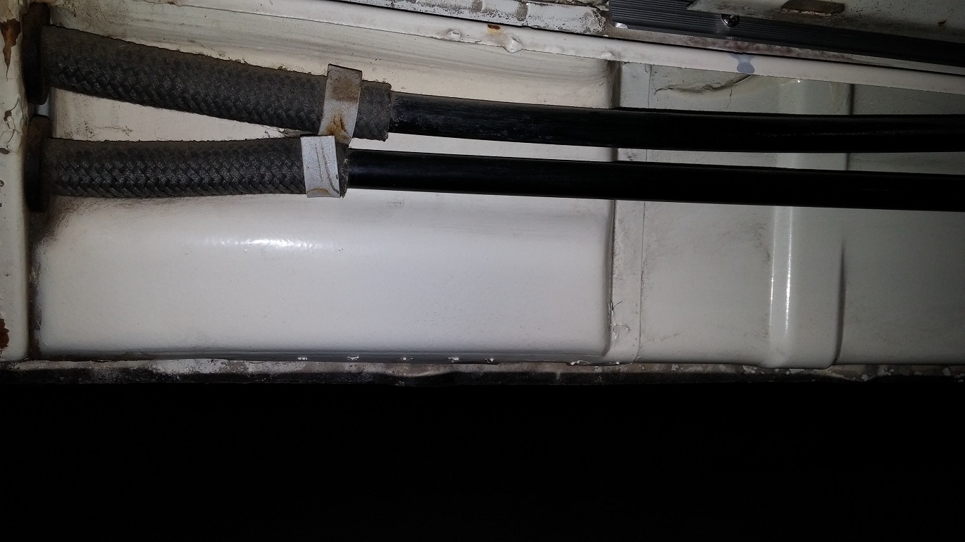

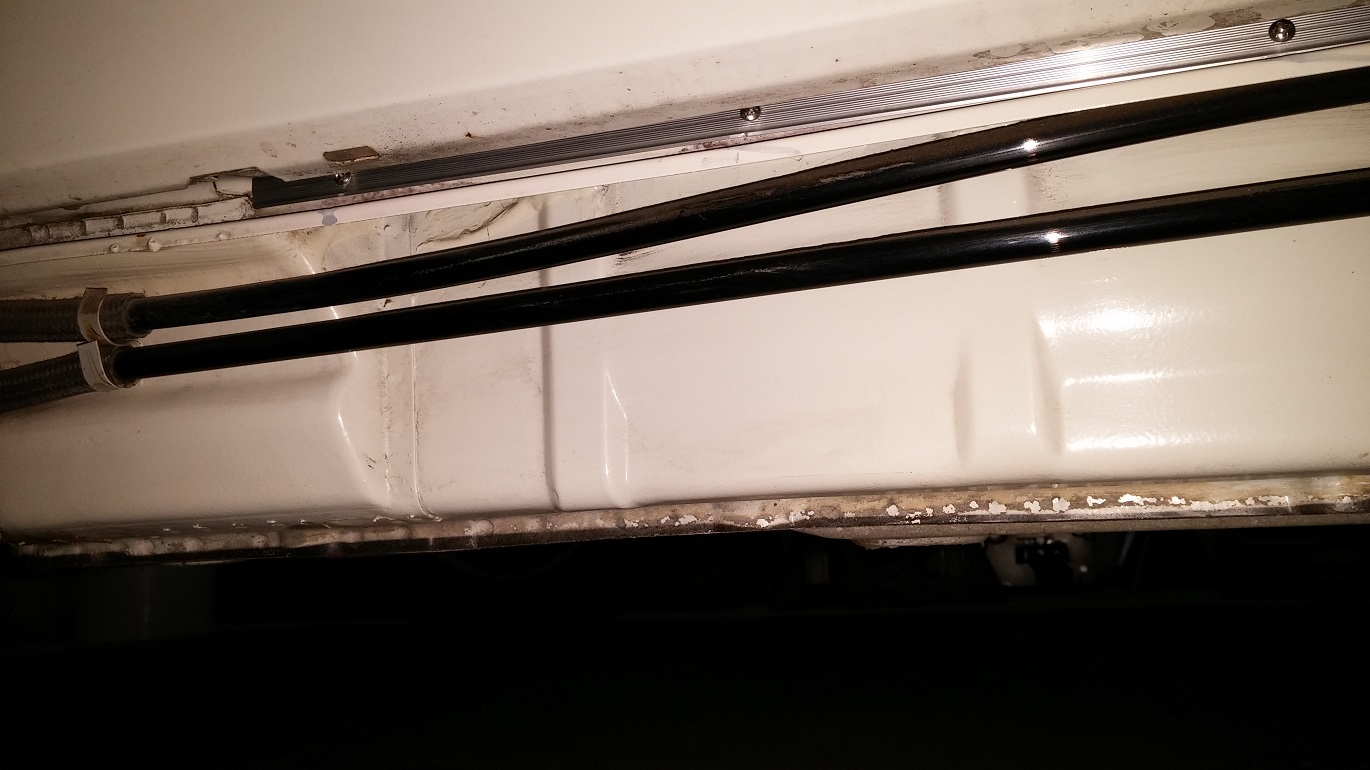

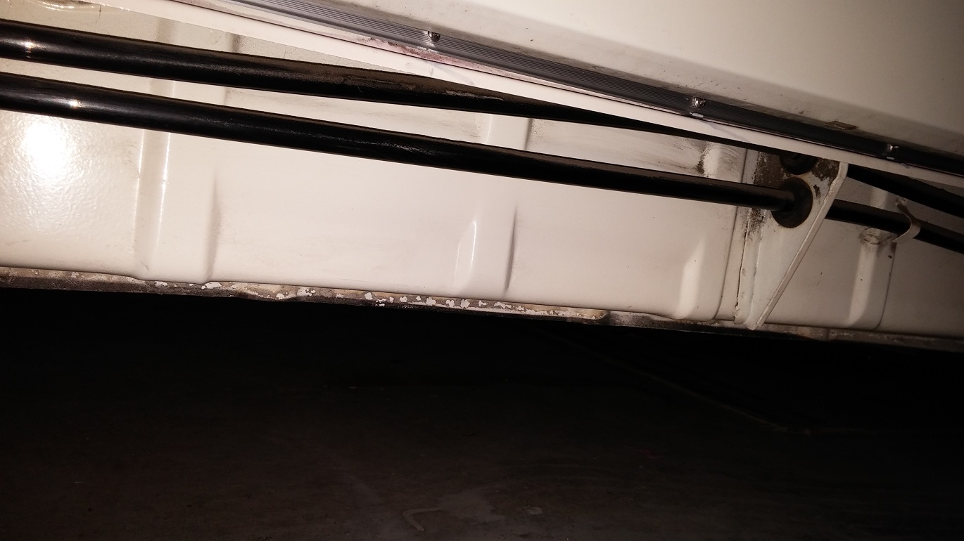

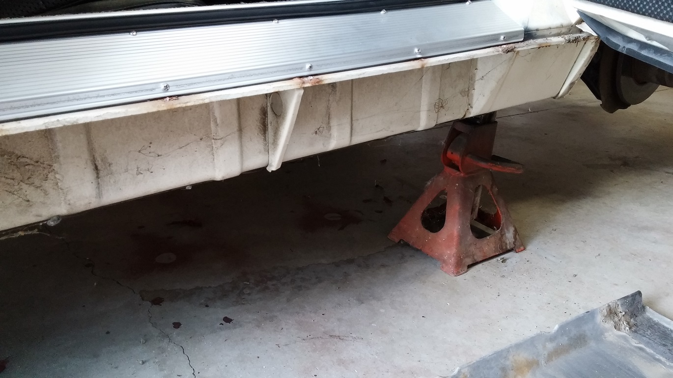

So I've got some more cleaning to do but I took some time to quickly clean them up:
I plan to paint the rocker covers, and I have what I need to put them back on properly.

I had three 914s that I bought in that condition when I lived in New York.
Of course they were brand new 1971-73.
They sure rusted quickly.... (IMG:style_emoticons/default/huh.gif)

Those look good.
I did the same last year...like going to a doctor's appointment that you have been putting off for a while.
Ten pounds of sand, dirt a crap came out.
POR'd the valance insides and resprayed the valances on the outside with 3M undercoating and then a top coat of clear lacquer. replaced the screws underneath with S/S metric cap screws instead of the cheese heads. I just re-riveted the top in place since the sheet metal is thin there. They are easy to drill out.

Consider coating with cavity wax before putting the rockers back on

That area in front of the Jack post is designed in such a way that dirt from the rear tire can get in there from above, but there is no place for it to fall out, so it packs in there.
I replace the bottom screws with two things
Longer screws and 3/8 inch thick rubber spacers.
This opens up the bottom of the cover and pulls it away form the long.
You cannot tell the difference visually.
Now, once done this way, you can take a hose and fire it in there from the front and the back and clean out the rockers allowing everything to go out the bottom.
Obviously you will want to touch up that paint, but this is a good long term cure.
For the other poster, unless he is magic, he also has dirt, rust, and pealing paint in that exact same area, it's in every car, no matter location or mileage unless is was never driven.

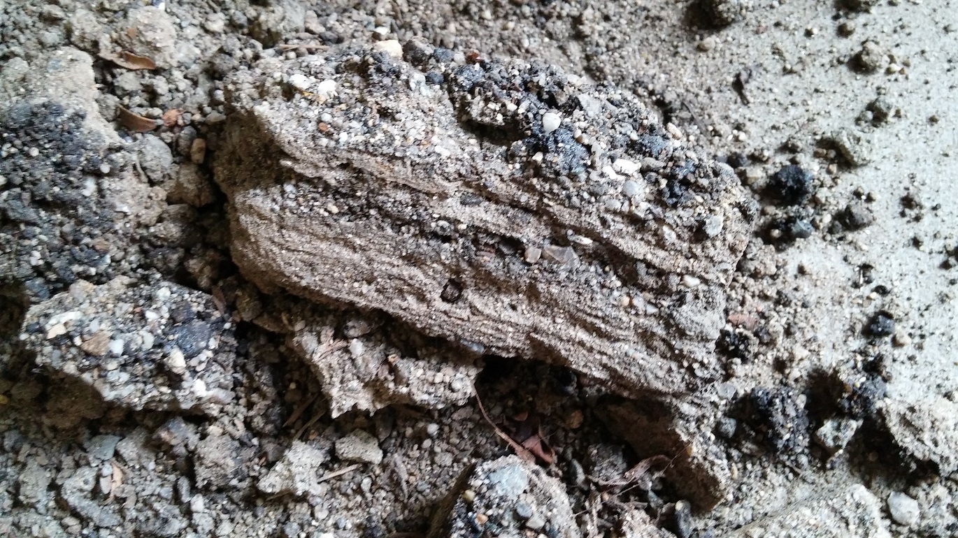

I was not expecting that brick of debris when I took the driver side cover off. I was also not expecting to wipe them off and see pristine Light Ivory painted longs either.!! (IMG:style_emoticons/default/aktion035.gif)
The passenger side long had some motor oil on it, there back by the jack post, and given the state of the engine and tranny, their was some pretty regular leaking going on in the past. Actually think that helped the passenger side. It will probably be a week before I re-install the covers, so I can get them cleaned up and touched up as suggested.
The car photographs well, but up close the original paint (at least on the outer surfaces) is pretty faded/chipped/scratched/etc... The trunks and now the longs look much better. It would be awhile before any paint job happened, and I'll still addressing the rust as I go along.

Man, that dirt was all layered in like sediment. I wonder if you could do some soil analysis and carbon dating and map out where all the car has been?
