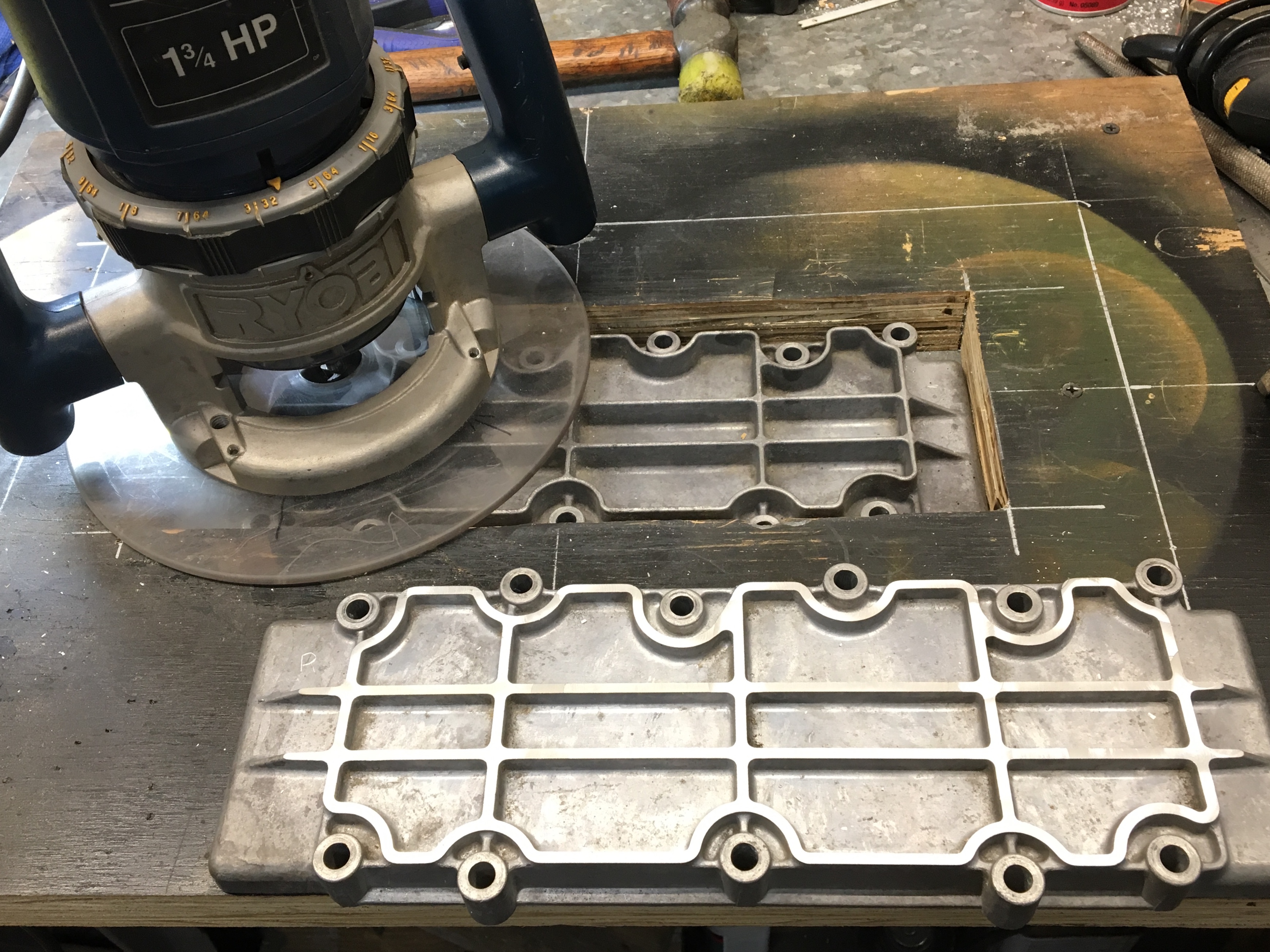

I milled mine down to just above the bosses using a router w/carbide bit ....

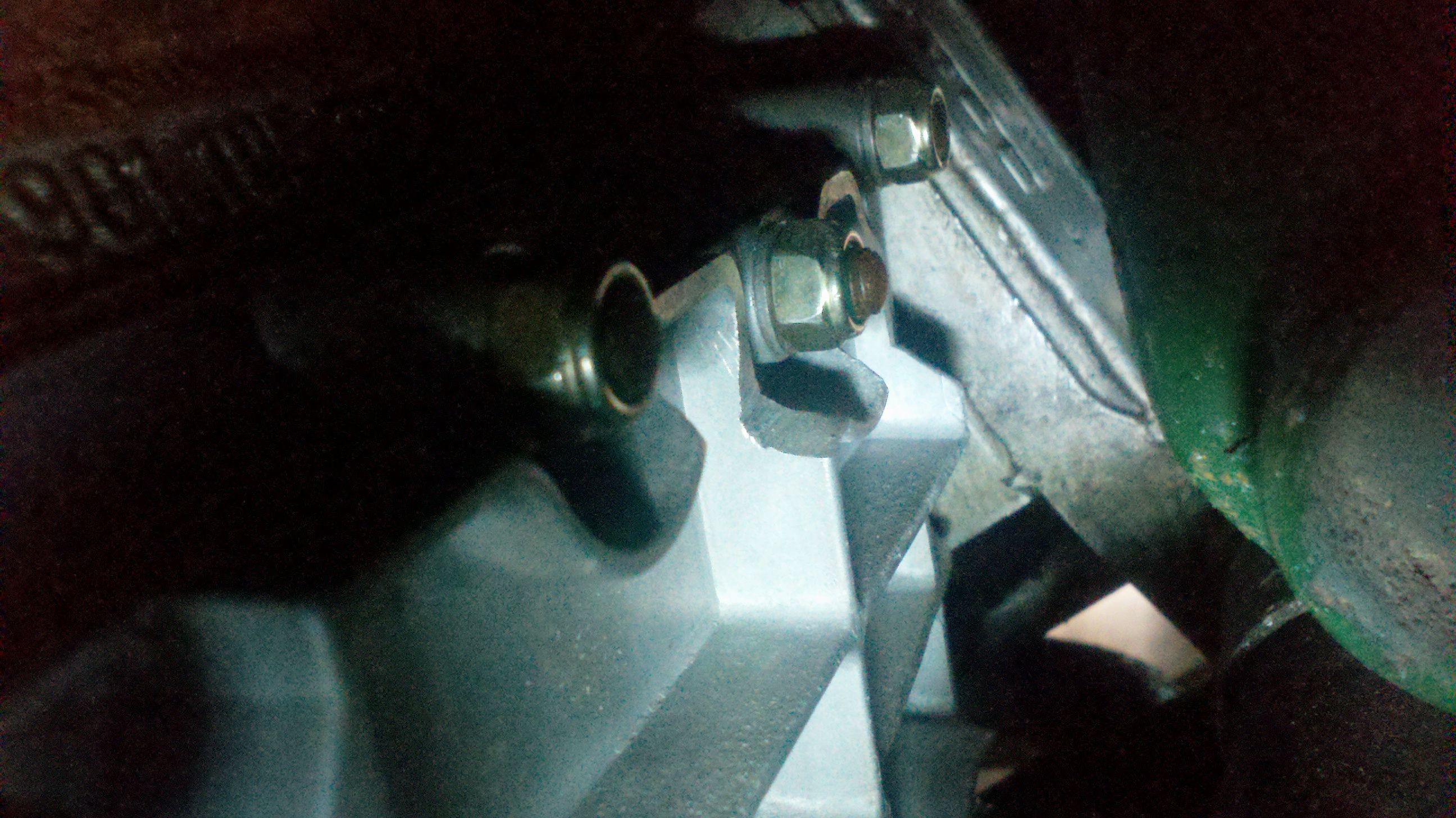

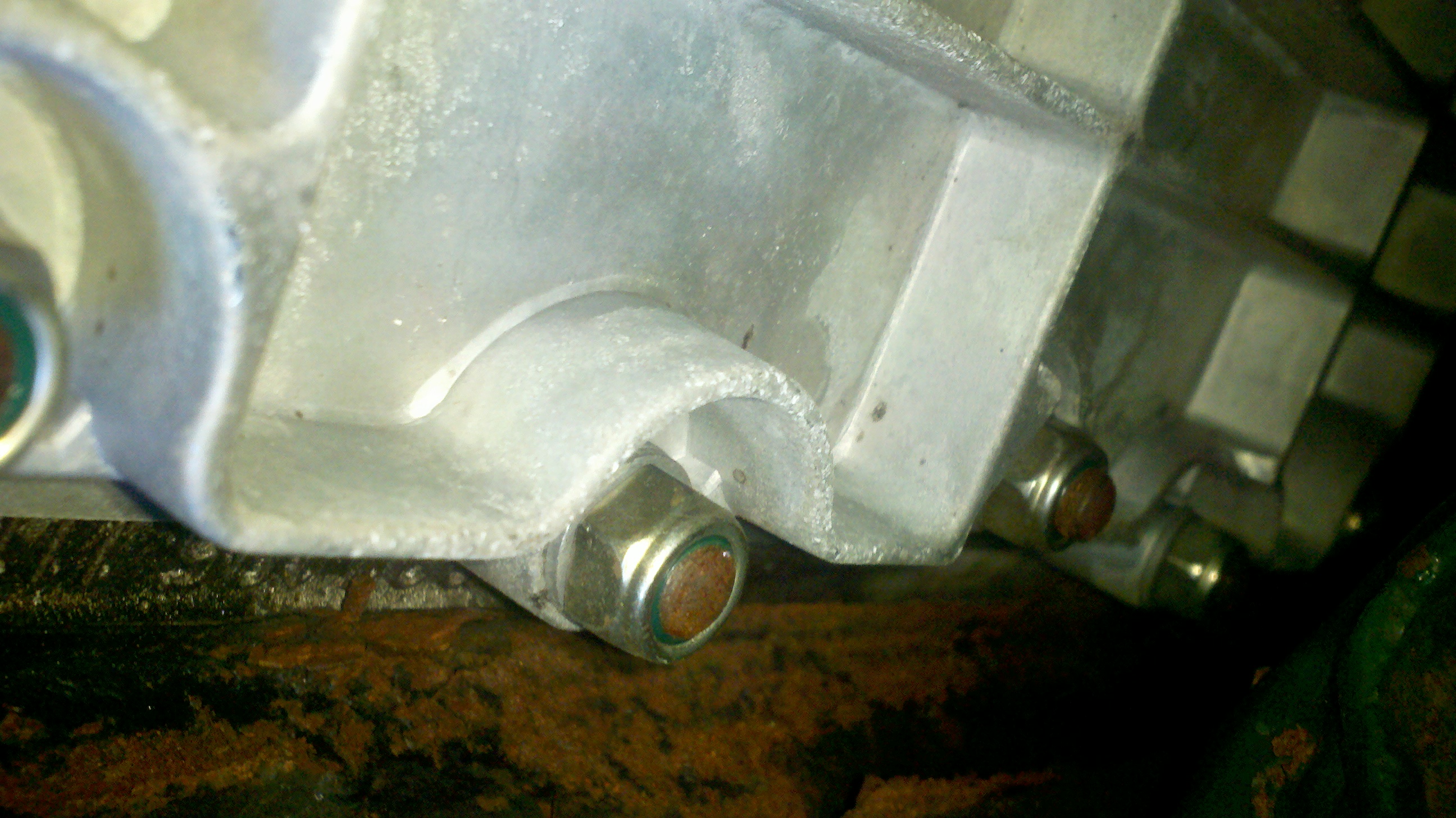

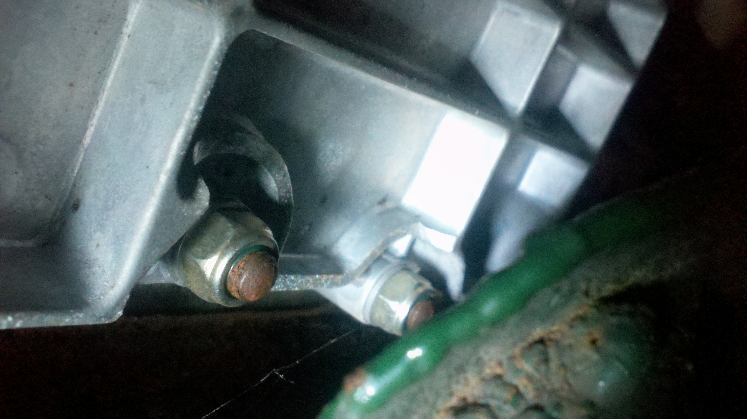

Been there, done that 5+ years ago when I replaced leaky magnesium covers (with engine in the car). Sales rep told me the turbo covers would fit as-is. Manager later called to apologize. Here are some pictures I took best I could after my 'modifications'. Don't need to take much off, just around a couple bosses.Attached Image Attached ImageAttached Image

You should NOT be required to machine the covers to fit the engine in the car but rather remove the covers while the engine is in the car.

My pictures are a couple posts earlier, I don't think I had to do both sides (but that was almost 10 yrs ago). It isn't the oil cooler that is the issue, it is the trailing arm suspension mount.
Just need a little shaved off right around that area.
