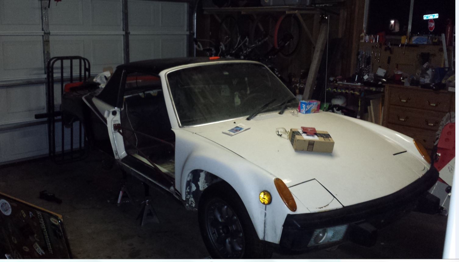

Progress:

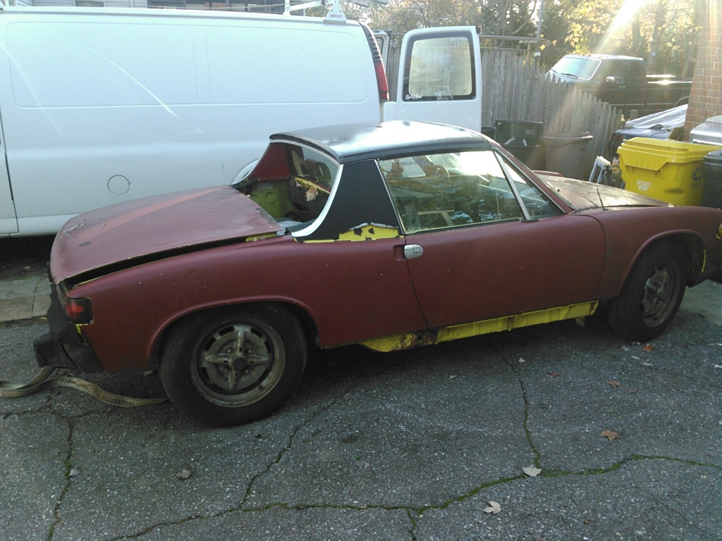

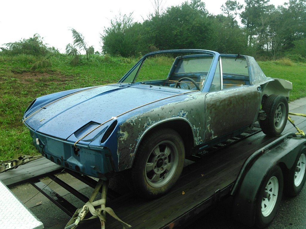

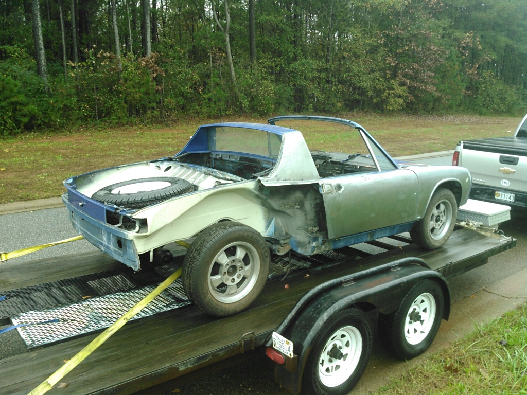

I think it is progress.... I bought a third car for the build. Well most of a car. It is a 1975 that Ghuff was working on. The body is really solid in the usual problem areas. It needs some love in the front fender to windshield post area and new doors/rear fenders. (A fun conversation with a skeptical wife...Its a lot less work to just chuck on some fenders)
A short 10hr drive to Georgia pick up the car and a 10 hr hop back. The 75 has been assessed cleaned and stowed.
Solid floors an longs!!!
The 73 started the end of its life by giving up the drive train and interior.
Challenges:
Staying awake on the trip home from Georgia.
Not posting enough on the build thread.
Budget:
-$1000.00 Original purchase
+$200.00 sold 2 sets of seats
+$400.00 sold targa top, center counsel, muffler, and sun visors
__________
- $400.00
-$300.00 for the 75
___________
-$700.00 In the hole
Goals next month:
Strip the 73 and cut it up.
Sell some of the "easy sale items"
Separate the usable parts from the 73 stash
Clean up the carbs
finish the engine tin and chassis parts that are in raw metal.

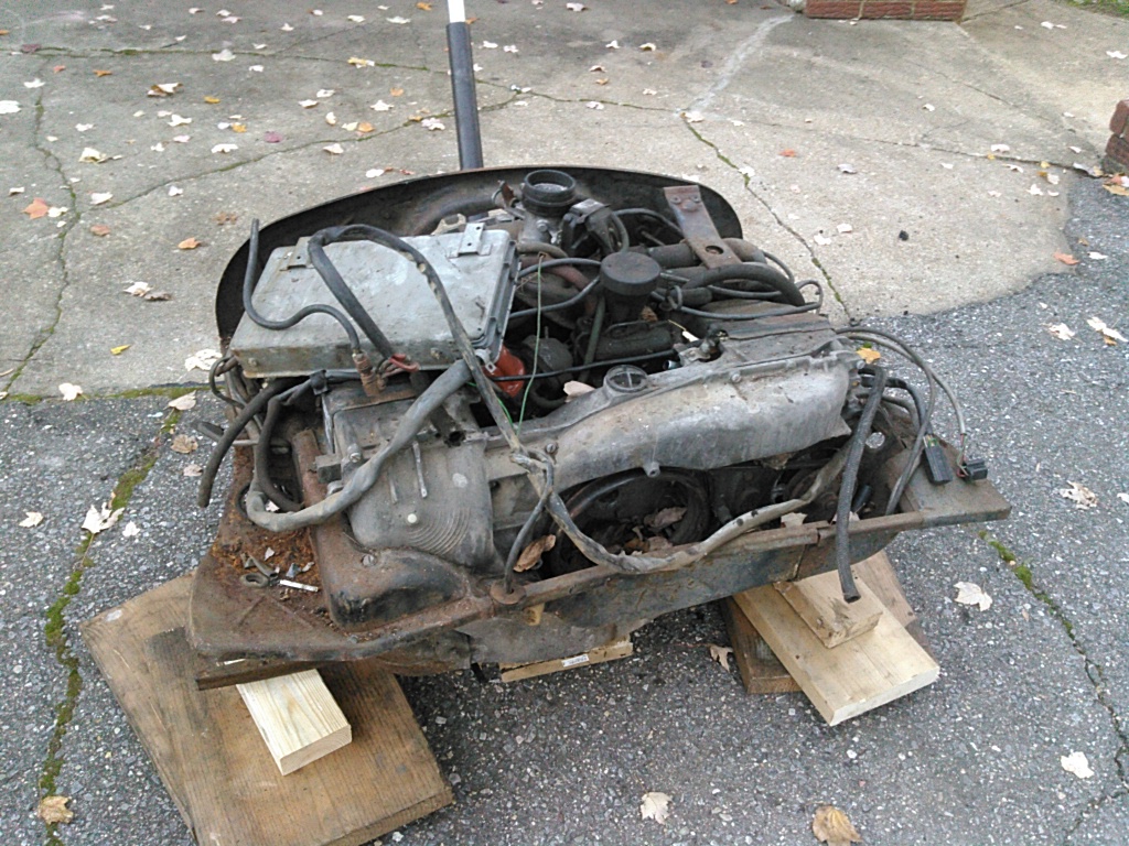

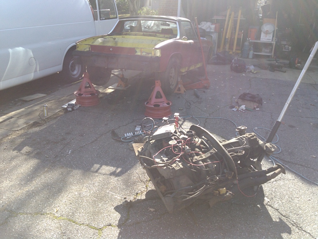

The first half of this month was spent finishing up Bretts car. But after that was done I got some work done on fitting the engine and buying a load of parts.
(IMG:http://www.914world.com/bbs2/uploads/post-172-1448258445_thumb.jpg)
First I removed the engine shelf.
(IMG:http://www.914world.com/bbs2/uploads/post-172-1448258531_thumb.jpg)
(IMG:http://www.914world.com/bbs2/uploads/post-172-1448516581_thumb.jpg)
Then I test fit the engine
(IMG:http://www.914world.com/bbs2/uploads/post-172-1448980488_thumb.jpg)
Reinforced and cut the hole

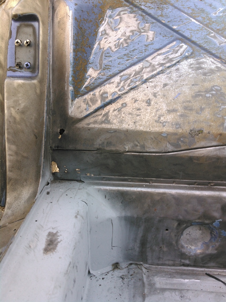

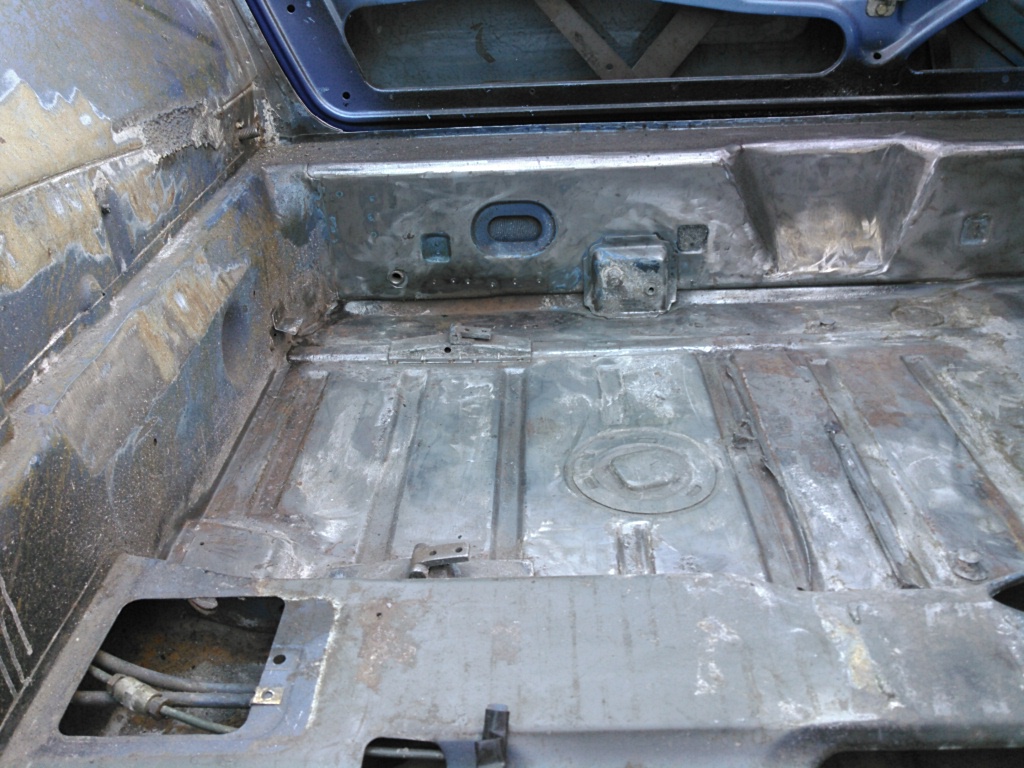

Alright so i know im late to the party and i apologize. I spent almost half of November on a honeymoon in Colombia so that will be my only excuse. I will not have anymore.
I did manage to get the chassis braces on the car which was harder than it should have been, but was expected given my automotive knowledge. Anyhow, i did manage to spend some time learning how to cut up a 914 from the mile high crew and am very gracious for that.
Alright so attached is a photo with the chassis braces on.

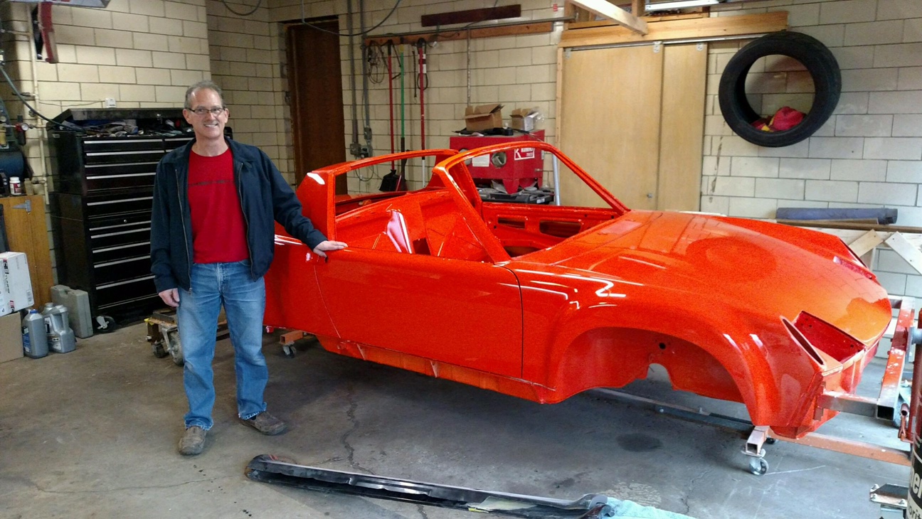

The month of December was very satisfying since the car was in the final stages of bodywork and painting. The car was painted a few days before Christmas and was buffed out on Christmas day. I was able to pick it up the day after Christmas which was very exciting!
I didn’t run into any unexpected challenges other than the car was done quicker than I anticipated but that is a good thing.
I haven’t had any shop or vendors offer any services but I will be taking advantage of 914Rubber’s generous discount offer in the next few days.
Below is my car finally back in my garage---Some assembly required!

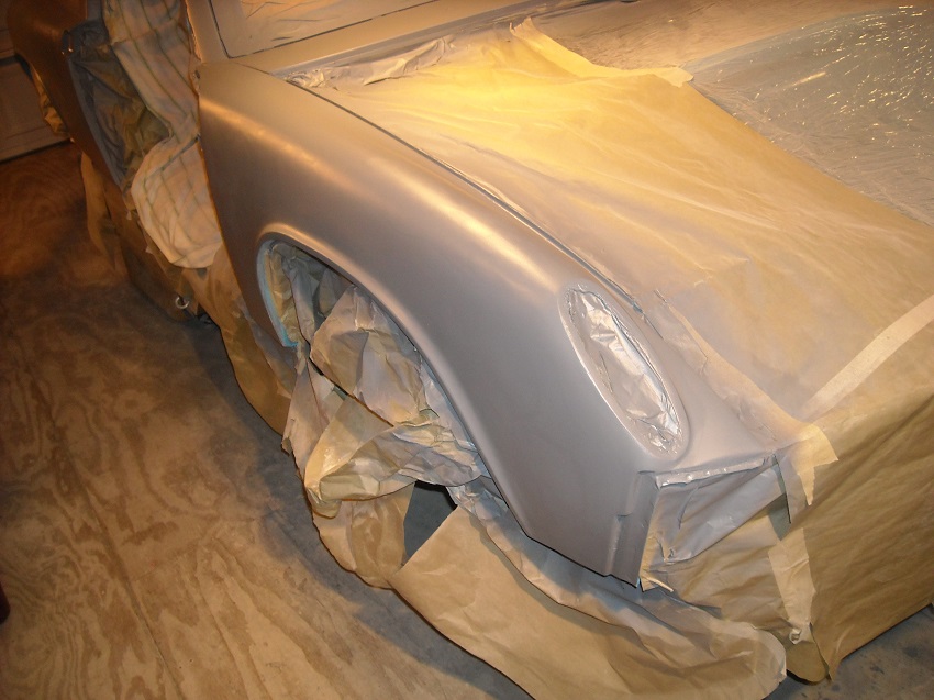

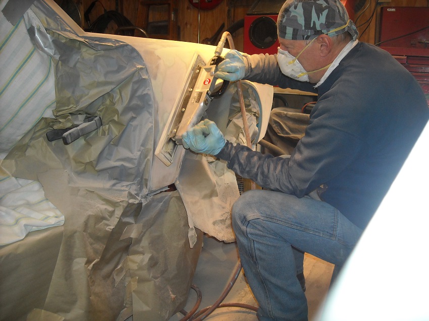

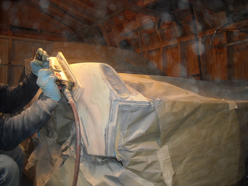

December update.
Well I did a bunch of this.
Then more of this.....
To get here... this is in PPG epoxy, then I'll shoot a couple coats of Slicksand and start blocking that down.
The lip on the fender is the hardest to get just right. but I am learning.
this still needs a little more work and the back quarter is coming along also.
I like the way the flares look, subtle, the front almost looks stock
Purchased new rocker covers from Restoration design, since mine were looking pretty bad.
still waiting on my PMB order. couple pieces are on backorder.
I got the bearing races installed in my front hubs. next I will put the Turbo tie rod parts onto the steering rack.
This competition is great for keeping me motivated. I seem to get a burst of energy near the end of the month..... (IMG:style_emoticons/default/smash.gif)

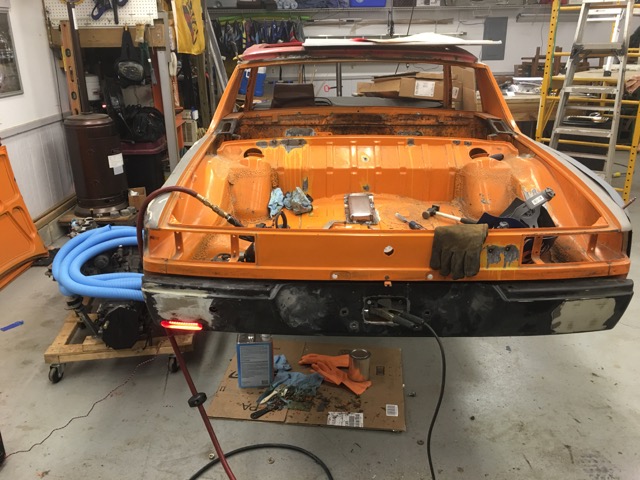

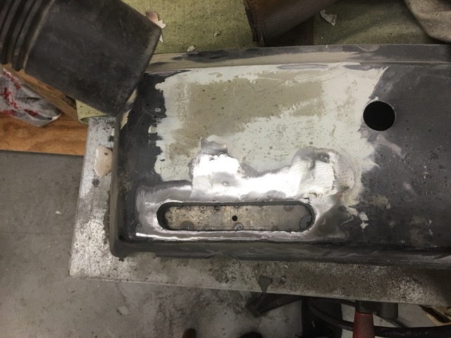

Lets see, a whole bunch of life got in the way. (IMG:style_emoticons/default/dry.gif)
Trip to Portland ended in a ride to the ER, but I caused our plane to get emergency clearance, and we arrived 30 minutes earlier than we should, way to turn up the wick.
Spent the next month trying to get clearance to drive again, that was no fun.
I am back to driving, all my doctor visits have found nothing, I am in prime condition except all the crap I all ready knew was an issue.
Thanksgiving, Christmas, Chanukah, Winter Solstice, etc.... Any excuse to not work on the car....
But the 914 got some progress despite all my efforts to keep me out of the work shop.
No outside services used yet, lots of parts and ideas being tossed around in my head. And yes I am still screwing around with the back bumper, rear trunk area.
Heres is what I spent my time on this month, 30 hours in this bumper this far.
With my novice skills I will most like triple the hours spent on a rear bumper (IMG:style_emoticons/default/screwy.gif)

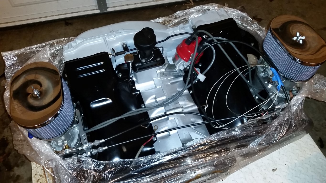

December Update: Extreme Budget Makeover - Creamsicle Edition
A. Progress
Replaced the 5+ year old Optima red top battery (that had been giving me issues for quite a while) for a standard battery. No longer need to keep a charger running overnight (IMG:style_emoticons/default/smile.gif)
B. Challenges
Keeping the 914 running well enough to get me back and forth to work. Most recently, an issue with the ignition system has manifested. Resetting the points and adjusting the timing has helped some. I plan to pull the distributor and clean it up as well as install new points and plugs (already replaced the cap) then adjust valves, set timing, and hope it clears up.
C. Shop/vendor provided services
As mentioned in my last update, my long-anticipated Raby 2056 showed up this month (IMG:style_emoticons/default/aktion035.gif)
Looks great. Is the top of the block painted?
