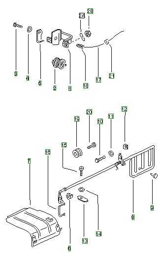

Here is a the bits.

In Miami, you may be able to get away with not using the thermostat, but I would run one. As Type 4 noted, you still need the flap over the oil cooler (#7 in picture.) Whoever told you they aren't necessary honestly doesn't know how they function. If they are in there and the thermostat isn't hooked up, it is not likely they are a problem. They were designed to be fail-safe. IOW, they retract to full-cooling position (read below.)
The flaps and thermostat regulate how much cooling air reaches the cylinders and heads. A spring on the rod between the two sides pulls them open (full cooling) by default. When the engine is cold, the thermostat pulls against the spring, and moves the flaps to a position where they block the cooling air from going over the cylinders and heads. As the engine warms up, the thermostat lengthens, opens the flaps and allows air by. Make sure you hook up the thermostat so it pulls against the spring when cold or it won't do anything.
The flap on the 1 & 2 (driver's) side only functions as above. The flap on the 3 & 4 (pass.) side has another function in addition: It guides the air over the oil cooler. That's why it's necessary. Without it, the air has to make an unassisted U-turn to go over the cooler. Since air follows the path of least resistance, it is unlikely much will go that way. Make sure it is hooked up correctly also. The 1 & 2 side flap is solidly attached to the rod that connects the two sides. However, as the diagram shows, the 3 & 4 flap is connected by a linkage. It is possible to hook it up so it works opposite to the other flap. If you do that, you will block the air from one side when the other is getting full cooling. When the thermostat opens, they will switch. Keep driving like that and the blocked-off side will burn up.

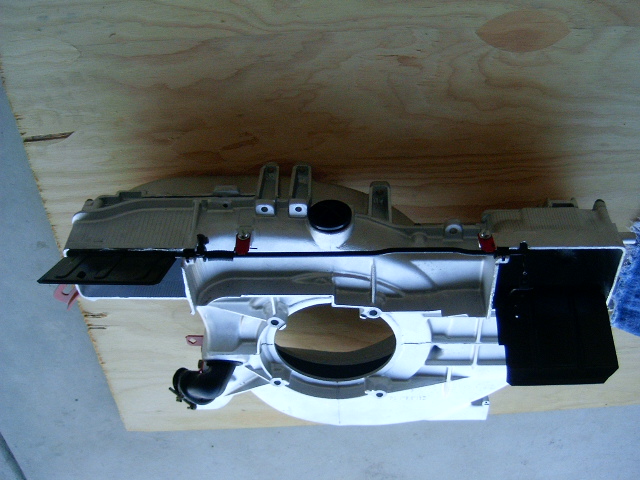

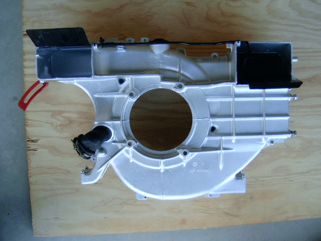

Here are a couple of pics with them installed on the fan housing. I don't know if anyone said it, but in the default position the one over the oil cooler is down.

2.

I had better go check the flaps. This make it look like one is mounted 90 degrees off from the other..?

QUOTE (Headrage @ Mar 6 2005, 10:06 AM)
yes, that (your pic. 1) is the default position for the flaps when the thermostat is removed.
the flap on the pass. side is *down*, meaning full air flow over the oil cooler and cylinders, the flap on the drivers side is *up* meaning full air flow over the cylinders.
this position (the default) will give you *max* cooling ...
