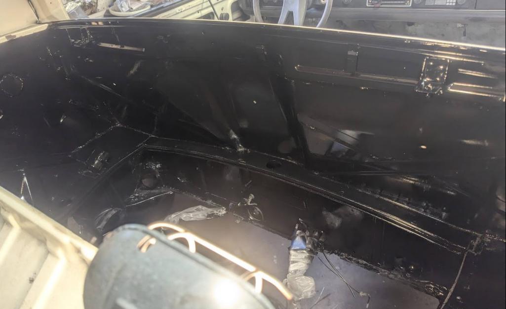

I would epoxy primer everything before coating. (IMG:style_emoticons/default/smile.gif)
Taking down to metal is nice because you know there will be no hidden rust or paint incompatibilities, but I wouldn't say it's necessary.

Hey Brett
I would prime any bare metal I was going to spray bedliner on. There is no need to take it all down to bare metal. Better off leaving good paint alone if you're confident the metal underneath is solid.

Ahh thats a good point. Since i cut out the majority of the metal rott except the trunk where i showed ya, i think i should be good to prime and raptor! May try the Hercules stuff over the raptor but its all the same sounds like.

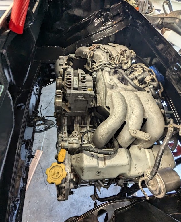

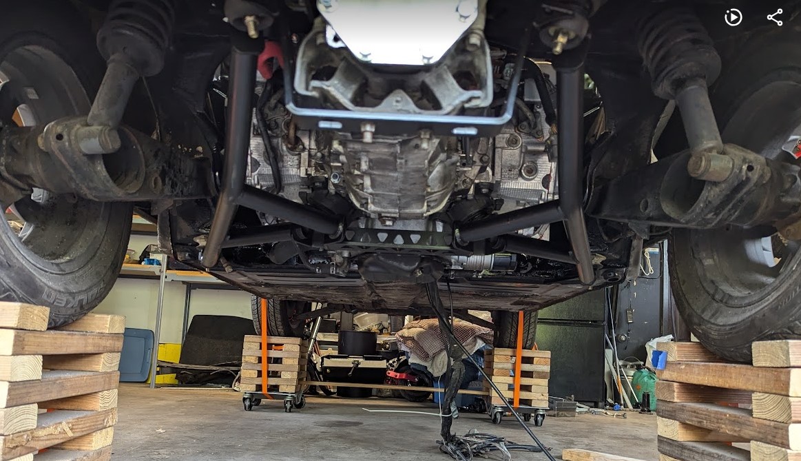

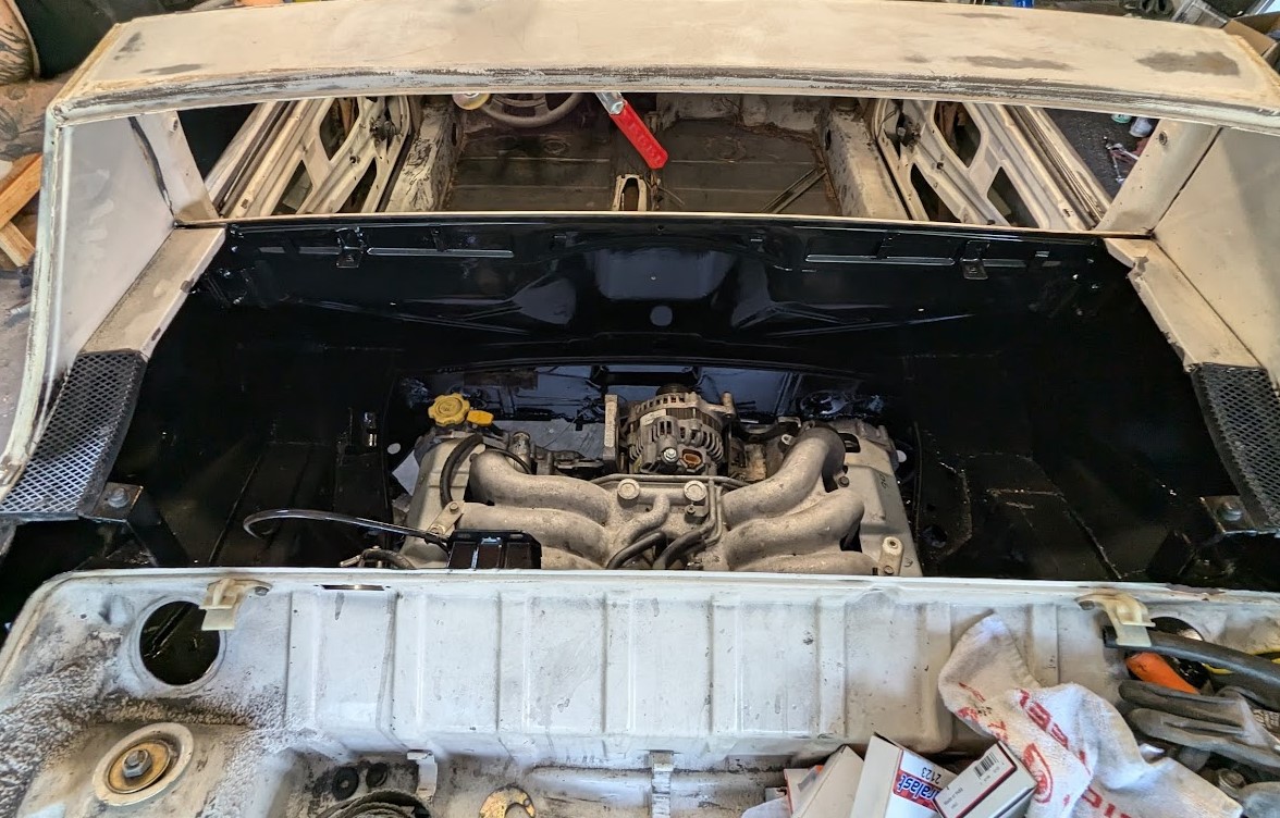

So ive been making some progress on the 914 and got the engine mounted and wiring all sorted. I ended up hiring a guy to help and that has been a godsend because i know i wasn't getting anywhere by myself. The engine cradle from coldwater worked perfect and just needing to get everything wired up and then the radiator sorted. Also got the engine bay painted.
Quick question - what is the best way to adapt the CV joints to the subaru engine? it seems there are multiple options but curious what yall think?
