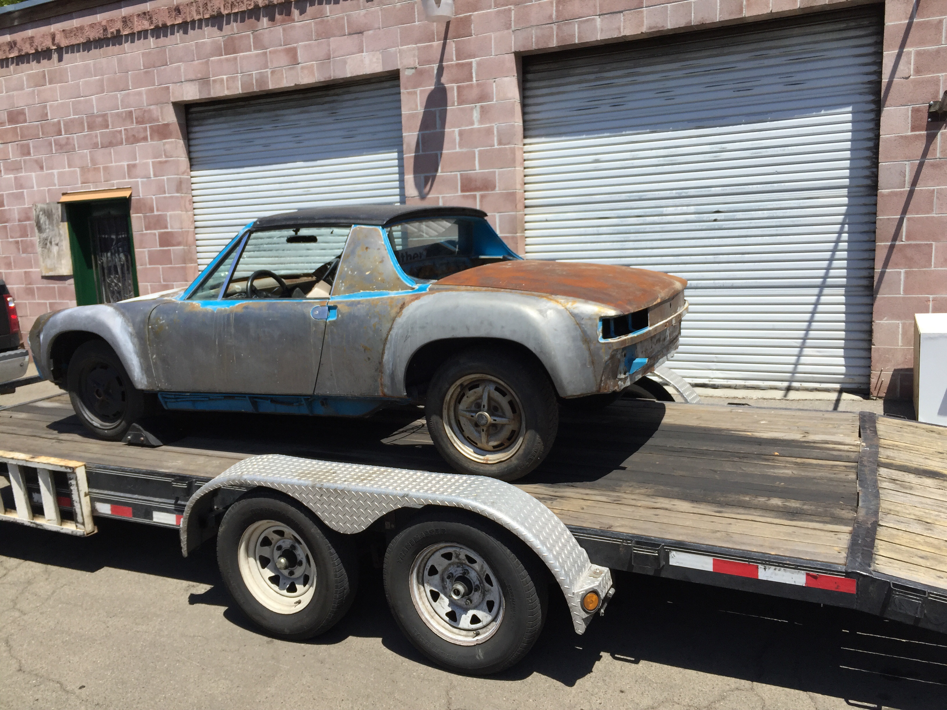

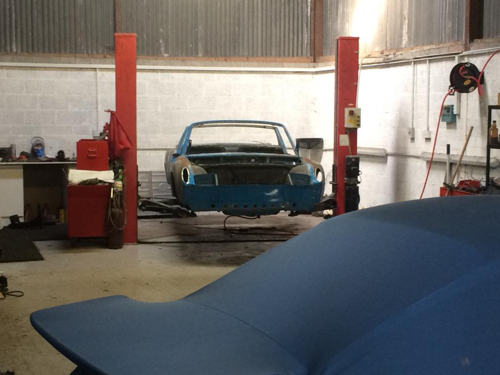

Hi everyone, just introducing myself and my project ! Some of you will have seen this car forsale here on the world, McMark was selling it for J Stroud, it was shipped over to Northern Ireland after a 6 week sea journey .
This pic is it leaving Marks old place
And it's arrival in my workshop

Welcome to the world...it looks like you're tight on space. i can store that other blue car of yours....no problem!

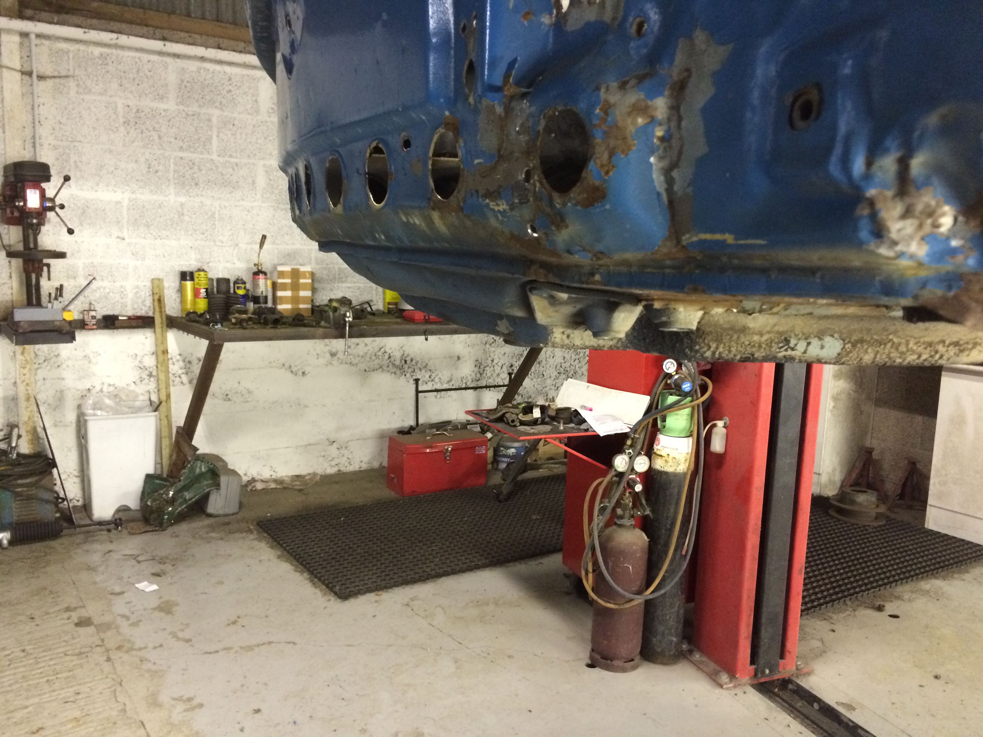

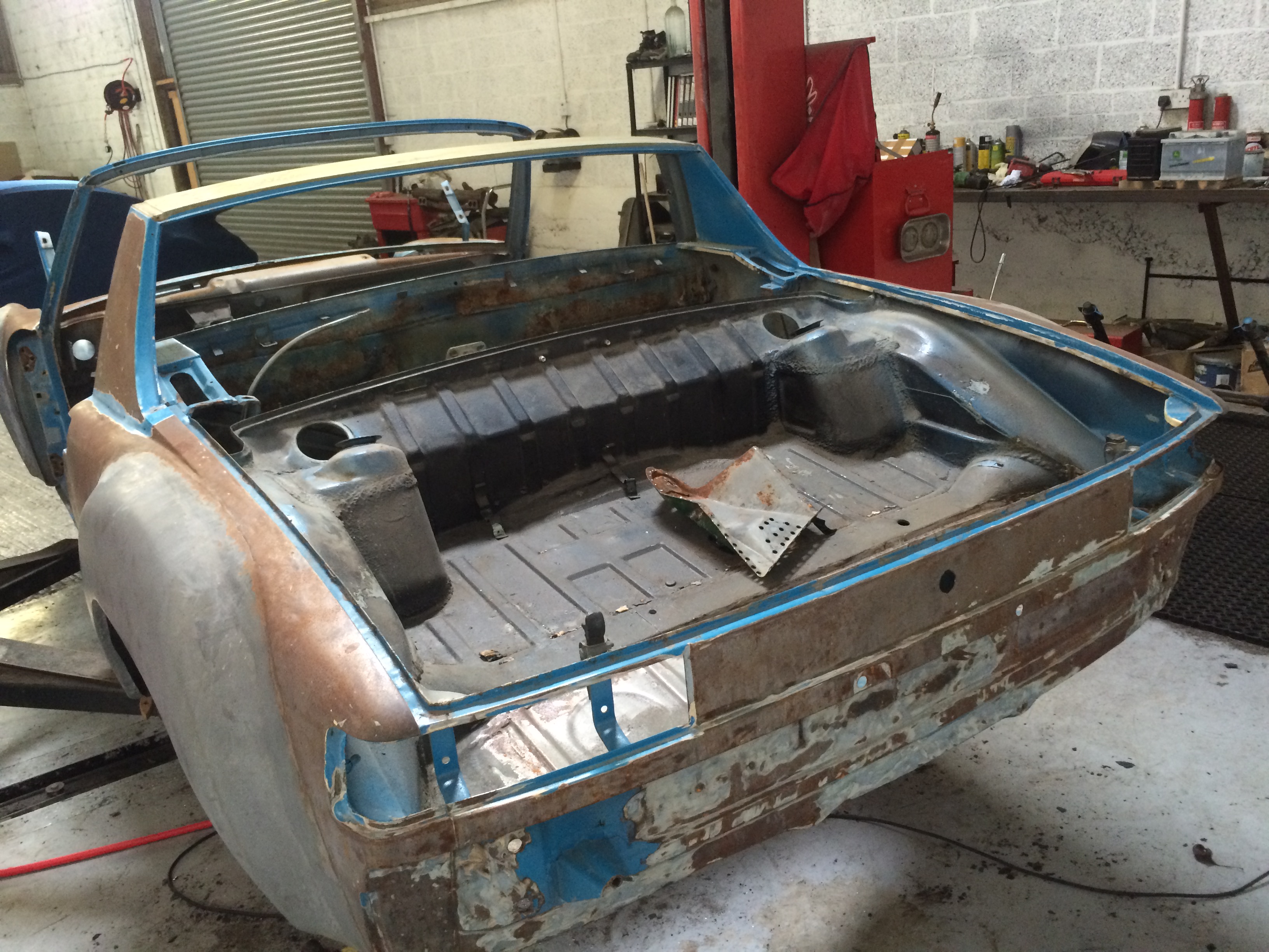

Thanks guys, fortunately I have plenty of room I dumped that old 911 out the back field (IMG:style_emoticons/default/sunglasses.gif) , I have it all stripped down now and up on my ramp, found some accident damage on the rear suspension console and driver side front but virtually NO rust (IMG:style_emoticons/default/biggrin.gif)
The rear

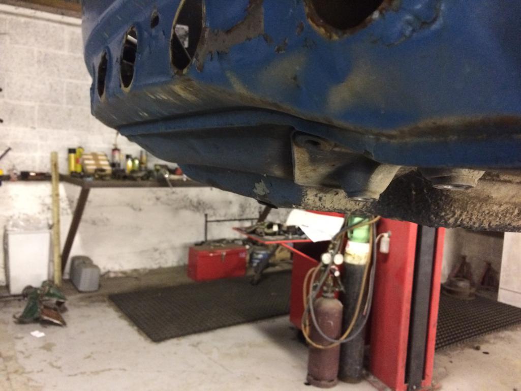

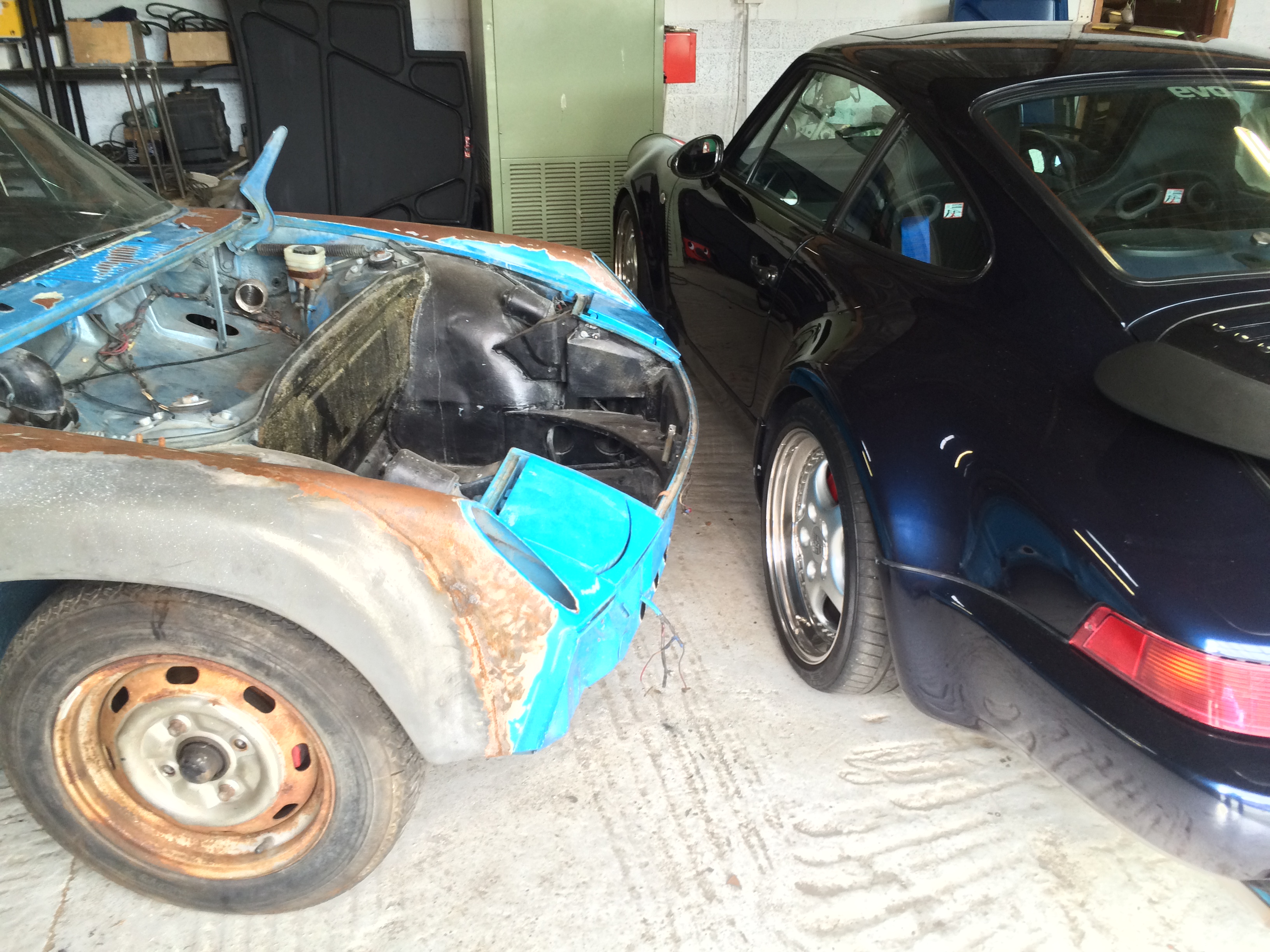

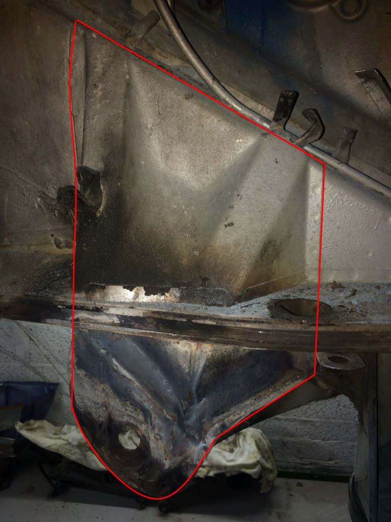

This is the front damage look like it was run up on a kerb ! It's about an inch pushed up !
The rear suspension console, I'm hoping I can replace the front and straighten the rear !
I hope it's visible the bottom is bent up and forward !

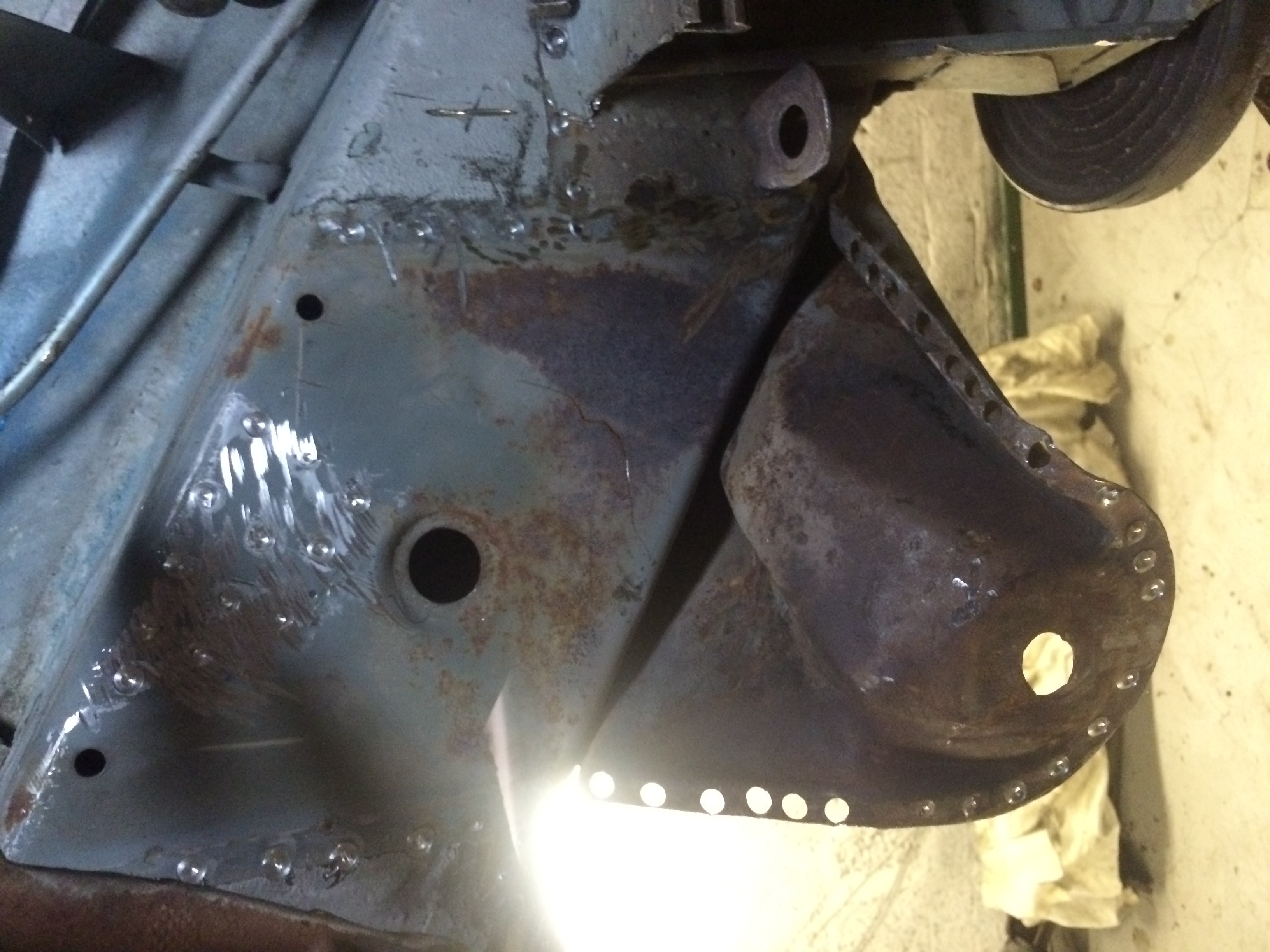

Ok so the kids are in bed and the wife is out so it was car time !! Just to add it beer o'clock here now, I bought some new spot weld bits yesterday and they working great, I drilled the spot welds on the rear suspension console out and it really miffs me I'm going to have to cut a perfect engine shelf to replace the front grrrrr
Now the front I had to remove a very bent support (not sure of the right name) before I could get the persuader out to shift the floor and front mounts back down I'm fairly happy ... Comments welcome ..... There's still work to do on the front panel, I checked the hood fit and it's good so all the damage was below this level.
Once I have the car straight I'll embark on the right hand drive conversion, I'm using a 911 pedal box and I have a second bulkhead and floor section to cut up as I want it to look as factory as I can make it , you guys will be the judges of that so here are tonight's work pictures ... And I'm doing this now (IMG:style_emoticons/default/beer3.gif)
The persuaded front floor .....
The drilled rear suspension console ...

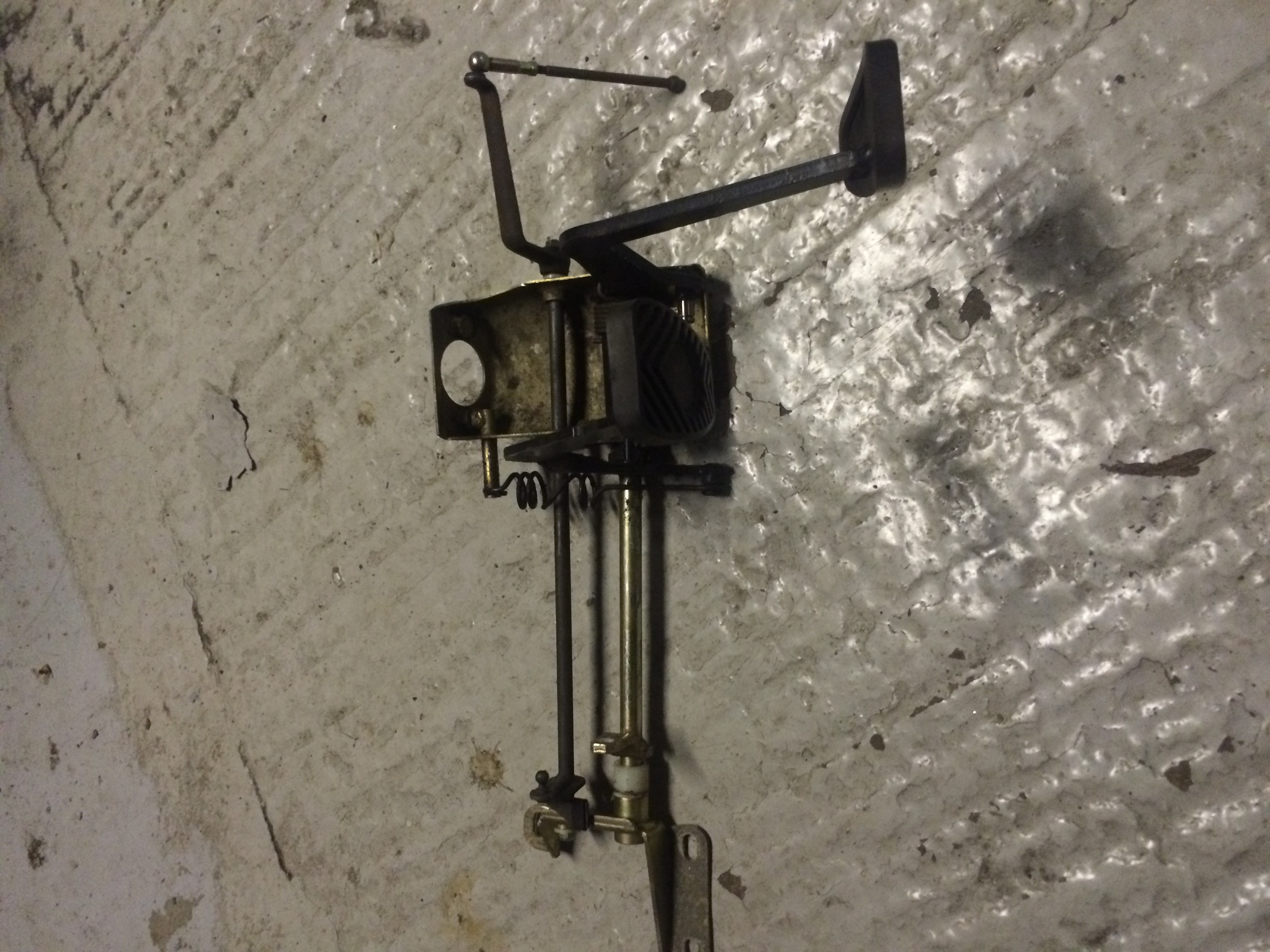

1a) straighten body and repair the small amout of rust, lengthen front footwell to accept 911 RHD pedal assembly, move park brake to right side including long indent, move parkbrake cable tubes to right side, move steering coulmn mount and make sure it all mounts up.

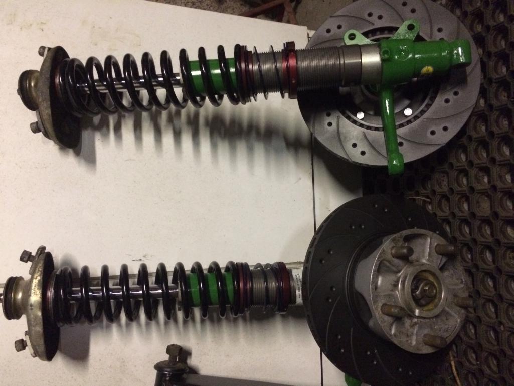

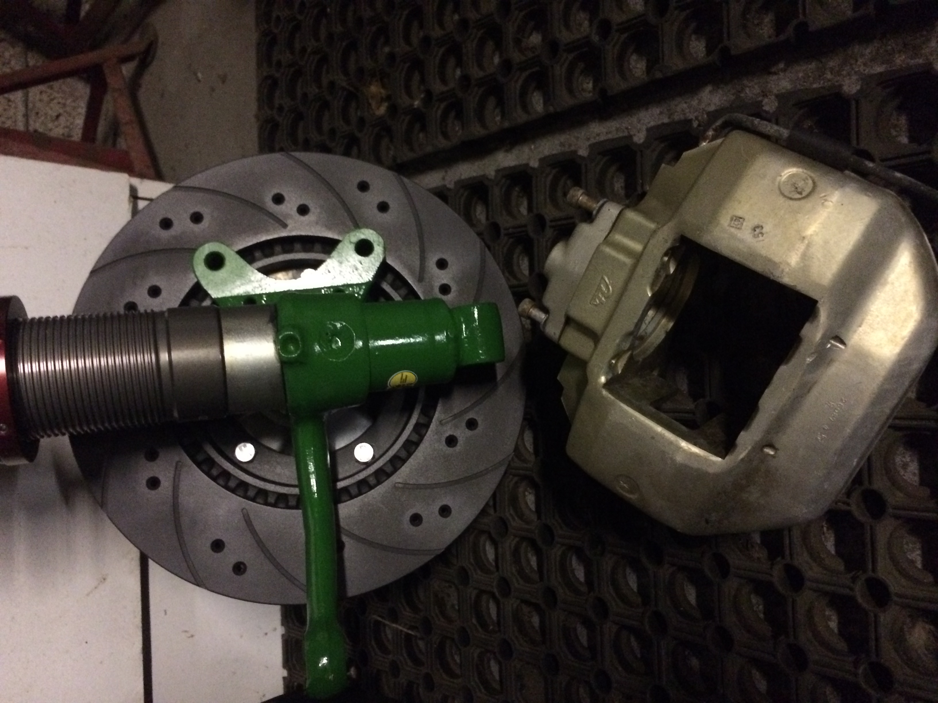

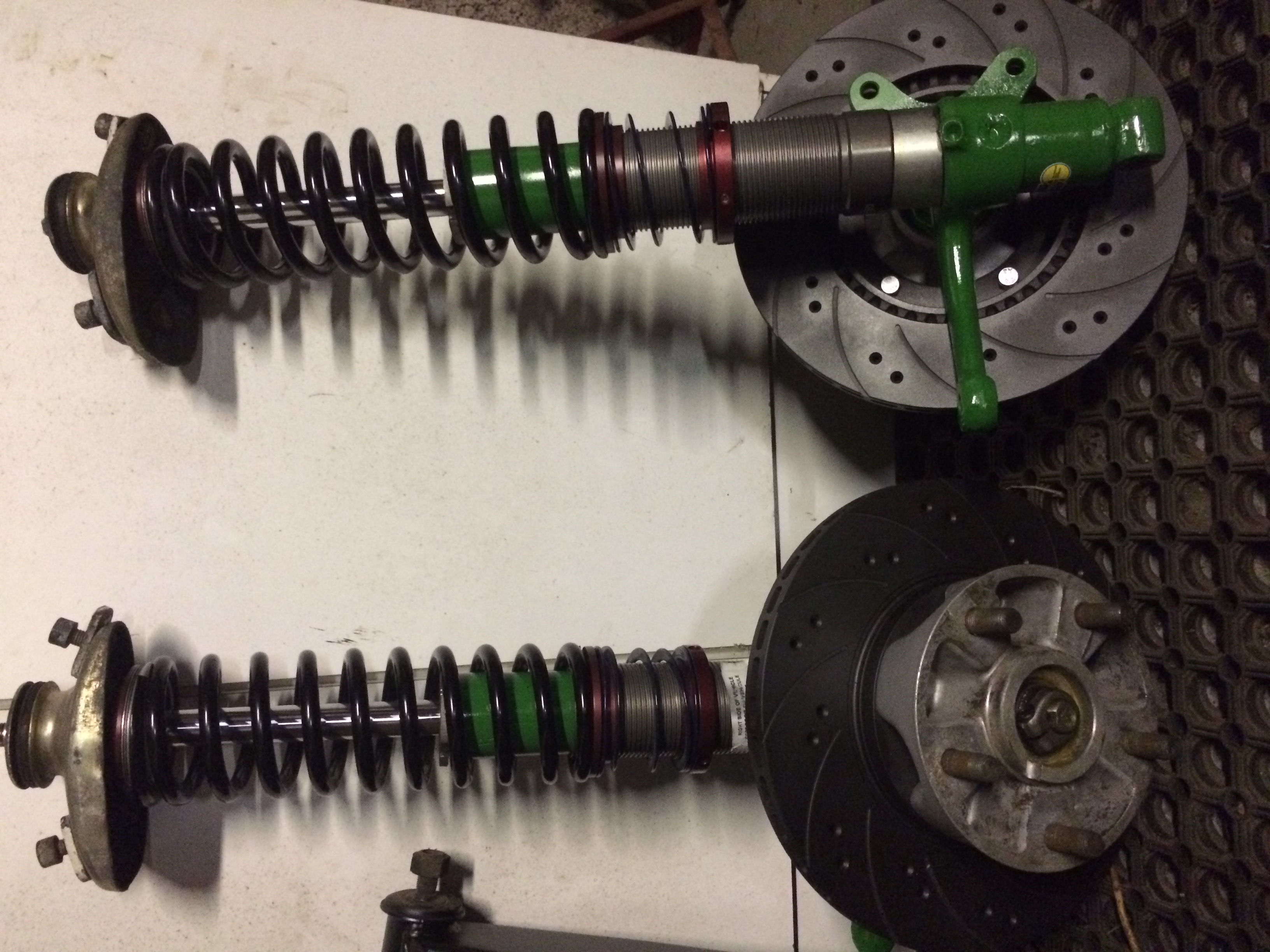

Well I was side tracked this weekend! The front discs arrived so I blasted and repainted the front struts
John Deere green and its really good paint, new inserts and Elephant racing coilover kit, I also stripped and cleaned my S callipers, ordered a full rebuild kit from PMB so they be like new soon!
Really need to get back to the body (IMG:style_emoticons/default/smash.gif)

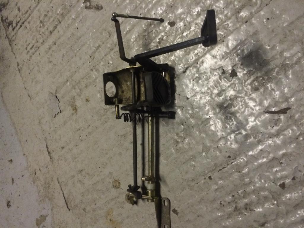

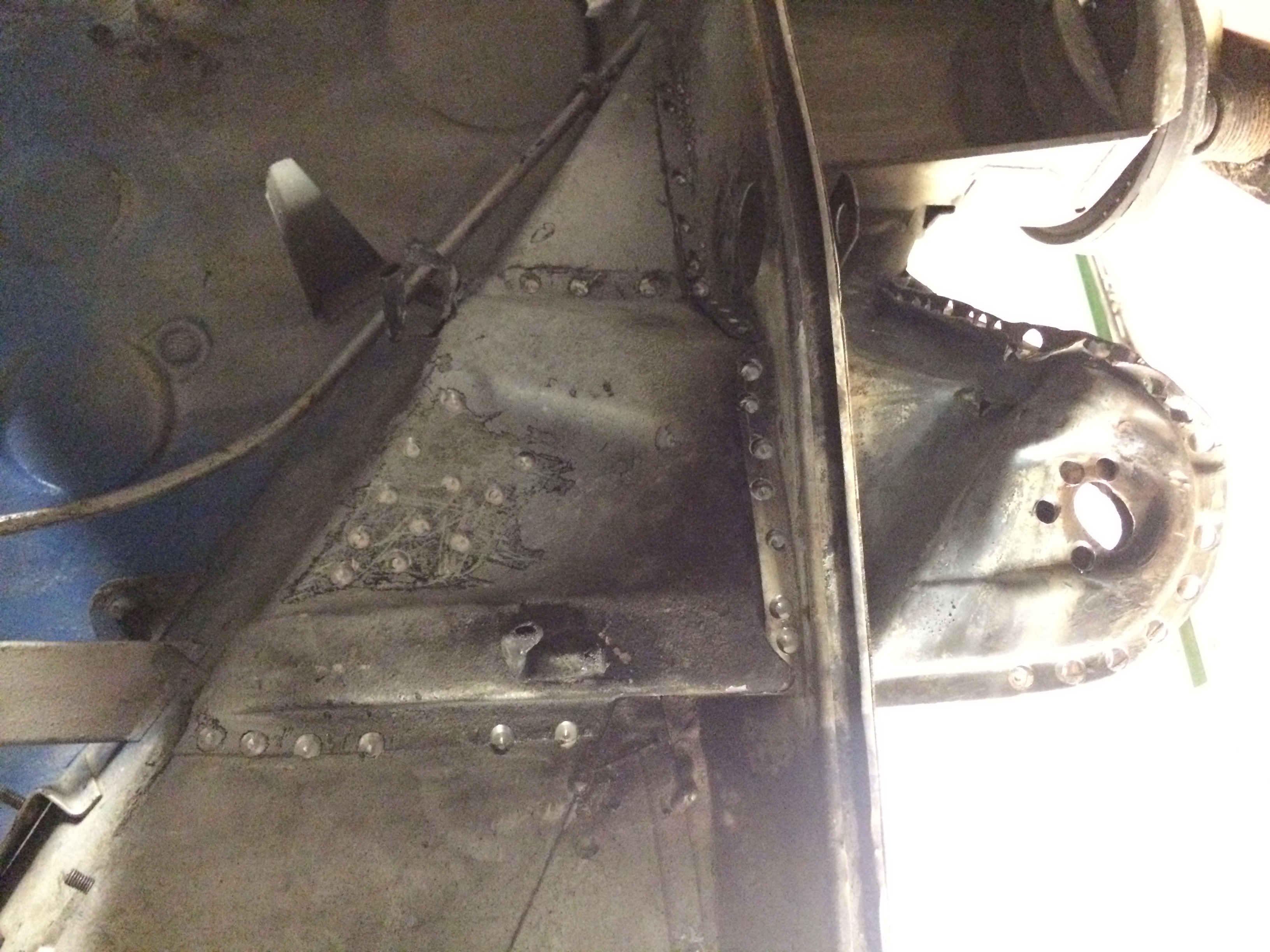

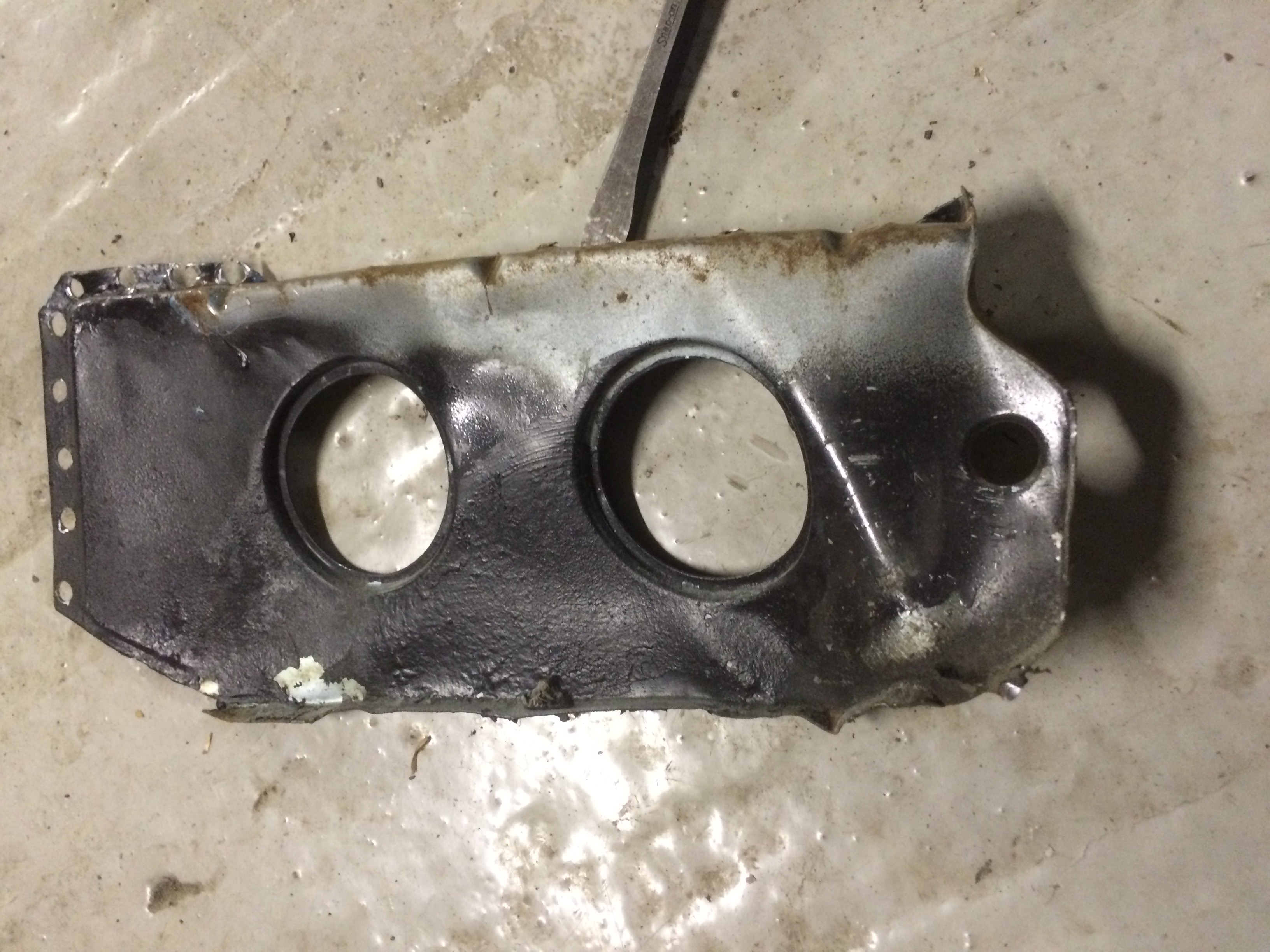

I have managed to do bits and pieces so here goes, I've removed the old damaged top off the rear suspension console
And the important bits arrived today after being miss shipped !
This now allows me to start the bulkhead modifications, so here goes .....

The main work to take place is the extension of the footwell to accommodate the pedal assembly I'll be starting to cut this weekend keep an eye out for updates as this is going to be fun.
I want to keep the look the factory probably would have left so once I've mocked it up please feel free to comment !
