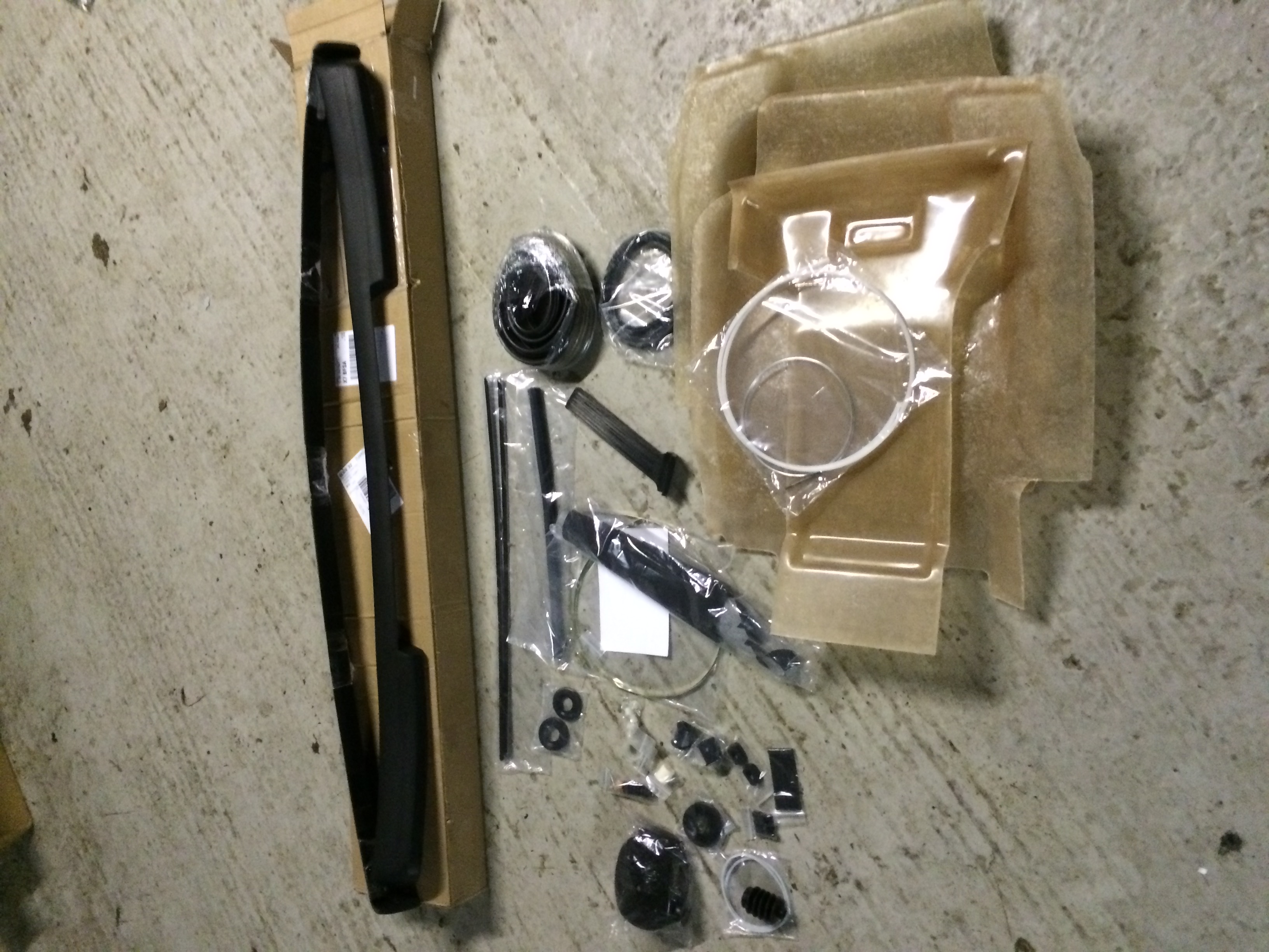

Evening all, well Santa arrived early today (aka FedEx) with a load of bits from 914 rubber , cheers Mark all arrived safe and sound

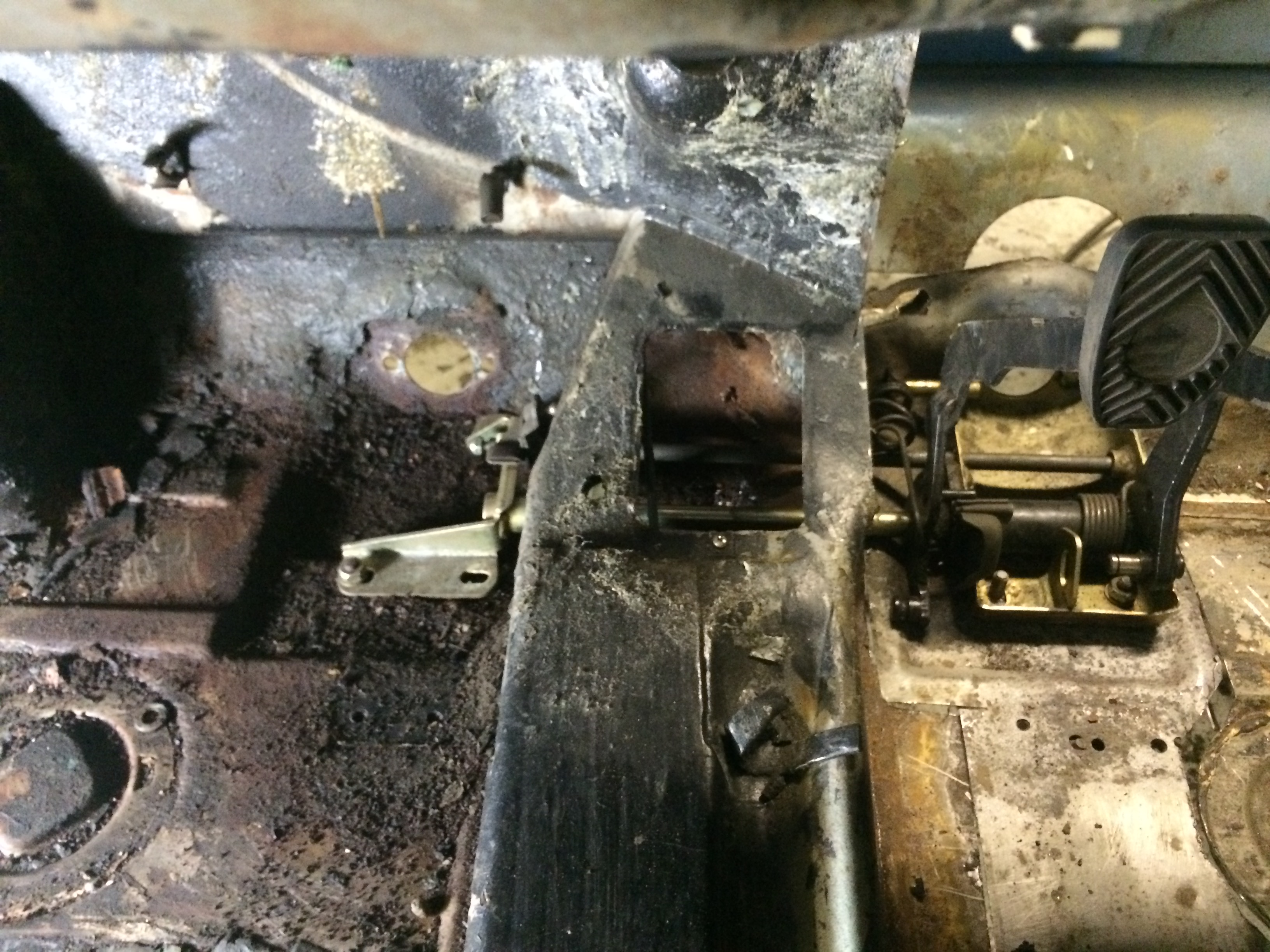

Well I started cutting tonight, I have bits of an old bulkhead I'm using for bits, so I've fitted the pedal holder very roughly and removed the front panel work to give foot room and to place the pedals in the correct place
Still a lot of cutting and tweaking to do yet (IMG:style_emoticons/default/dry.gif)

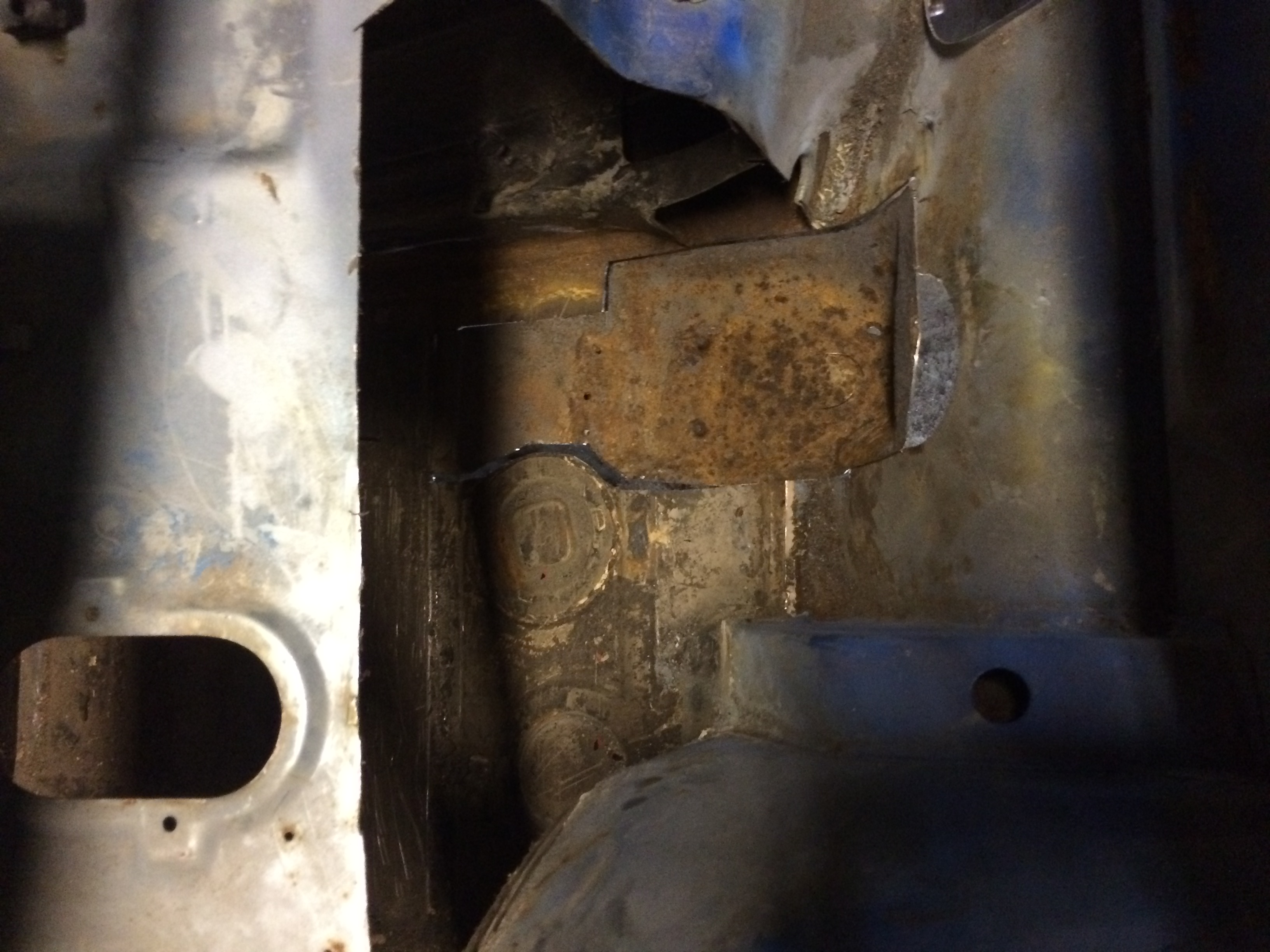

It's looking like I managed to get the measurements right ! The end of the pedal rods mounts on the old LHD pedal mount !

Gadzooks! You have your work cut out for you, Nutter. Do those shafts use some carrier or intermediate bearings? (IMG:style_emoticons/default/beerchug.gif)
EDIT: I'd like to see some close ups of that pedal assm and/or it's individual parts when you rebuilt it. (IMG:style_emoticons/default/biggrin.gif)

It's a complete setup from a RHD 911 so yes everything has bearings and is mounted as the factory does, this is the fairly straight forward bit, I still need to move all the corresponding bits for the hand brake (e-brake) and there's some modification to stop the steering shafts rubbing on the sheet metal .

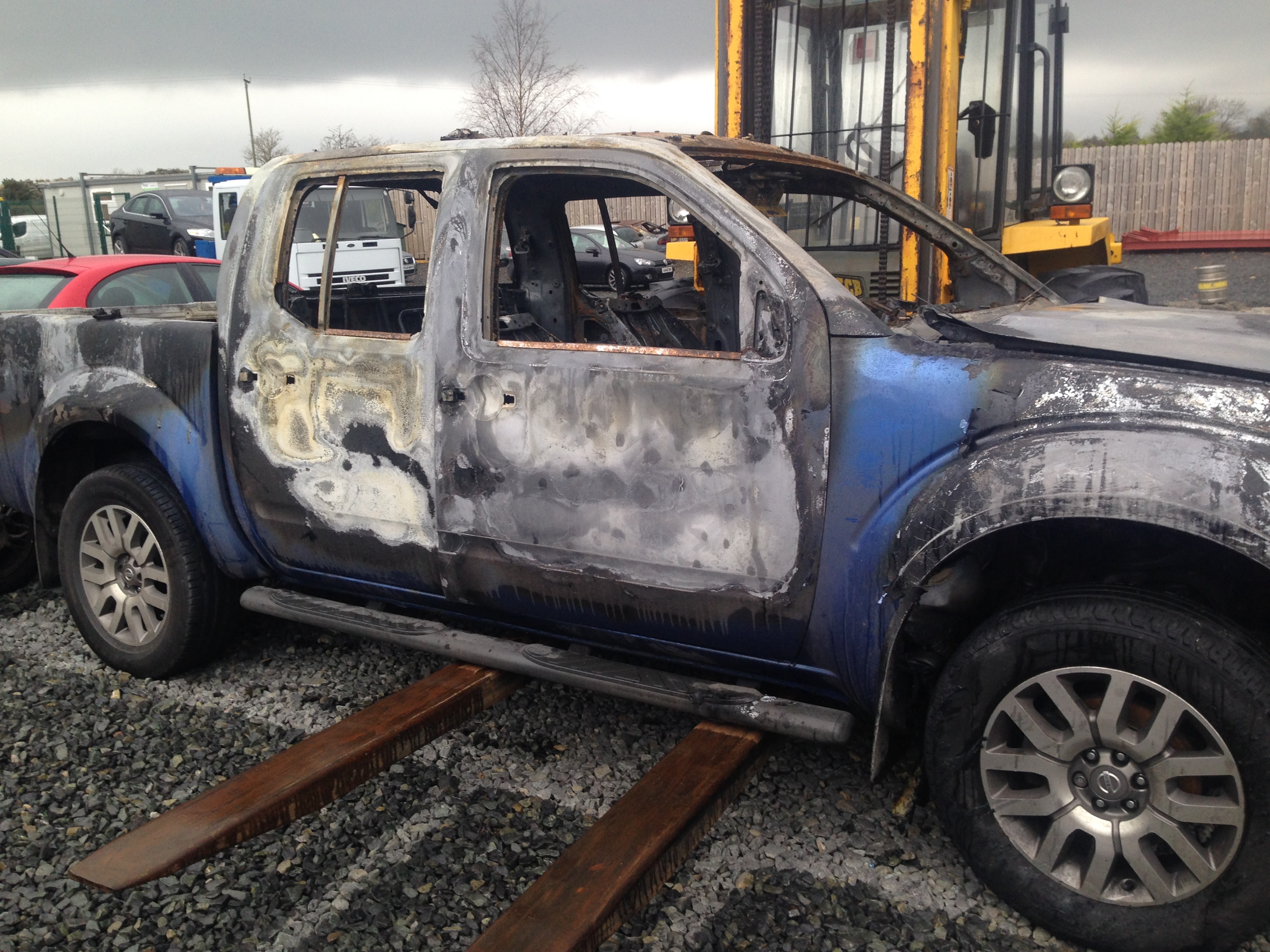

Hi guys and girls sorry for the lack of updates to say November was a kick in the teeth would be an understatement !
We had a visit from creeper burglars who stole all the keys for my Businesses , my wife's car and my pick up which they also took and to top it all my iPad and oakleys, they then took it for a trip to Dublin and I've been caught for the tole roads and then it was found like this
So my wife has been very upset as there was scumbags downstairs as we slept upstairs, I've been busy upgrading lights and gates and my rifle is now under the bed !

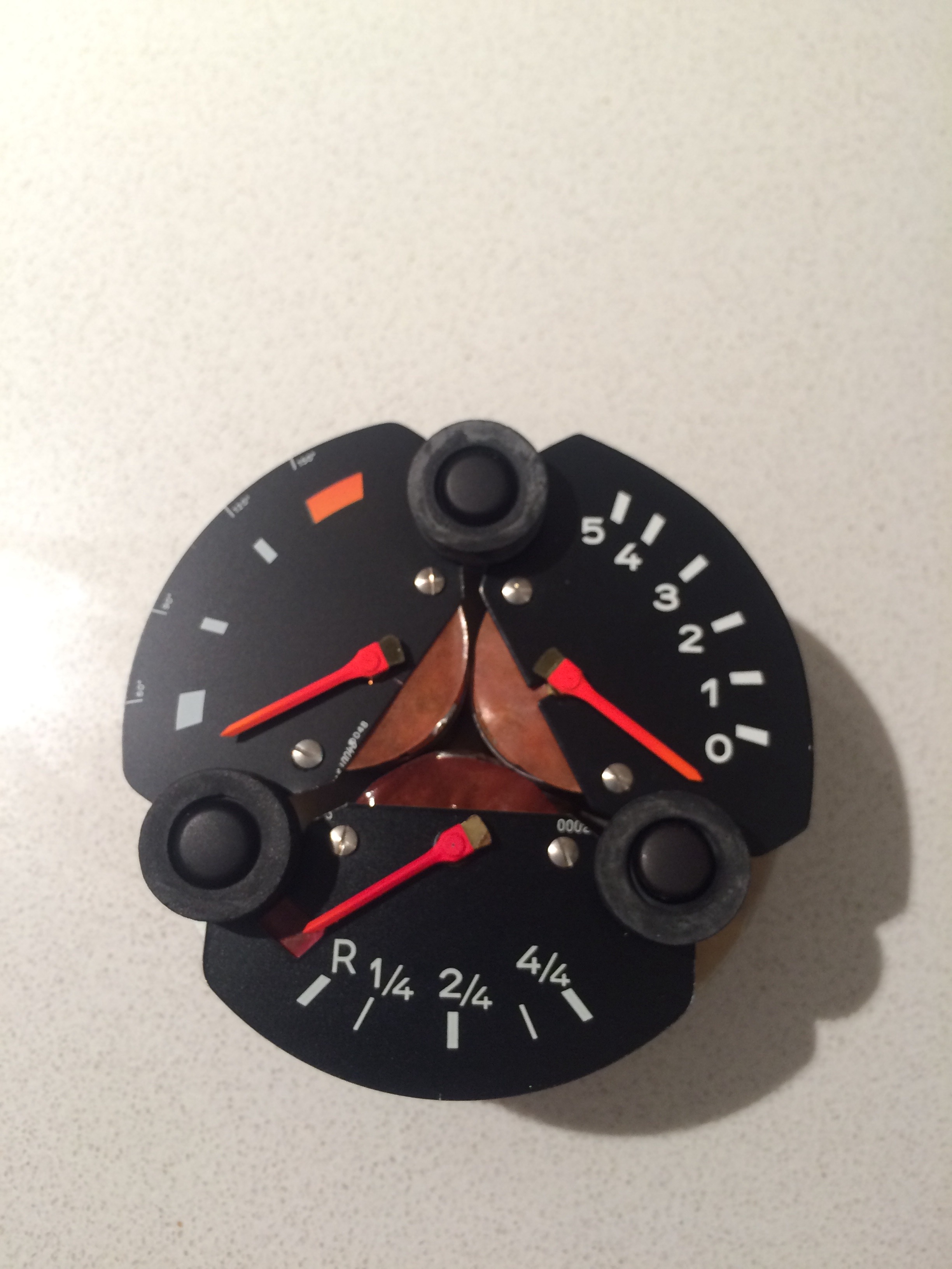

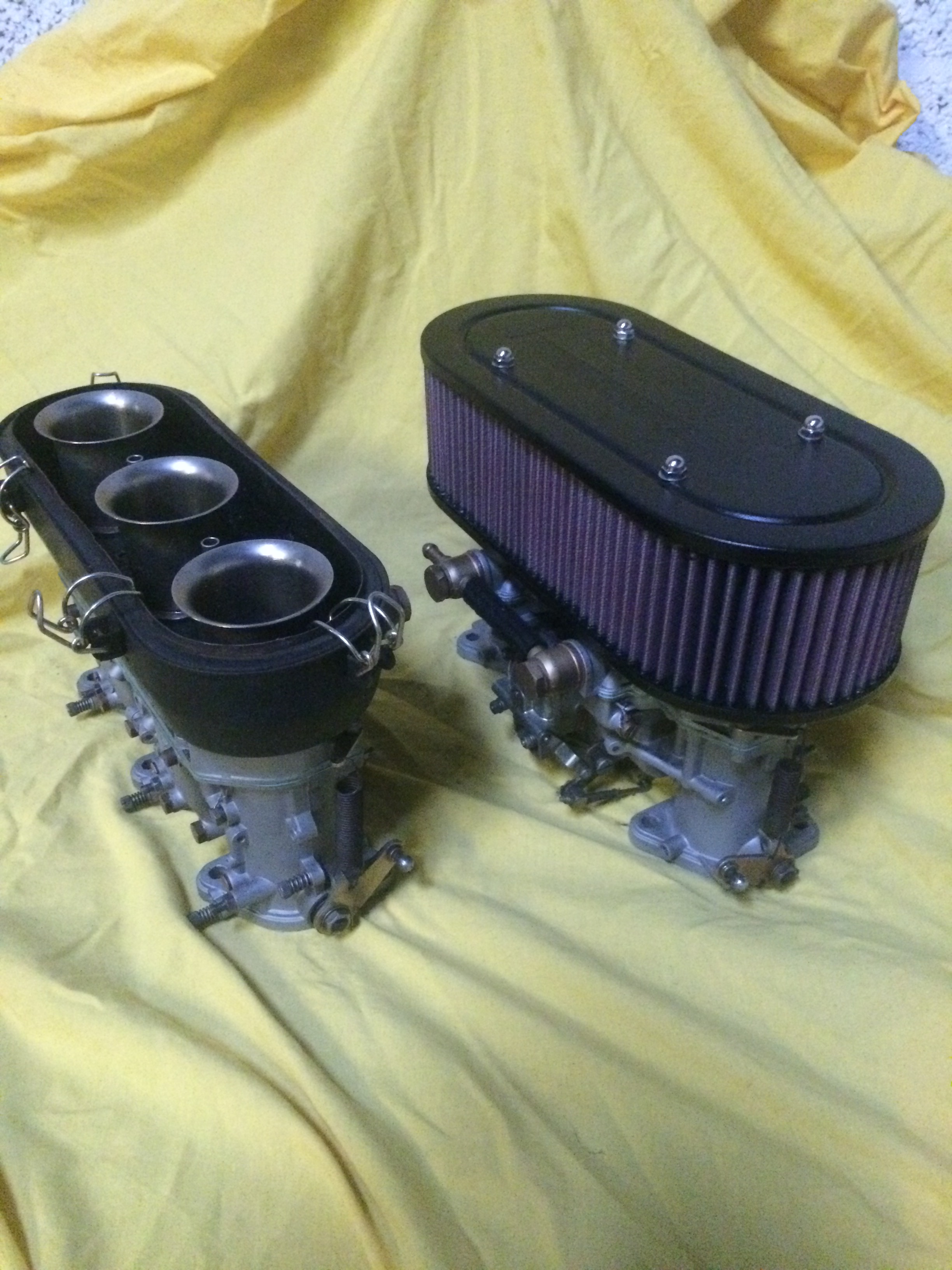

Ok so heading back on track, we'll sort of, couldn't resist building this up when my bits arrived !
Nearly finished
I promise I'll b back to welding ......

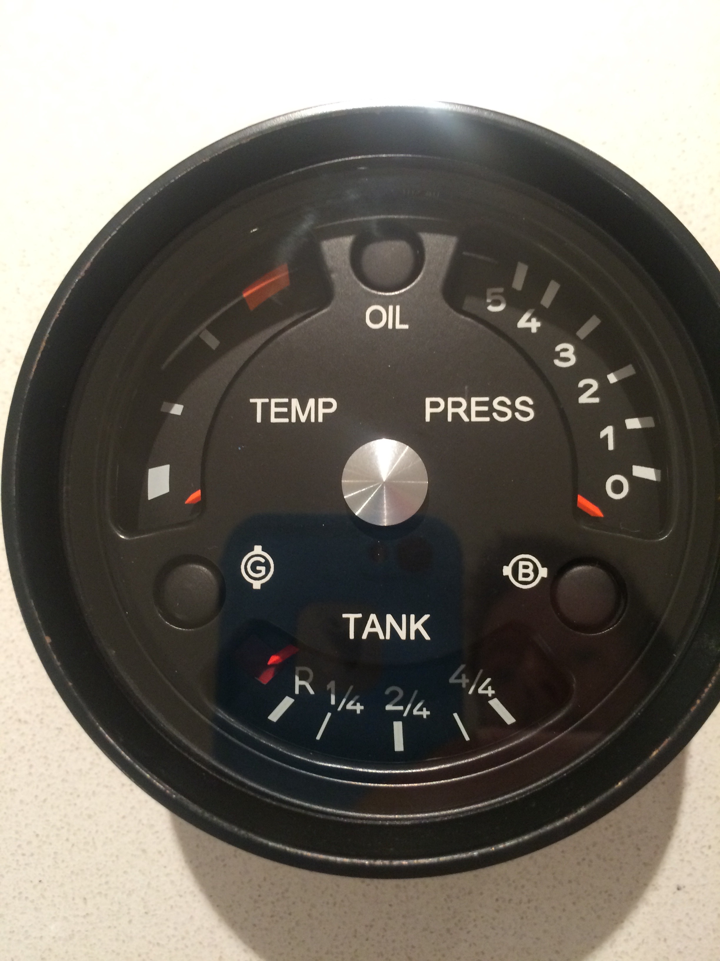

Yes, really nice gauge. I need to come up with one like that. Mind spilling the beans on how you did it?
John

I'm glad your gauge worked out for you. It looks great!

For all those who like the triple gauge this is the man to talk to (John above ) super kit and as you can see the finish is brilliant. (IMG:style_emoticons/default/biggrin.gif)

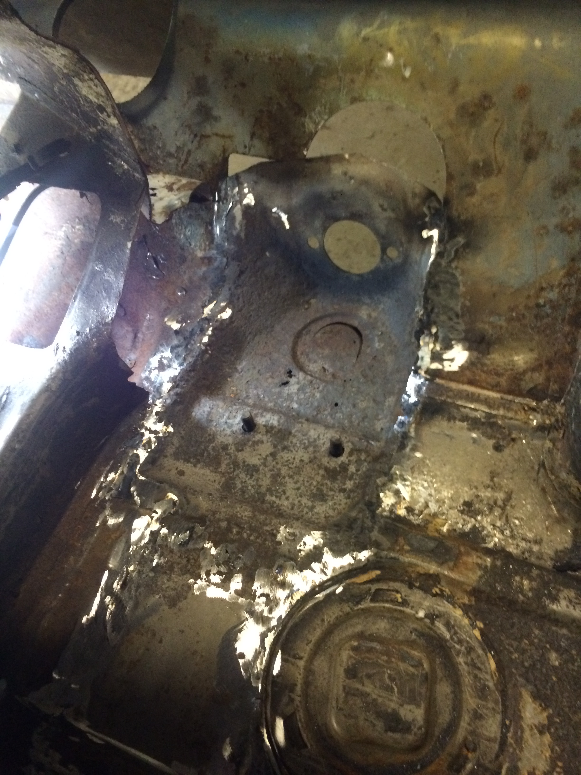

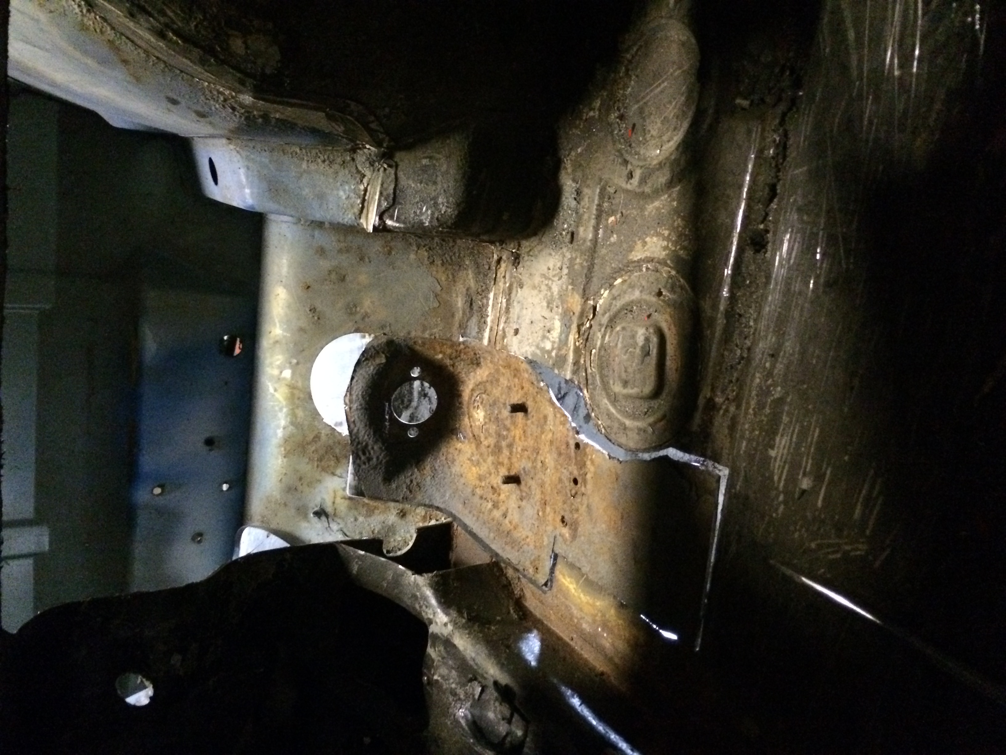

At long last i'm back welding .... so the pedal floor pan is in place and going nowhere ! next is the hand brake cable guide tubes, hand brake lever mount and dimple then the bulkhead ...

Theses arrived yesterday (IMG:style_emoticons/default/piratenanner.gif) complete with manifolds and linkages
(IMG:style_emoticons/default/drooley.gif)
