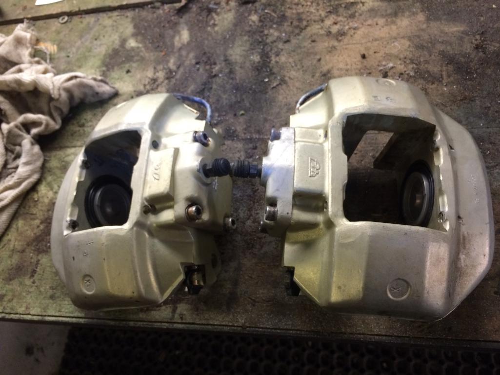

Ok, a little work done to some bits for the car ! It's just not welding weather .....

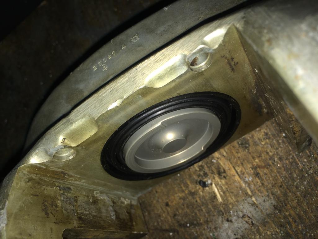

I rebuilt my "S" callipers with seal and piston kits from PMB, those DuroAno pistons are beautifully made !

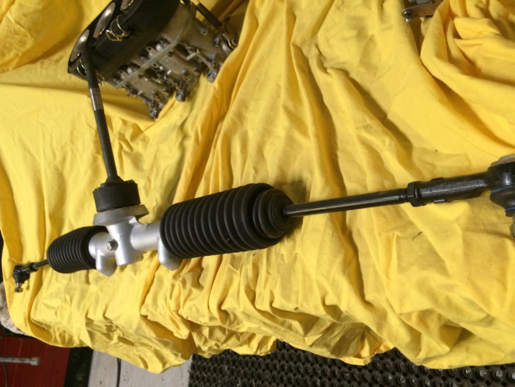

So on to the steering rack next ...

And the rack .......

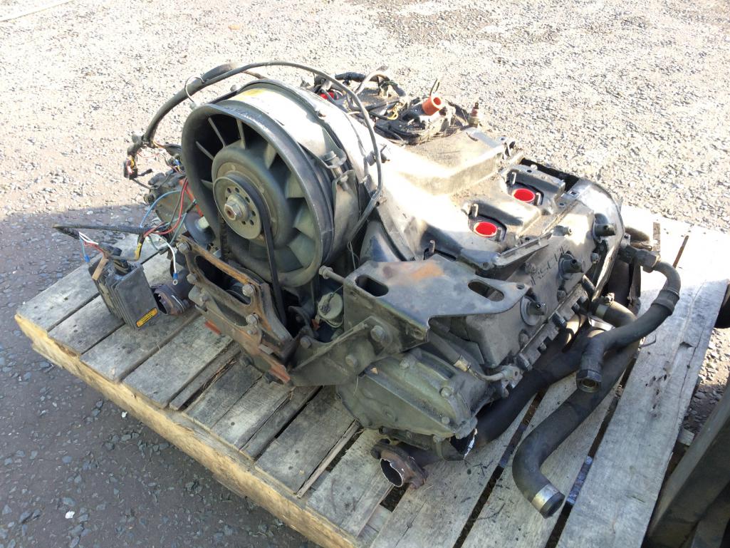

Picked this up from the shippers warehouse this morning, all the way from Phoenix Arizona !
2.7 with the webers i picked up earlier (IMG:style_emoticons/default/piratenanner.gif)

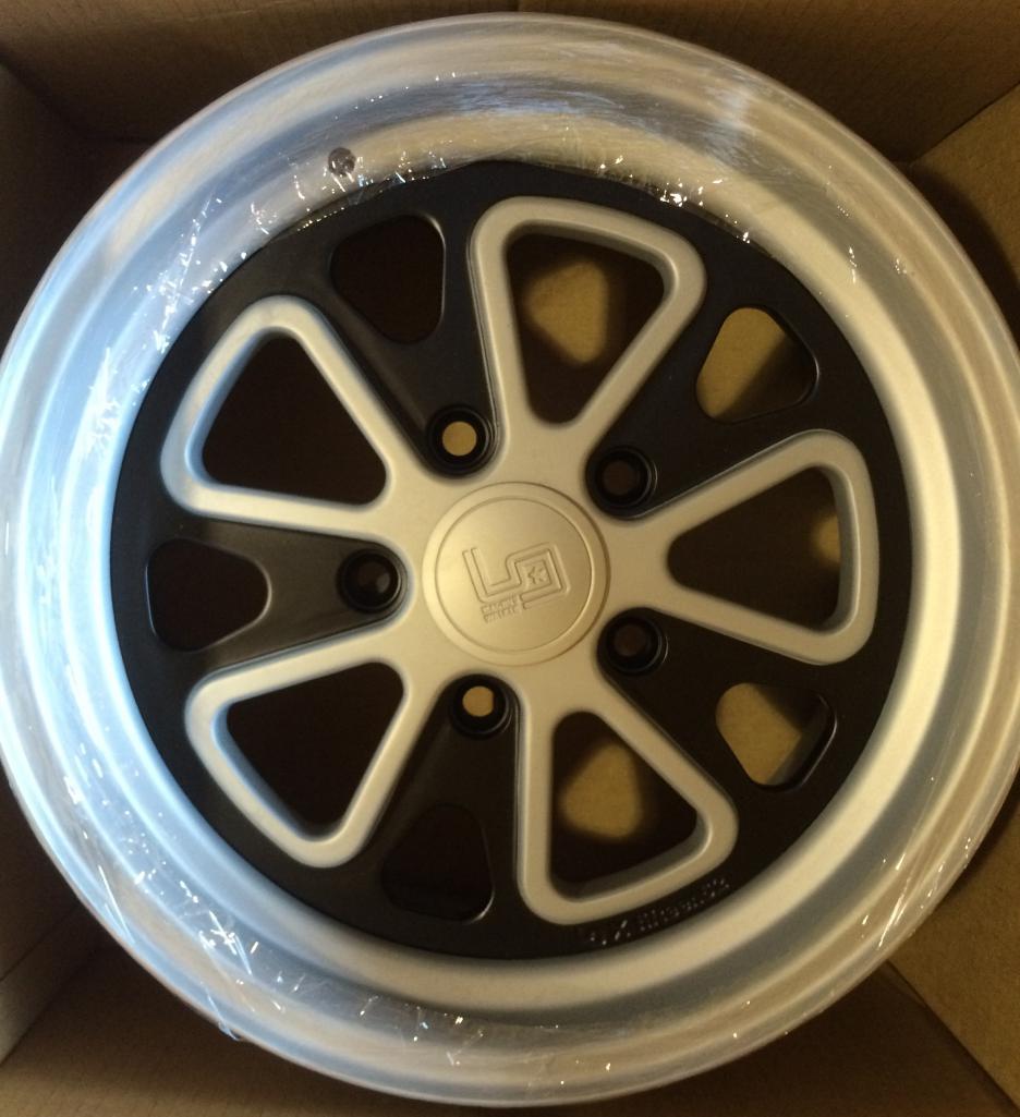

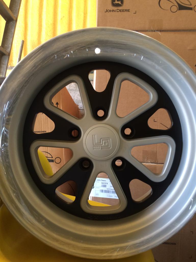

Yeah Fed ex arrived today and brought these !
Pure porn in my book, the sun is actually shining here today so hard to get a good photo .....

Those look great! I dont think anyone has put those on a 914 yet so I am very interested in how it looks!
What sizes did you go with?

I went with 7&8 X16's the fronts are even sweeter !

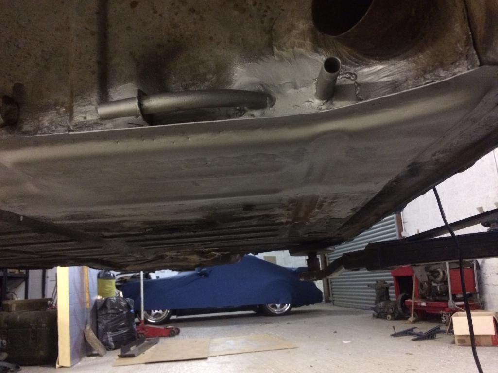

Evening all,

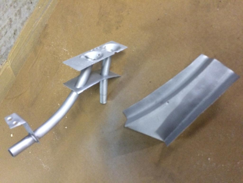

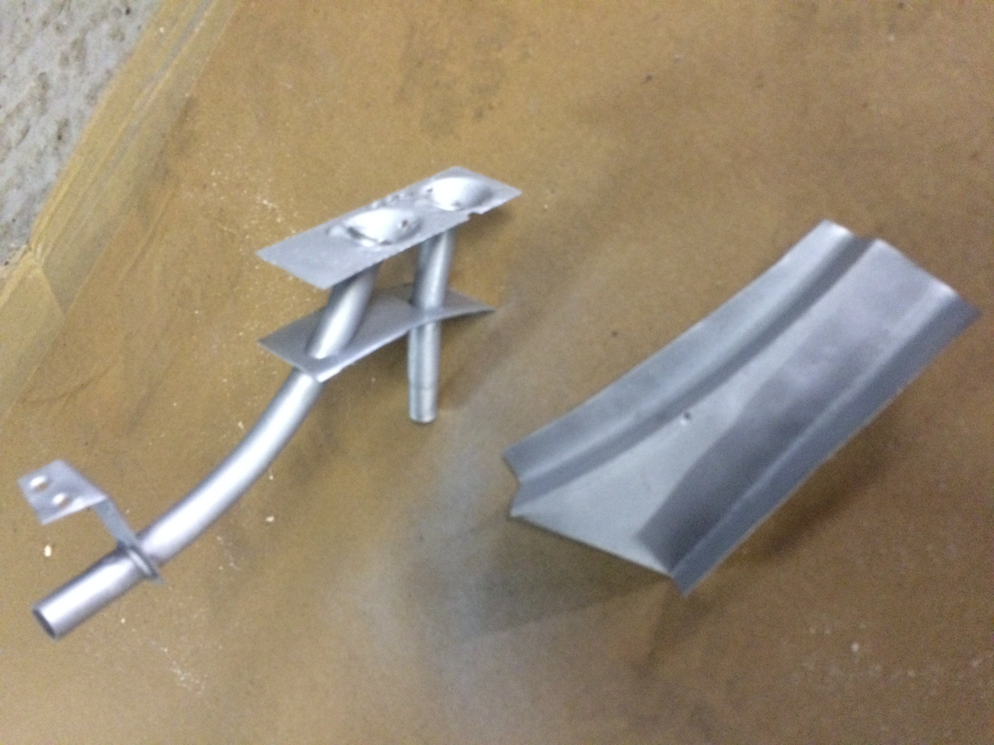

Managed an hour in the workshop this evening, I cut and flipped the cable guide plate and then trimmed, blasted and painted the extra set of hand brake guide tubes, ( it's weld through primer) so hopefully this week will see it all welded in to place.

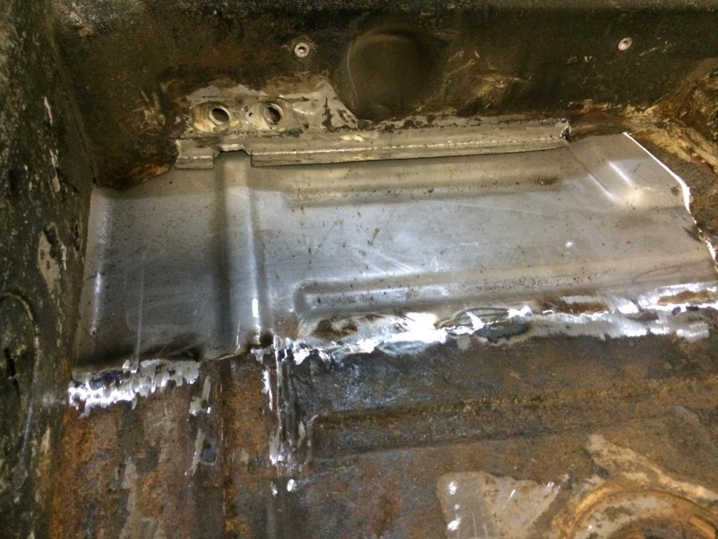

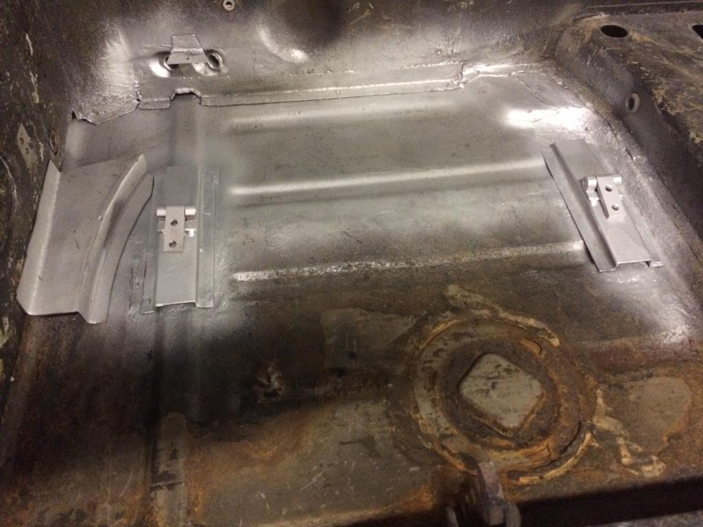

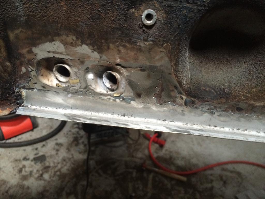

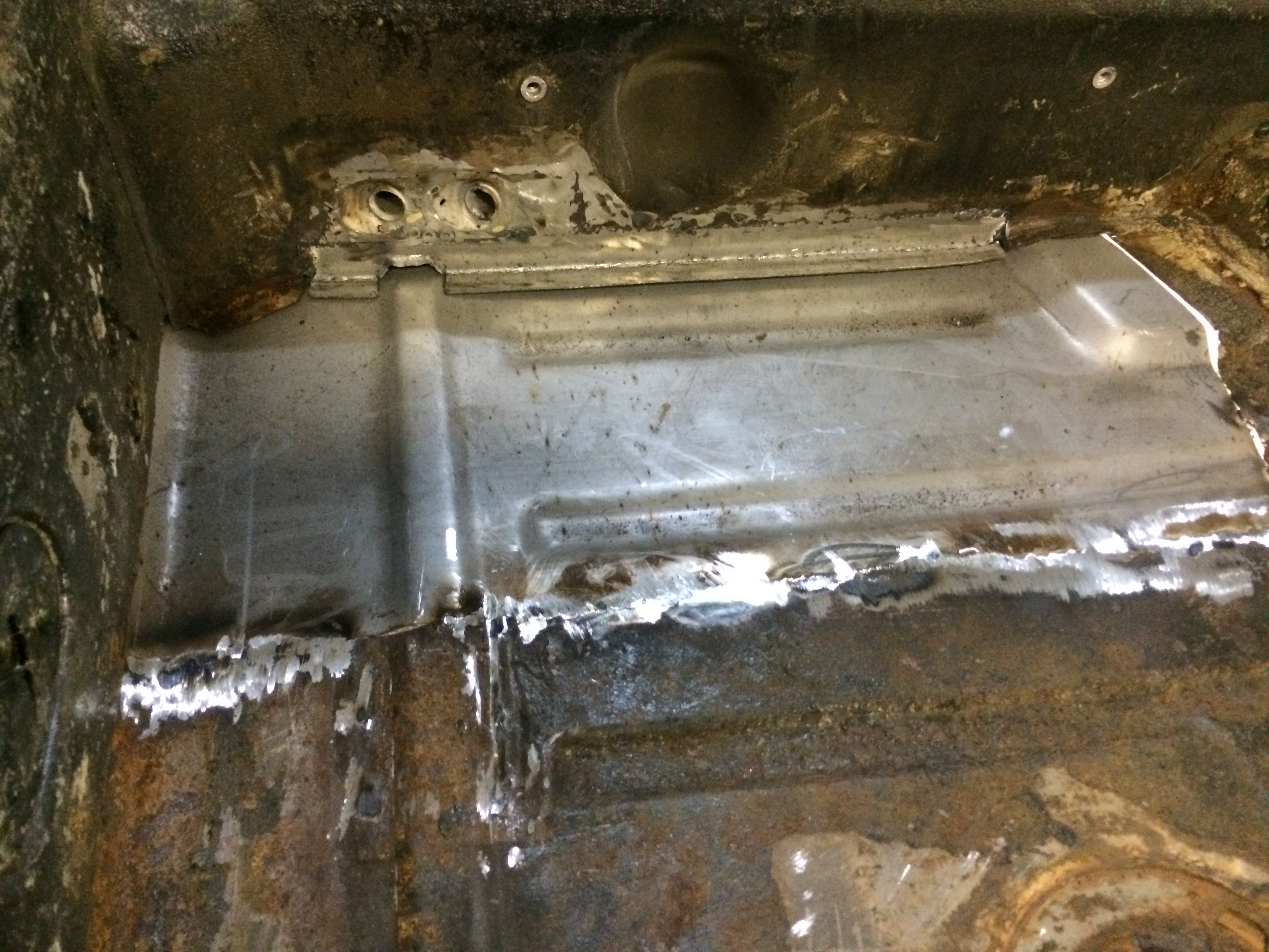

A couple of evenings has seen some progress ! I ended up removing the rear portion of the floor as it had been badly repaired in the past, so the guide tubes are in and a new lower edge fabricated and a portion of floor trimmed to suit
Floor in and tacked
Guide tubes on the proper side (IMG:style_emoticons/default/happy11.gif)

Yeah only two items left to do at the rear ! The hand brake mount and its associated dent in the inner long , I'm having to manufacture the hand brake mount as it's completely reversed!
A little bit of cleaning up to do oh and the floor reinforcement

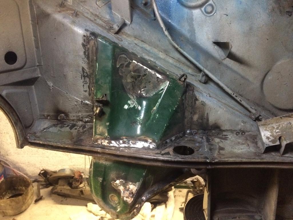

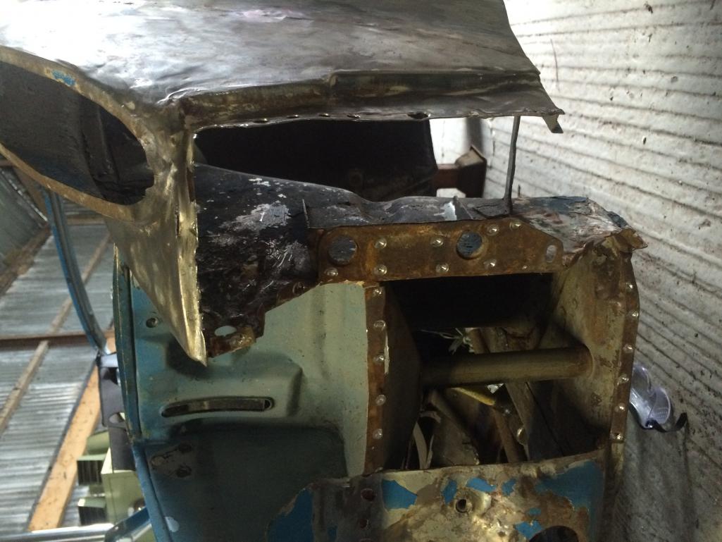

A little more completed last night, engine shelf welded back in to position and the suspension console completed

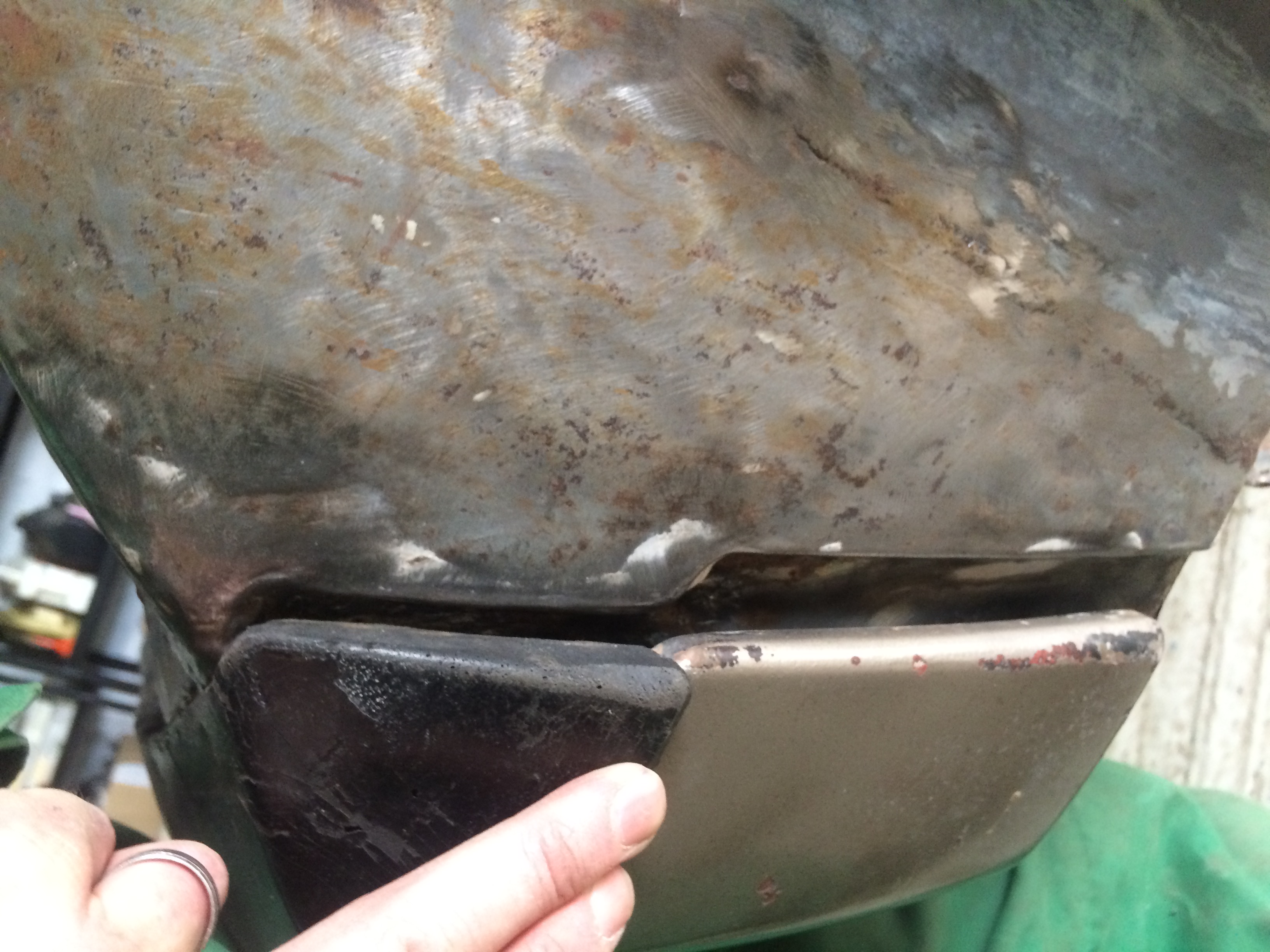

I'm assuming the same dog bones are used front and rear ? I have a poorly fitting rear bumper ! The front is fine thankfully

Real swell,a decent looking retake on the 5Fuchs design,to the desired size and finish.

QUOTE(Nutter965 @ May 7 2016, 04:58 AM) *
Dogbones are used both front and rear.

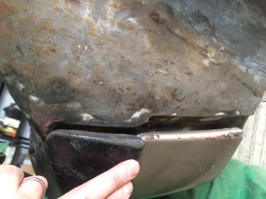

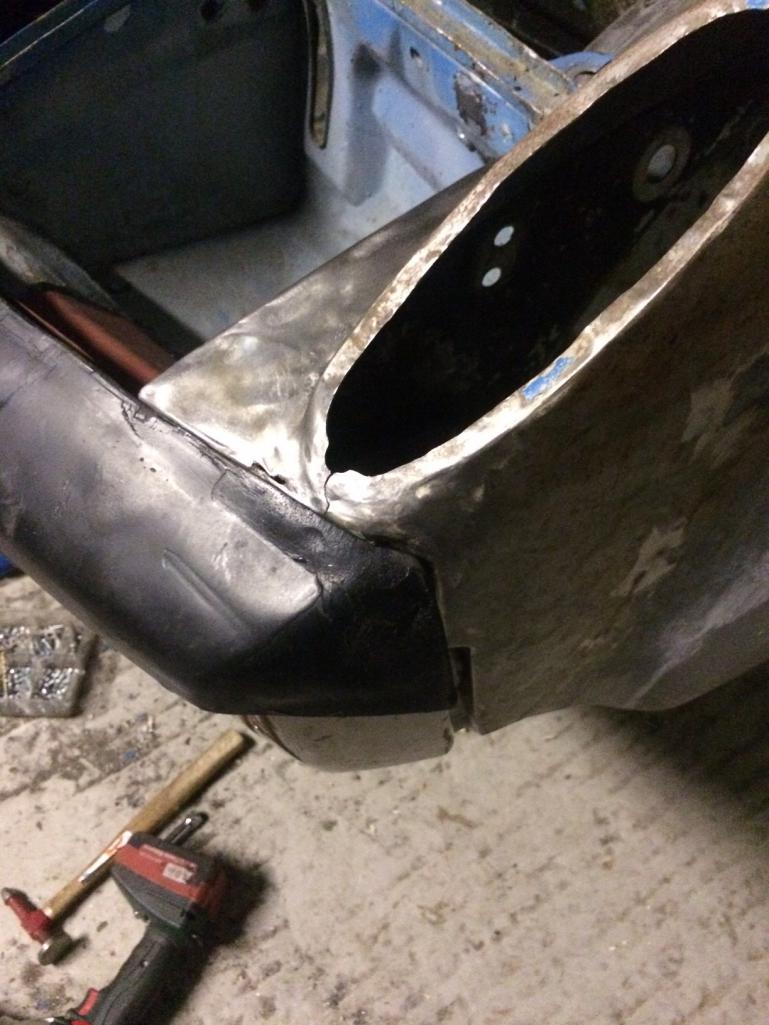

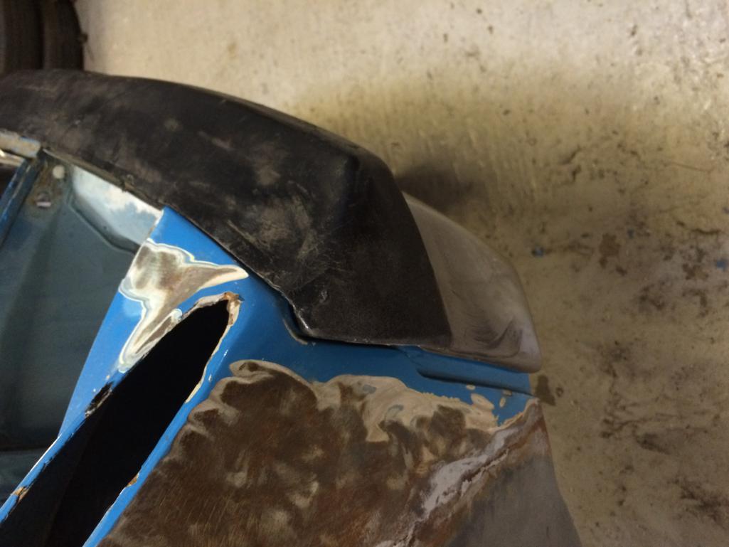

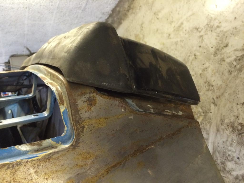

Seriously lacking enthusiasm at the moment ! fitting the bumpers has caused more issues than i'd bargained on !, i wonder if in the shipping process has the rear bumper been flattened a little .....

Found some motivation today before I went hedge cutting !

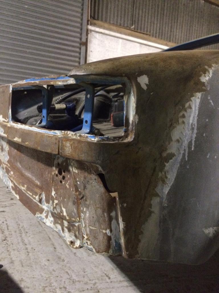

After my trial fit of the front and rear bumpers highlighted the large gaps it became clear that the damage was worse than I thought so out with the grinder and I used the front panel I already had in my store .
All looking much better and a quick trial give this ,
Just a little bit of cleaning up and I'll weld it in, then the rear needs a lot to make it fit !

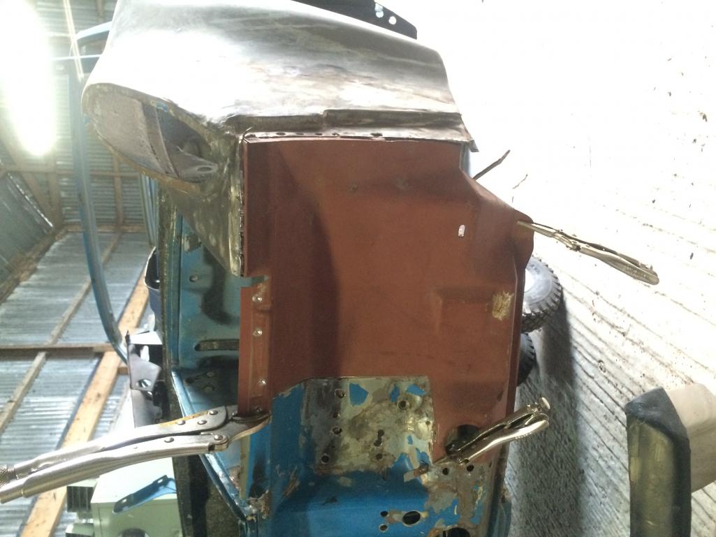

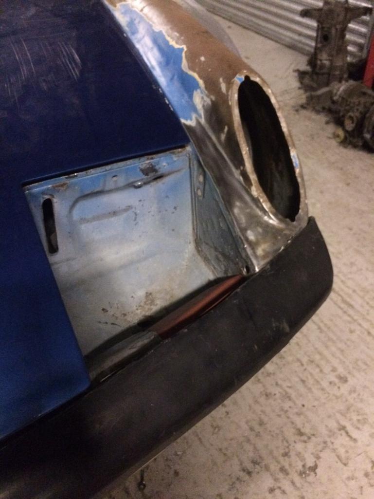

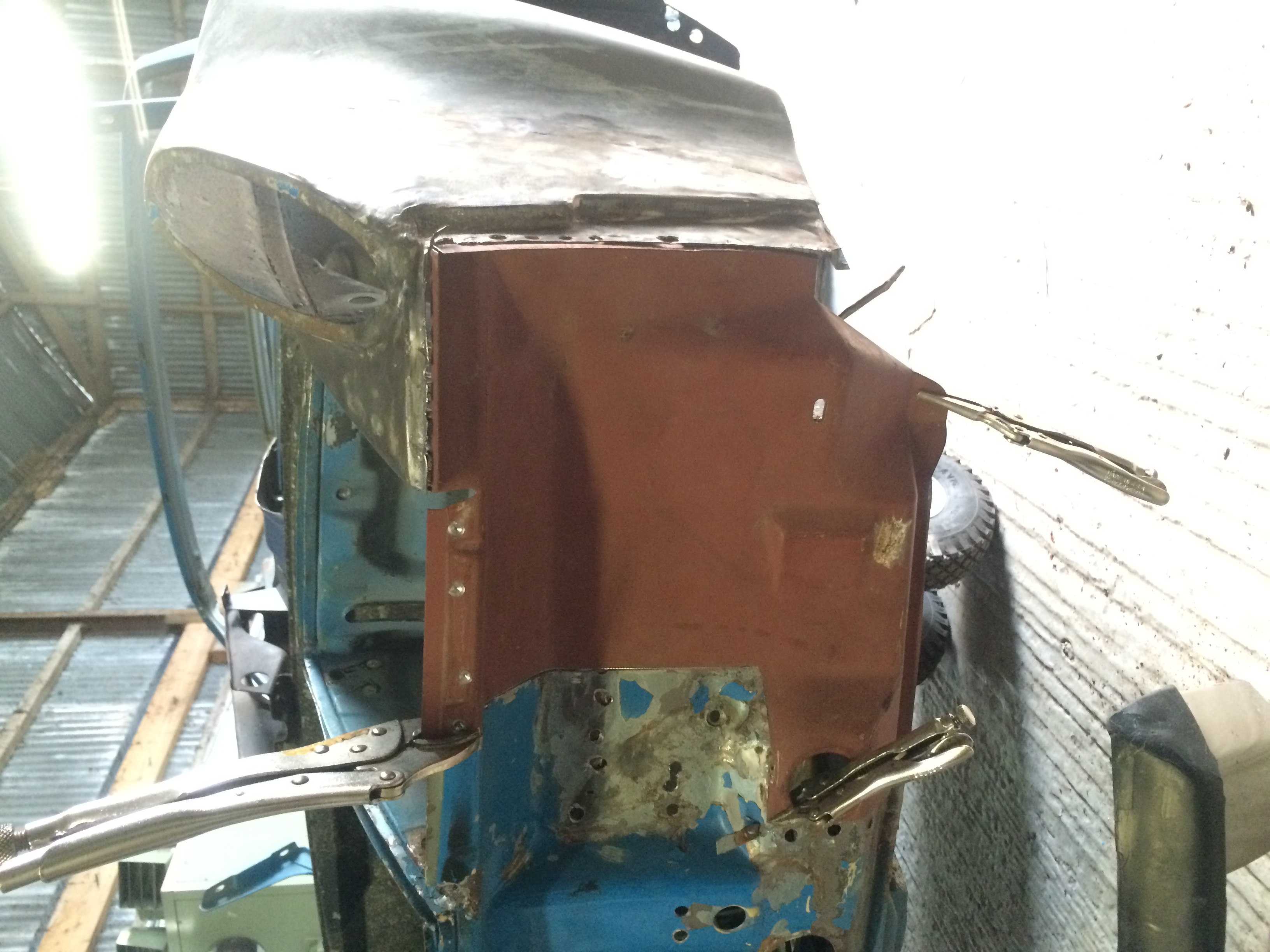

Well the work has progressed ! i spent quite alot of time working on the front of the car as previously told and i was fairly happy with the work so just to make sure everything was good i refitted the hood .............
OMG it wouldn't fit ! the internal rib of the hood was hitting the light box on the previously damaged side ! so after some careful measuring i found the top inner edge of the headlight box was pushed back by 10mm.
i borrowed the porta power from work and pushed it back in to the correct position and then had to start again on the fender ....
But i have to say much happier and also better that the last time !

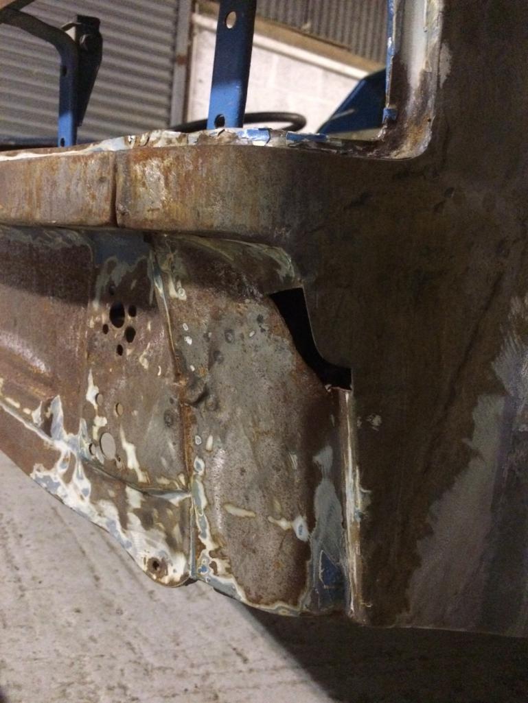

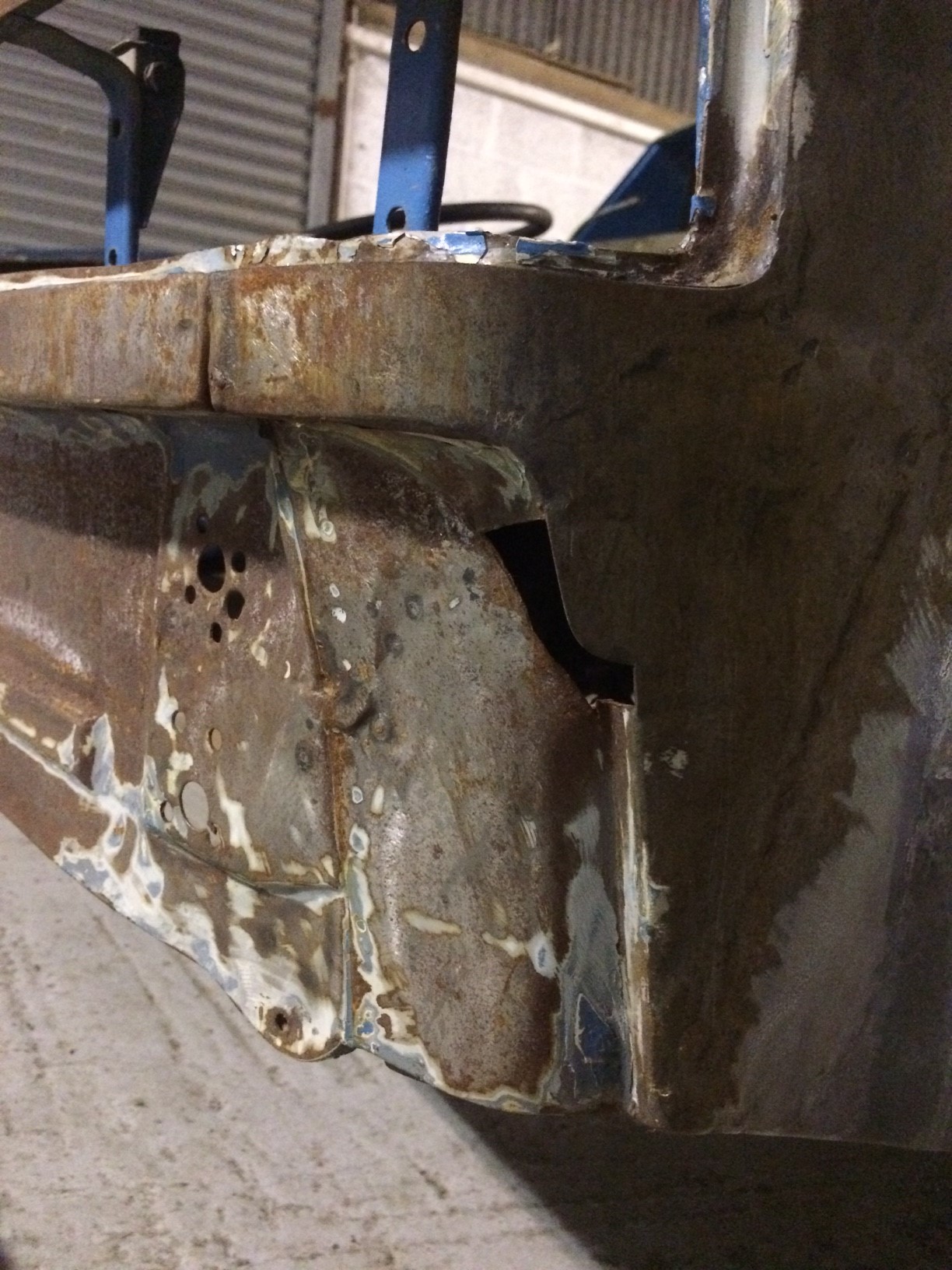

So i'm thinking about the rear corner now...
Does anyone feel like donating a corner say 6" each side and i'll pay the shipping ? i also need the bumper strengthining bracket to !
mine all seems to be about 10mm out, its been hit and partially repaired but its not in the right place by a long shot !
so still a bit to do ....
