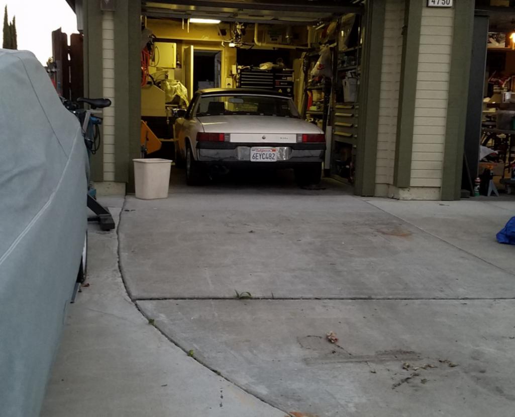

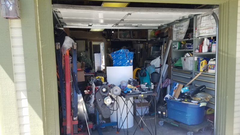

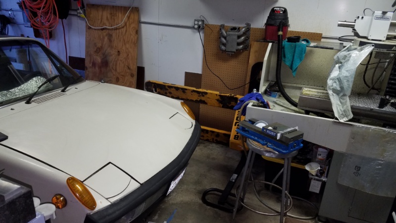

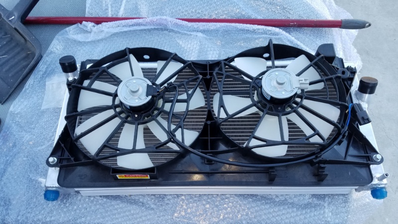

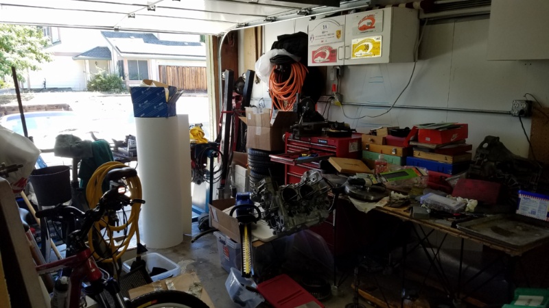

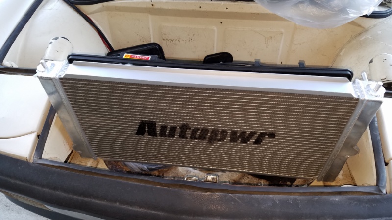

Radiator came in today.

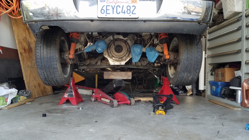

More importantly is that I got the 914 moved into the garage. Took all day to move and organize all that crap.
Removed axles and shifter tonight, hope to drop motor/transmission in the morning.
A few before pics of garage.

Impressive looking radiator and fan set-up. Looks like you will need plenty of exhaust air outlet area from the front trunk. (IMG:style_emoticons/default/idea.gif)

QUOTE(Mueller @ Jul 12 2018, 01:15 AM) *
Reminds me of our garage. 10lbs of (IMG:style_emoticons/default/stromberg.gif) in a 5lb bag. (IMG:style_emoticons/default/biggrin.gif)

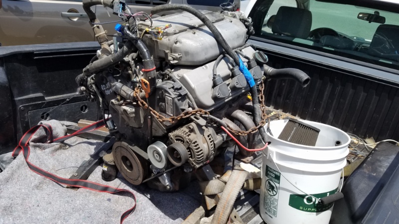

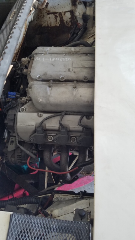

A huge shout out to Cali914 (Harry)
Not only did he deliver the V6 to my home, he stuck around for hours helping me install it (I think he did more work than I did)

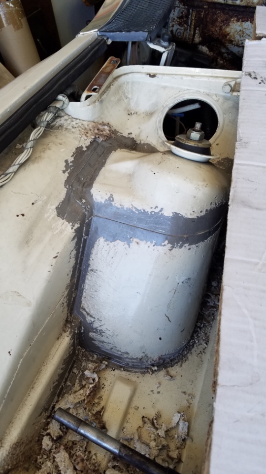

Busted out the heat gun today, didn't have enough time get real dirty so this little project was perfect for the short time slot.
