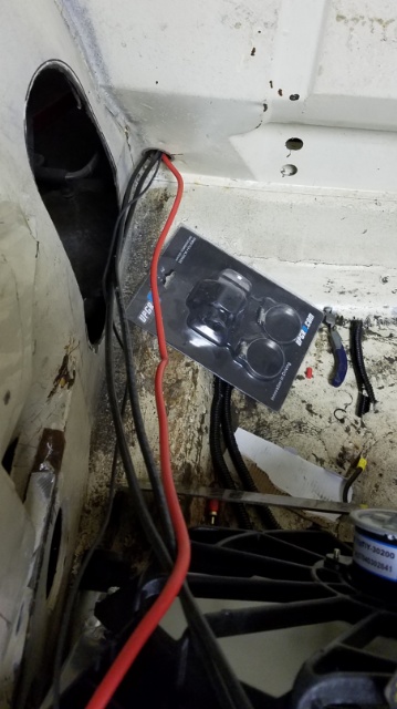

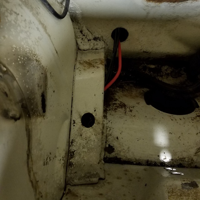

Still adding the new wiring for the up front fuel pump and radiator fans.

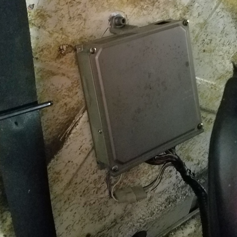

New ECU mounted, I need to get a few higher amp relays, I was going to use a solid state relay, didn't like the spec sheet saying I may lose 1.5volts. Might run some test, we'll see.
The fuel pump and each fan will get a dedicated relay and a dedicated power fed. After I ran these wires I found a large enough and long enough wire that would be fine to replace all 3 in a cabinet. These will do for now.
Yes I know I need grommets to protect the wire covers.

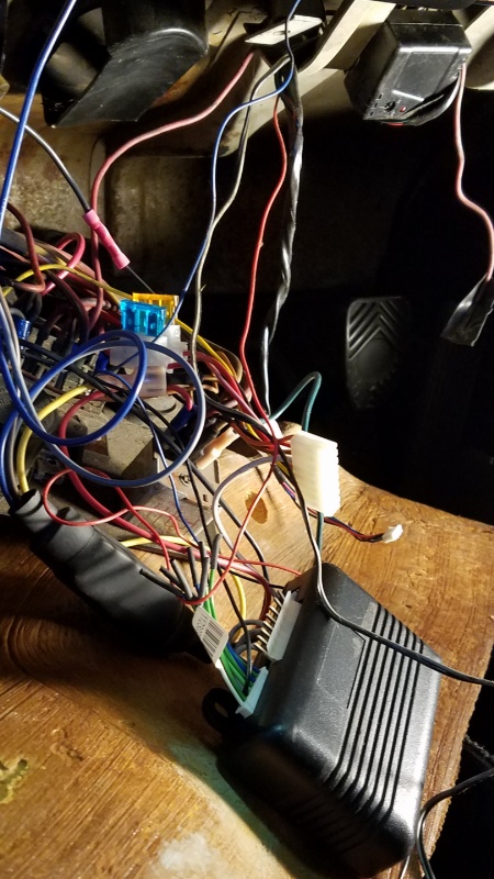

I also removed the old stereo and alarm system. So far the motor cranks over when I turn the key, next will be the ECU wiring into the 914 starter circuit.

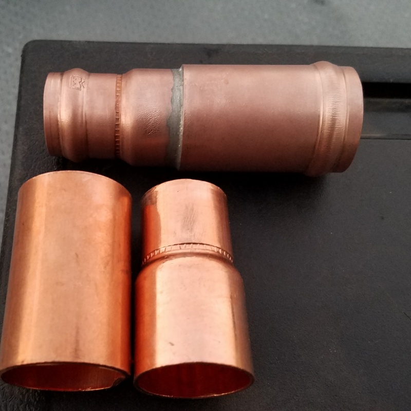

Needed some hose adapters for 1" to 1 5/16".
Hit up Lowes and broke out the solder and propane.
Beads came out okay.

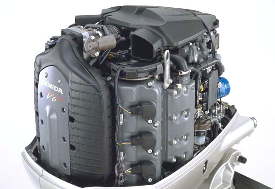

I bought a Marine intake manifold, have not tried it yet but it is shorter and puts the TB up near the motor "V" ($60 shipped on ebay)
This would put the TB up near the cabin firewall.
Make sure to have a build thread, would love to see a "pro" build....I'm a hack and a half (IMG:style_emoticons/default/sawzall-smiley.gif)
