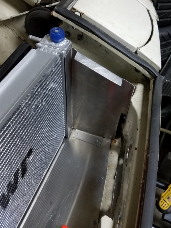

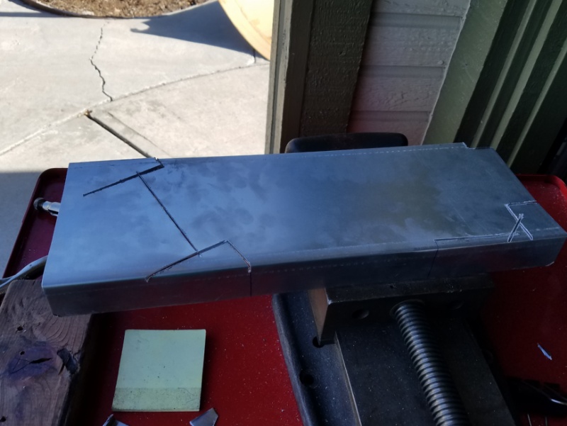

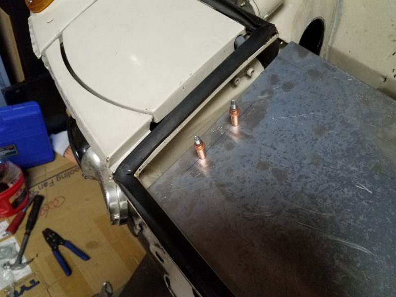

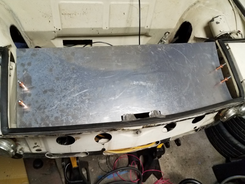

Slowly making progress, a little more radiator install work done yesterday. Hope to get the top shroud made and mounted this week.

Progress...sorta...got a whole 4 rivnuts installed tonight (IMG:style_emoticons/default/sad.gif)

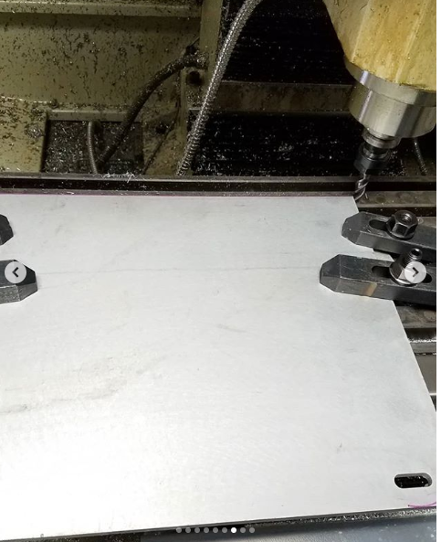

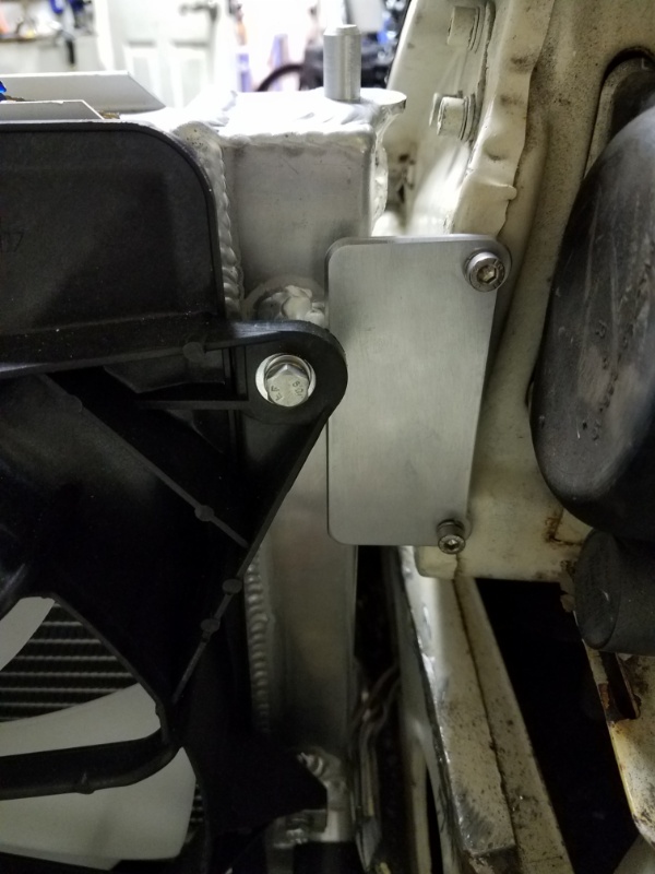

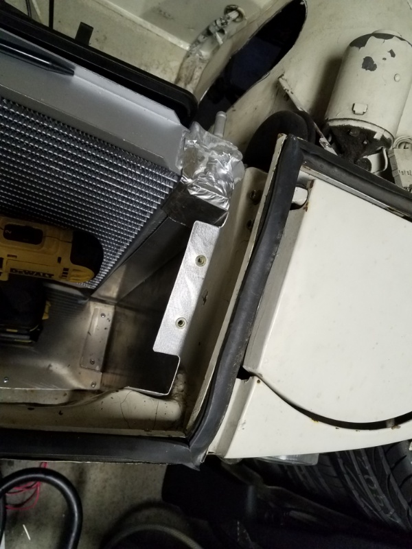

Remember those rivnuts I installed earlier?
These plates will help hold the radiator I'm place, I will install foam between the plate and radiator.
I think 1/8" thick should be good enough.

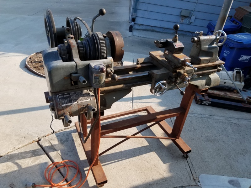

A few more pics of radiator install. Also bought a new to me large, old Atlas lathe made for Sears, Roebuck and Co. Not bad for $200.

Nice brackets, Looks pro.

I love the lathe, I found someone shutting down a business a few months ago. Lots of great equipment... starting at 5000... Ug.

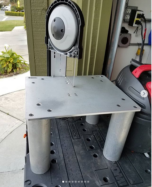

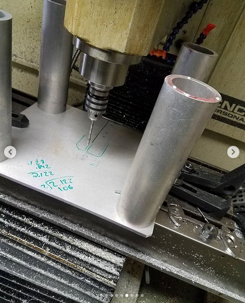

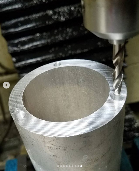

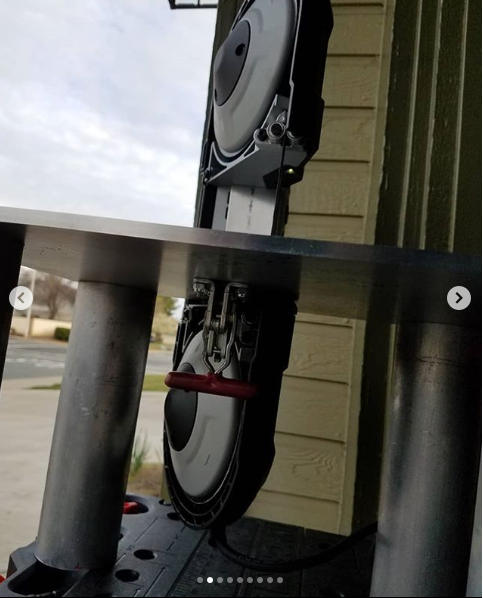

I know I said I was taking a break on the 914 for a while, however I needed to finish this for some cuts I will need in the future.
I could have bought a premade stand from SWAG but I wanted to make it myself. All the aluminum is scrap that I've had for over 15 years!
I originally thought I could bolt the stand to the saw..didn't work out too well. (see 3 unused countersink holes)
Total cost was less than $20, I bought a bunch of the clamps on ebay for a really good price.

Mike - Love your bandsaw stand! I hope you get the same enjoyment out of making stuff as I do. It all adds up to making the car fab go faster/better.
Keep up the great work!
Chris

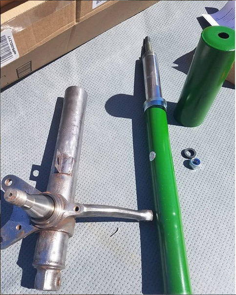

Found my Boge strut Bilstiens there.
The struts I soaked in straight vinegar for a bit to clean off the rust.
Plans are to paint them this Monday.
