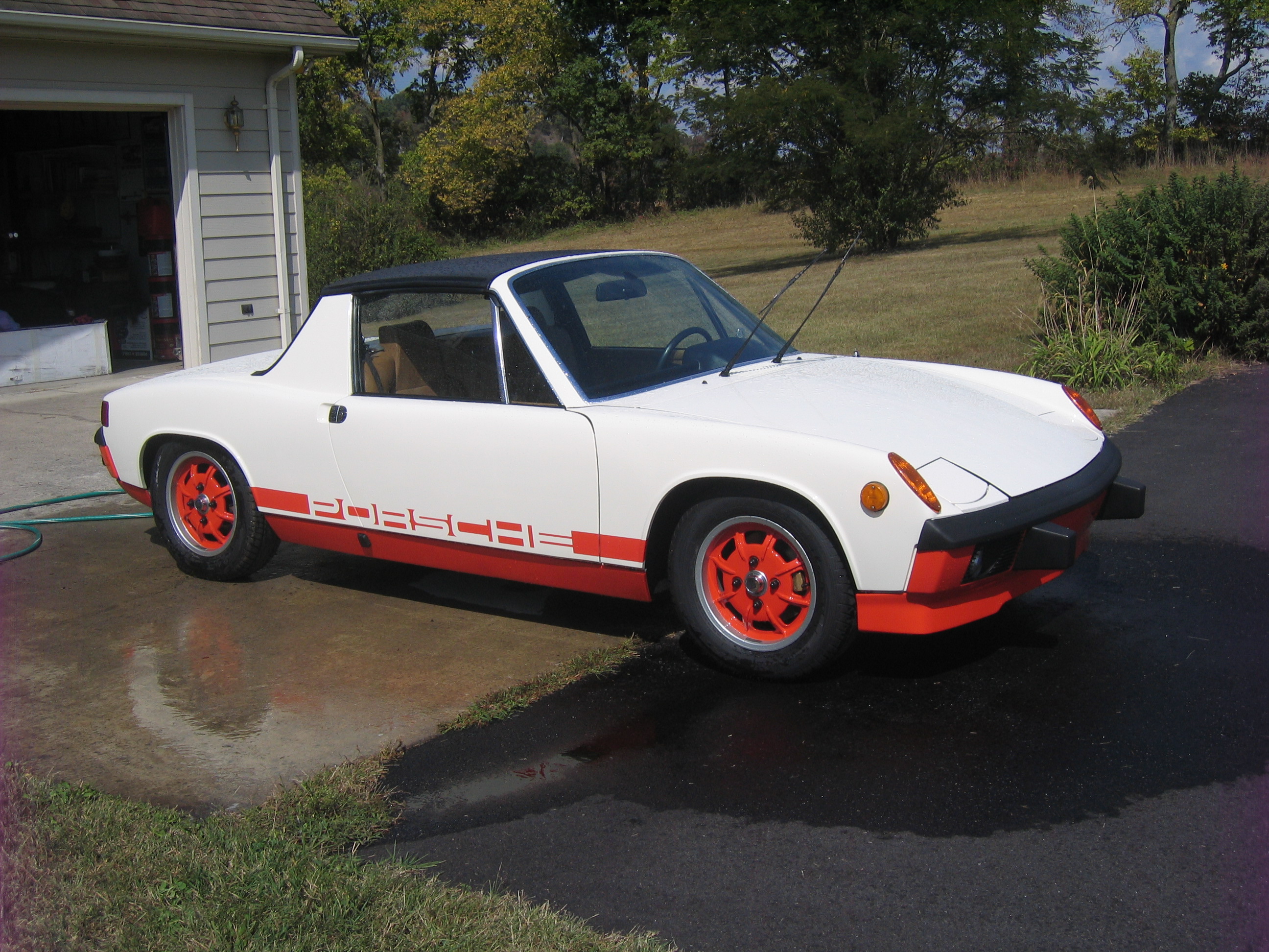

Here is the photo you asked for of my car w/ my Mahle rims fitted with Dunlop SP Sport 195/65HR15s. I have no clearance issues at all & my speedo/odometer is spot on with this tire size.

thanks....those do look great!

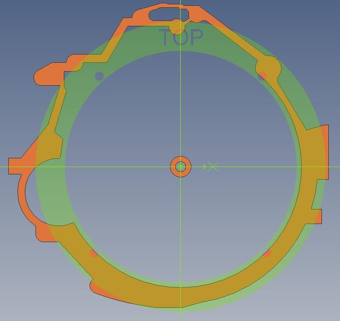

Playing on the computer tonight, overlay aircooled (green) on the Audi gearbox bell housing.
Need a 914 transmission so I can see where the starter mounts and see where to move it or clock it relative to the input shaft.

Did you get that cad drawing from somewhere or did you make it somehow?
Your engineering skills continue to amaze me... Glad your back (IMG:style_emoticons/default/smile.gif)

I found a drawing online that has the bolt hole locations and I imported it in and manually traced the outline. I will add the holes later on.
That was drawn using Geomagic, it used to be called Alibre...a poor man's version of Solidworks.
