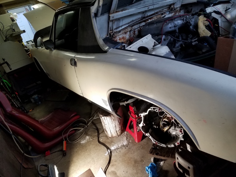

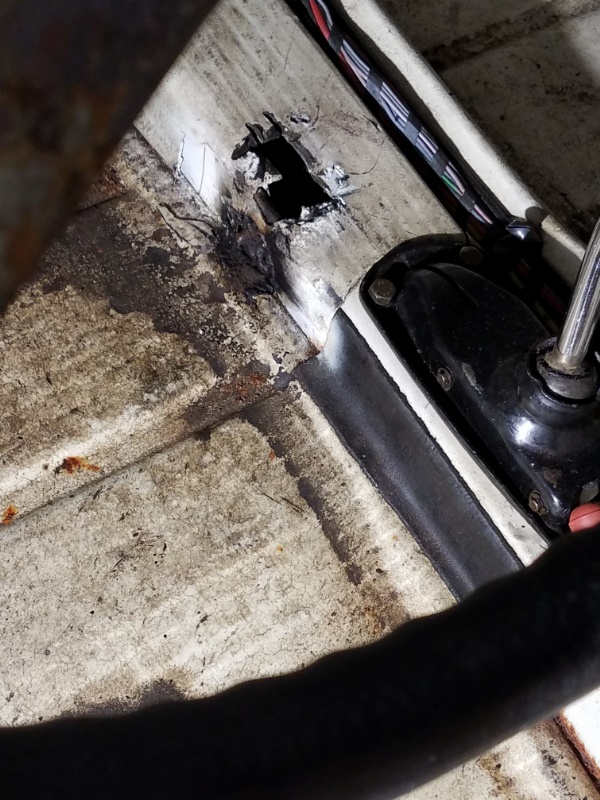

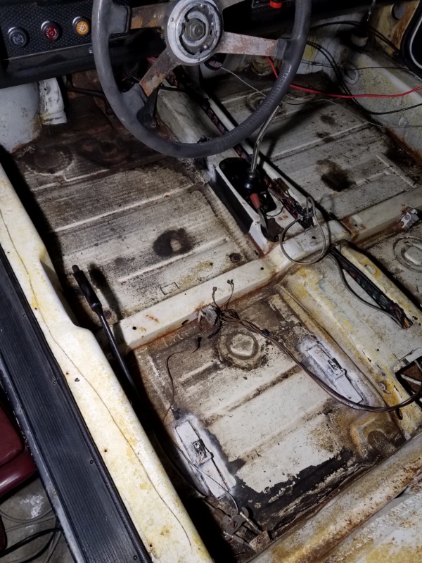

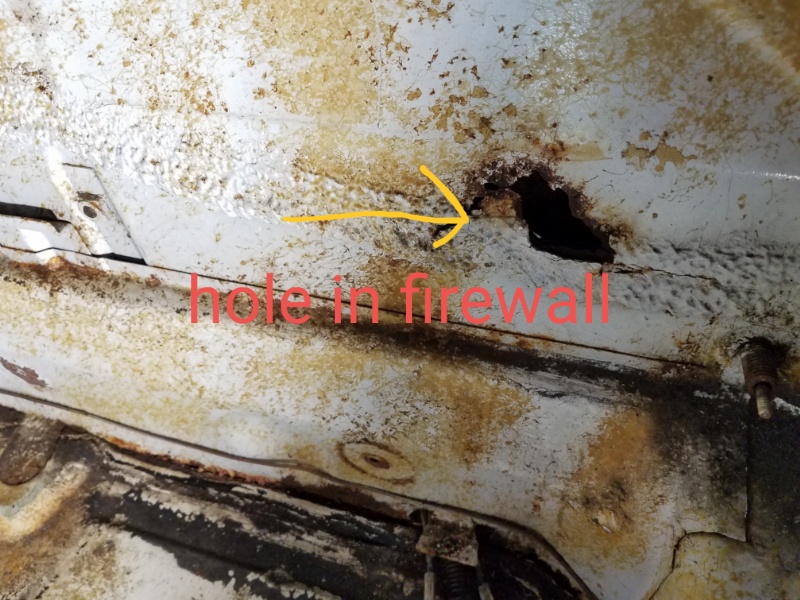

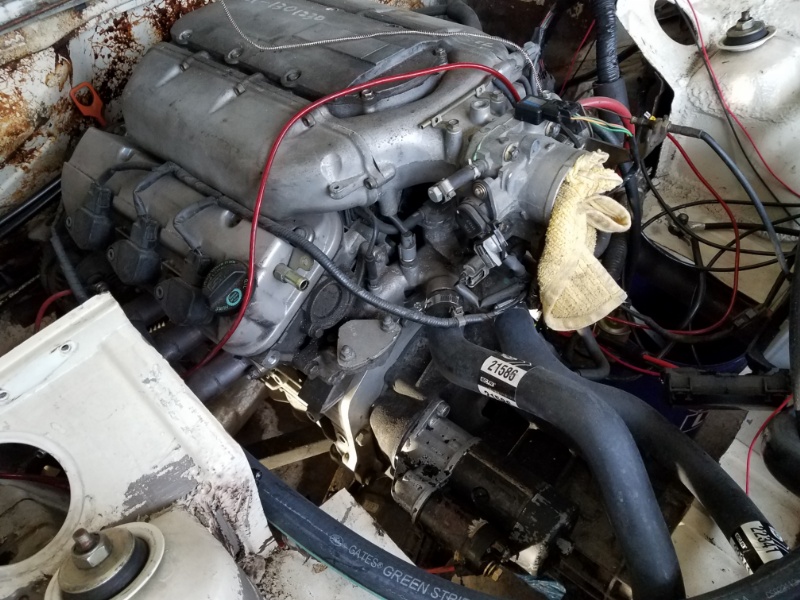

Put a few hours in on the 914...
Took seats out to look at the floor, will know more when the tar comes off.
A few ugly holes....
The seats will be for sale....sans the rails.
The engine compartment looks like hell from the engine install...that'll be fixed in the future.

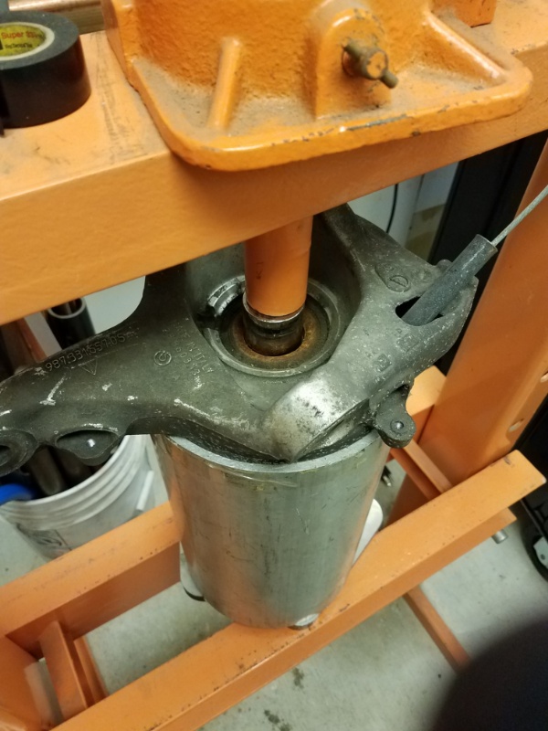

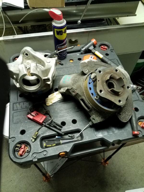

Working in the garage myself today. (Until called me in to take a break)
Taking the hubs out of the Boxster rear carriers.
The tube fits with the pads removed.

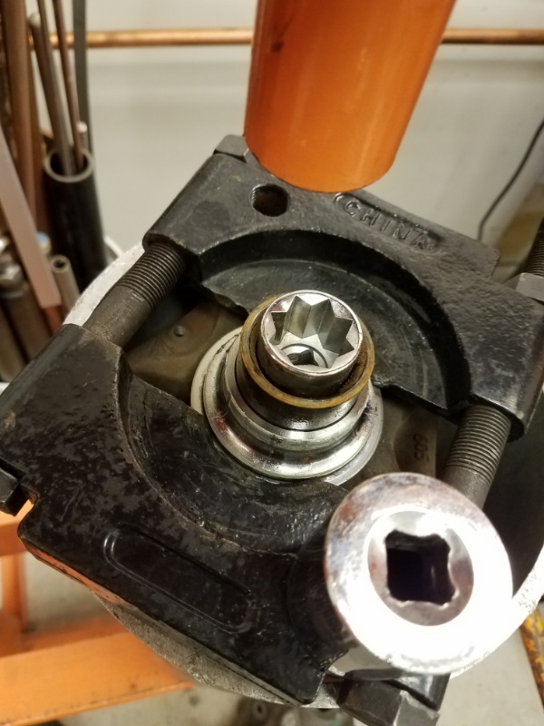

Right before I was called inside I finally started to get a stuck race off the hub. Bearing puller is junk and inside contact area keeps breaking.
I have had this aluminum tube for over 15 years, just recently was put into commission as a brush holder.
I put a socket inside of hub to hold the driven socket
From moving side to side. No press pressure on small socket or inside hub.

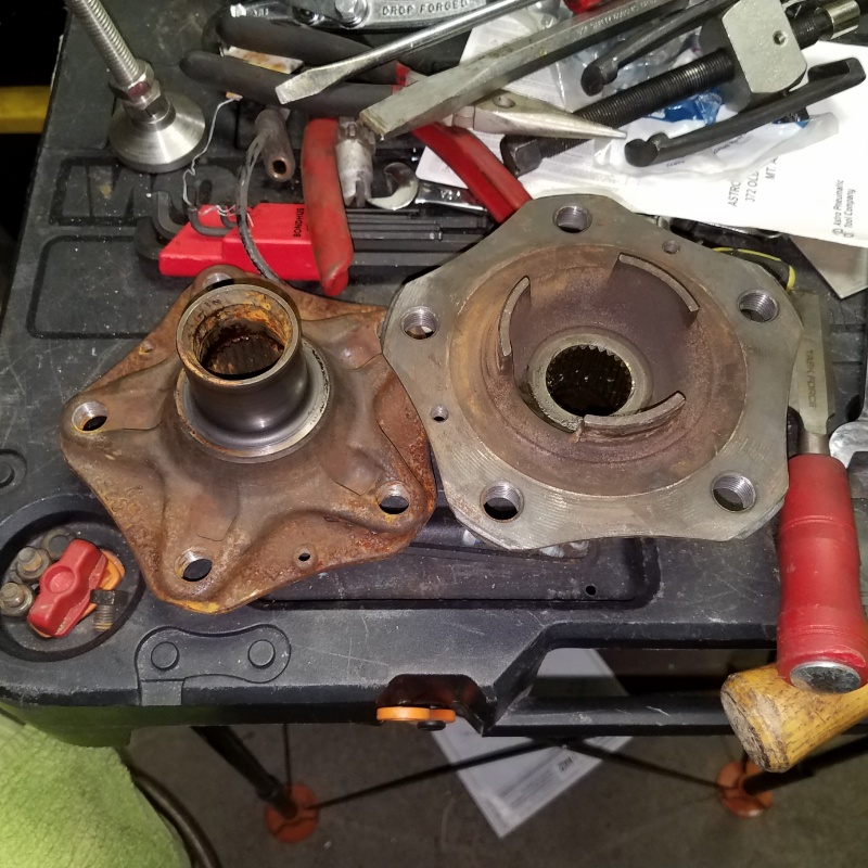

We got a pair!

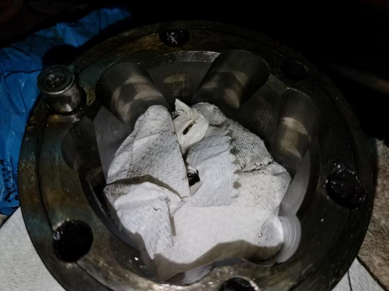

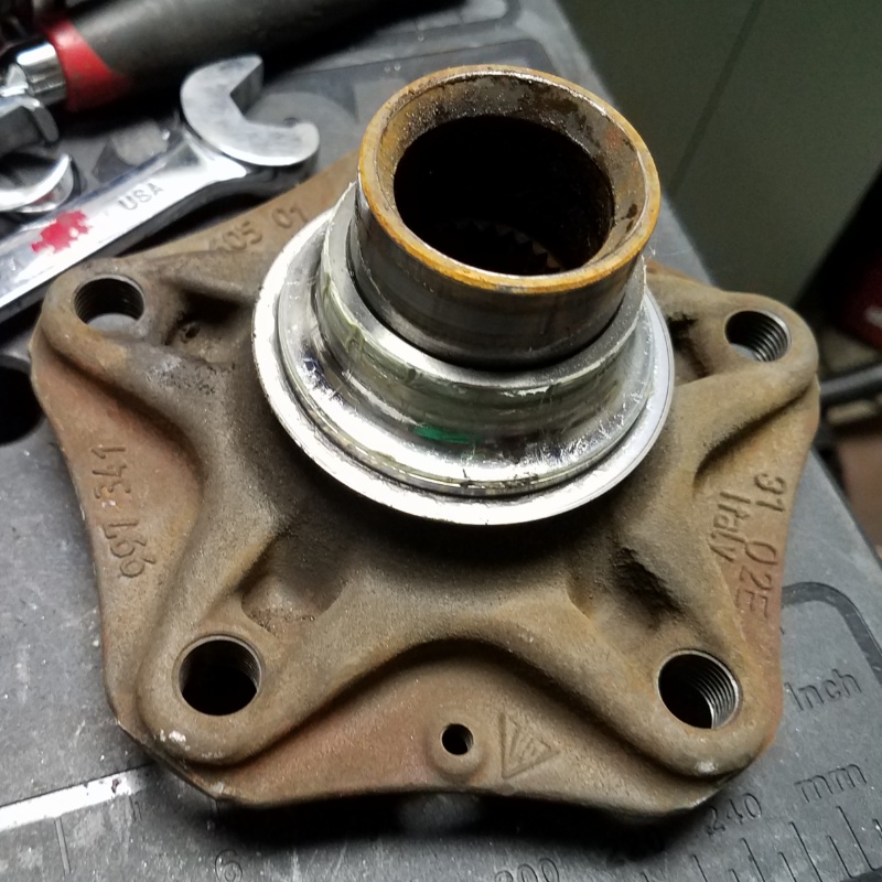

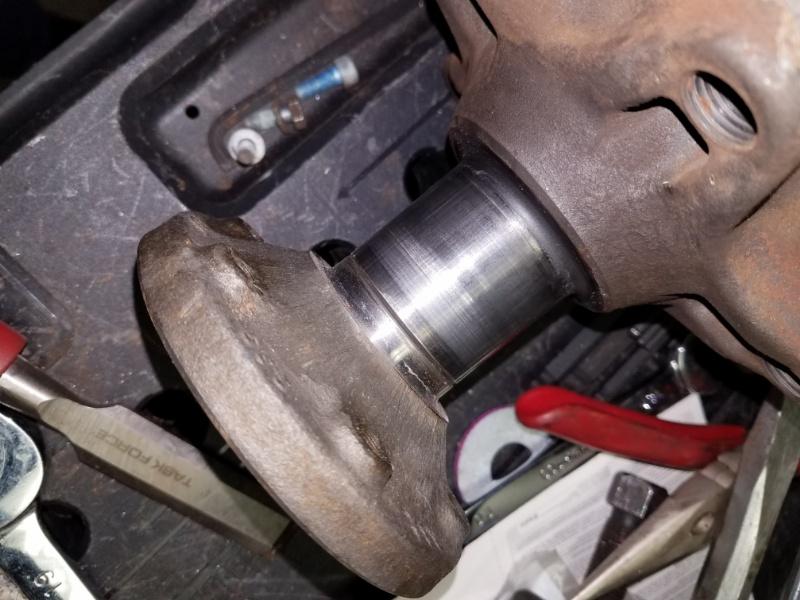

Not sure what to do now.
The 986 hubs going to take a bit of work to get going. I need to find the width of the bearings, it looks like too much room between the hub and the 951 stub.
The plan was to make adapters to use the smaller 914 cv joints for a short time however they look beat to heck. I guess I can just drive slow to the car show in 3 weeks.

QUOTE(Mueller @ Sep 5 2019, 10:23 PM) *
I thought the Boxster used the same wheel bearings as the 914?
Mueller
post Sep 6 2019, 12:00 AM
Post #214
914 Freak!
Posts: 17,157
Joined: 4-January 03
From: Antioch, CA
Member No.: 87
QUOTE(SirAndy @ Sep 5 2019, 10:40 PM) *
It does. The bearing is 1.46" wide
The space between my combo is almost .25" wider.

Would machining the hub shorter and adding a spacer to the nut side of the stub axle be an option?
Just take off enough to create the clamping necessary for the bearing.
Jim
Jim
Thought about that, it would make it more difficult to remove the stub axle since part of it is in the bearing.
If my research is correct, the 951 bearing is 5mm wider. (and bigger OD)
Jim
That is an option I thought about.

Most of the time you just machine a spacer between the hub and the bearing, - problem solved PMS sells them also. Make sure you put it on the proper side, as it will change the flange placement in relationship to the old flange, moving the rotor accordingly and then affecting its relationship with the brake caliper also.
Lots of things going on that are placed via the hub, so make sure you measure calculate, and measure again to make sure you get this correct.

QUOTE(914forme @ Sep 6 2019, 09:20 AM) *
Thanks, I found a thread by Clay detailing what he did and now that I think of it I might have made SirAndy a pair of spacers 10 years ago or so.
