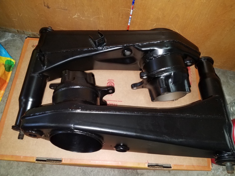

Early morning surprise.
Mark Howard drove down in his beautiful 911 SC to drop off a pair of cleaned up and powder coated trailing arms. That is a 100 mile round trip for him.
I showed him the 914 and my shop and 20 minutes later he was headed back home. Thanks Mark. Now to get my tail out in the garage and make some progress.

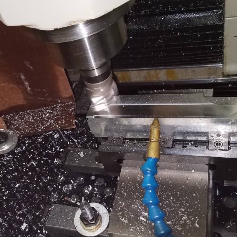

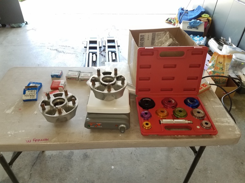

Hey 914 bub, yes I do remember you, recommended your shop for a motor rewind, they went with new instead.
John* is in the process of doing the bearings once he gets back from the store.
Anyone guess what I am making on the mill besides a mess?
*cannot think of his screen name right now.

Brake adapters?

Brake adapters?
Me, i am wondering why you have car parts on a magnetic stir pkate.

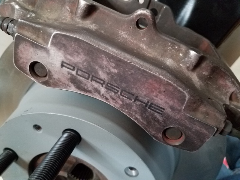

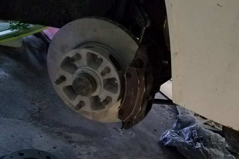

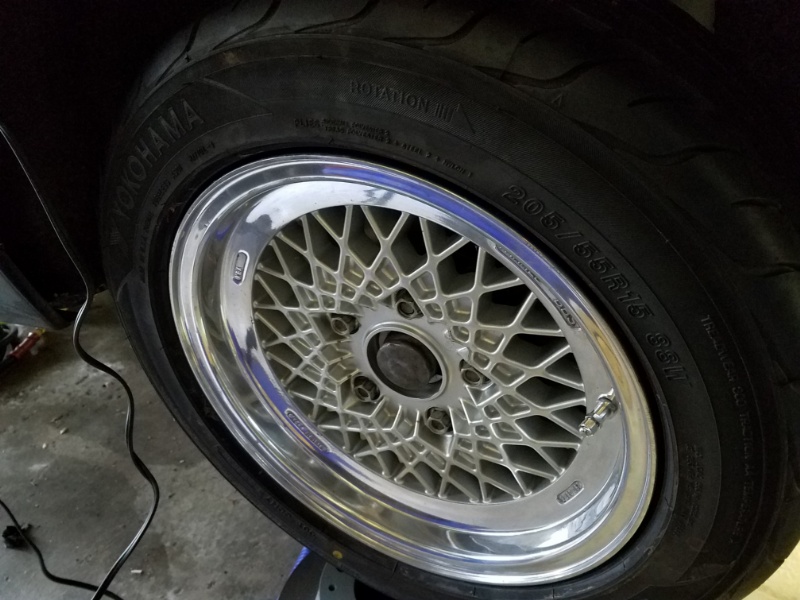

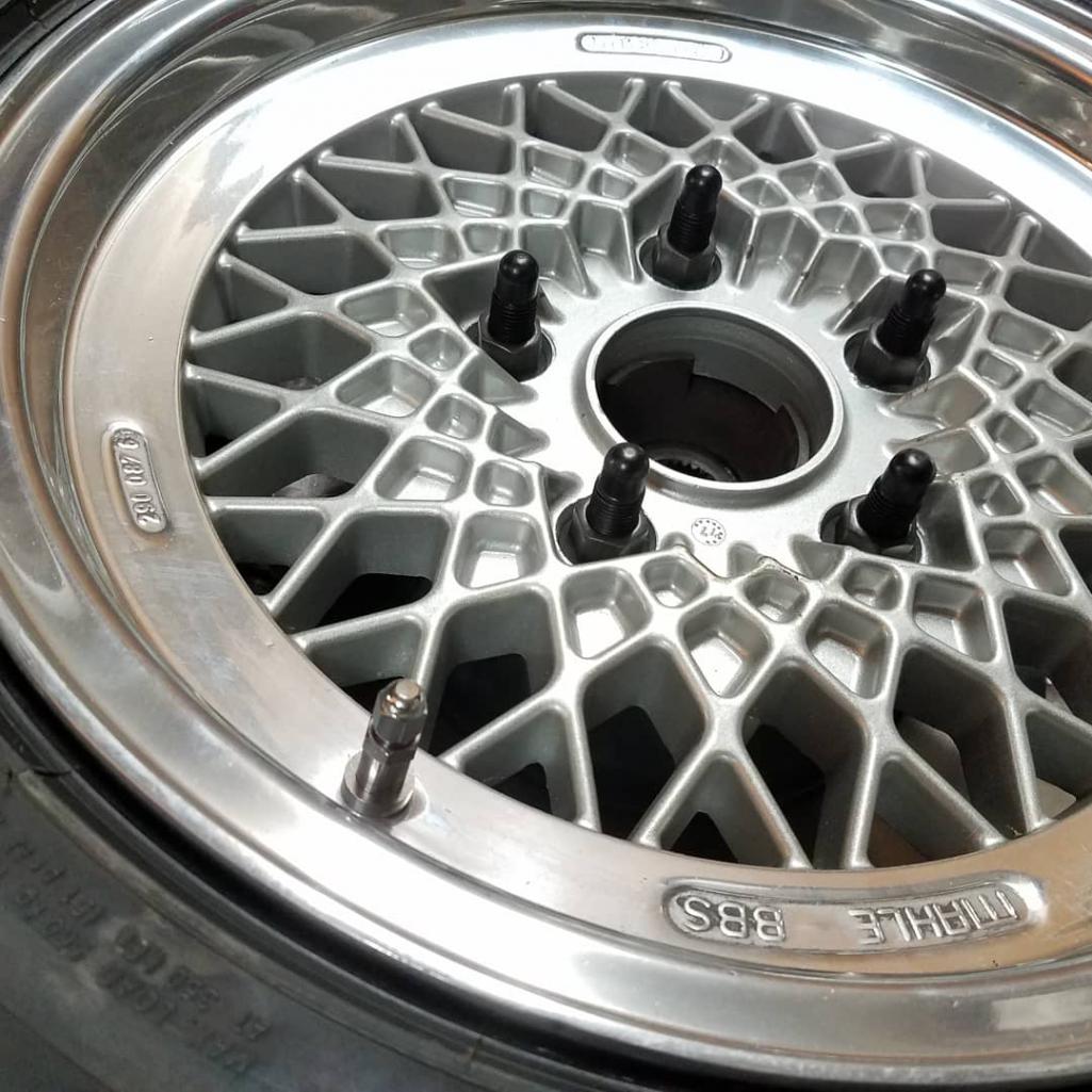

Worked on the 914 today...
Was making progress until I put the front wheels on.
Studs too short.
Oh well. Will order some longer ones.
Boxster front calipers fit under the 15x7 Bbs-mahles luckily, today was the 1st time testing it out.

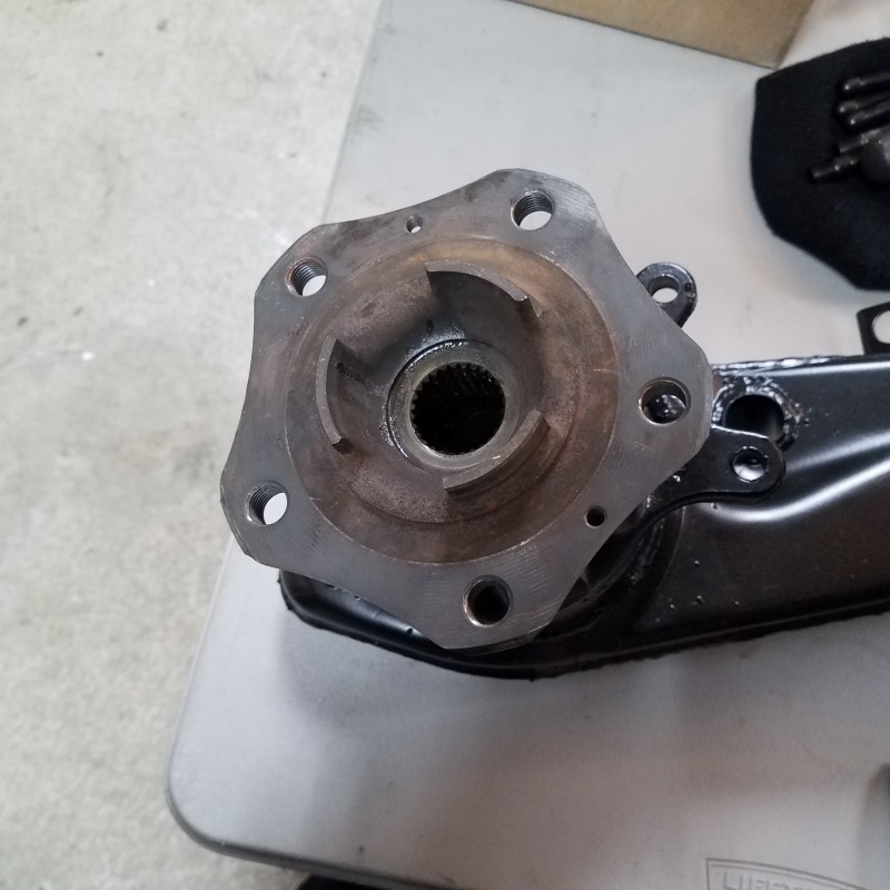

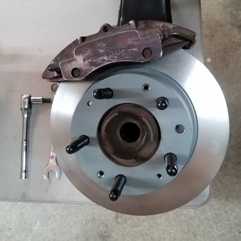

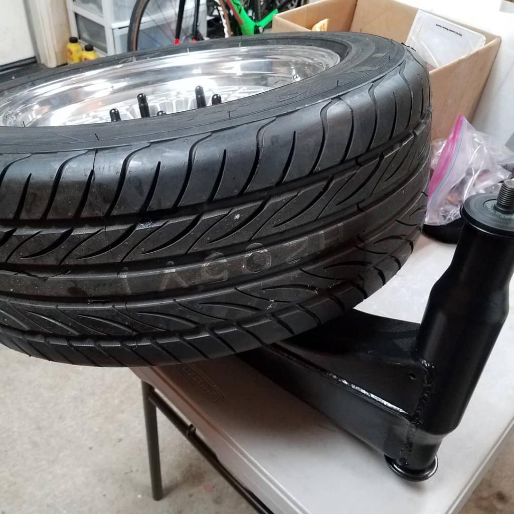

Happy New Year...1st day of 2020 and I am working on the 914. Not a bad start.
Test fitting Boxster rear hubs and calipers.
I took an old rear bearing and ground the ID and OD to make it slip fit for testing.
