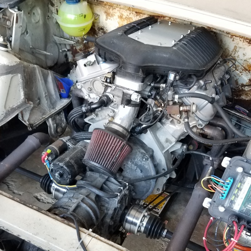

We have a runner, Part 2.
Since the last time I posted the motor running I have done a few things that made me question whether or not it would ever run again.
Replaced vehicle wiring with Infinitybox CAN bus system.
Took apart the factory Honda engine wiring harness, removed a few feet from it due to it being too long. Also recovered all the wires.
Installed new intake manifold which required me to come up with a new way to control the throttle body. In the end I used a /6 throttle cable and made an adapter to screw on a short section of cable to attach to the Honda TB.
Next will be using the Amazon sourced cooling system vacuum purge and coolant refill kit to get all the air out of the system. So far no leaks.
Now to get insurance for it so I can register it to test it out on the street.

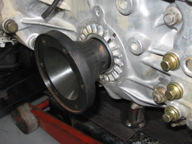

That was the last year for that model # transmission. Converted to a 6 speed? Wow, that's a new one. I'll look into that. The final drive will be 3.9 regardless. Although I'm not sure the quantity of oil I stated is accurate given it's been converted to a 6 speed. I came to this conclusion by immersing the center diff and related bearings and washers in a can of transmission oil and measuring the displacement. You can do the same thing after removing the diff. Just make sure that you measure the amount of oil that the rear cone takes vs. the flat plate you will use in it's place. The glove is blocking the view of the output. Post another pic of that area.

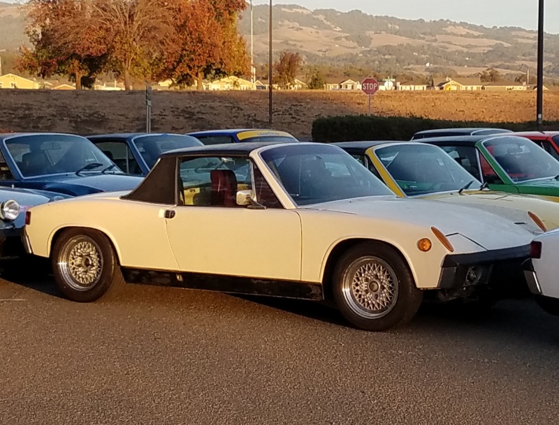

I drove it around the block for the 1st time right before I hooked it up to my truck for the ride up to Petaluma for the 2020 WCR last week.
For the WCR I only drove it Saturday night for the picture and dinner. I didn't trust the car for the 2 drives thru the unknown roads.
Now to fix a bunch of little things and put a heater in it.
