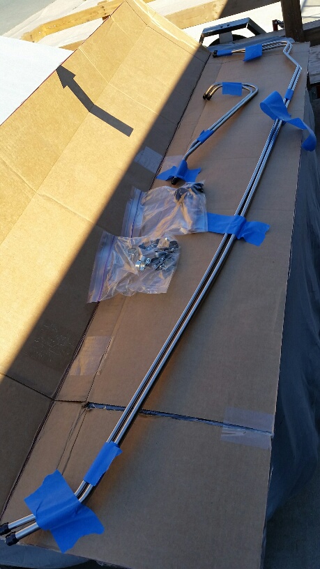

The car is still across the street, however I have started to buy some items for the soon to happen motor installation.
$164 shipped from Rotary '14 , so far they look like nice parts.

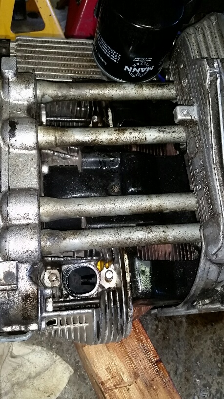

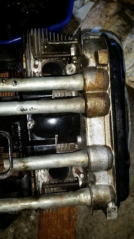

Started to work on the 1.7 engine....
4 out 8 exhaust studs are broken, I started to spray them with a penetrate, next will be welding nuts to them and hopefully they screw right out!
I popped off the valve covers and it is very, very clean in there, no sludge. I drained the oil and it was nice and clean (for engine oil, hahaha)
Time to clean off all the tin from it sitting for a few years, and install L-Jet instead of the current D-Jet (so all the D-Jet stuff will be for sale)
Debating whether or not to pull the heads, I figure at this point it might not be a bad idea so I can do a quick inspection. I was a little surprised that it does not have the 911 swivel adjusters, no idea yet if these rockers can be modified for using them or not.

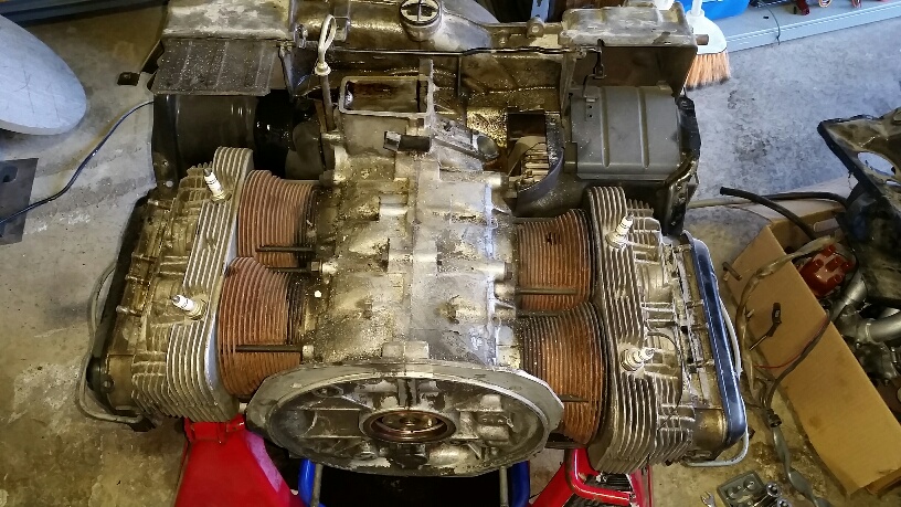

Took heads and cylinders off tonight, didn't like how one side had more oil leakage than the other.
Measured the cylinders and they are 93mm which makes this motor a 1911, which is cool since I thought it was a 1700. Pistons and cylinders in great shape, not many miles on this motor at all!
I'll have to run the part numbers but I think they are stock cylinders bored out.
No 911 swivel foot adjusters which sucks. No idea what camshaft used, not sure if I want to pop off the oil pump to look for some markings on it or not.

QUOTE(Mueller @ Jun 29 2016, 12:02 AM) *
93 and a 66mm crank make it a 1.8. you need 96's to get to 1911.
