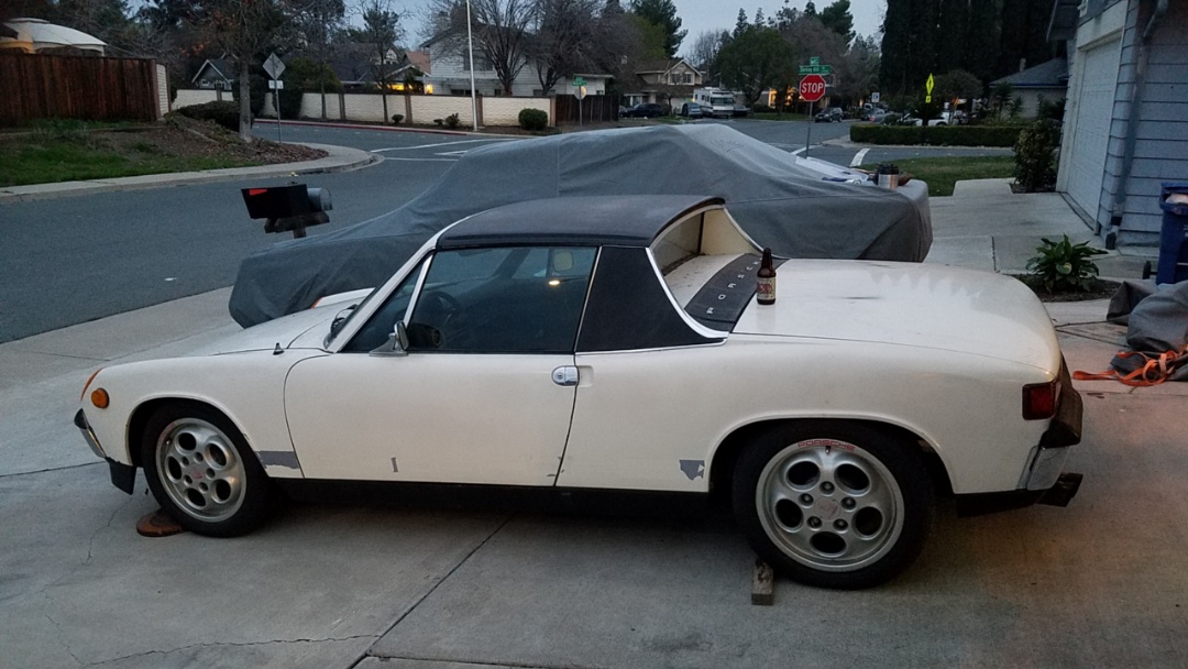

I finally have a 914 at my own house after almost a 10 year absence.
For the last year and half my latest one was stored across the street, finally pushed it home and I didn't even get a chance to "drive" it.....my lovely wife Sherryl had the honors of steering it.
I had a green Porsche script on it that I added to it a year ago, nobody in the family really cared for it the more we looked at it. I must have had the worlds cheapest paint job, much of the paint under the decal came off...oh well it needs new paint badly.
