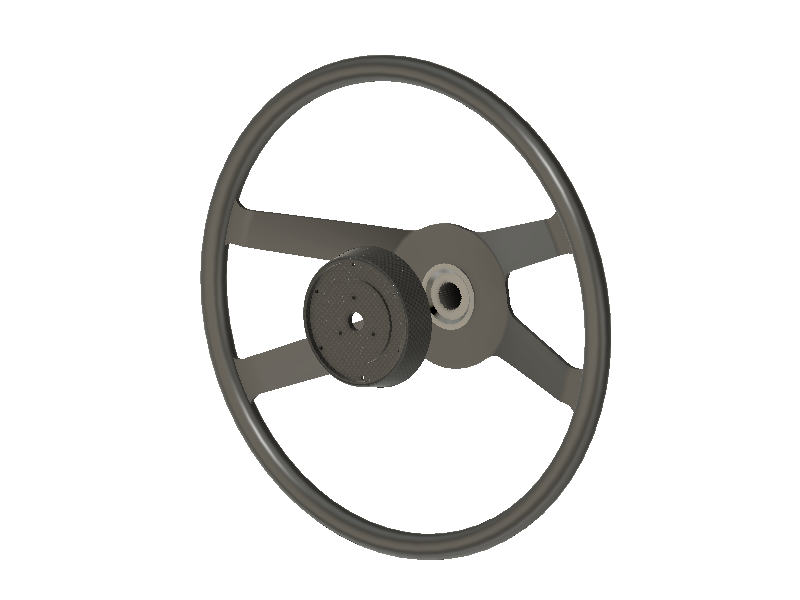

Started to gather parts to rebuild/restore my ugly steering wheel. Ring for hockey puck horn button replica that I will be making from billet alum instead of the usual plastic. Pricey little sucker, found on eBay for $42 shipped, not sure if I like it now.

Drew up my version of a hockey puck horn pad. Waiting for the leather to show up. Not going with standard Porsche crest.

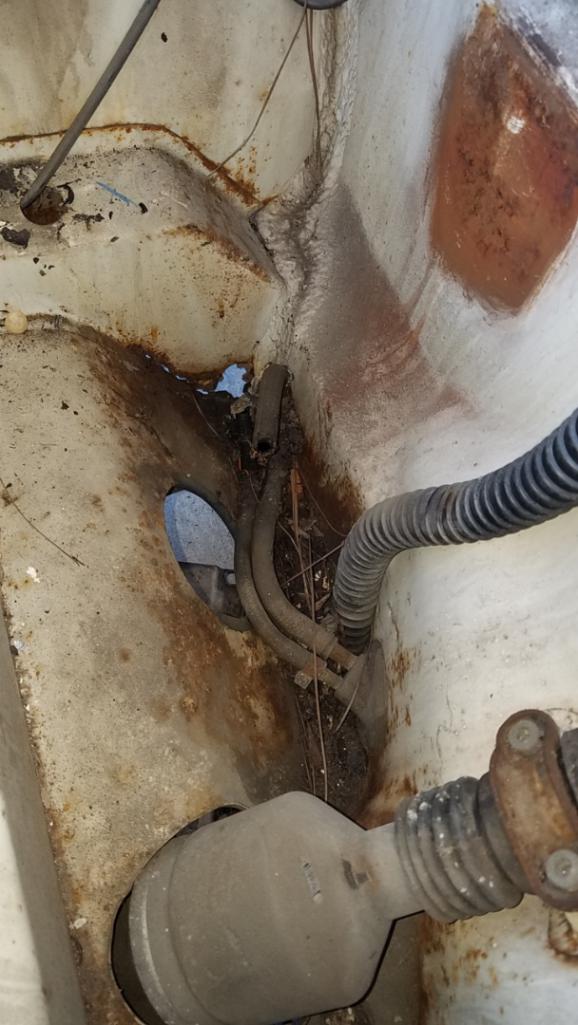

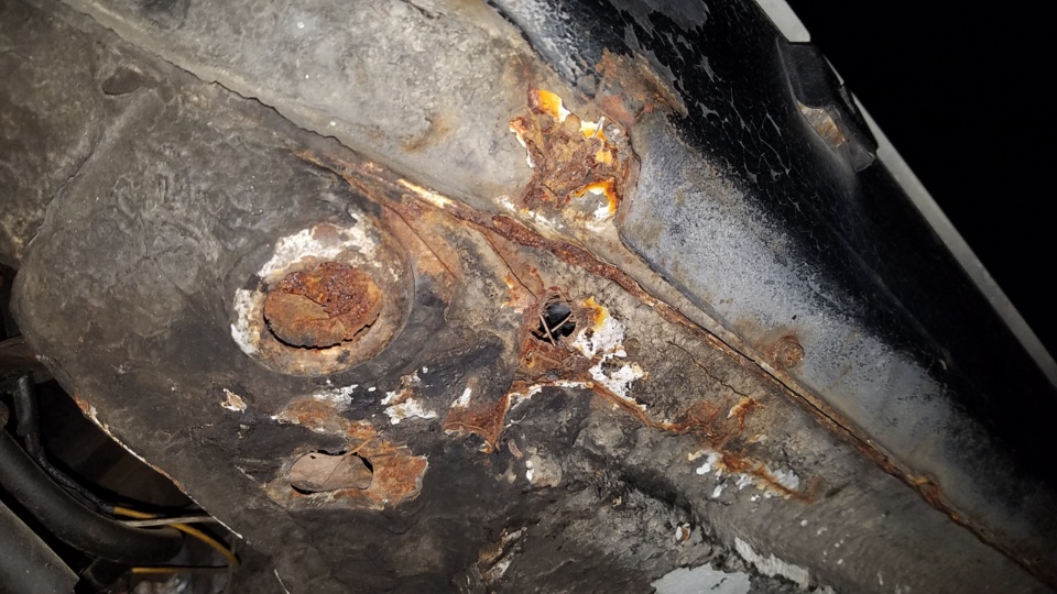

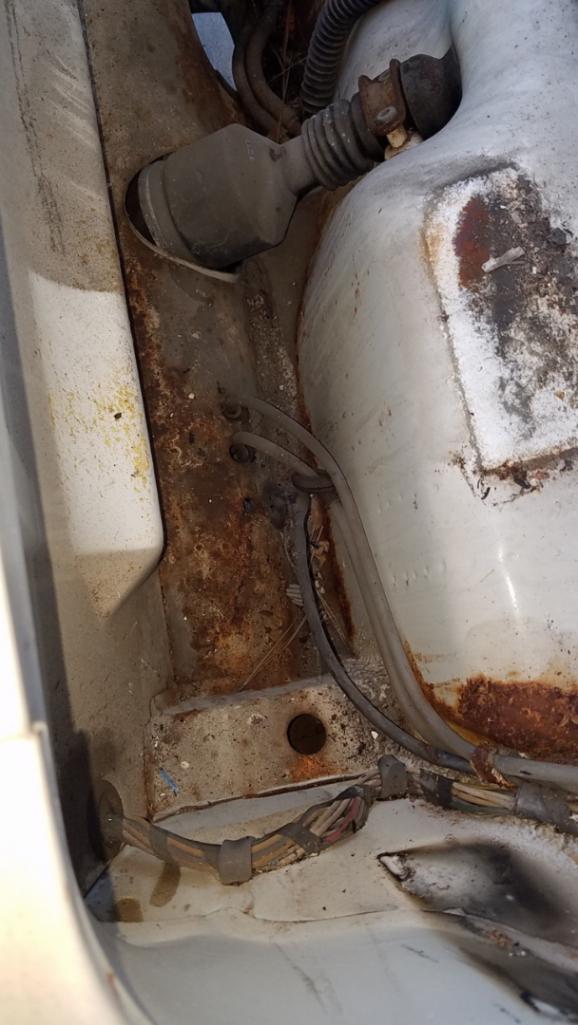

Removed gas tank today, the rubber hoses just snapped in half so who knows how old the suckers are.
Car is much rustier than I thought it would was originally. Front trunk has a 'glass panel riveted in to cover a bunch of rust and missing sheet metal. Hell hole is gone and rust made it all the way down to the jack pad and long.

QUOTE(Mueller @ Feb 25 2018, 09:18 PM) *
Wow, thats a lot rustier than I would have imagined! (IMG:style_emoticons/default/sad.gif)
Fixable... but thats a PITA..
I mean that front gas tank area never gets rust..
Throw some patches over it and make it a driver??

More than likely rusty from a couple of items.
Salt water - I hope not, or animal urine. More likely the latter.

QUOTE(914forme @ Feb 26 2018, 06:19 PM) *
I found out the car sat in a field for a few years before the PO bought it, then it sat in his front yard for a few years as well. We think the car could have been on the coast for a bit as well. I've owned for 2 years, no battery and fully covered.
Sh!t happens, I'll slowly fix it. I was telling the wife that with the amount of rust it has I won't feel guilty making small modifications to the car. She said fine do what I want as long as I don't add flares! hahaha

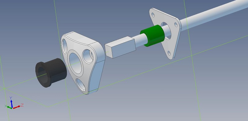

My car does not have a front swaybar, never had one.
So I bought a stock 15mm bar, didn't realize it had no hardware until I committed to buy it, still think it was a good deal. This thing looks brand new so I am not complaining.
Spent a little time drawing up some parts for it while I wait for the garage to warm up this morning.
The idea is to make a 15mm ID by 24mm OD split spacer, (green parts, hard to tell there are 2 pieces there) this will allow me to use an Igus MFM2430-30 bushing (dark colored part) to replace the factory rubber bushings. These are <$5 each (accounting for shipping, I bought 6 of them)
