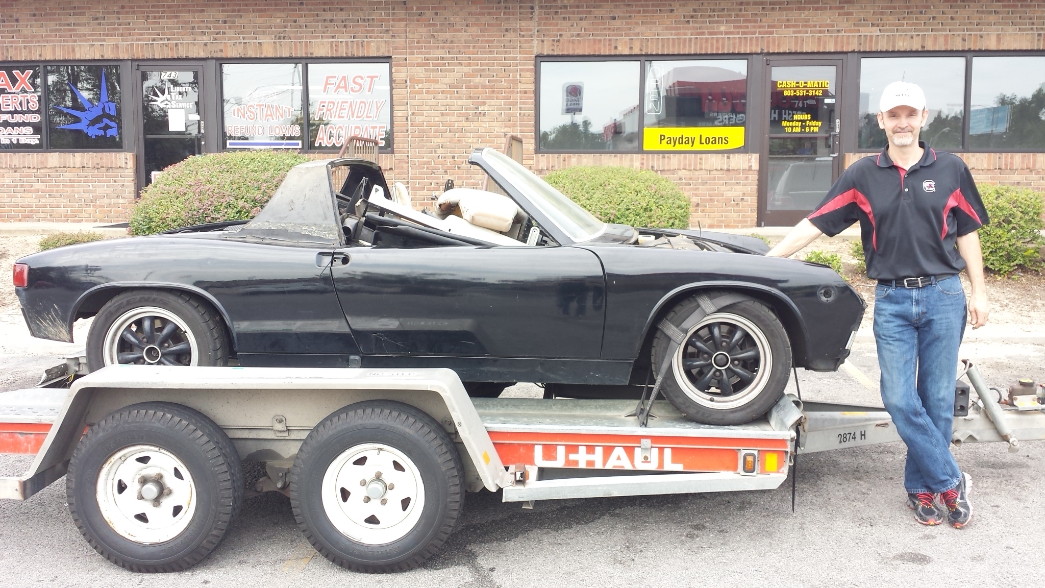

Introduction to the car my 11 year old named black beauty . Hopefully it can be returned to her former glory.
Back story:
Not much is kknown about this car.
I bought the car from Billh1963 on Sept. 29, 2015. He bought the car earlier in the year , found on Craigs list in Columbia, SC. We all know Bill can't pass up a deal!. Car sat for 10 years after the p.o. had pulled it off the road to fix and restore it. He got as far as stripping it down, pulled out much of the wiring harness. Replaced the right front quarter panel and then it was abandoned. Luckily it was preserved by being stored in a clean dry place.

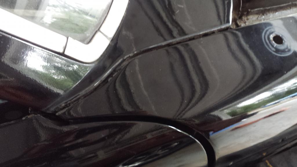

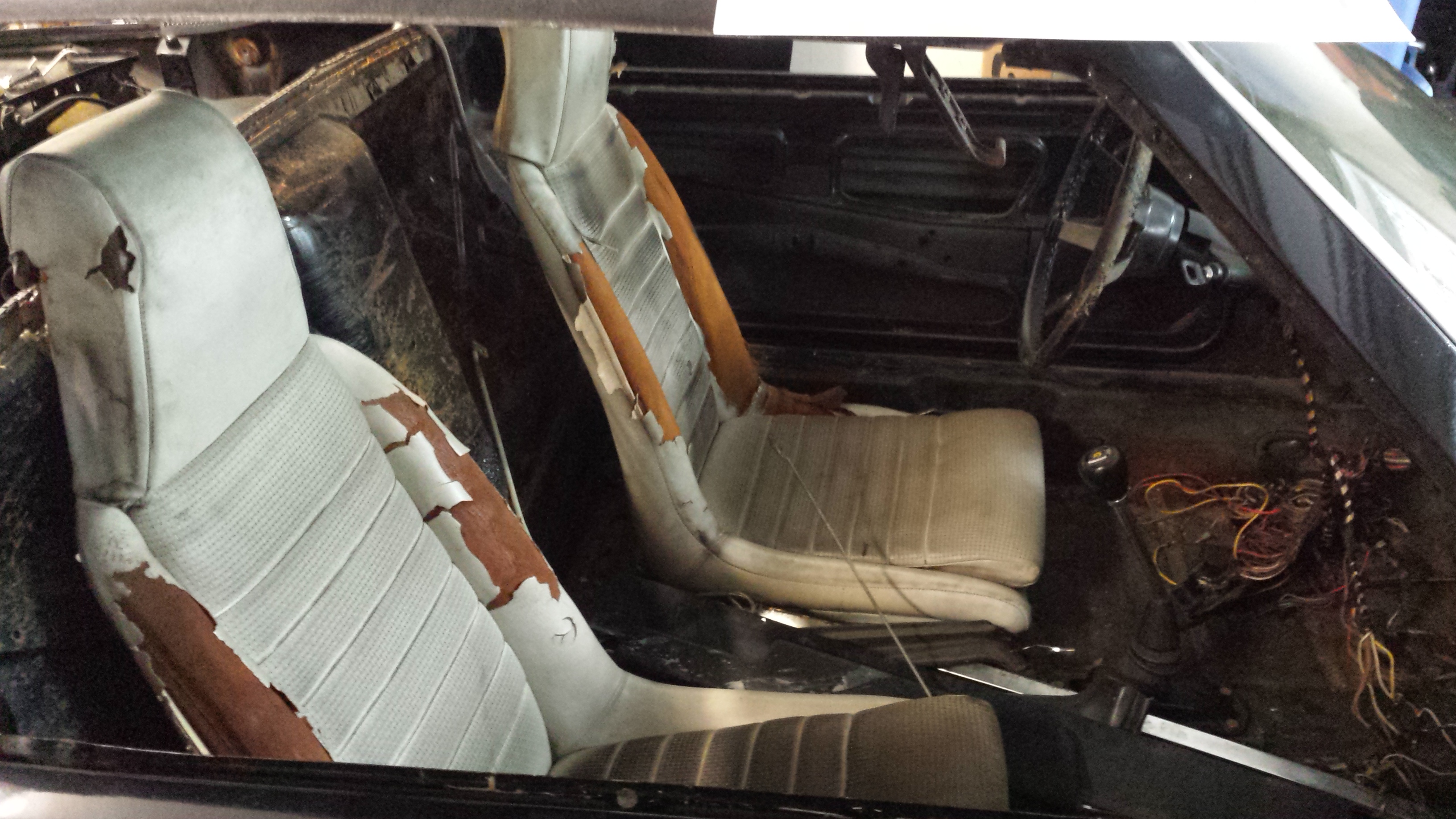

Here are a few pictures of the current condition of the car.
I am a late entry and thank the powers that be for allowing me to join the contest.
I do not have the welding or body work talent that some have but I will do most if not all mechanical and interior restore work.

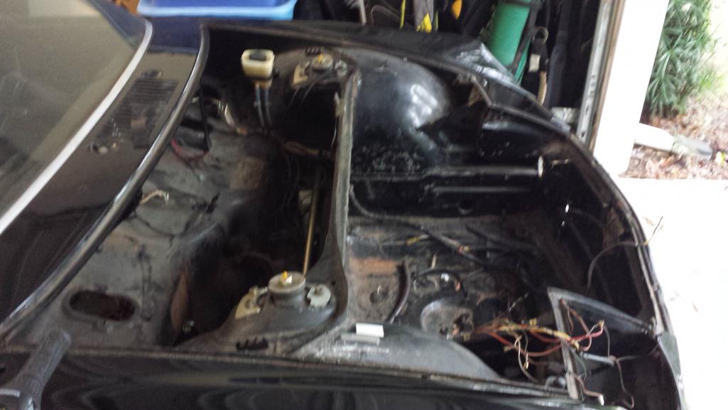

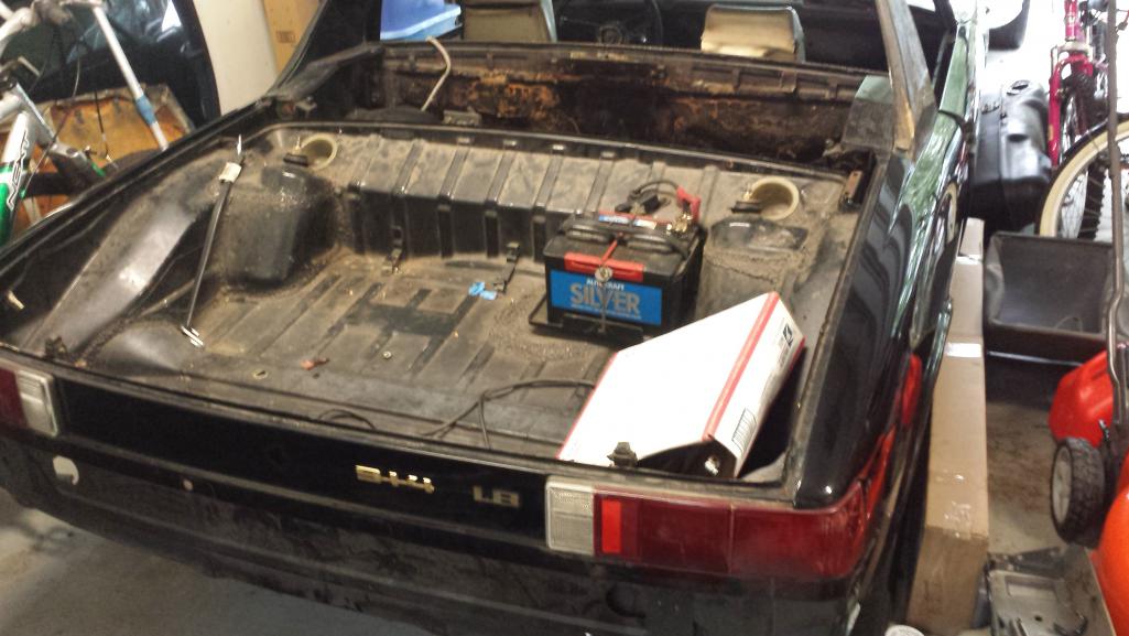

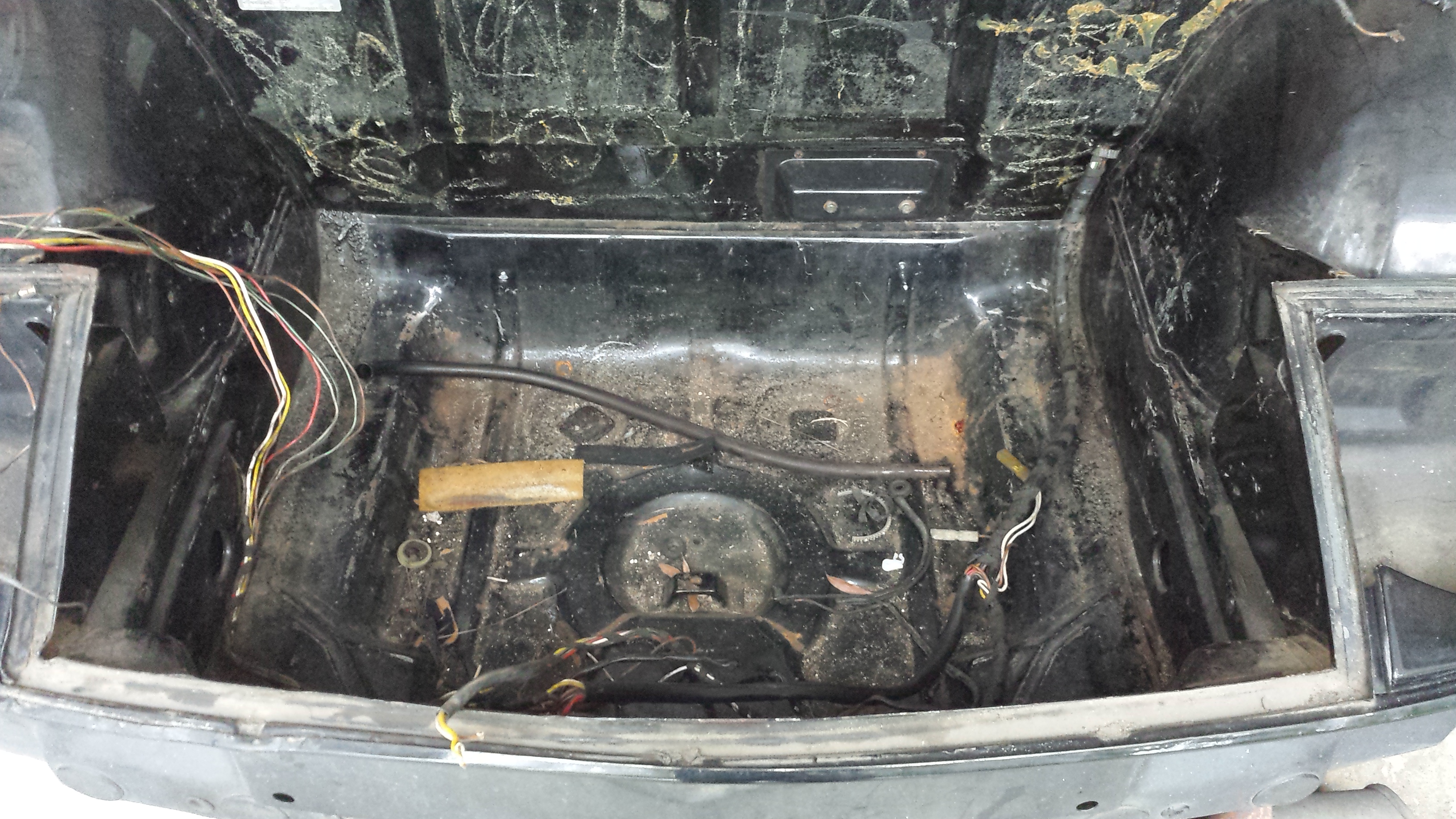

Front trunk. Hood is off,

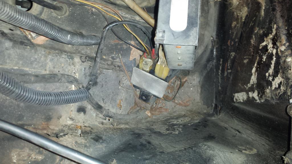

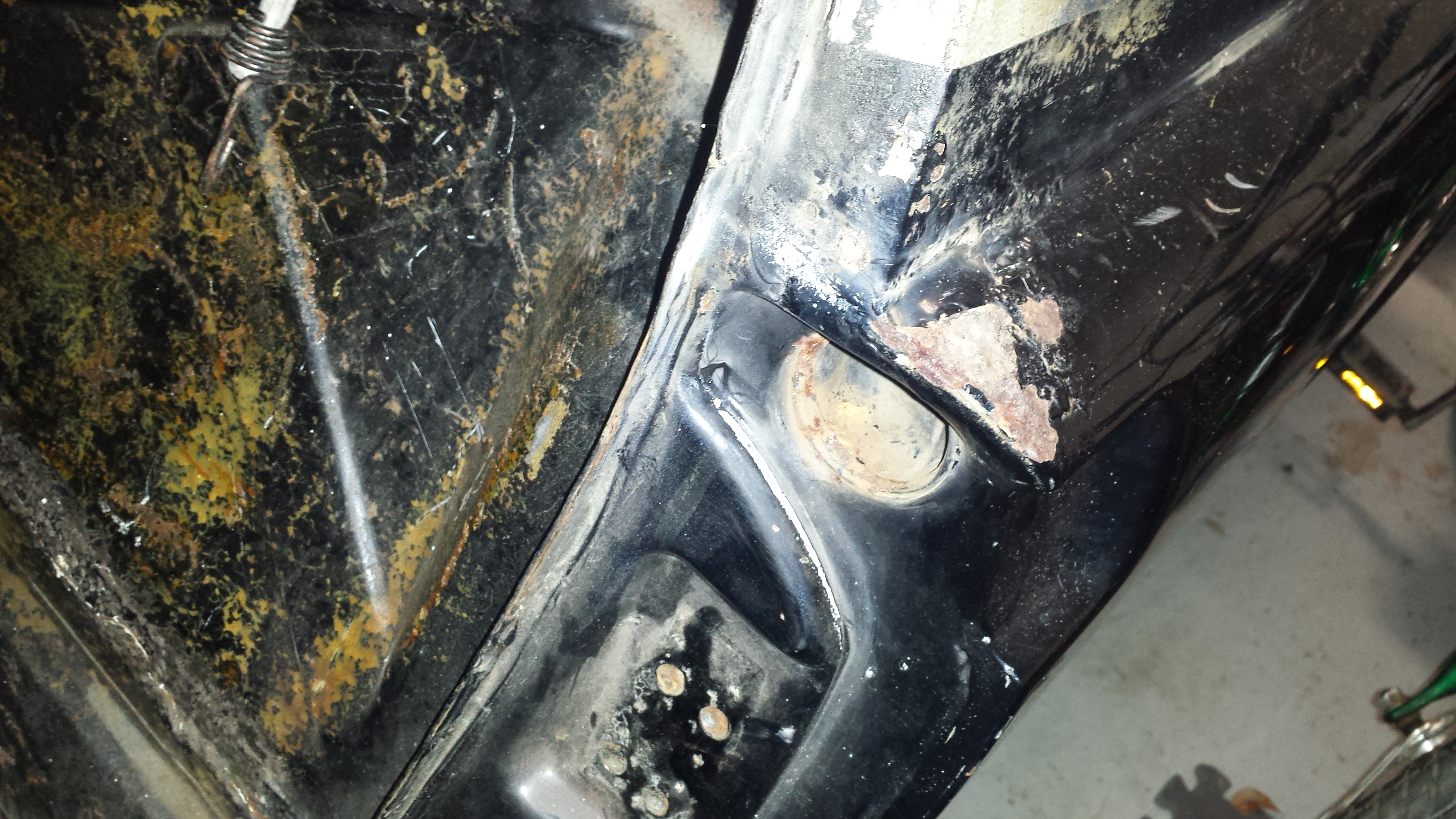

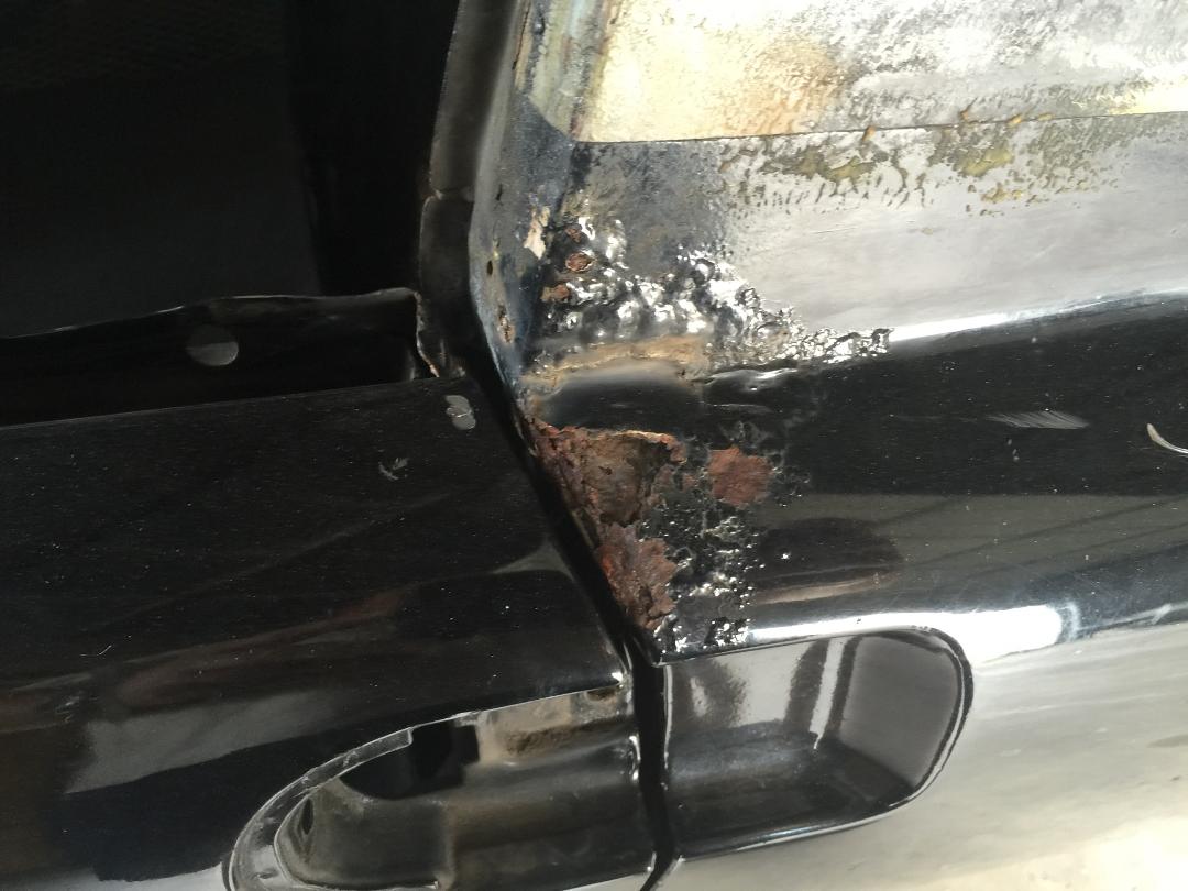

Rust

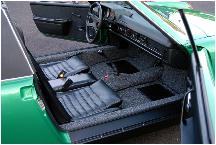

here is what i am shooting for with being original, but of course the seats will be white.

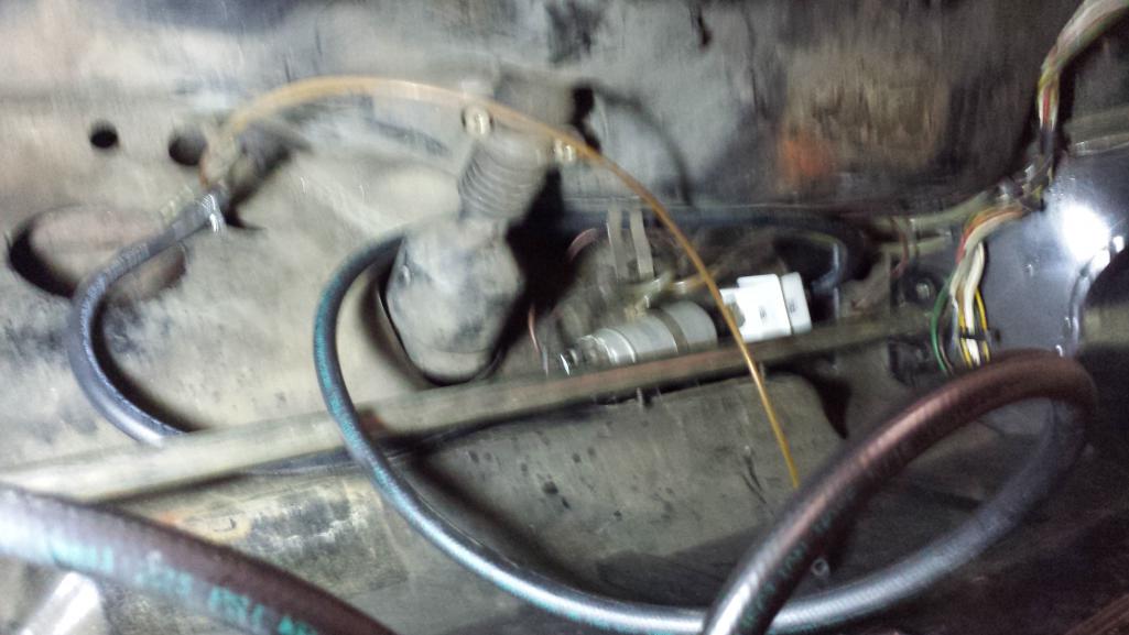

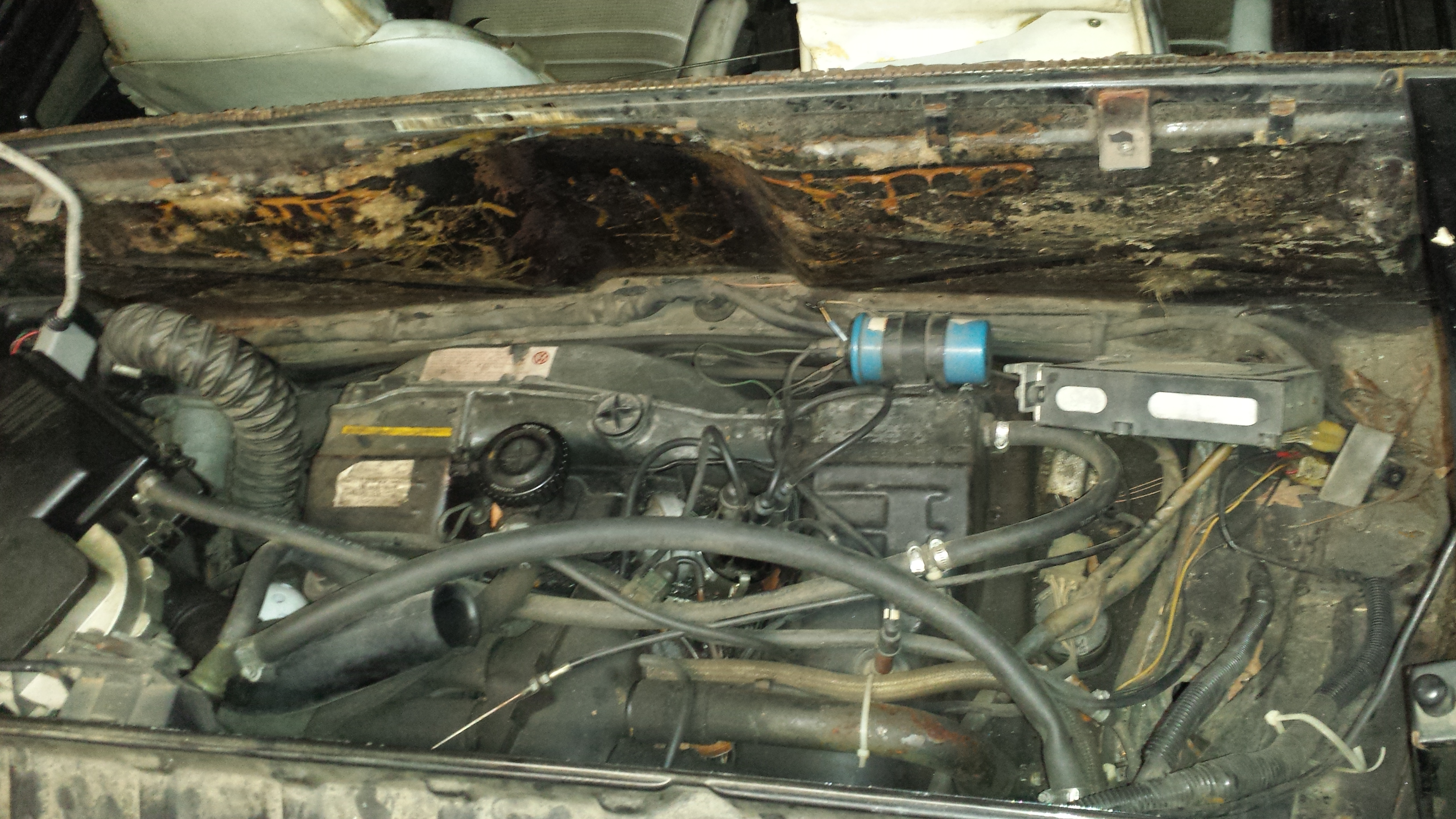

A few more present status picks, engine etc

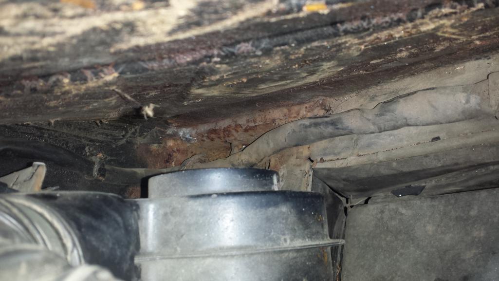

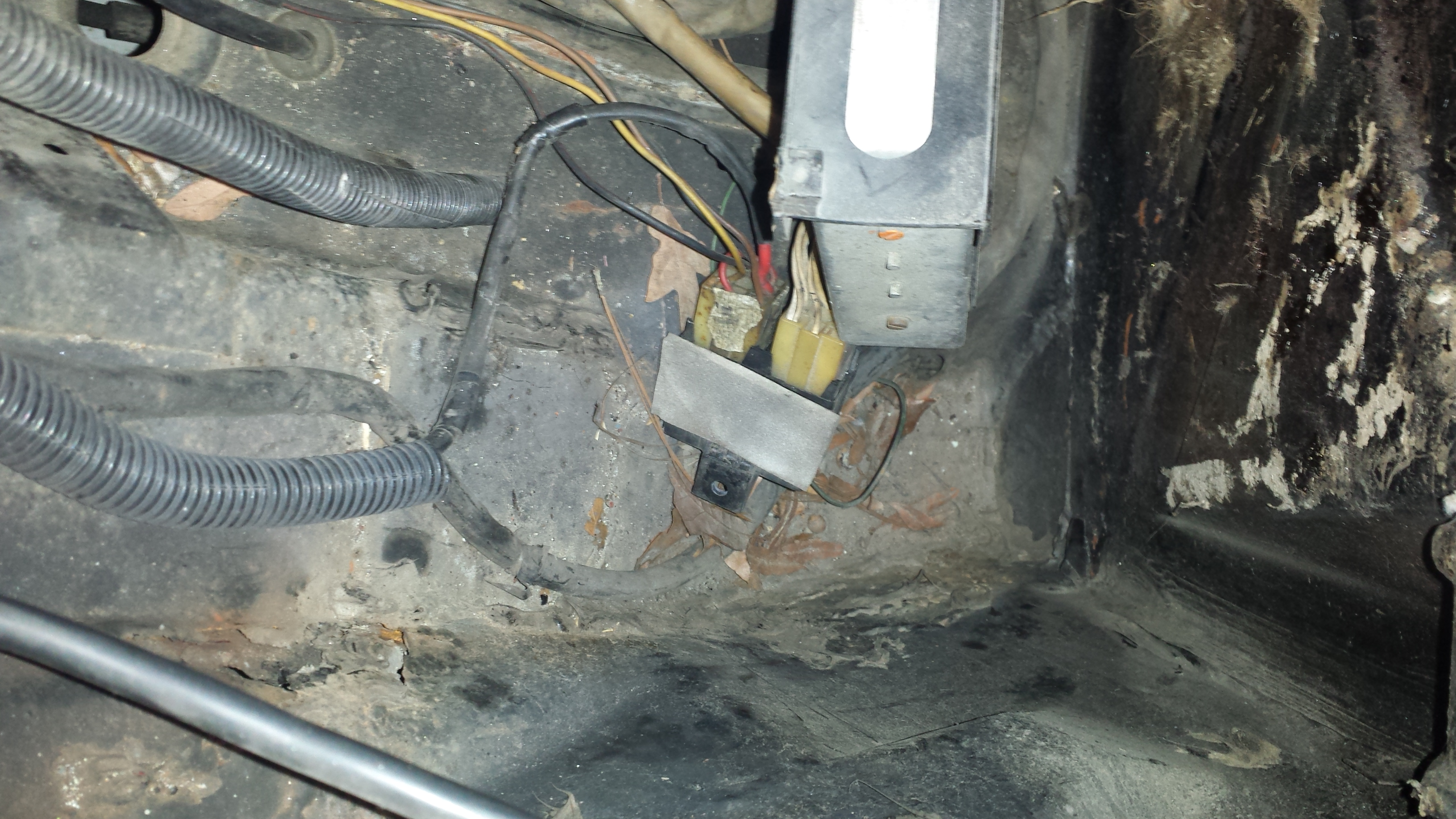

Rust

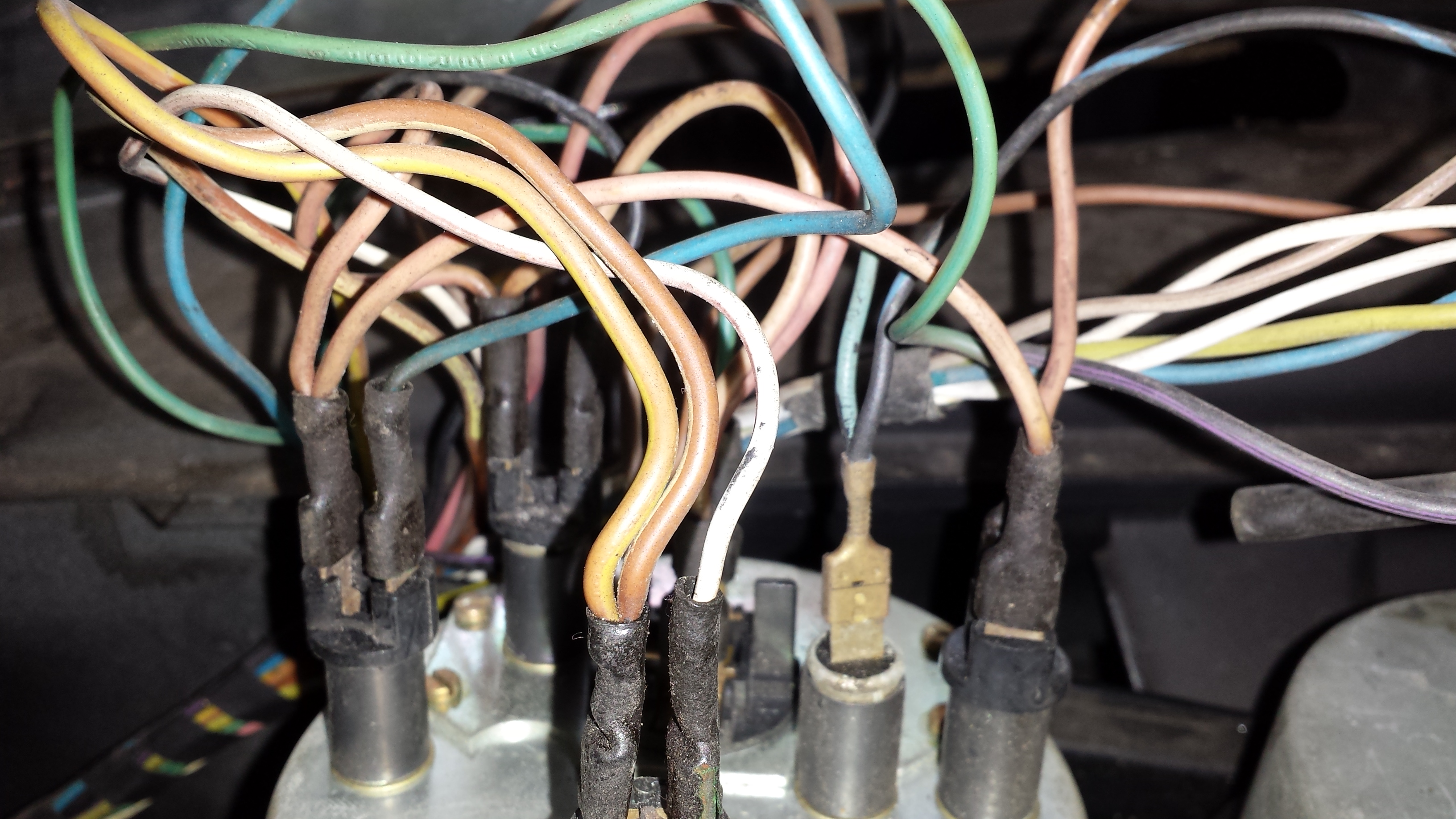

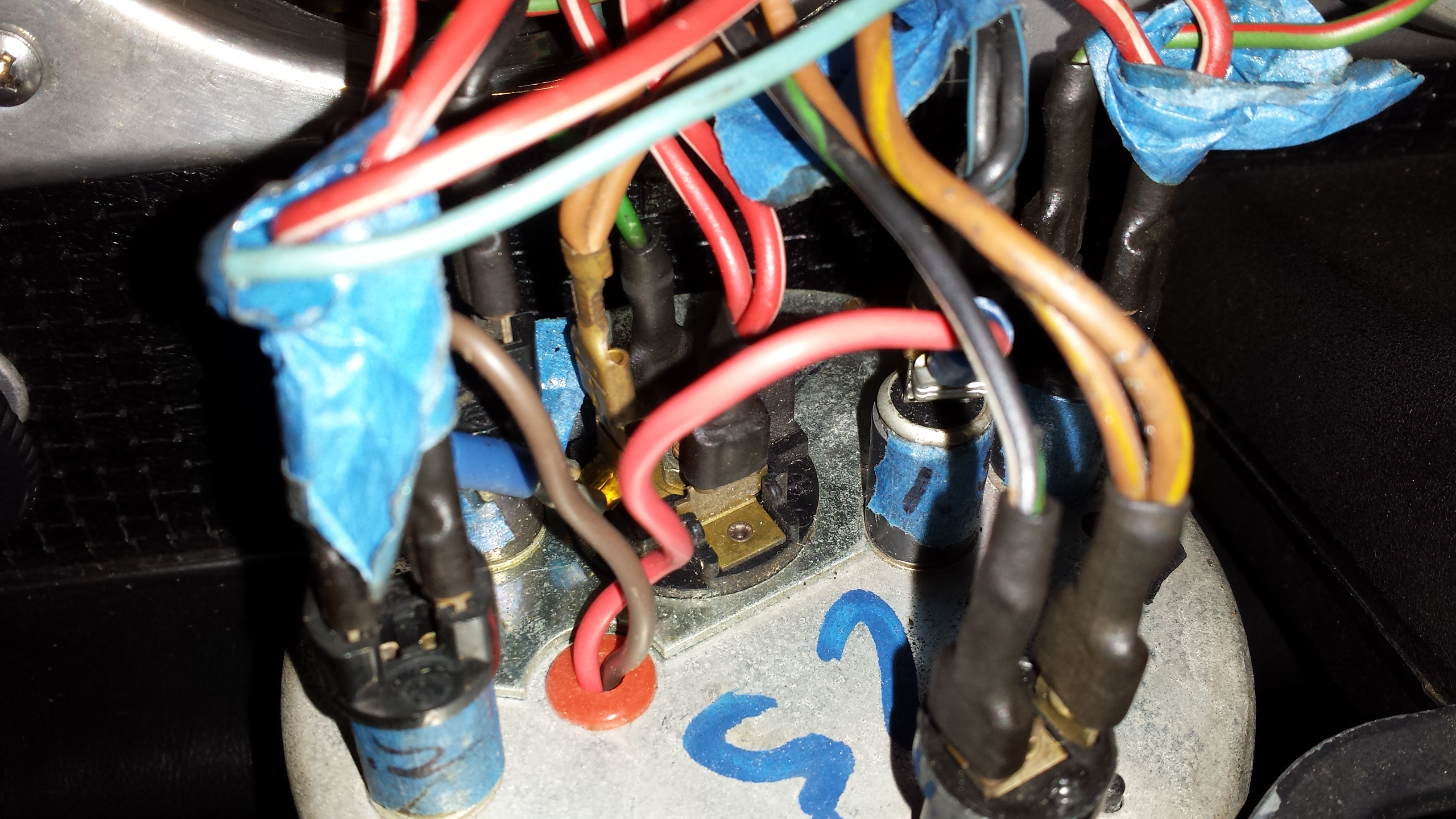

Dash wiring question- I have my gauges just about hooked up, but I have a strange variation and with the color fading it's hard to make out some of the colors, but I went over to my other 75 and did some comparing.
This car does not have the same color wire on the ee-brake wiring light. According to the schematic, Bowlsby char and my other car it should have 2 wires that are brown w/yellow and it does but the other one should be black with white and green stripe, but rather what I have on this one is white with a brown stripe. Has anyone else seen this variation?

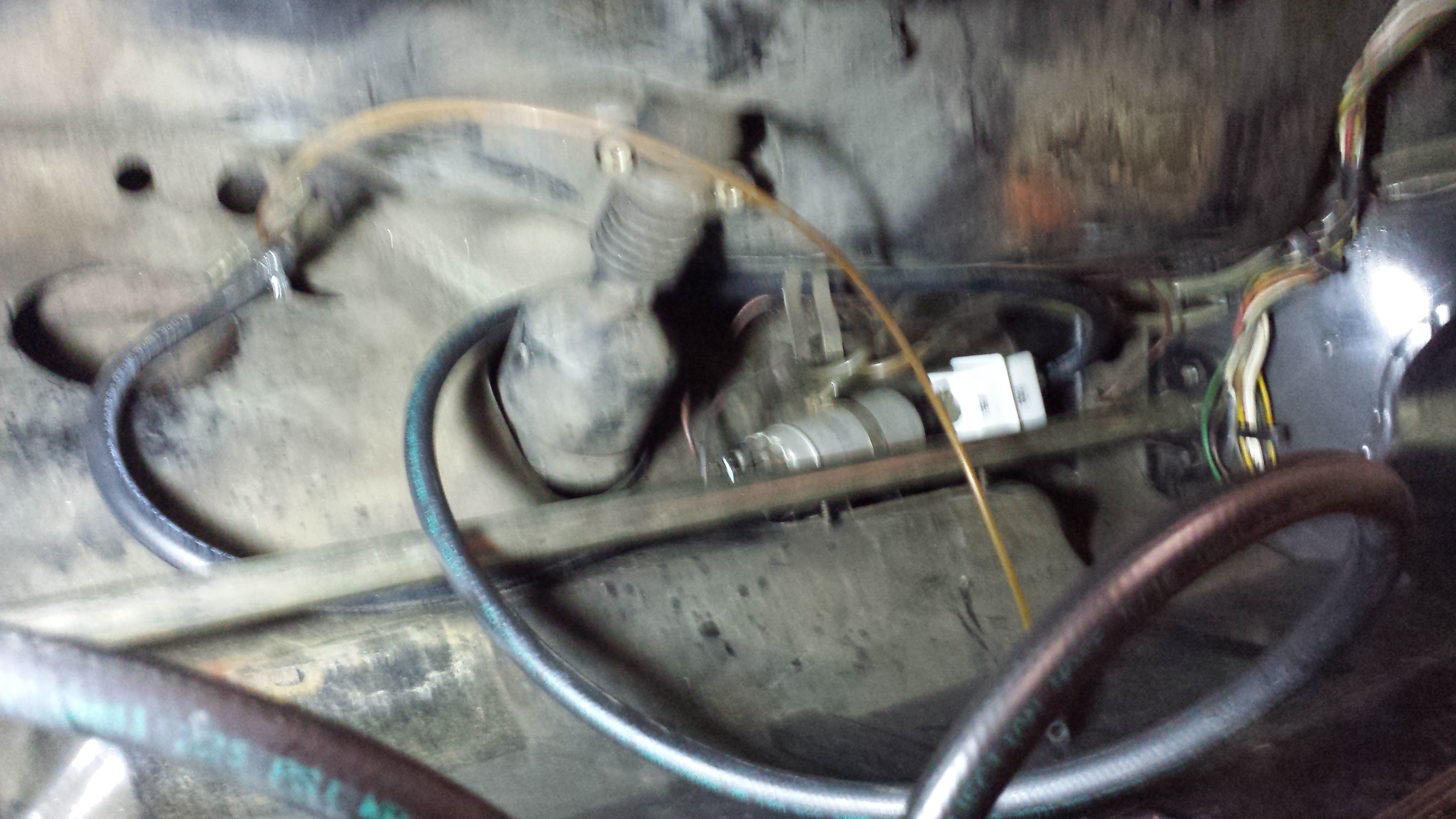

Minor progress tonight. Changed oil and filter. New gas hose , new filter and pump and hooked them up so that I can get ready to test it. Has not been run since I got it, and I'd like to see if it will go. Now that tank is in place I will put some fuel in there to see if I got the wiring hooked up correctly. Also got some inspecting of the under carriage. Looks pretty good. Also, jacking up the car I noticed there is no body flex at all. Liting from the back the whole.aide of the car raises up as it should, checked door gaps and measurements at the top and no change !! That's a good sign for sure, since there has been some work done in the hell hole area in past. Next I will pull those rockers.

- pulled wiring back thru to sort, hook up the fuel pump. because I need to know what I have in order to know if I am doing major or minor engine work- i'm really close to trying to crank it up so that I can then check for leaks, check compression etc. ( car is a 75 with 1.8 L-jet.)

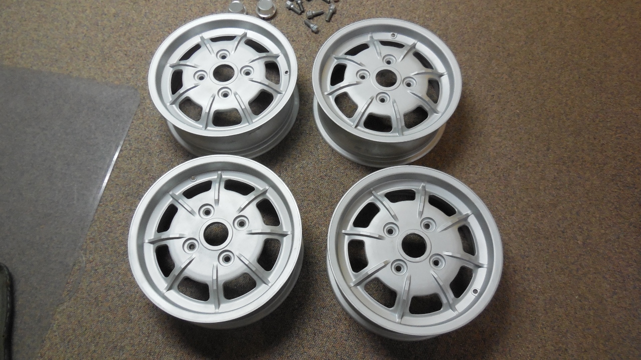

1. new Mahle wheels from member here: - will be shipped today or tomorrow(soon as I pay him (IMG:style_emoticons/default/wink.gif) )

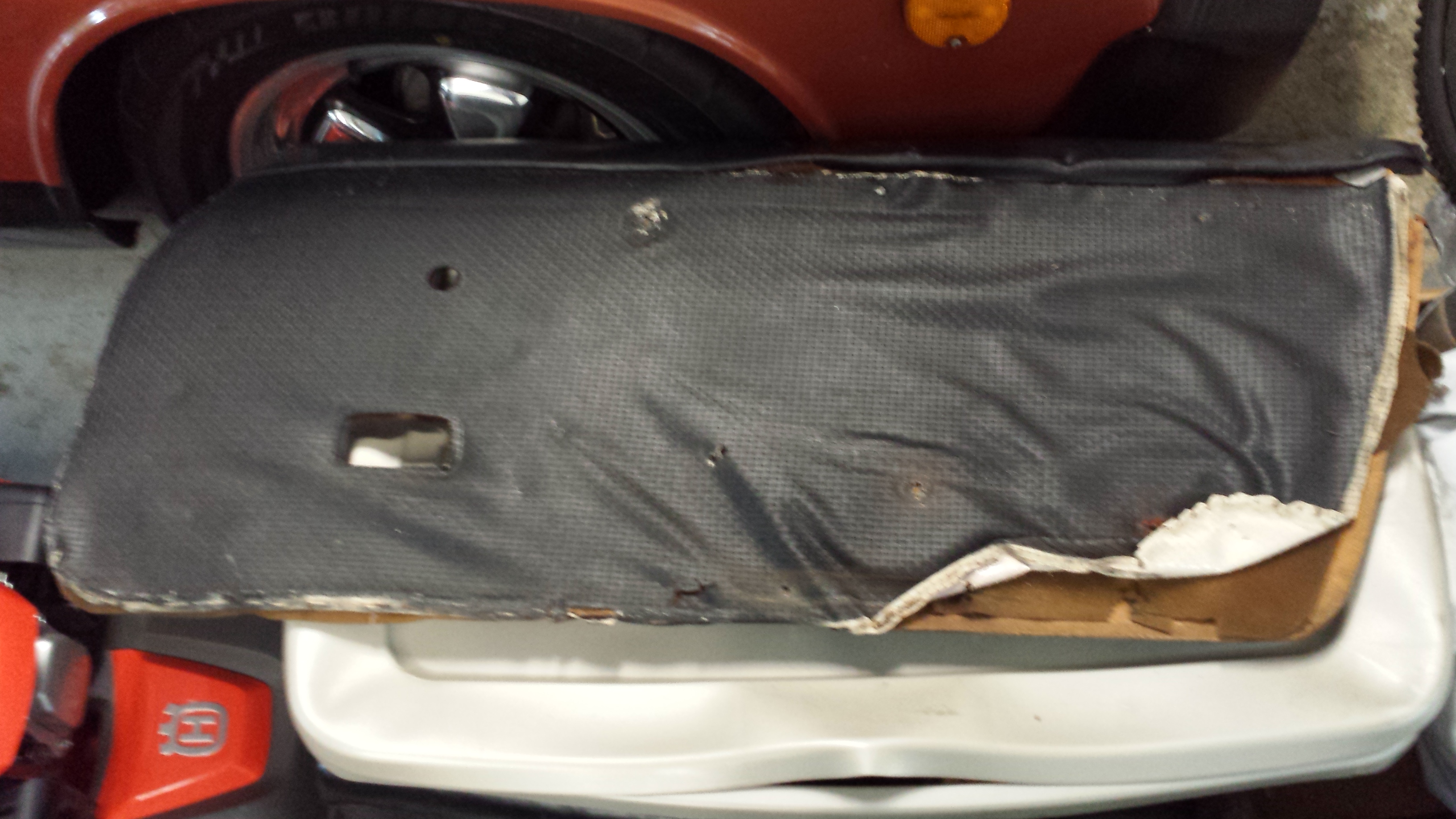

-threw out almost all interior parts except seats!! it was all trash
** so new list of parts needed to go forward: hell hole repair, battery tray, new dash and all new interior including door panels, back pad panels, white vinyl for back , doors, seats, - need to find out what carpet the car would have had stock- it was originally a stock black outside and white interior???

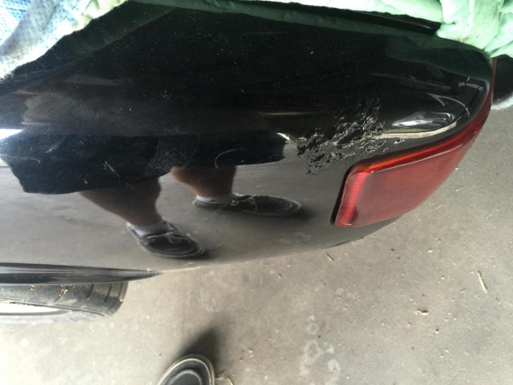

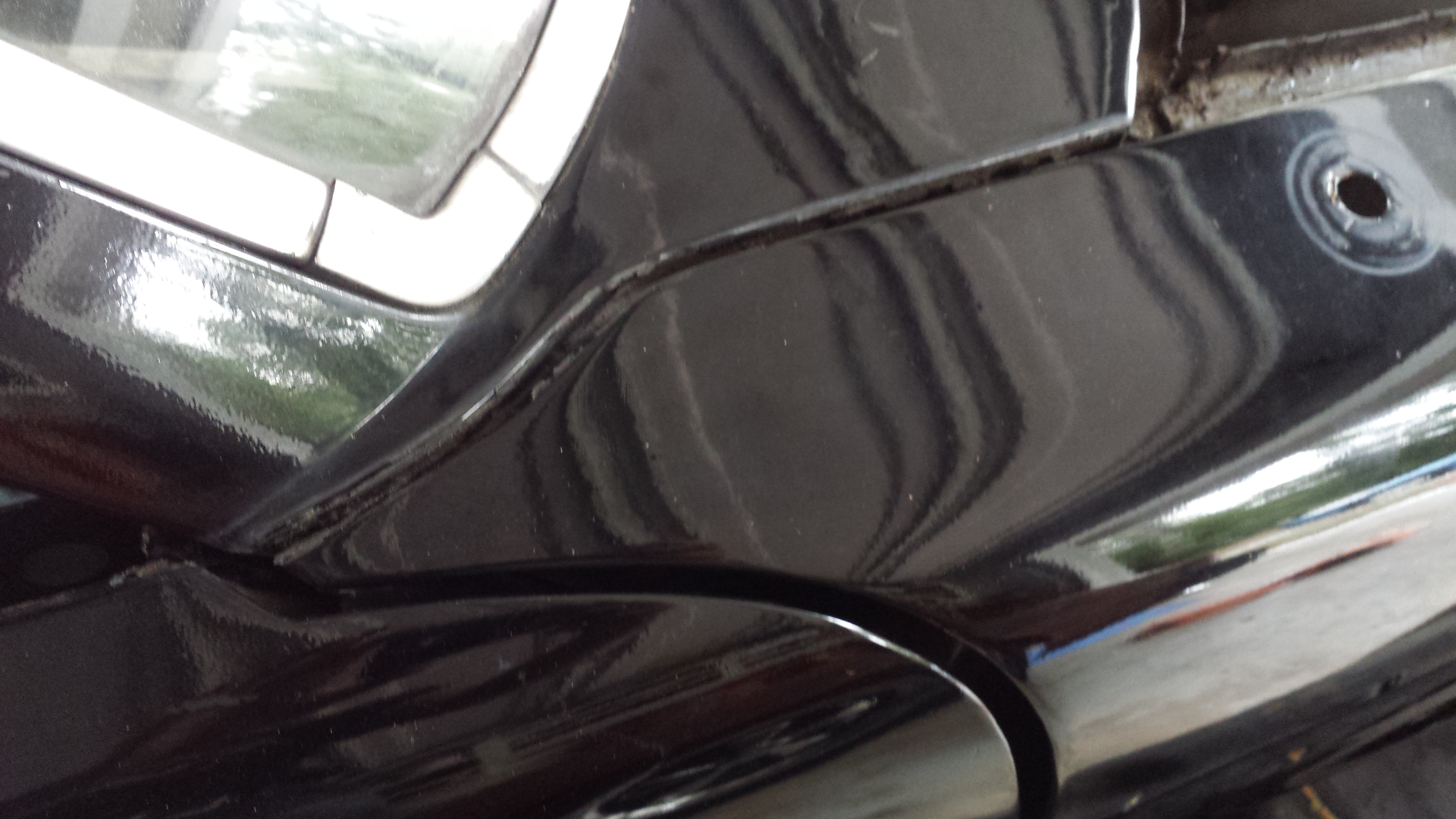

The right front fender clip was replaced and is very straight., but not aligned perfectly so the gap with the cowl and the front edge of door is 1/8" or so too bigh. I need advice on whether I should leave it or remove and reattach it.

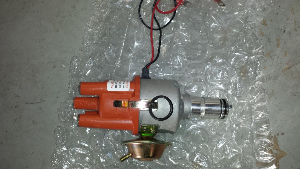

New distributor.

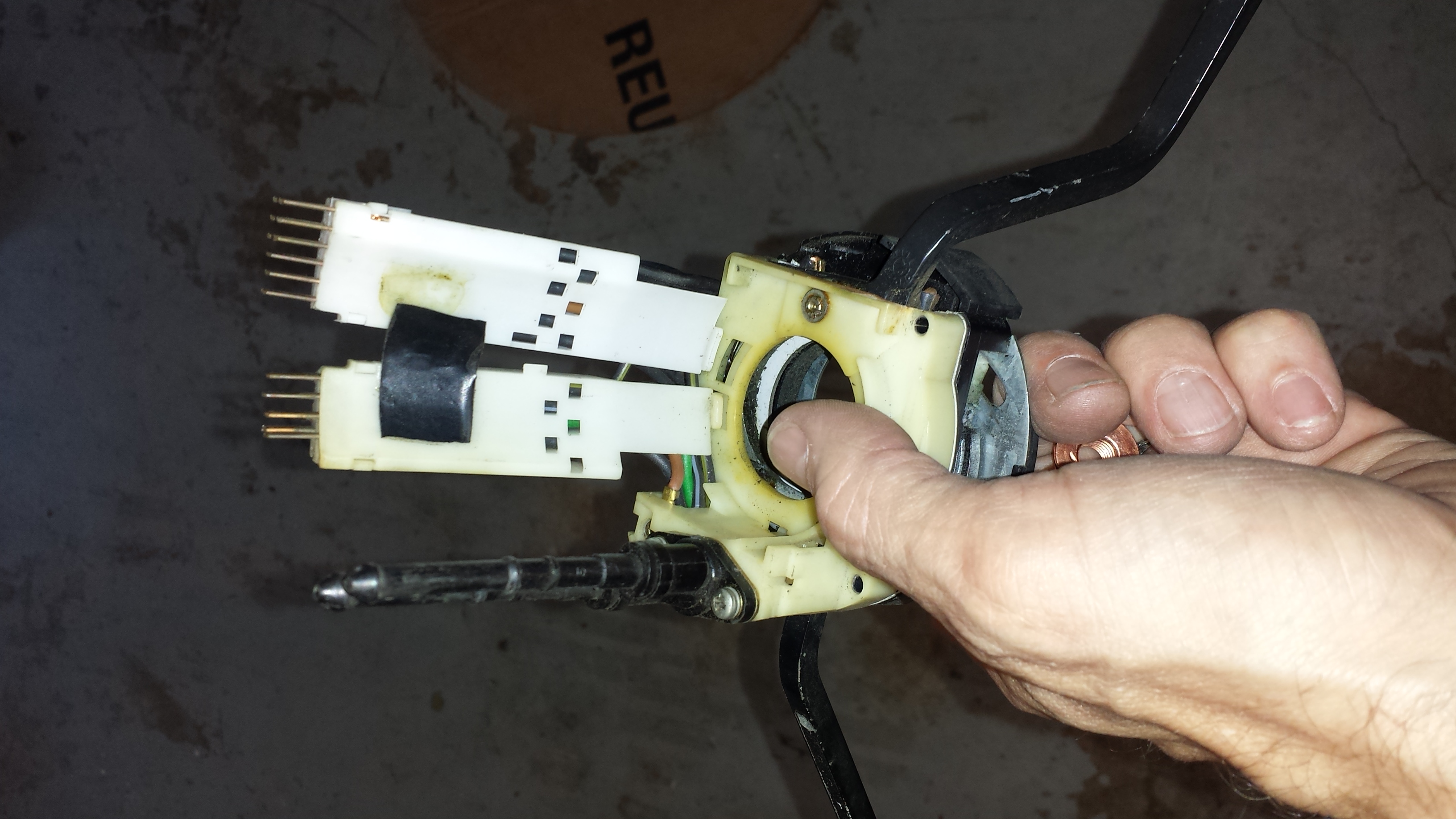

Can I use this over ? I think when the pulled it out it was ruined, I may need to source a new one, do they make new column parts?

Fender/door gap and cowl gap

Reharvey sent me some awesome restored Mahle wheels, already pictured, now in my possession!.

QUOTE(Philip W. @ Oct 27 2015, 05:04 AM) *
New distributor.
The split you mean? Thats normal, it actually pieces back together. The question is if everything works..
