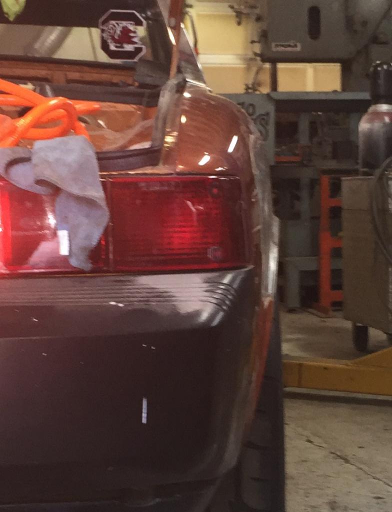

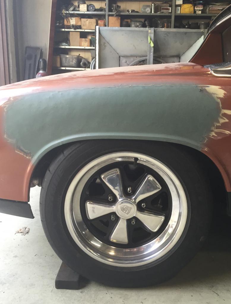

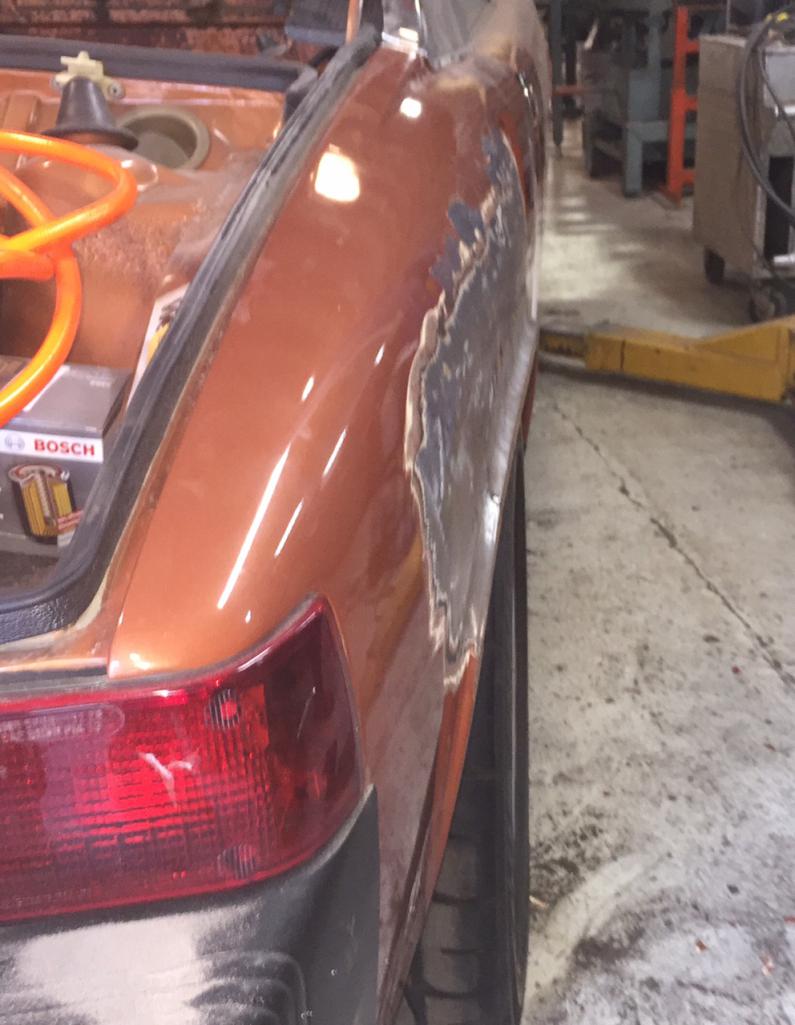

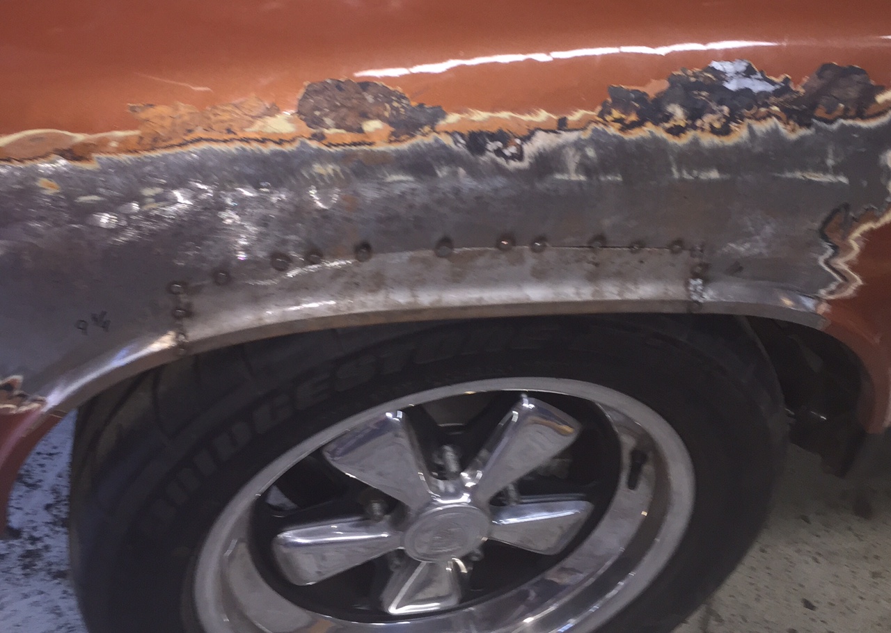

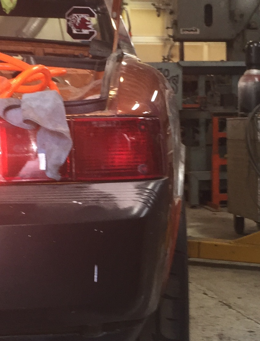

Good news to report! Here are some photos that Chris just sent- try had a lot of work to do in the rear fenders- the lips were bent badly and creases on the fender from a poor attempt to roll them- then they rubbed and caused paint blistering- the 7" Fuchs didn't fit, but they are staying in the car- so Chris's guys were able to carefully pull them out about 3/4", and replace the whole lip from a donor and in the end you can see the view from behind the profile looks perfect and I think once primed and repainted you will not be able to even see there was work done! - way better in my opinion than putting whole flares on the car- I wanted the stock look and lip, just enough room for the wheels and tires.

Chris is almost finished with the repairs on the car. should be wrapped up by the end of this week so I am flying up next Thursday night next week and going over Friday to put stuff back in the car and probably will head out Friday night to drive it home - He put a new aux oil cooler on it for me this week, and they are finishing the last of the rust repair, a spot on the threshold area they found- that should be it! - new half floor pan, pedal area, rear longs, jack points etc etc, drivers side cross member support and seat hinges replaced - rear fenders were pulled out and hammered straight with new lips giving room for the 7" fuchs with 205/55 wheels and rims! - stock look, cant wait to get it home and have the paint done!!! this will be started on August 25th -

ChrisFoley
post Aug 10 2016, 02:52 PM
Post #46
I am Tangerine Racing
Posts: 8,035
Joined: 29-January 03
From: Bolton, CT
Member No.: 209

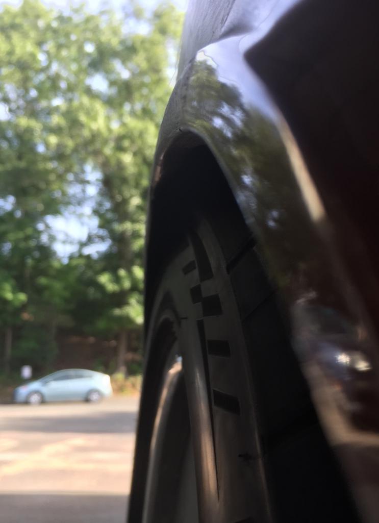

Right quarter panel tire clearance:

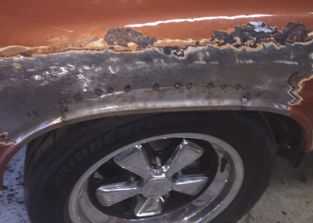

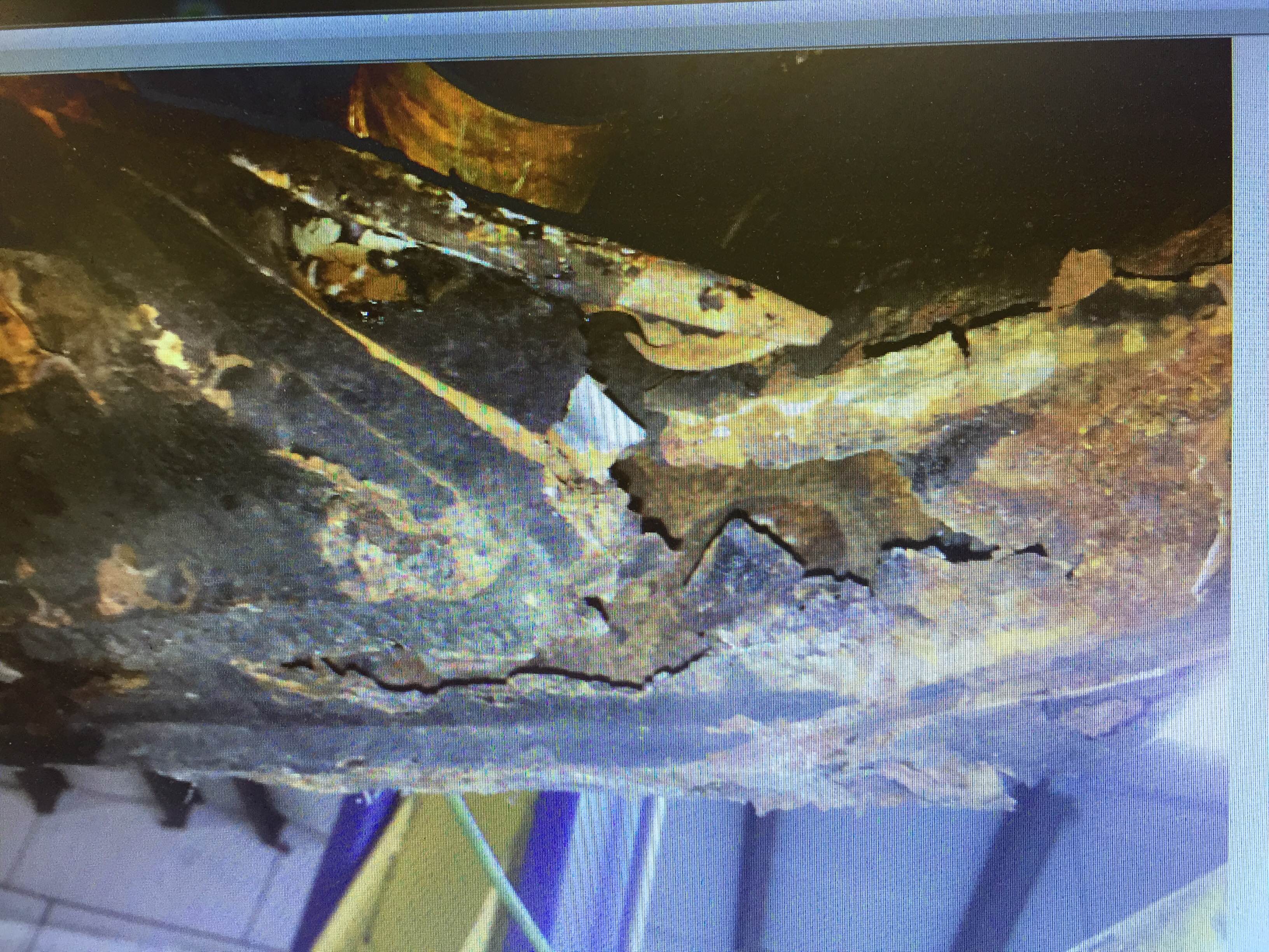

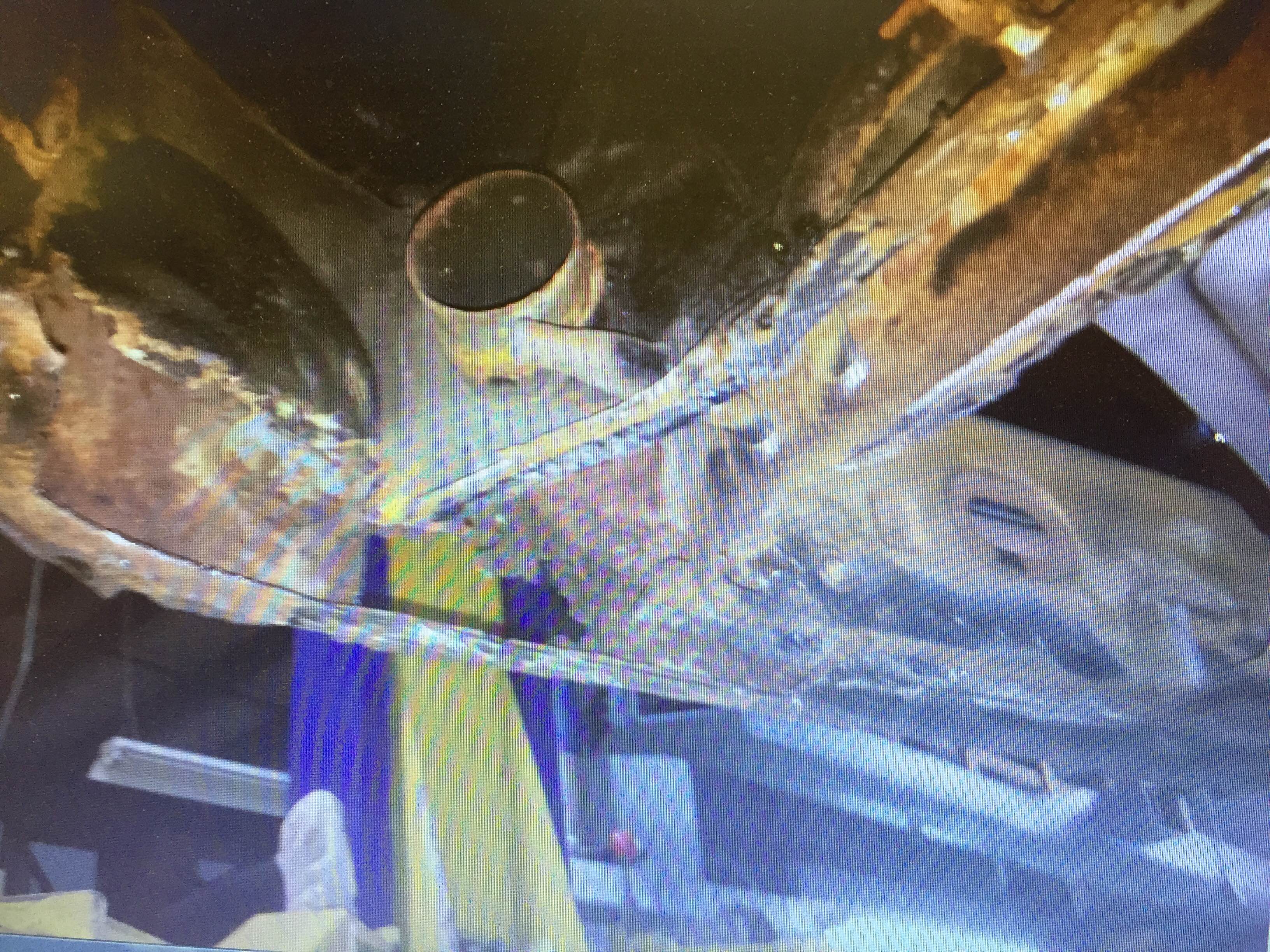

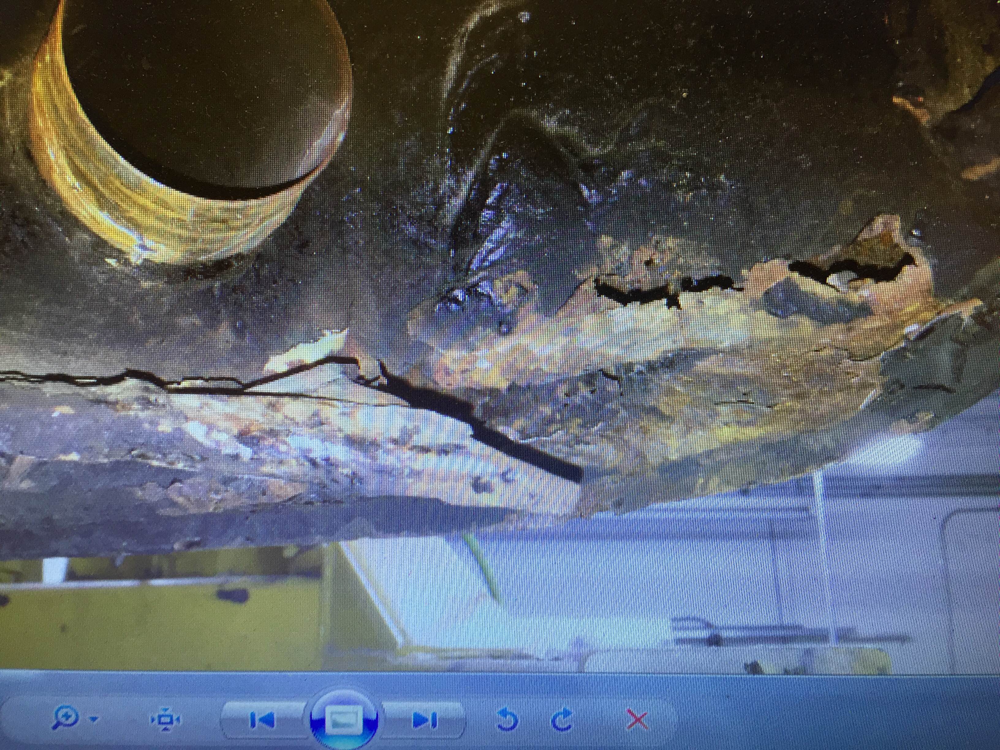

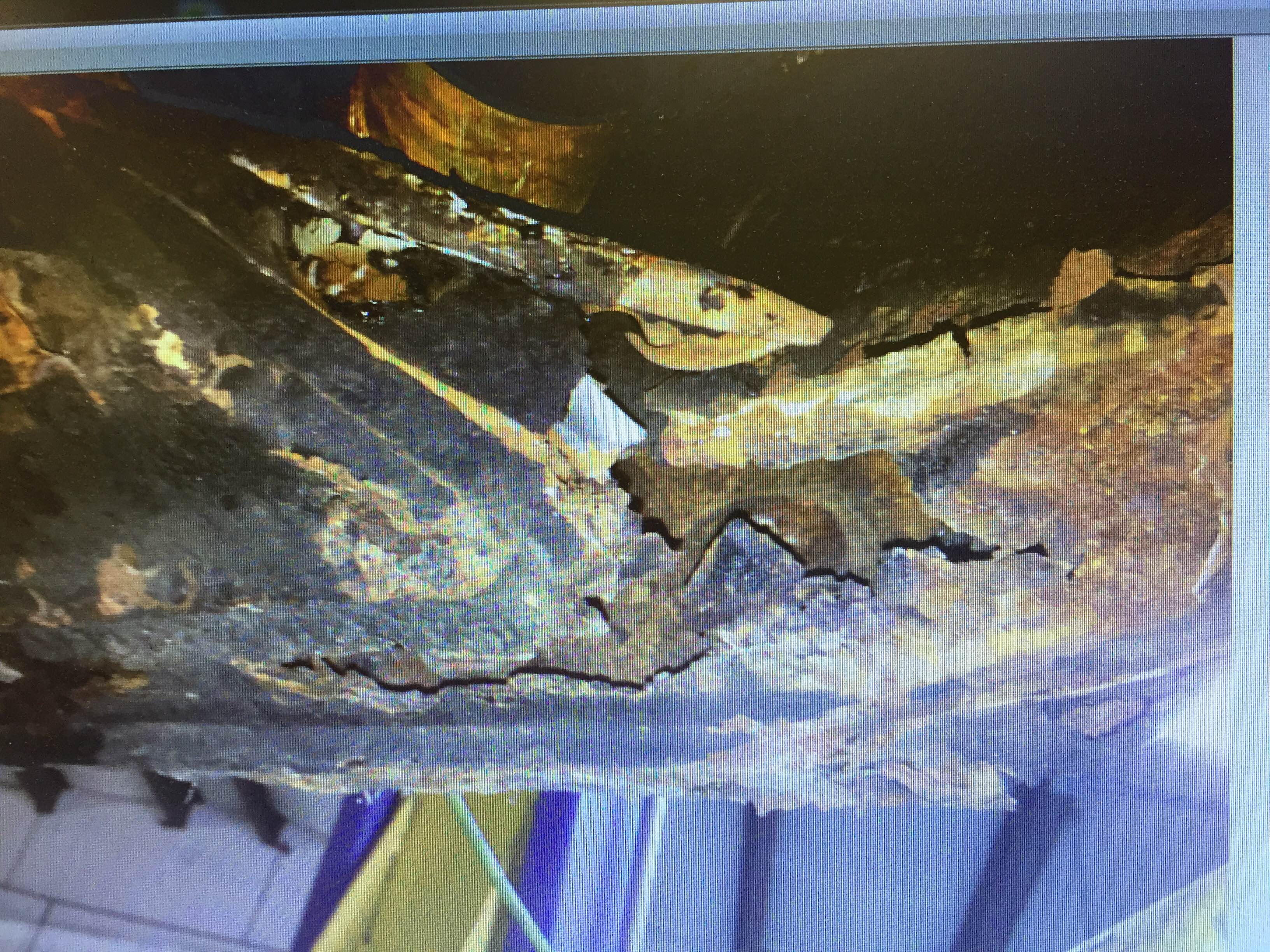

time for some rust updates - I have some pictures taken by Chris so we can see the extent of what was removed and what was replaced.
- condition of the longs- drivers was worse but the rear inner wheel house on passenger side was worse - floor under driver side - pedal area under cluster, etc.
DRPHIL914
post Aug 22 2016, 07:44 AM
Post #49
Dr. Phil
Posts: 5,971
Joined: 9-December 09
From: Kennesaw, GA
Member No.: 11,106
more
DRPHIL914
post Aug 22 2016, 07:45 AM
Post #50
Dr. Phil
Posts: 5,971
From: Kennesaw, GA
Member No.: 11,106

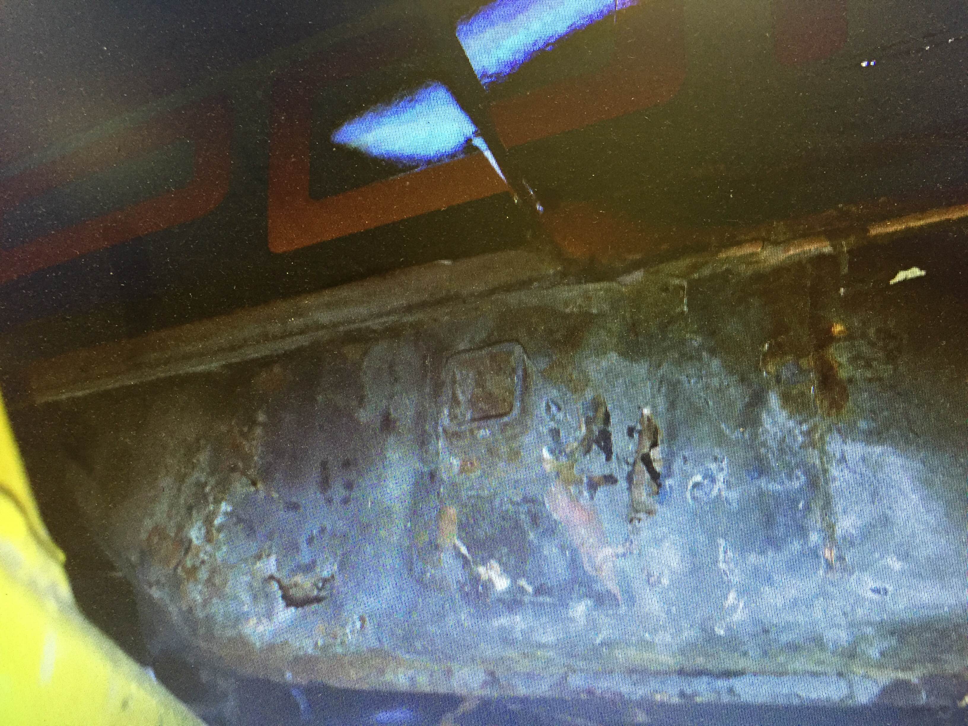

right side rear long and wheel house
DRPHIL914
post Aug 22 2016, 07:46 AM
Post #51
Dr. Phil
Posts: 5,971
From: Kennesaw, GA
Member No.: 11,106
righ side under

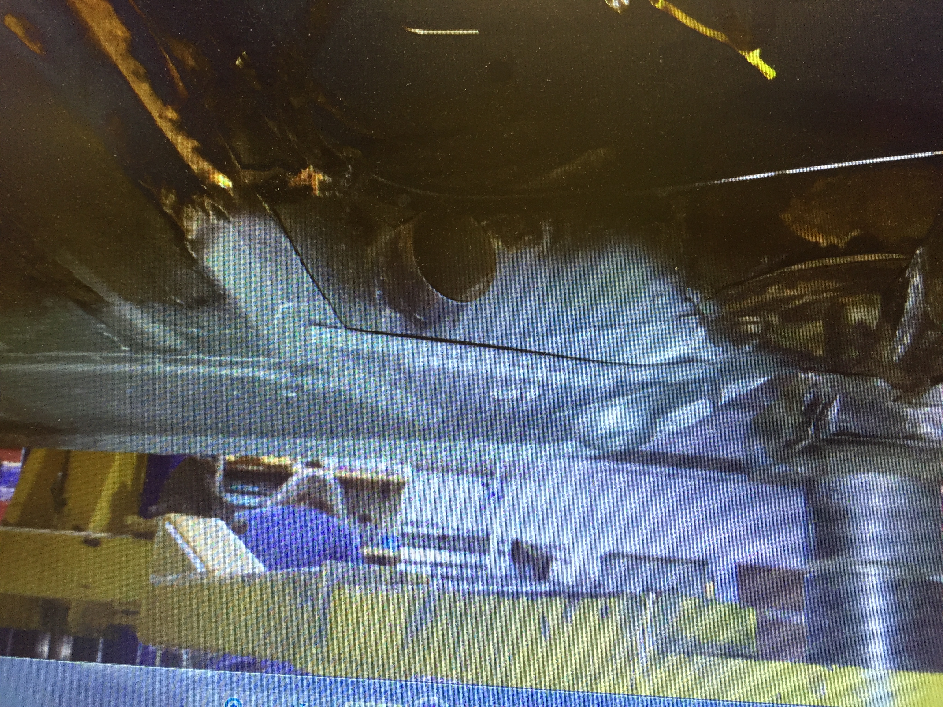

post Aug 27 2016, 06:47 PM
Post #54
Dr. Phil
Posts: 5,971
From: Kennesaw, GA
Member No.: 11,106
Big change from before

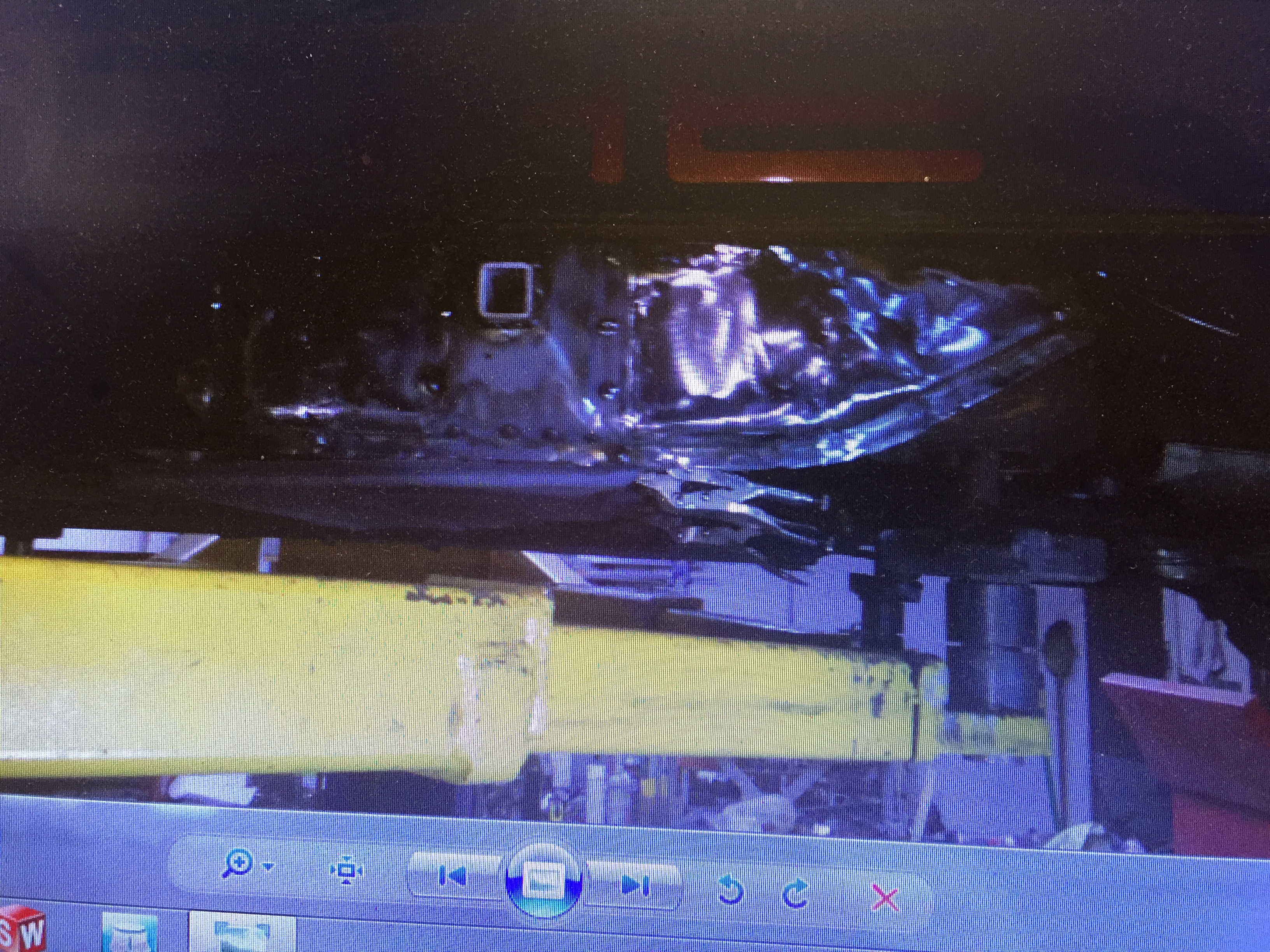

DRPHIL914
post Aug 27 2016, 06:51 PM
Post #55
Dr. Phil
Posts: 5,971
From: Kennesaw, GA
Member No.: 11,106

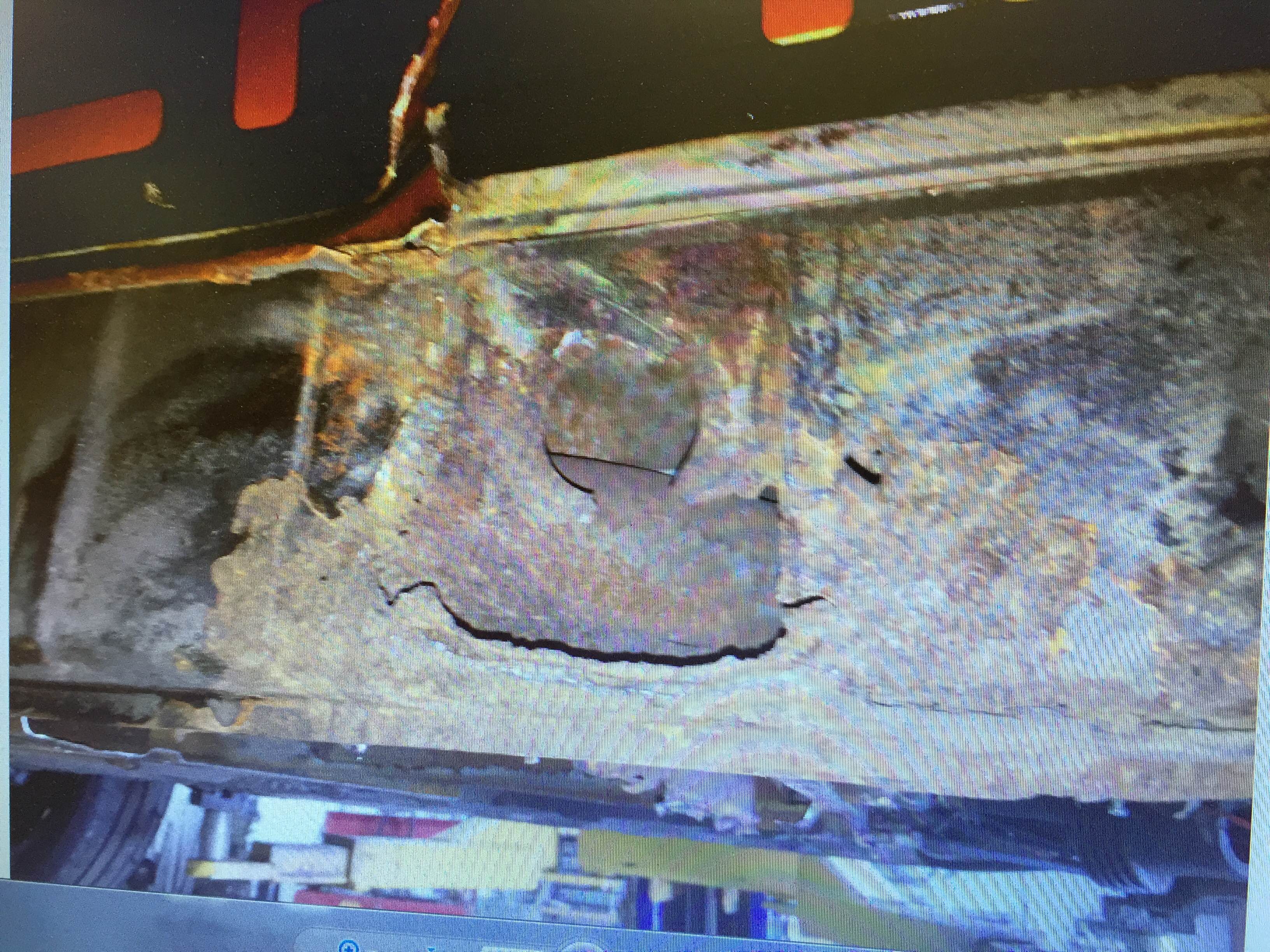

Drivers side Jack triangle had rusted off completely , tube was gone as you see from the previous picture

post Aug 27 2016, 06:57 PM
Post #56
Dr. Phil
Posts: 5,971
From: Kennesaw, GA
Member No.: 11,106

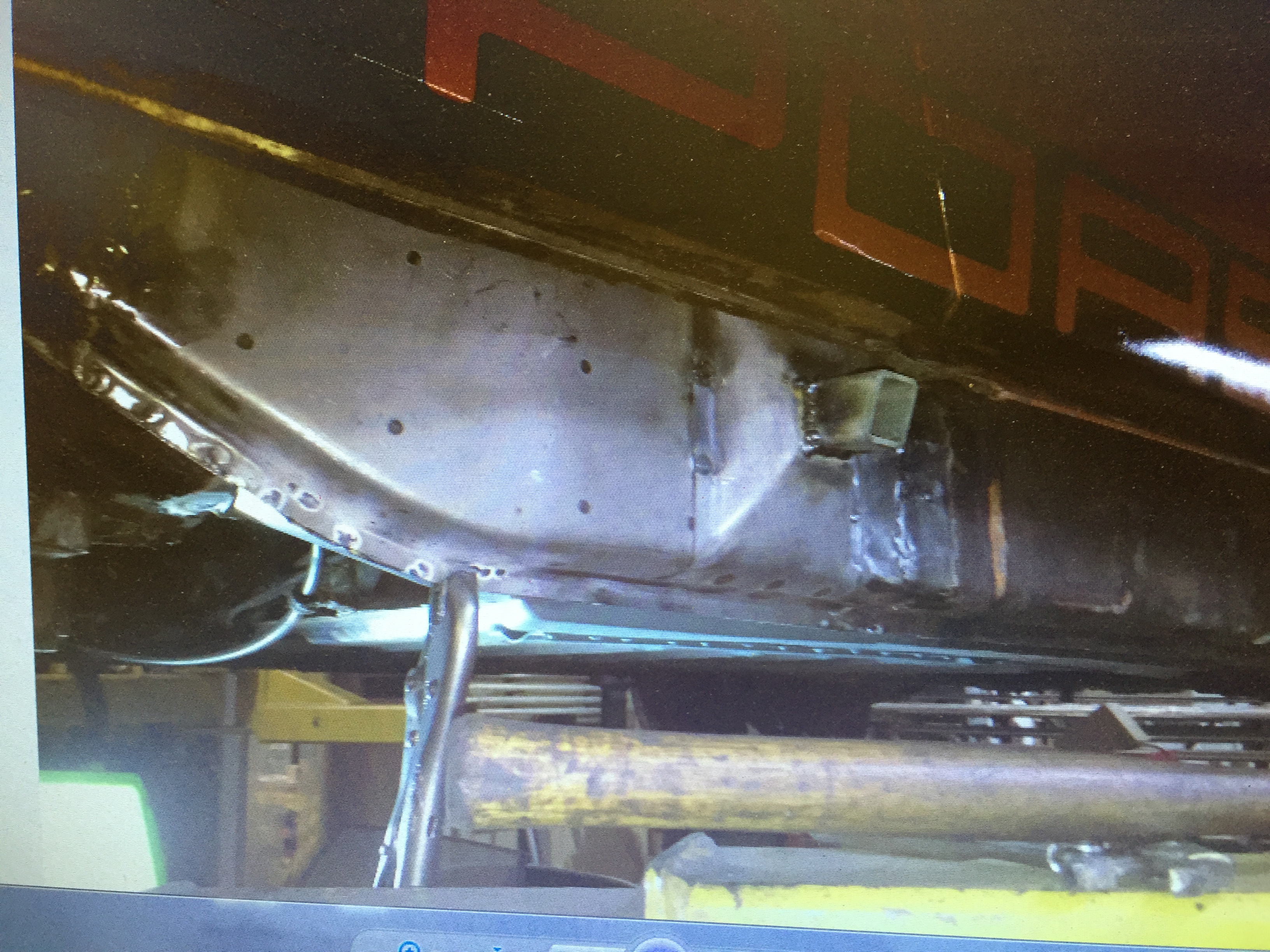

New floor pan pieces!

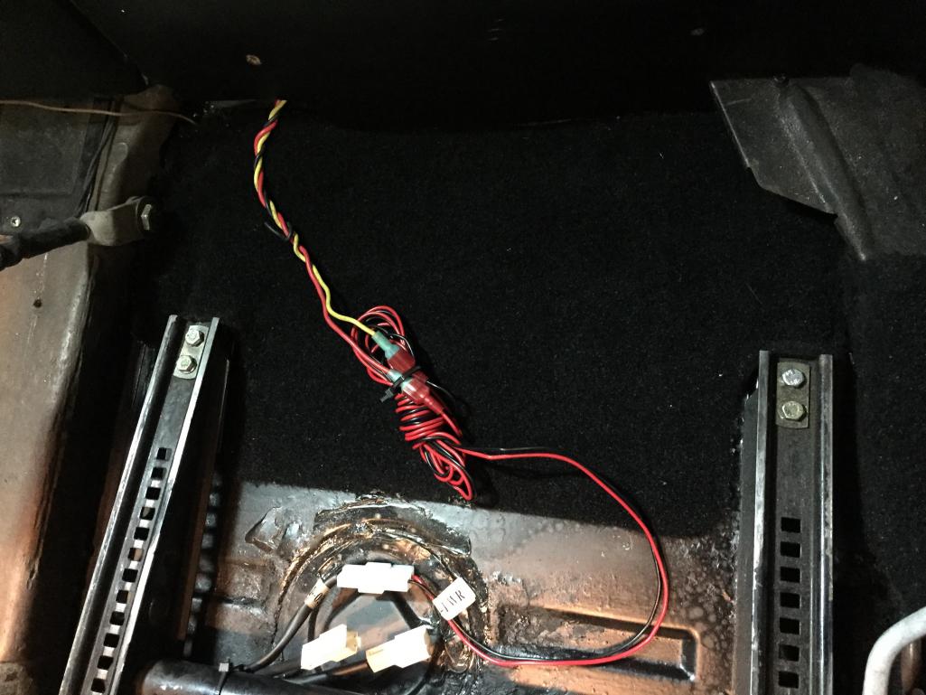

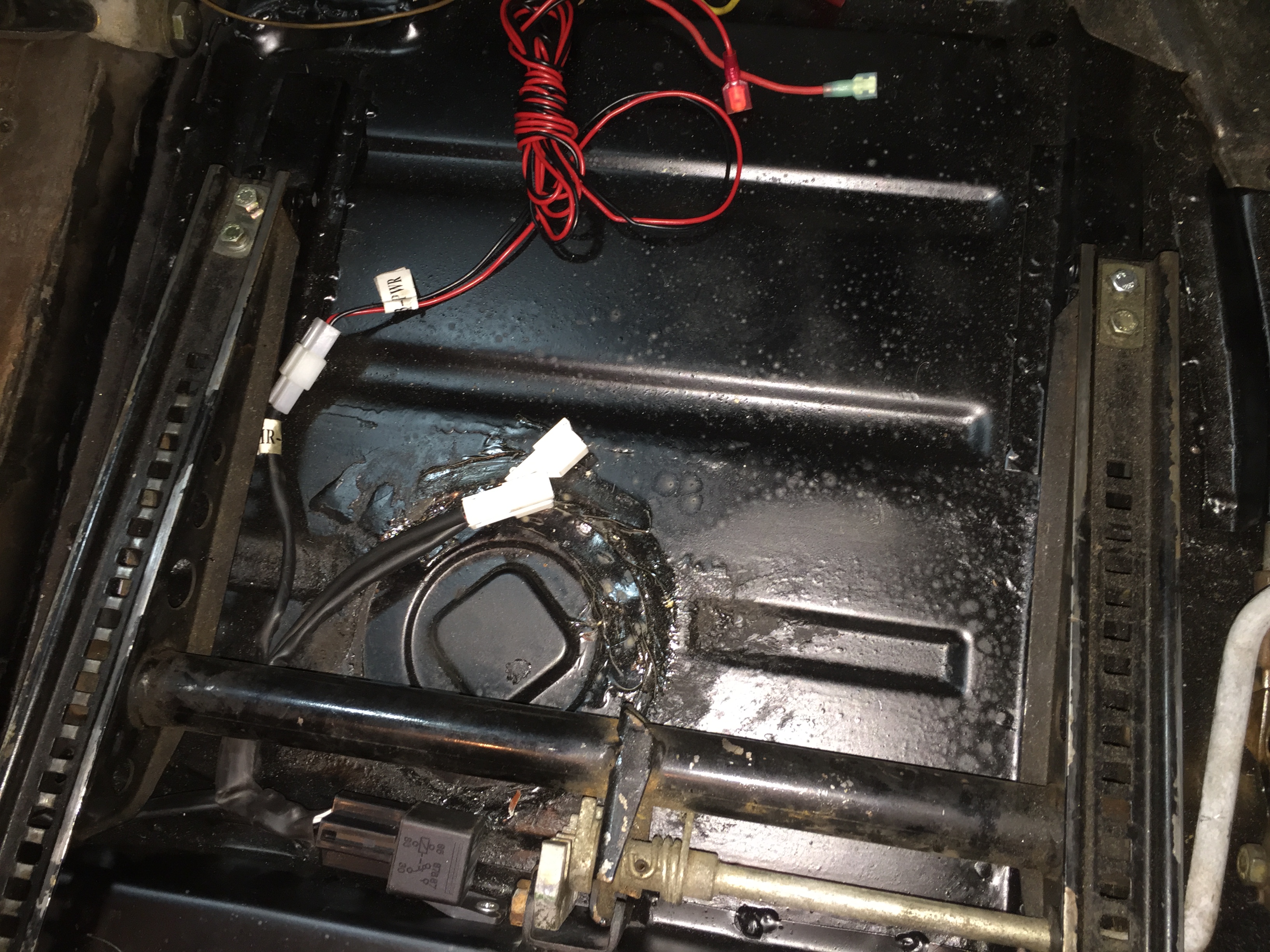

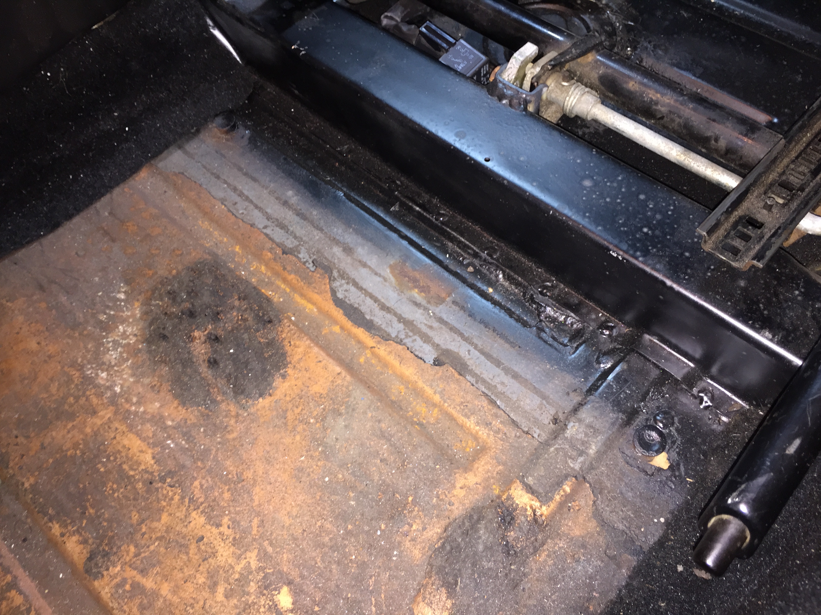

Inside picture of new door area- also new cross member- new seat bracket and hinge. This area was rusted thru under the seat and the cross member cut and lowered to fit 993 seats at one time, now along with the longs and Jack points all repaired by CFR-
Thought I would rewire the heated seats as I am cleaning up and putting rugs back in place - the wiring you see on floor is for the heat pads that were put in when I did the 914rubber seat kits I will later on put some sound pad under there but I don't have time now and it reall does not make that much difference-
