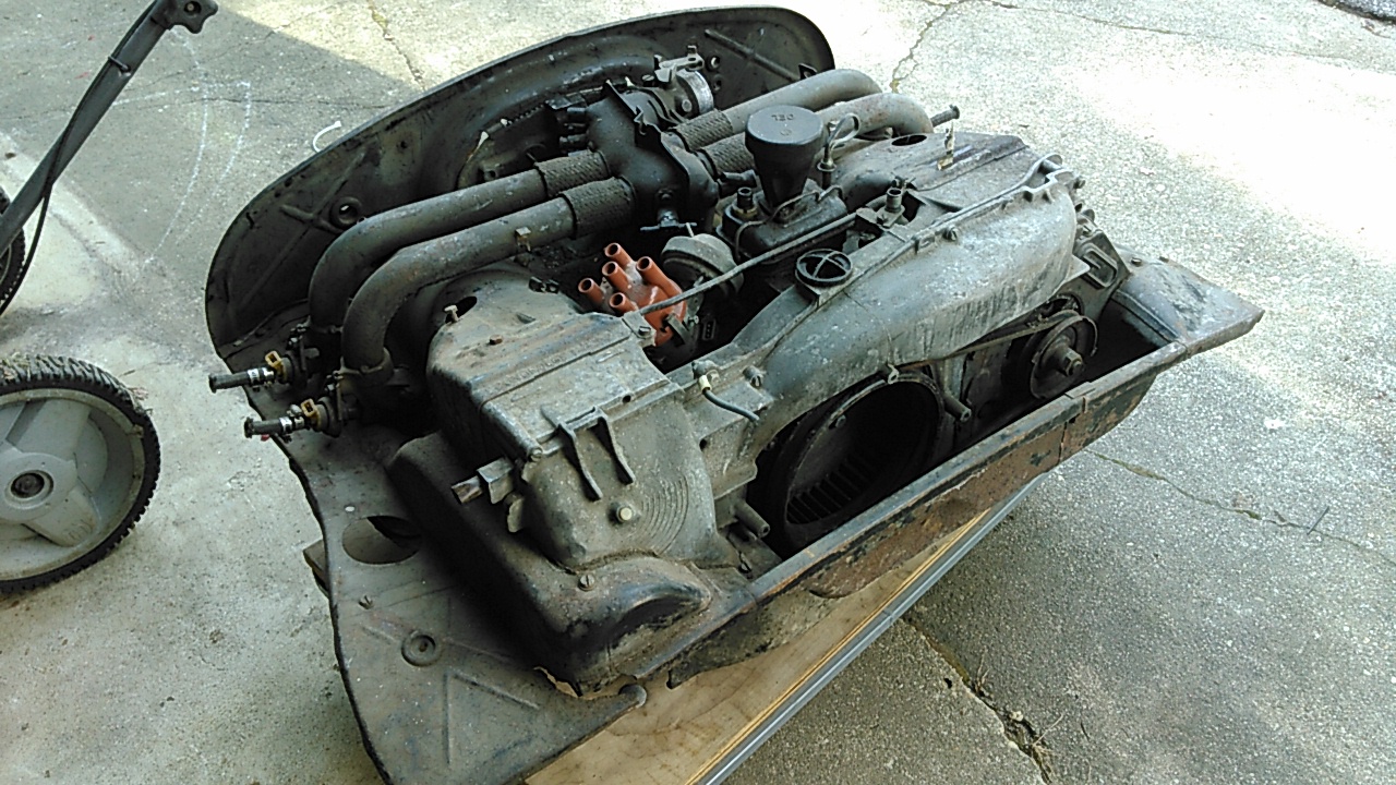

The main difference is the cutouts for the sparkplugs.
(IMG:http://www.914world.com/bbs2/uploads_offsite/matsgarage.com-15176-1444044349.1.jpg)
This is how they sit on a 2.0
