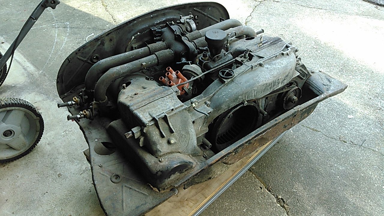

The main difference is the cutouts for the sparkplugs.
IPB Image
This is how they sit on a 2.0
914Sixer
The fan housing/shroud is the same up to 75. 75-76 has extra holes for top mounted smog pump bracket. The fans are Different because on the timing marks on them. Flaps and related parts are the same 70-76.
