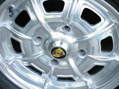

I have these Pedrini's that someone nicely polished before I bought them.

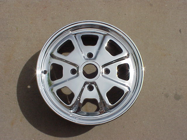

There's a lot of labor in that wheel Trekkor. Mahles and Pedrinis are more intricate than Fuchs.
This one took 30 hours.

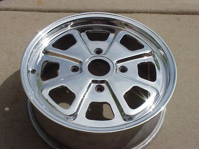

'nother.

Glass bead blast (which I wouldn't do if I did it again), 80, 220, 400, 600, 1000, 1500 ggrit sandpaper. Wet sand, mostly by hand. Couple of different polish levels on a large buffing wheel.
Lotta work... but those wheels you're talking about doing polich up really well. Go for it!
I should add, I would happily pay $75 a wheel to get those wheels fully poliched including the edges of the holes. Well worth it.

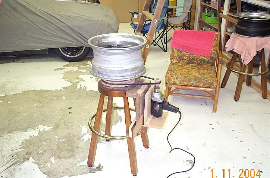

This cobbled up rig helps a bit, but I don't go the extreme of Gint's wheel.

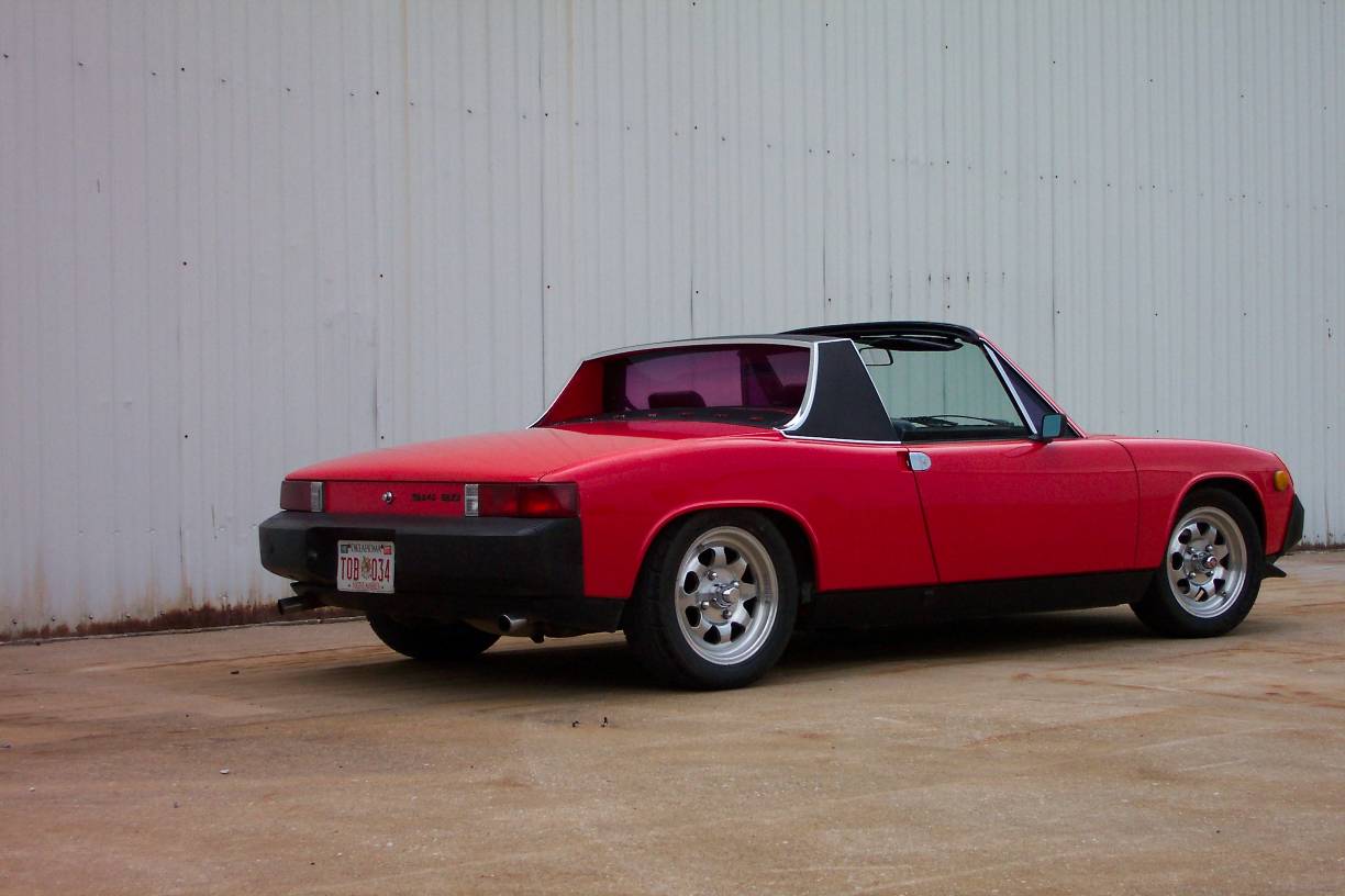

Here's mine after hand polishing with a high torque angle drill, 3 1/2" buffing wheel, black emory compound, followed by red rouge, then cleaned up with mother's. They looked just like yours before polishing. About 2 hours per wheel. Not a mirror finish, but I didn't want that.
Travis, I run 205/50 Kumho Ecstas MX and they fit just fine.
