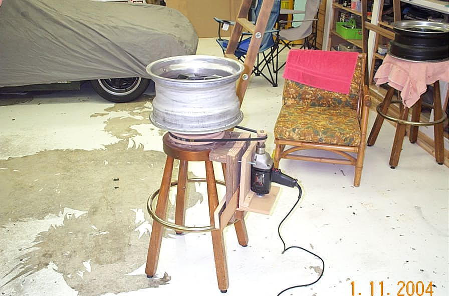

Ayup, 20 hours depending on your starting point.
This cobbled up rig helps a bit, but I don't go the extreme of Gint's wheel.

At 20-30 hours per wheel you guys are doing something wrong. Al Reed will polish your wheels for like $80/each and that's the retail price and he's making money. I figure it must take him an hour at the most.

And I figure you've never polished a wheel.
